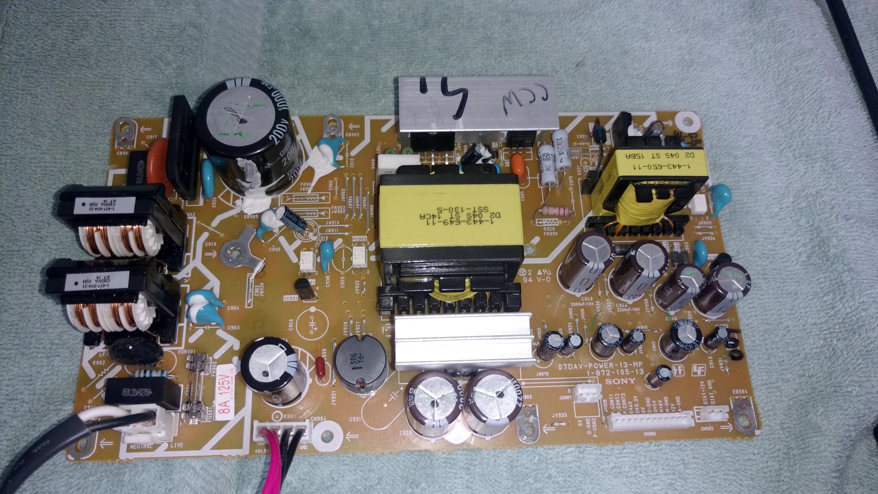

    Hi! I have a Sony home theater system that won't power up, model DAV-HDX265.
    It contains a power supply board 07dav-power-13-mp (1-872-105-13). I've checked a few things, but not sure where to go from here. Attached some pics, if any zoomed-in shots would help just let me know.
    - the voltage from CN904 marked 31.5vdc measures 0v
    - the voltages from CN906 don't make a lot of sense to me, but I'm not sure if I should be measuring from chassis gnd or "D-GND" on CN907...
    - I checked all electrolytic caps with an ESR meter, and nothing looks suspect; no caps bulging either
    - I checked the diodes and transistors, as well as IC921 for shorts but don't notice any
    - fuses/resistors F901, LF902, R912, R913, FR930, R903, R904, R927 all seem fine
    - for the heck of it I replaced C924 & C926 (I hate Lelon caps), but no change
    - I hear a faint, high-pitched squeal when the board is plugged in, not sure if that necessarily means anything

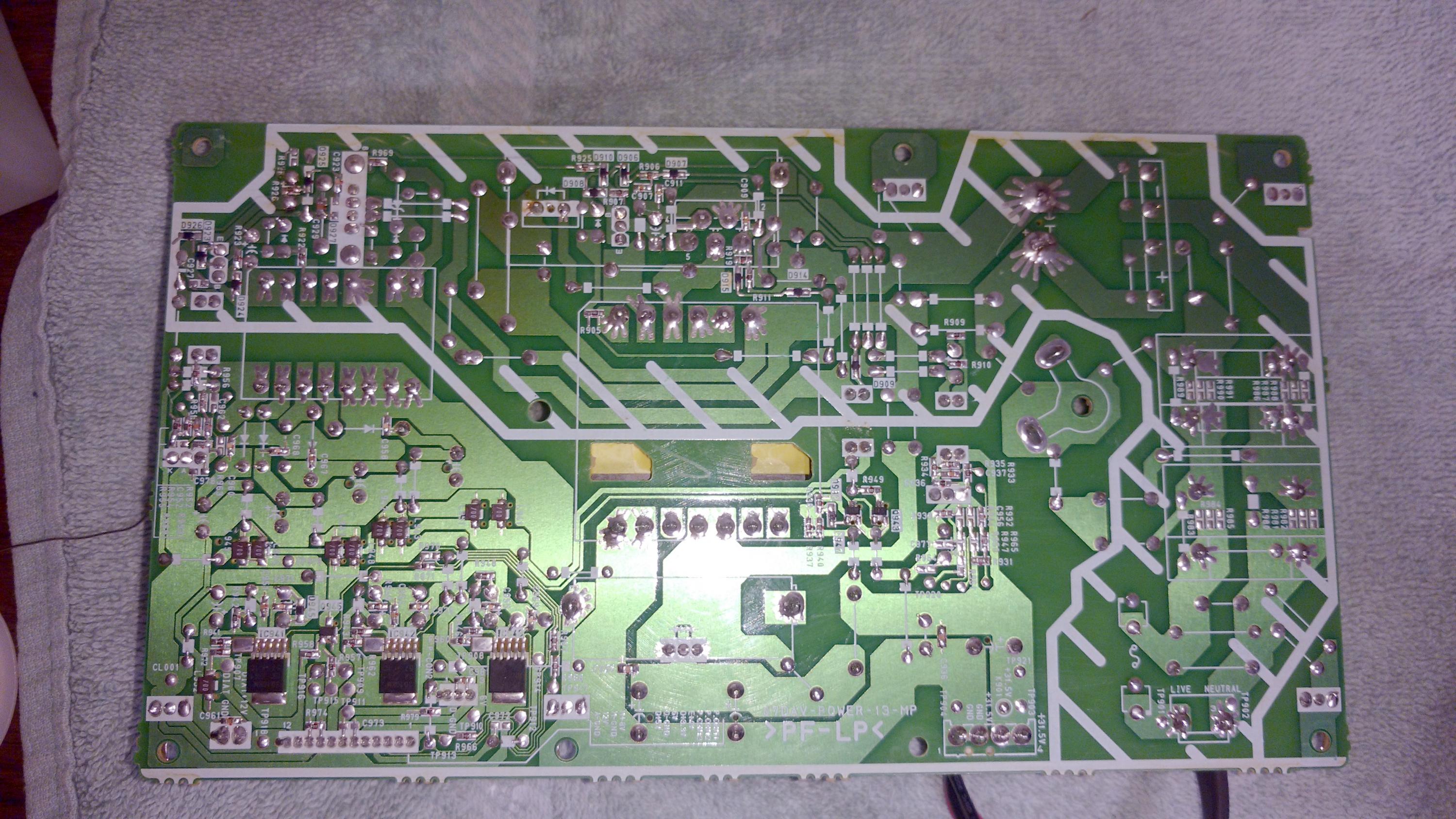

        I was looking at the picture of the bottom of the power supply board and although it's hard to tell from the picture, I would resolder the connections on both of the transformers. If you see the transformer lead and there looks like a black ring around it that usually indicates a poor connection.
        That P.CONT2 voltage seems high, Check what it is when the plug is connected to the rest of the unit.

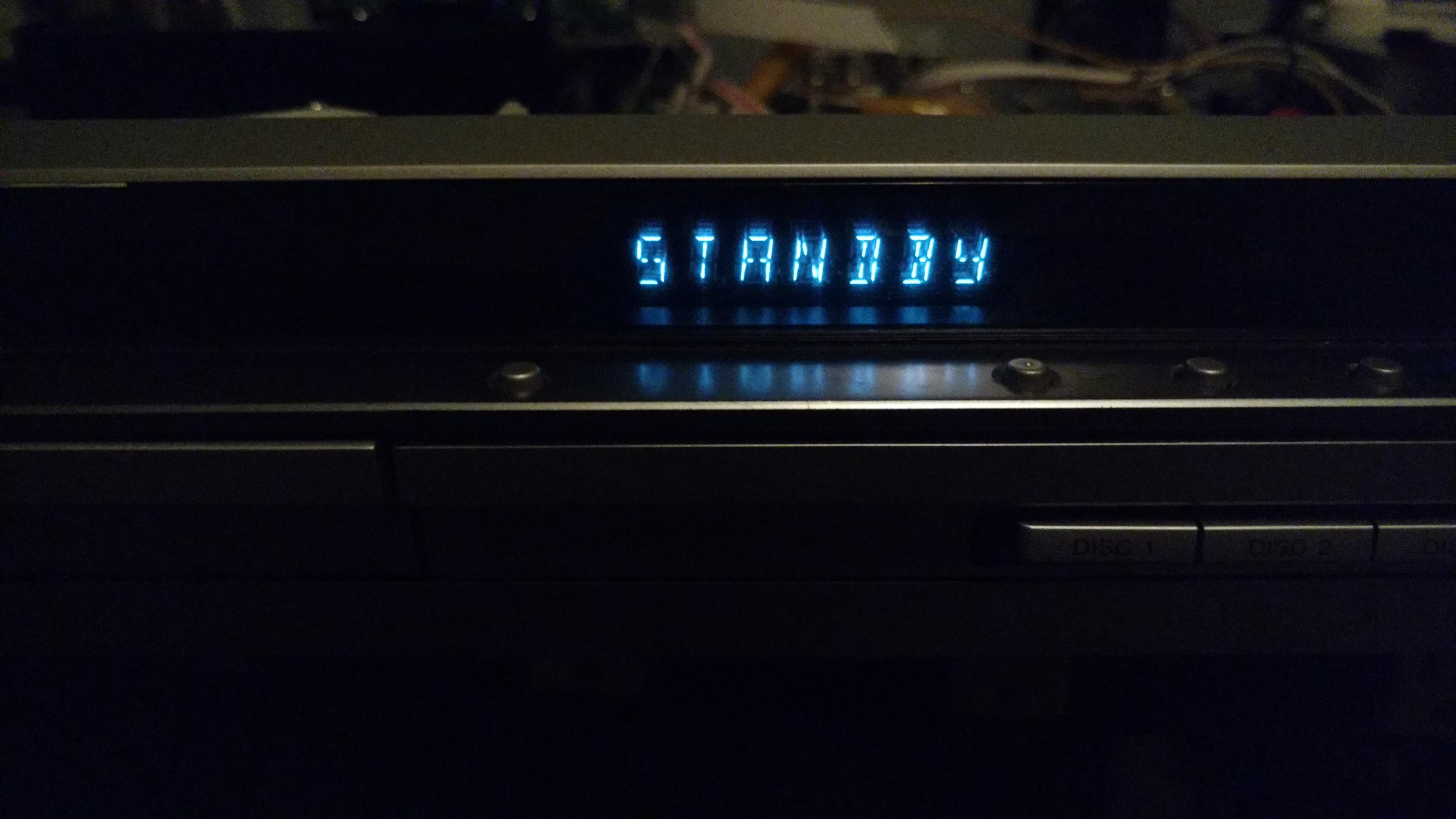

                                  Hi! Finally had some more time this weekend to poke around...
                                  The collector on Q3552 gives about 3.3 vdc when I first plug the unit in, but drops to 0. I notice pressing the Power button no longer makes this unit come to life, it just stays in demo mode regardless what buttons are pressed. Not sure what changed.
                                  I found another unit of the same model at a thrift store, shockingly also would not turn on... I picked it up anyway so I can have some parts to compare & swap.
                                  Unit #2 the power supply was completely dead, so I compared all components against unit #1 power supply, and finding different resistances decided to swap out both IC901 & IC921. Not seeing any bad caps, open resistors/fuses or other issues I plugged it in and unit #2 power supply seems good. Also the CN906 "6V" on unit #2 power supply measures 6vdc, compared to unit #1 which always seemed high. Plugged into unit #1 main board, all unit #2 power supply voltages come on for the first few seconds after plugging into the outlet, and all voltages look good, even 32vdc CN904.
                                  Putting power supply #2 back in unit #2, the unit came on the first time I pressed Power button. But when I pressed Eject it started showing "PROTECTOR" -> "PUSH POWER." Ever since, it shows that immediately after being plugged in, regardless of how long I let it sit. Shouldn't it go back to the Demo flashing mode after it sits a while? Did something on the main board kill itself the first time it tried to power up, or is some circuit remembering protection was triggered and I need to clear that somehow?
                                  I checked the outputs of each amp chip for any obvious shorts, but did not find any.

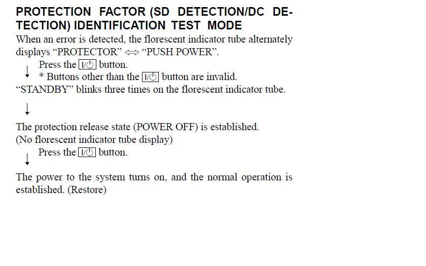

                                  Per the service manual (p24), holding Fn + Ej + FF displays "SD DETECT." I see a "SD" pin 4 on the Digital Power Amp IC's (p32 - 3100/3150/3200/3250/3300/3400/3500). These seem to feed Sys Controller IC501 pin 43, something called shutdown detection. I'm seeing 0vdc on this pin... I would expect to see 3.3vdc if there was an error...
                                  I notice each of these has a 0 Ohm resistor in series with each amp chip pin 4. I desoldered each of these 0 Ohm resistors in the hope it would come on since that would sever the detection pins from the amp chips, but I still see the "PROTECTOR" error. Both pads of each pin 4 resistor still measure 0vdc.
                                  I was hoping unit #2 would be an easier fix, but so far no luck :-P Any ideas what I could check next on either unit #1 or unit #2? If I can get one unit running that's good enough for me

                                    It looks like you need to have 3.1v on the SD line, 0v means error. The DC-DET line should have 3.3 volts. Check the voltage across the speaker terminals on all outputs.
                                      Hmm, no DC voltage on any of the speaker outputs.
                                      Thanks, that makes sense now. I was thinking 3v would indicate the error condition there.

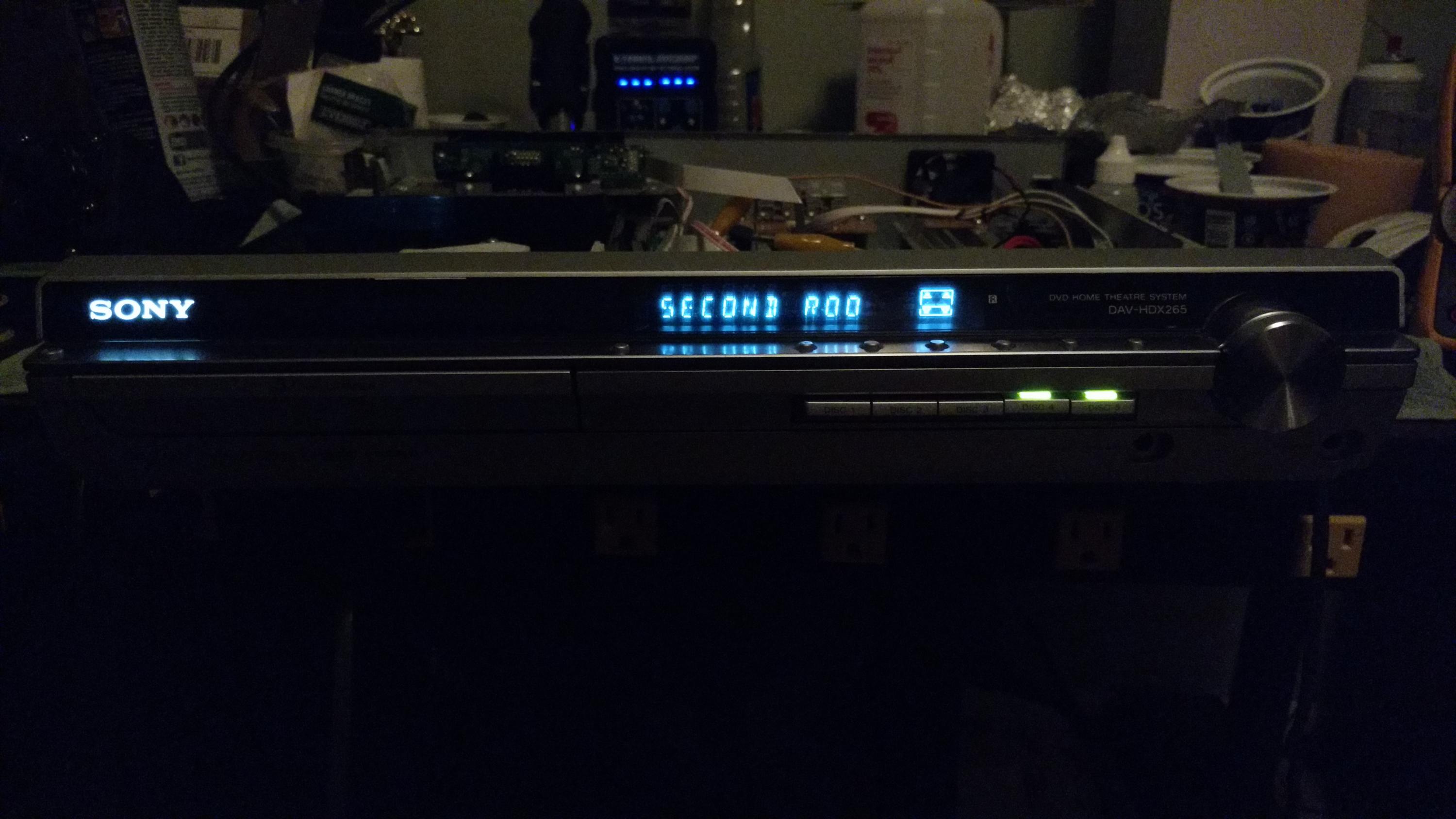

                                      To see what would happen, with the resistors after each amp chip pin 4 removed, I put E+4V into this SD line and the "PROTECTOR PUSH POWER" (SD DETECT) message goes away, and the unit even turns on. Re-checked all speaker outputs, but still no voltage on any of them (something like 0.05vdc), regardless of the Volume setting. I hooked a test speaker to several and input an auxilliary audio source, but no sound ever comes out. The amp chips do start warming up (I have the big heatsink off right now).
                                      I am able to press the Function button and cycle through things, but DVD (or pressing the Eject button) goes into an endless "PLEASE WAIT." Not sure what that means... I never hear any motors or anything in the DVD player attempt to move.
                                      I do see 3.3v there, so guessing that is good.
                                      I'm guessing the first step is getting the amp chips to output 3v on the SD line first, but does the above test of bypassing the SD error line resulting in no audio output & DVD "PLEASE WAIT" indicate additional damage? Or might everything clear up once the SD issue is resolved?
                                      Thanks for all your help!
