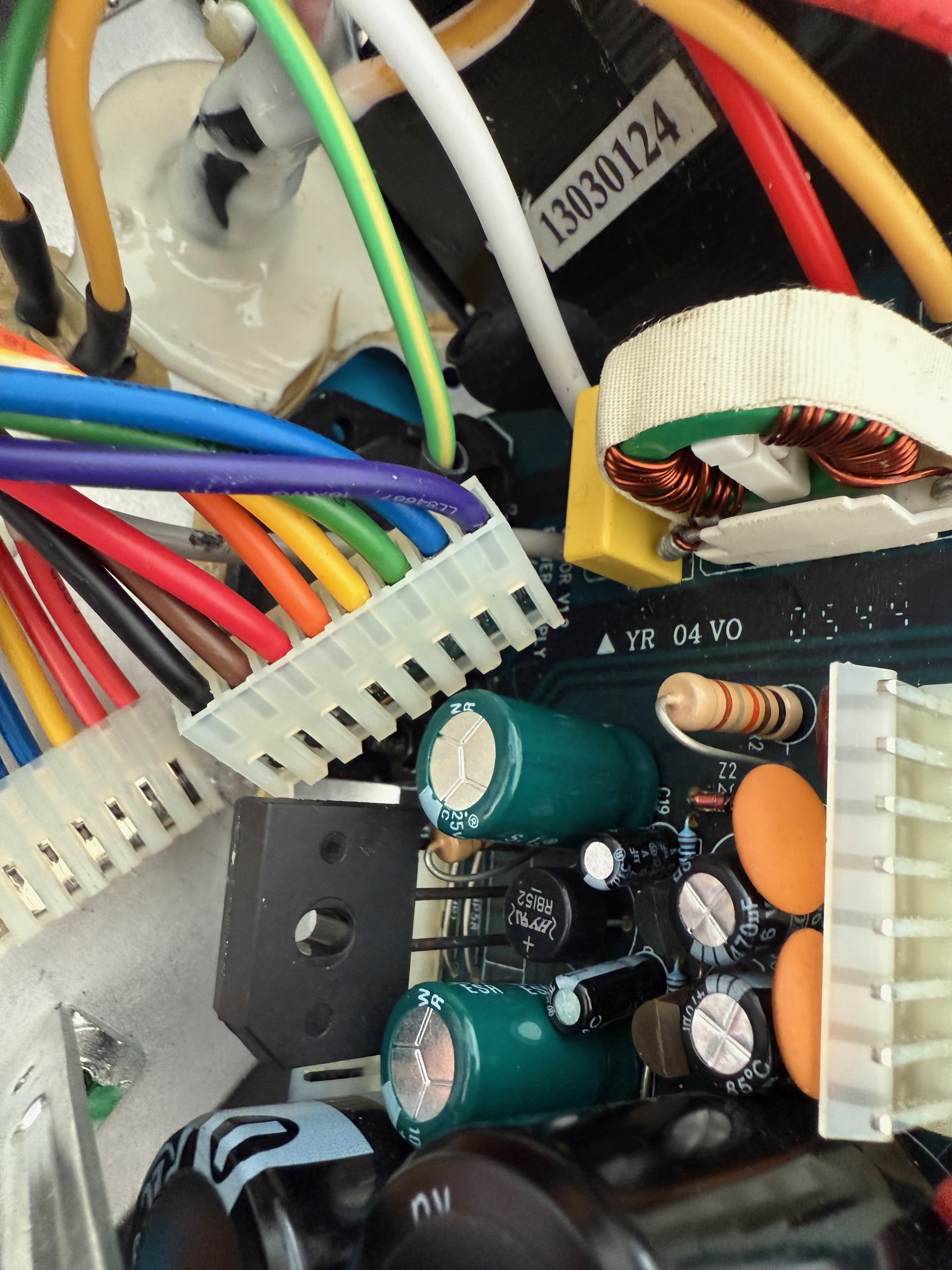

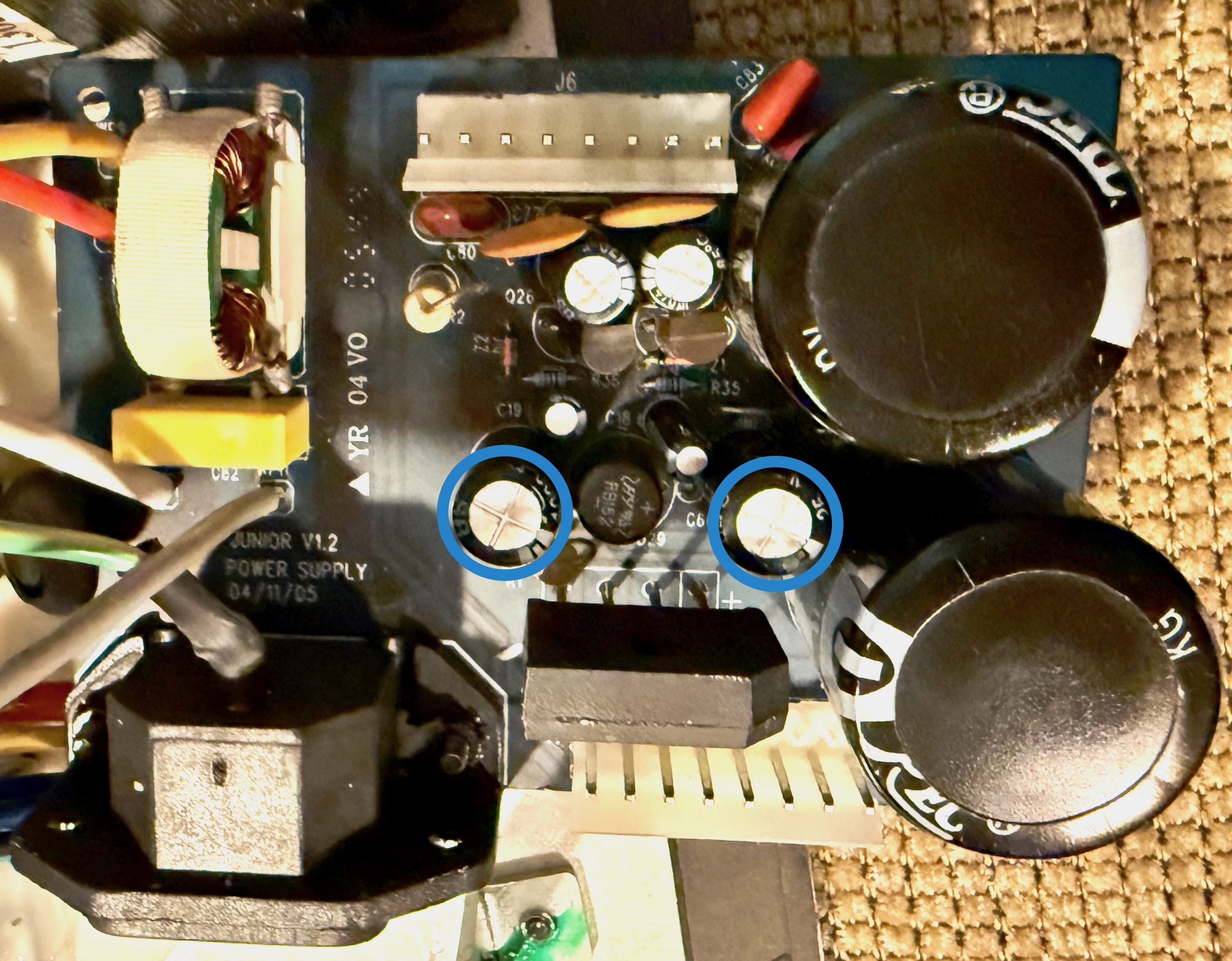

            Signed up to say thanks to all those who contributed to this thread for the past 15+ years. I was experiencing a constant hum with my subwoofer, and while the plate amp was not the one described in here, it appears that the power supply PCB used by the Woofers by Bob Carver Dominator Model D-10 uses the same (or extraordinarily similar) PCB. The board in this case is labelled JUNIOR V1.2 POWER SUPPLY
            One of my two caps looked slightly bloated, and it matched the regularly discussed 1000uf 25v ones in this thread. I replaced both on my board, and no more hum!
            Including some pictures in case they can help others in the future. Especially for others who have Bob Carver dominator subwoofer amps that might not be aware that this thread could help.

            The Junior v1.2 PCB with the caps in question circled in blue:

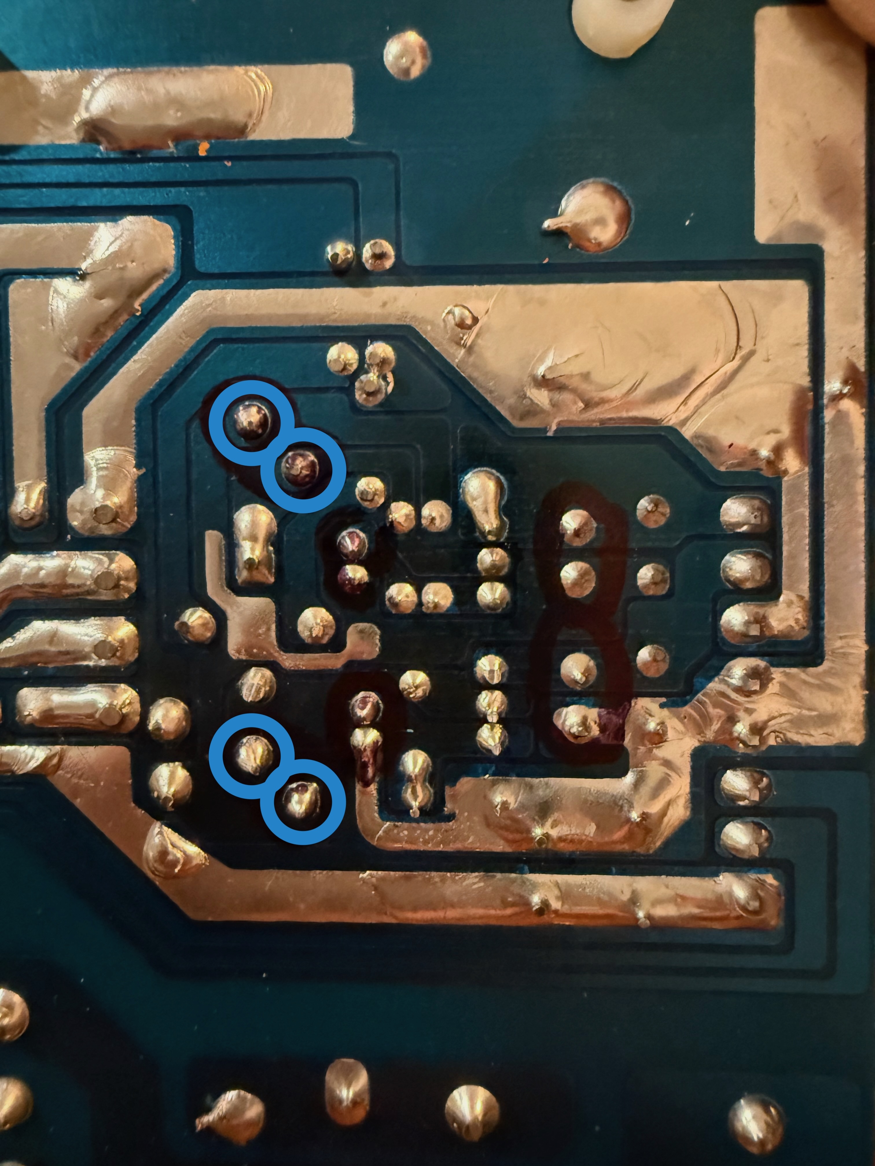

            The bottom side of the PCB with the solder points for the caps in question circled in blue:

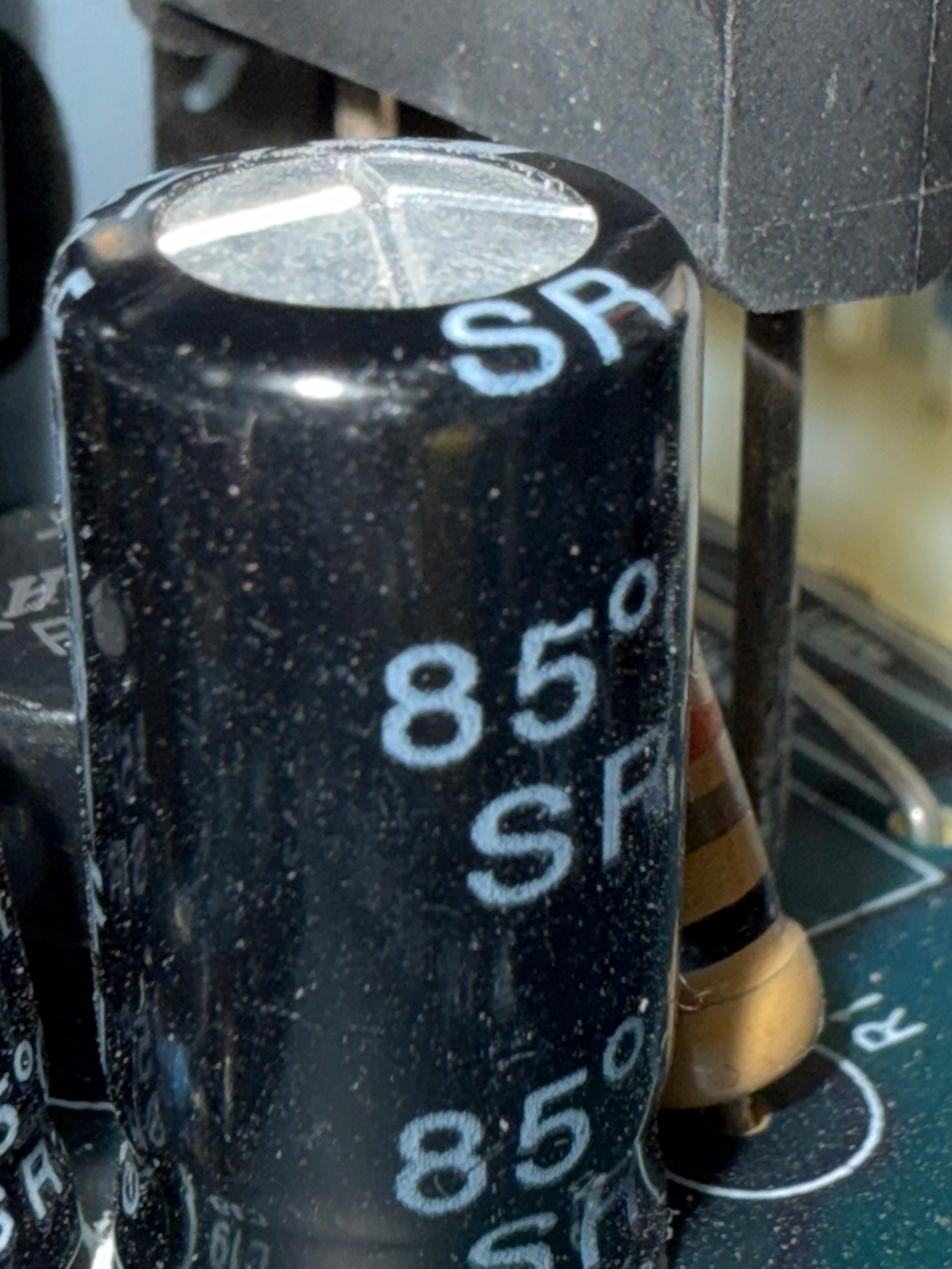

            Replaced caps:
