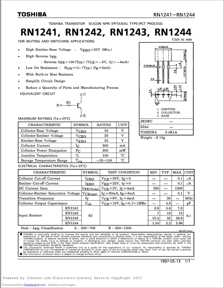

    Hi everyone, I need to change a pre-out plate transistor, RN1241A, but I can not find the same, someone can suggest an equivalent..

    http://www.allxref.com/toshiba/rn1241.htm
    Will this help?

      That transistor is unique because it has a built-in base resistor ("RN"), and is for audio muting.
      I would use a transistor for muting applications and add a series base resistor, if you can't find it:
      2SC3326
      2SC2878 (popular TO-92)
      2SD1468
      2SC4213 (SC-70)

        The 2sc2878 is easily found in Brazil, it will be my choice, just confirm the value of the resistor in the base, put of 5.6k?

          That would be it.
