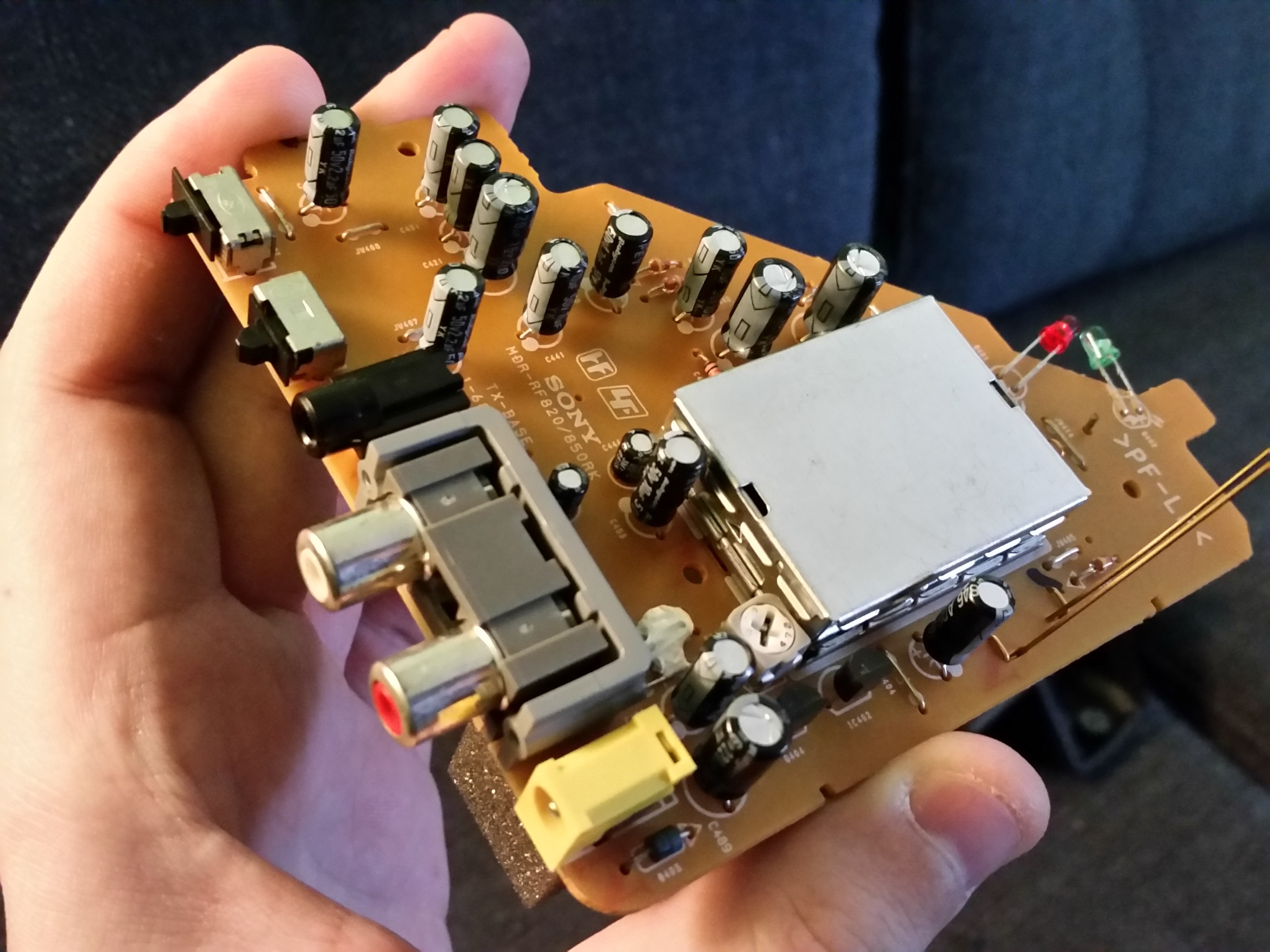

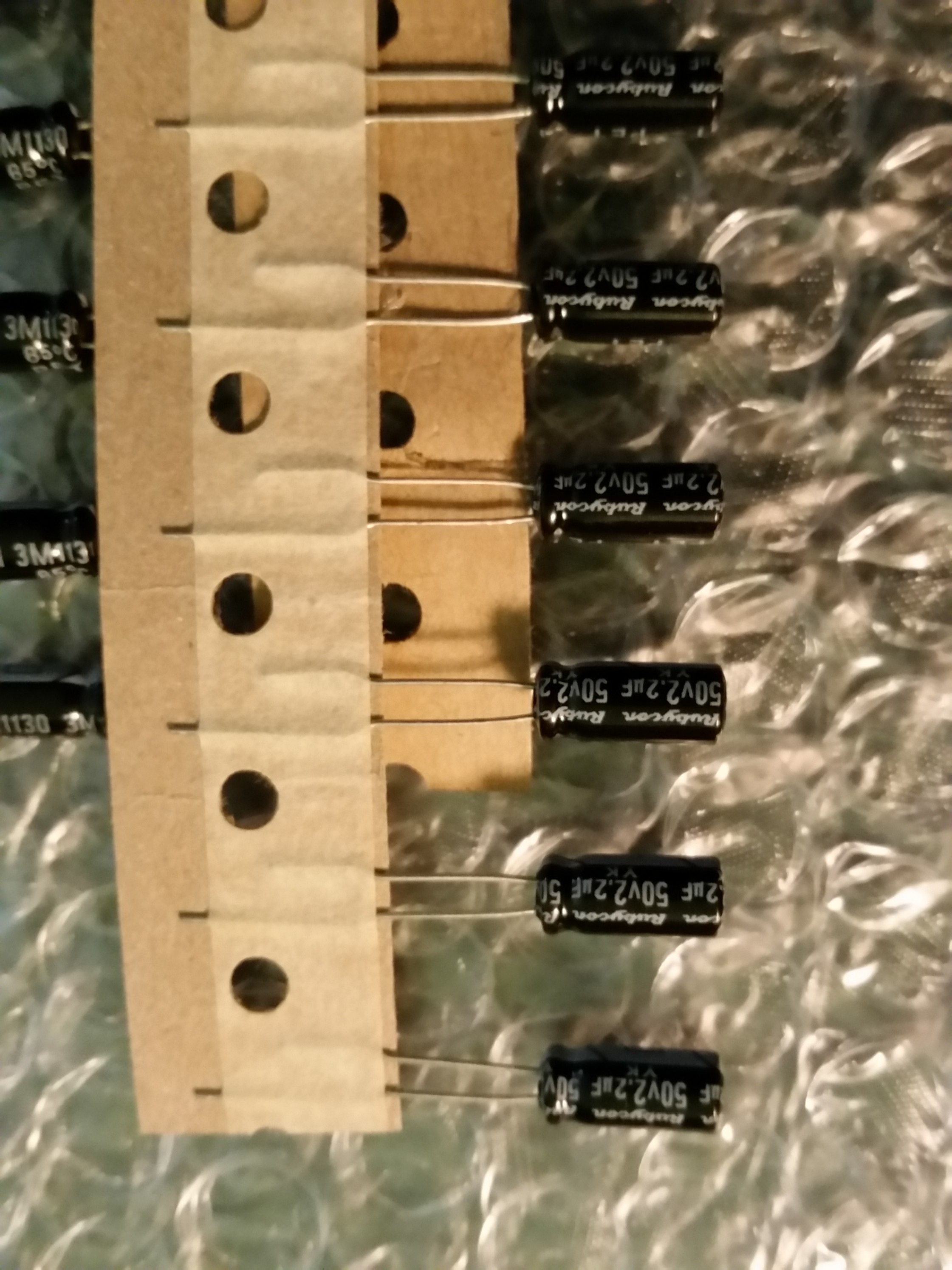

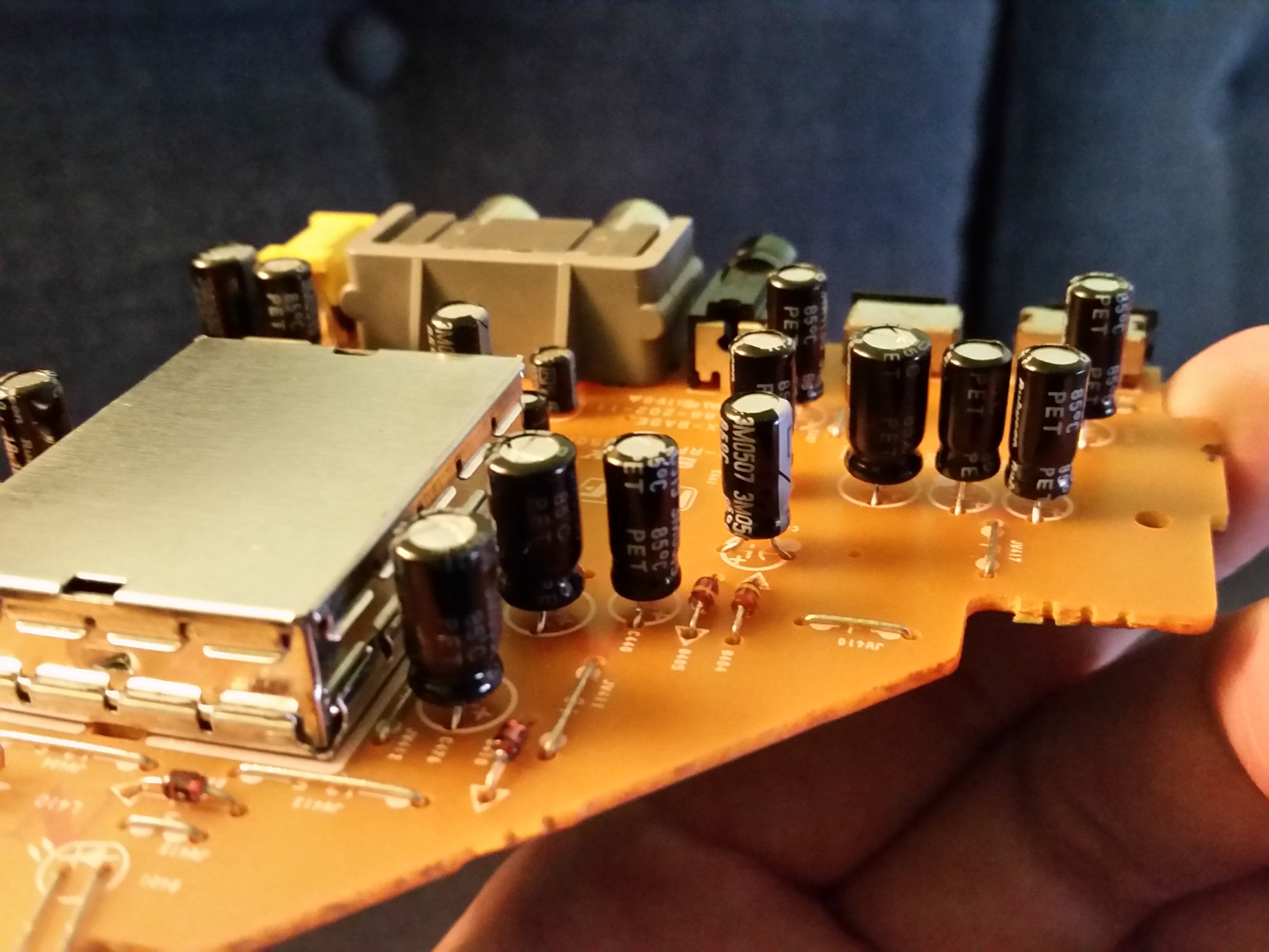

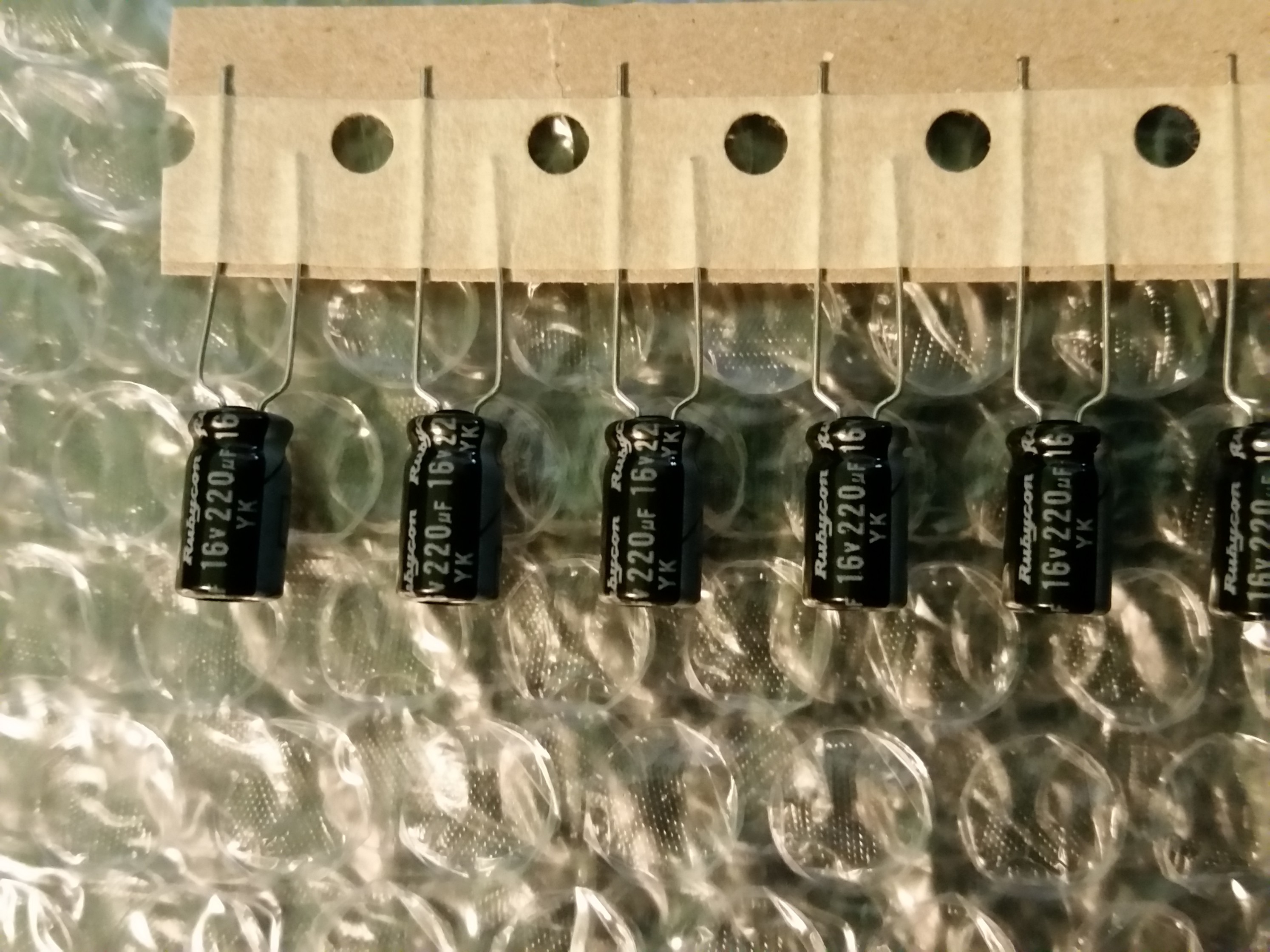

    I got my caps today. I will take some pictures of the caps for you guys to see how they look like. They truly seem to be genuine Rubycons. I recapped the transmitter base PCB, but unfortunatelly, the problem is still present. Still occasional hiss sounds appear. But there is a slight difference now, they do not get worse when moving around the room. I guess these headphones started exerting some FCC directed behaviour, causing an undesired operation.
    Anyway, I only ordered replacement caps for non-Rubycon caps, but maybe some of the Rubycons went bad. Maybe it's not the caps at all. I also recorded the hissing sound with a microphone, but I don't know if it is possible to attach a file type other than image.
    I will post some images for you to see the recapping results, but I am getting tired of this malfunction. The recapping went smoothly, but the results were and still are disappointing. I have a bigger fish to fry now, and that is the ongoing PSU problem.

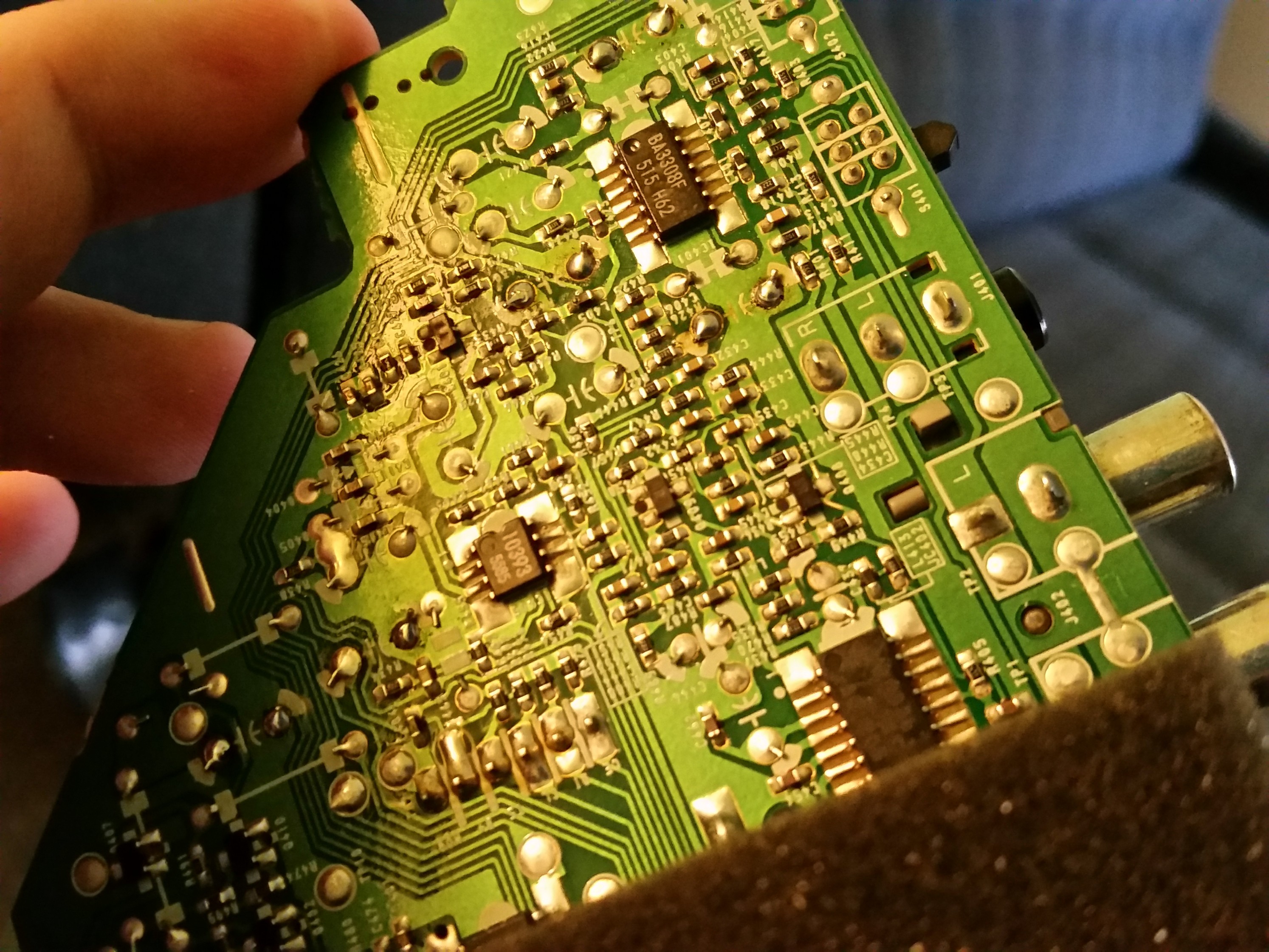

      Well, I suggested this several posts back, but I didn't get an answer from you...
      Did you try swapping the power supplies/adapters that power these stations? What about the audio cables between the station and whatever it is getting its signal from?
      There is also a BA3308F pre-amplifier IC on the transmitter board. You should verify that it works by inputing a signal into the base and seeing if you get anything on it's output pins (pins 1 and 7, that is).
      There are other ICs, but I can't see their numbers. I doubt they would have failed, though, so let's leave those alone for now and focus on the items above.

        Momaka, thanks for your your reply. I did test my base at my sister's, when I wrote about comparing the operation between mine and her headphones. It meant that I connected my base to her adaptor (I didn't bring my adaptor and/or cables because she also has the same model and everything was compatible). My headphones did not hiss when receiving from her base, but her headphones did hiss when receiving from my base - both bases were connected to her adaptor one at a time.
        Also, I added that additional 16V220uF capacitor near the DC plug on my base's PCB, but I guess it didn't make too much of a difference. I will include these pictures as soon as I get home and grab some time to do it.

            Ah okay, good! That means you isolated the problem to not being the power adapter or audio cable too.
            With that said, just to make sure the issue is not the other caps you didn't change... get a hair dryer or a heat gun and heat the entire transmitter base PCB well - no so hot to burn yourself, but close. Then see if that makes a difference. If it does and the transmitter works, then you either have bad caps or a bad solder joint somewhere.

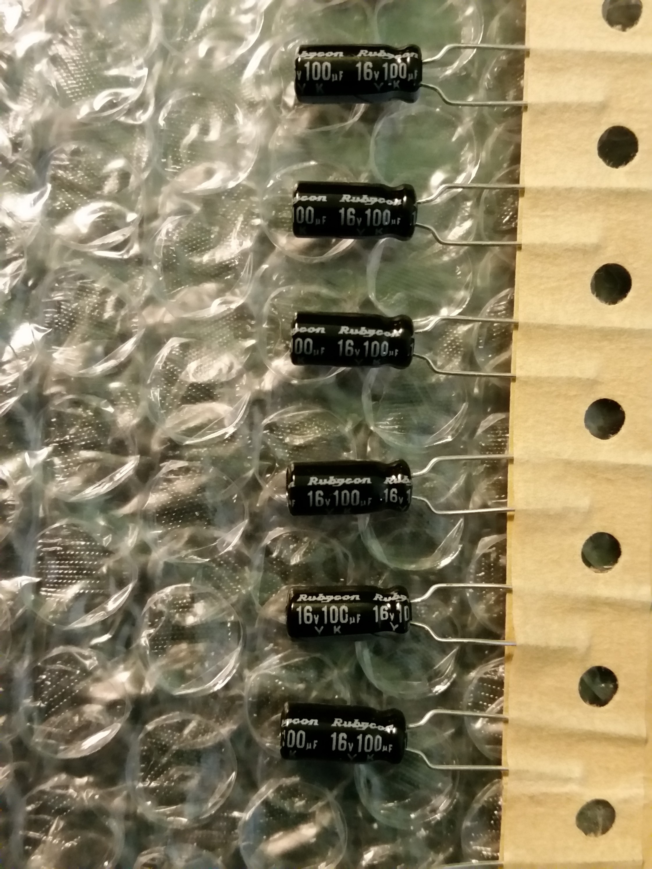

              Here are the replacement caps, the ones I got from egekecu.
              I am going to try the hairdryer trick now as it will be an easy access now that the base is apart.

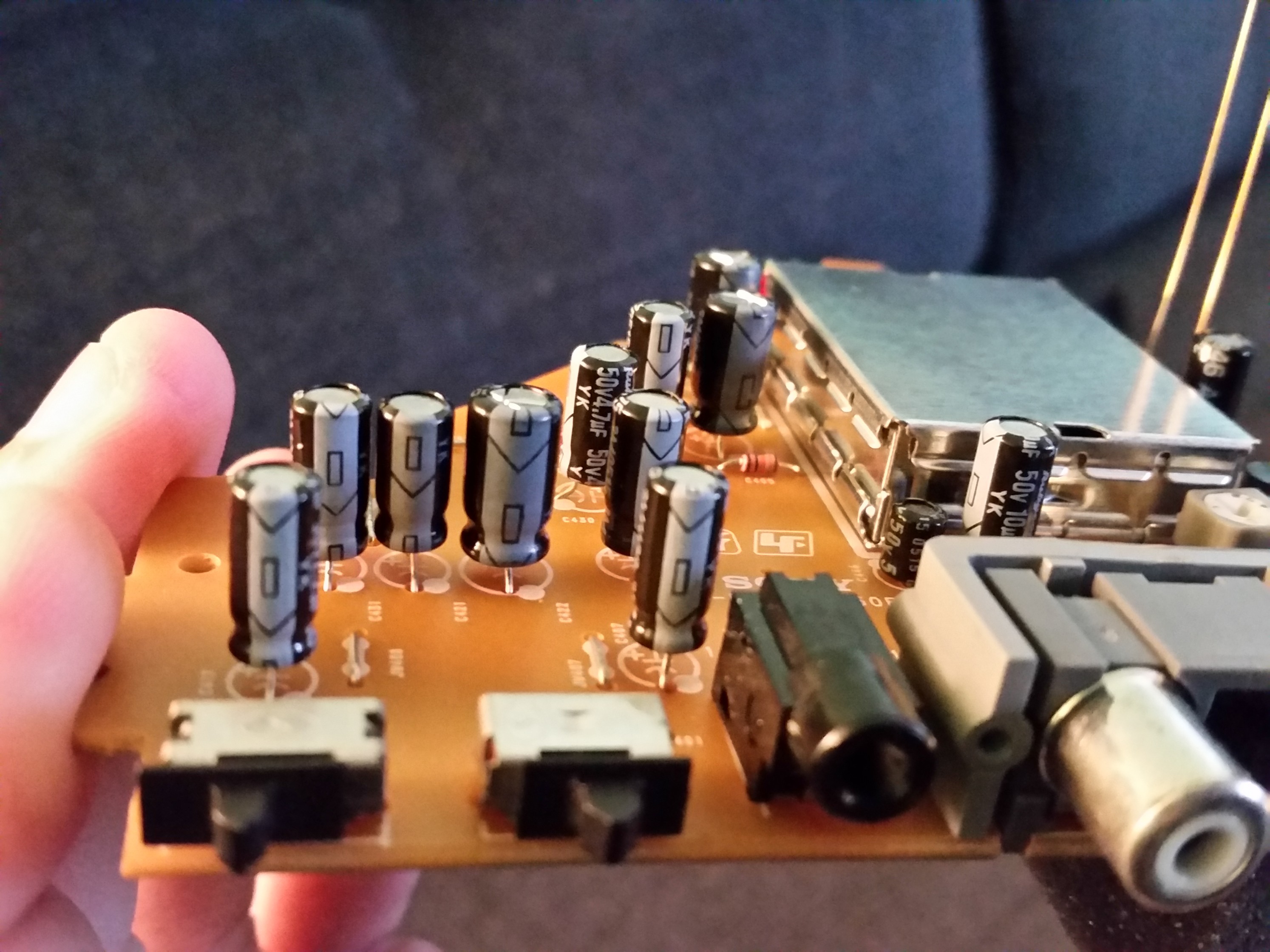

                      Well there is not much else on the board besides caps and some small ic's.
                      In this case i would mark the potmeter as it is right now and slightly change it while playing some sound like music.....
                      Maybe the frequency changed a little.

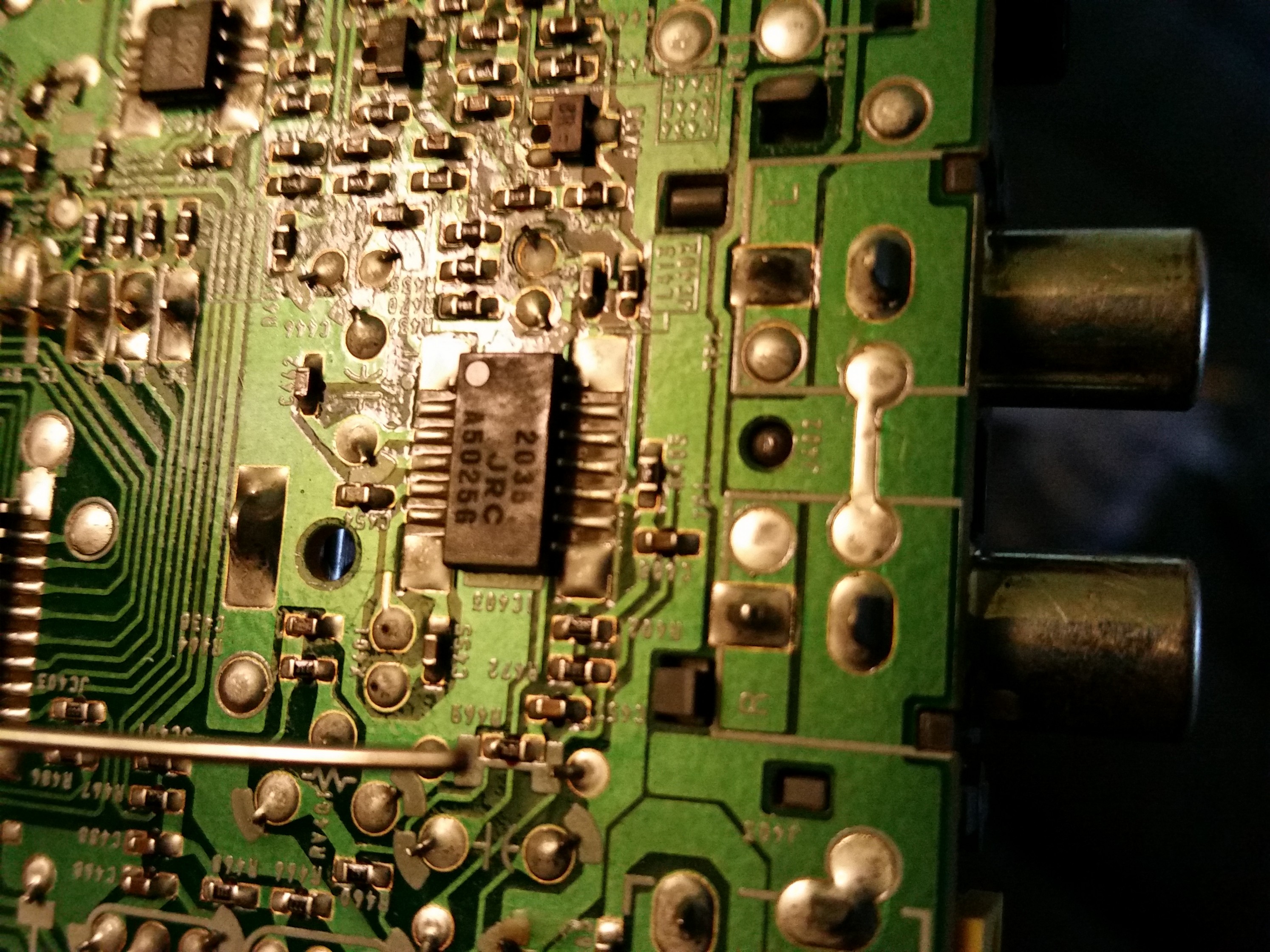

                        So the transmitter is sort-of working then? As in, you can listen to music and whatnot, but only that there is also a hissing noise on top?
                        The hissing sounds almost like some high-power computer/digital noise is getting through. If you are listening to music, let's say, does the audio go out when you hear the hiss or does it continue with the music?
                        Originally posted by UserXP
                        You suggested to check the input. I am not sure what you were referring to, but if you meant the sound input, then yes, there is one.
                        No, I meant trace the audio input on the transmitter board and see if it goes to the BA3308F pre-amplifier IC. If it does, then also see if the audio you get out of the BA3308F IC is the same or noisy.

                          The hiss is present whether I play something or not. If I tune the headphones to pick a local radio station, the hiss disappears. As soon as I tune them to receive from the transmitter, the hiss and fuzziness appear. Just like in the recording, if nothing is played and the base is on, that hissing is all you can hear. When music is played, the hiss is also present but is therefore masked by the music sounds. If in the music there is a more slient part, pauses, beats and alike, the hiss is heard more prominently as there is less of music stuff to mask it. Also, if I turn the volume knob up on the headphones, the hiss also becomes louder. Nothing gets cut off, it's just as if the hiss somehow became incorporated into the radio waves sent from the base. I can hear all the tones when listening to anything, its just that there is this random and annoying hiss present all the time.
                          As for the IC you mentioned, I can try tracing the leads on the PCB, but if tracing would require the use of some specific equipment, I don't have any. If it doesn't, please direct me on how to trace that.

                                What does that little potmeter do?

                                  I don't know. I didn't touch that. There is the same one in the headset. It's probably tuning something.

                                    You could just play a sound and use the potmeter and see if it changes anything. For example when you are listening to the radio in your car and the signal is bad. Add a little MHZ up and signal is good again.....
                                    Maybe the hiss is bad frequency

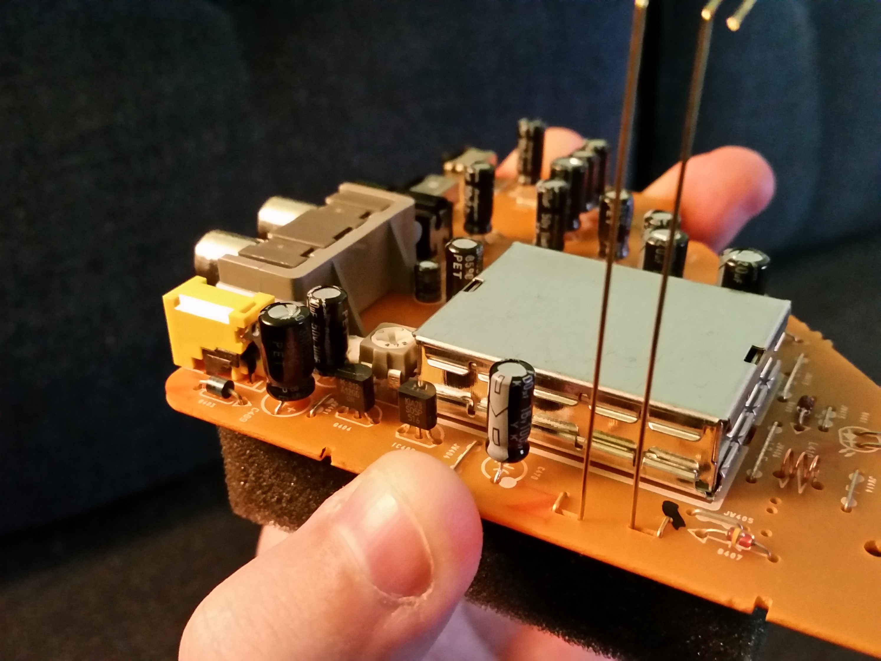

                                      I am not quite sure what you think I might achieve by fiddling with that potmeter. The base already has 3 channels selector switch, which are - according to its user manual - ranging in 0.5Hz respectively. The headset has a tune wheel, and no matter which of the three channels is selected, the hiss tunes itself within the signal. Not knowing exactly what that pot does might prevent me from turning the base into its original state. I don't know how sensitive the changes would be, which might make it difficult to return to the exact original state even if I marked the pot position to begin with. Maybe a bit more reassuring information could help.

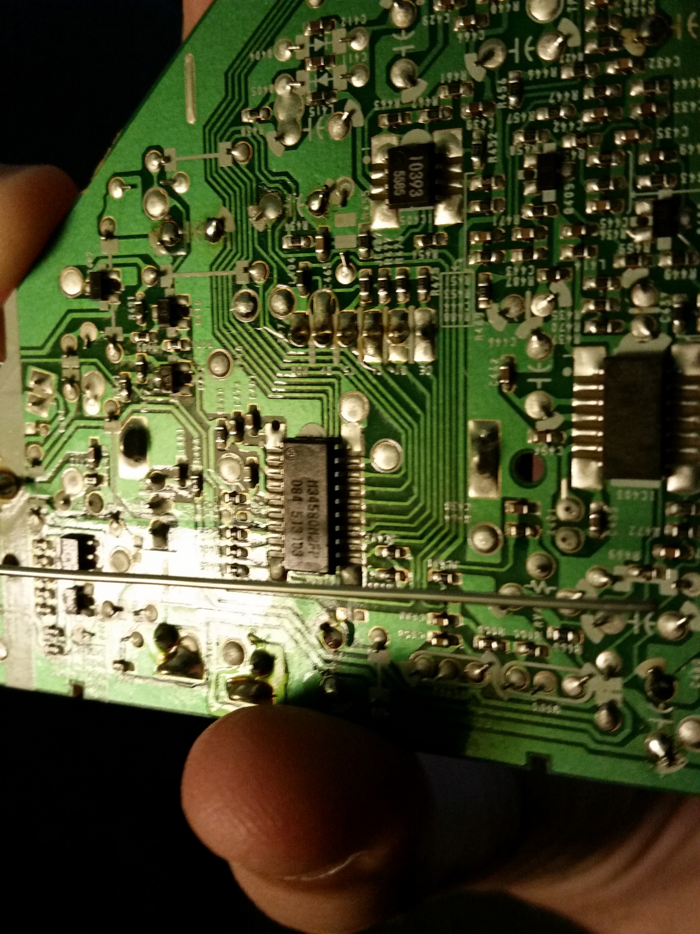

                                        Well, thanks for providing the sample. It really gives a lot more insight to what is going on.
                                        Unfortunately, I'm not sure what could cause that slight hiss/noise. It is not constant, so I don't think it's a drifting tunning frequency issue. (Though if someone knows more about radios, please correct me if I am wrong). That said, I imagine a headset like that probably uses a PLL IC to do the FM modulation. Thus, if there is a bad component, probably nothing will work. Most likely, there might be a resistor or a capacitor (non-electrolytic too) somewhere that is drifting only slightly in value due to age, and thus causing the PLL IC to misbehave.
                                        I agree.
                                        Don't touch it yet if you don't know what it does.
                                        First try to trace to what IC it is connected to. Then get the datasheet for that IC, find what pins the pot connects to, and try to see what its function could be.
                                        I know that is much easier said than done, of course. But with a little bit of patience, you should be able to trace it. Post back what you find, though, so we can try to help you with finding IC datasheets and trying to understand what the pot does.
                                        If bad comes to worse, then we can try to play with the potentiometer. But before doing any of that, do make sure to mark its original position so that we can return it back to what it was. I doubt it would be that sensitive that you can't get it back to what it is originally - that would be a bad design and could make the headset/base not work even from a simple drop, as that can often cause the pots to vary a little.
