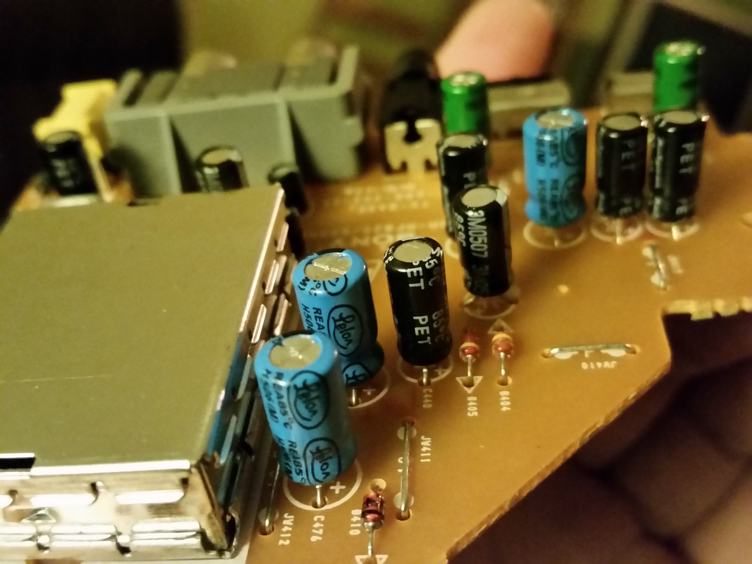

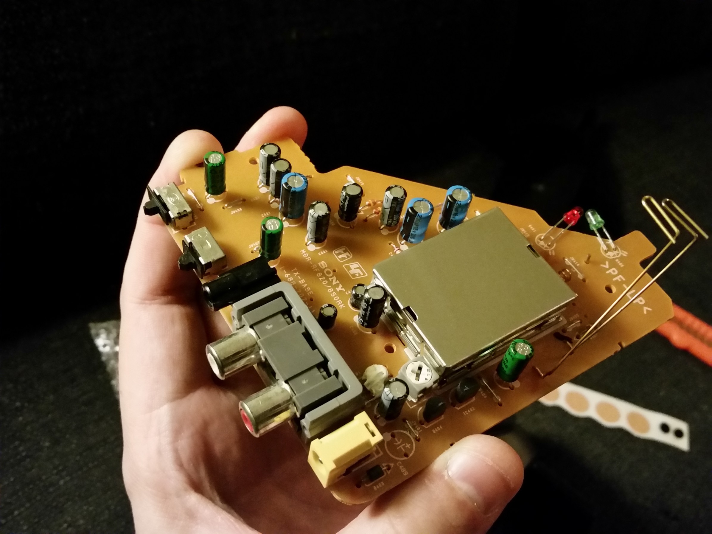

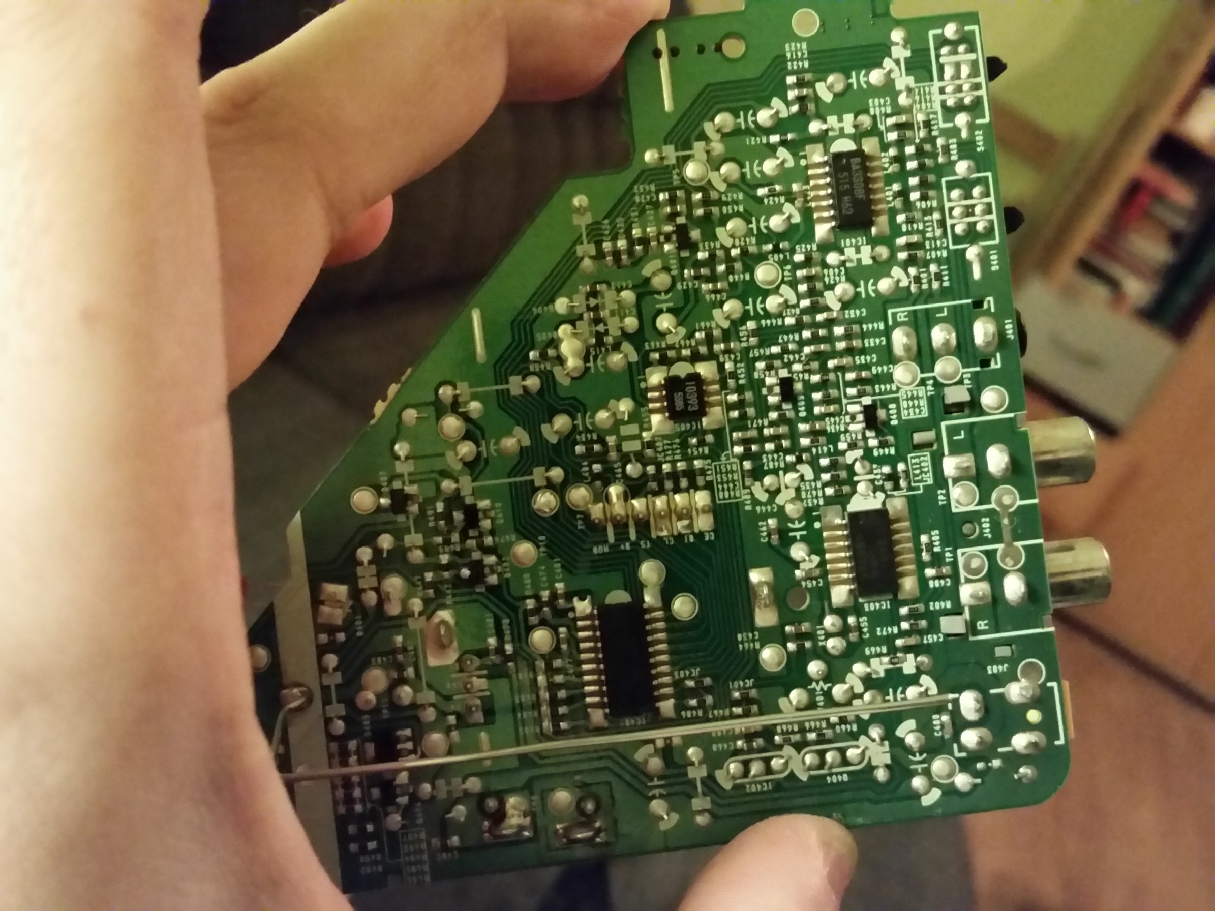

    Hello, guys.
    I was wondering if you could help me identify the source of the problem. I have these wireless headphones from Sony which worked flawlessly until recently. Now, when they turn on, intermittent hissing is heard, combined with a very short hiss every two seconds. This happens regardless of the position from the transmitter.
    To be on the safe side, I took mu headset to my sister's as she too has the same model of headphones and the hiss is not heard when connected to her base/transmitter. So it must be my transmitter that is sending this hiss sound. Also, when I turn the transmitter off, I can turn the headphones Tune knob and pick some local radio stations which sound normal and without hiss. So the headset seems to work fine and must be receiving the hiss from the transmitter.
    I have included a few photos of the transmitter PCB if it could be of any assistance. The black caps are all Rubycon YK series, most of them are 50v10uf, 50v22uf and one 50v4.7uf. The green ones are Sam Young 16v100uf and two 50v2.2uf. The blue ones are Lelon 16v220uf. None of them seems or looks defective.
    Do you have some idea as to what could be causing this repetitive hiss, mixed with additional intermittent hissing sounds? Thanks in advance for any assistance, as always.
      If I were doing this repair
      Just because they have not pop there tops or bottoms that does not mean that they are still good
      When I see these brands or ones that I have not seen before I replace them on sight
      I would replace all of the caps that you have above

        Well, looks like a lot of the FM receiver stuff is in a metal box, so probably not much to go wrong with that. Thus, I suggest to start by replacing the caps. Of course, before you do that, try some fresh batteries. It would be too funny if that's all it takes to "fix" this issue. I'm sure you probably tried that already, but just mentioning it anyways - sometimes simple problems are overlooked and interpreted as much more complex ones - at least it's happened to me quite a few times.

          Thank you all for your suggestions.
          @Sam:
          I was thinking to do that, and I actually looked on eBay from that one seller who has original Rubycons (his name is egekecu or something similar), I ordered before and all was OK. But there are 5 different cap values involved for the base, and it went to around 30$ for the cap packs (as he sells in packs of 10pcs or so). I will check with the seller if he could customize the order.
          @Momaka
          I agree, I to had similar situations. I fully recharged the batteries and it didn't help at all. I found a "mod" for these headphones' bateries. Original ones had square inserts on the battery ends. So I removed those and it turned out it could be fitted on any AAA rechargeable battery. Since then, I am using Duracell AAA rechargeable batteries in these headphones and the base has always charged them nicely as if they were original ones. This workaround was also much cheaper solution than ordering a pair of original batteries from Sony.
          I am very tempted to try with the recapping, but I also am not sure whether it will make any difference or I would be just throwing money. Do you think these existing Rubycons have gone bad, or should I just order replacement caps for the non-Rubycon ones?
          I managed to open the headset as well, but I forgot to take pictures of it. The PCB in it also had several caps and they were all tiny or short in hight. The headset operates on two AAA batteries, so I don't think the cap values are high, especially with their small size. They were also very tightly positioned to each other, making it very difficult to see the readings. They too looked fine, but I am not sure as to what brand they are. :/
          If it would help ypu to see those imagges as well, please let me know, I will reopen the headset's right cap and take some photos for you.

                                    Yes. When I:
                                    - tune my headset to her base transmitter, noise is not present.
                                    - tune my headset to my base transmitter, noise is present.
                                    - tune her headset to my base transmitter, noise is present.
                                    Both her and my headset can pick up some local radio stations and reproduce hissless audio output, so the headsets must be fine, right?
                                    Do you have any specific idea I did not try?
                                    Also, I opened her base transmitter to sse its inners. Everything is identical to mine, except hers has only Rubycons YK series and no other brands, plus her base has a fourth 16v220uF Rubycon cap near the DC plug. My PCB doesn't have that one but there are markings and holes on the PCB where the additional cap could be soldered (I think it is visible in one of the included pictures from the initial post). Can that mean a difference all of a sudden?
                                      Yes it could.
                                      If they removed that cap as a cost-cutting measure, the circuit function could have been marginal to begin with, but still enough to last a while. As things age - particularly caps - ripple and noise can start to get high enough that not having that capacitor makes the difference between a functional and non-functional circuit.
                                      So on that note, it's probably not a bad idea to get a spare cap and fill that spot too. Might as well if you are ordering other caps.
