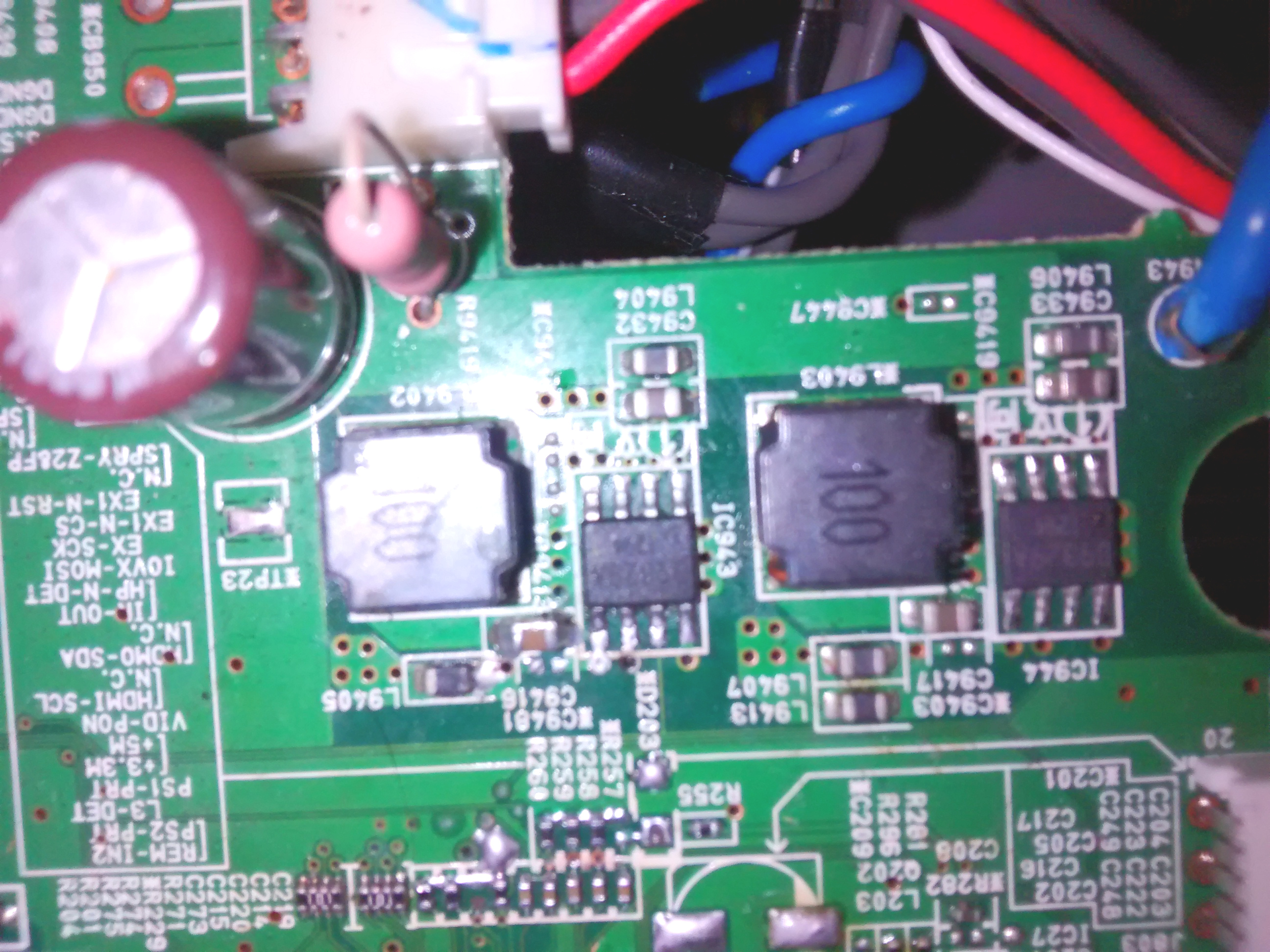

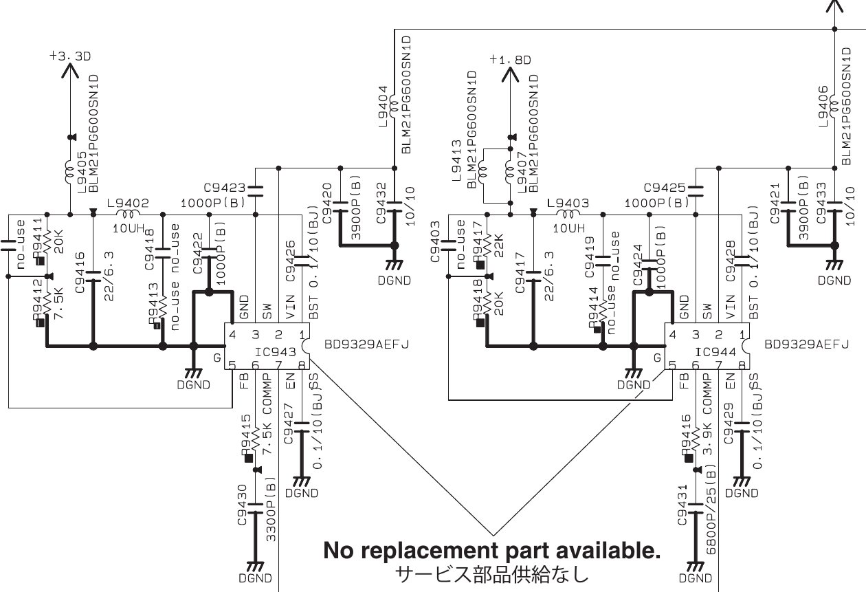

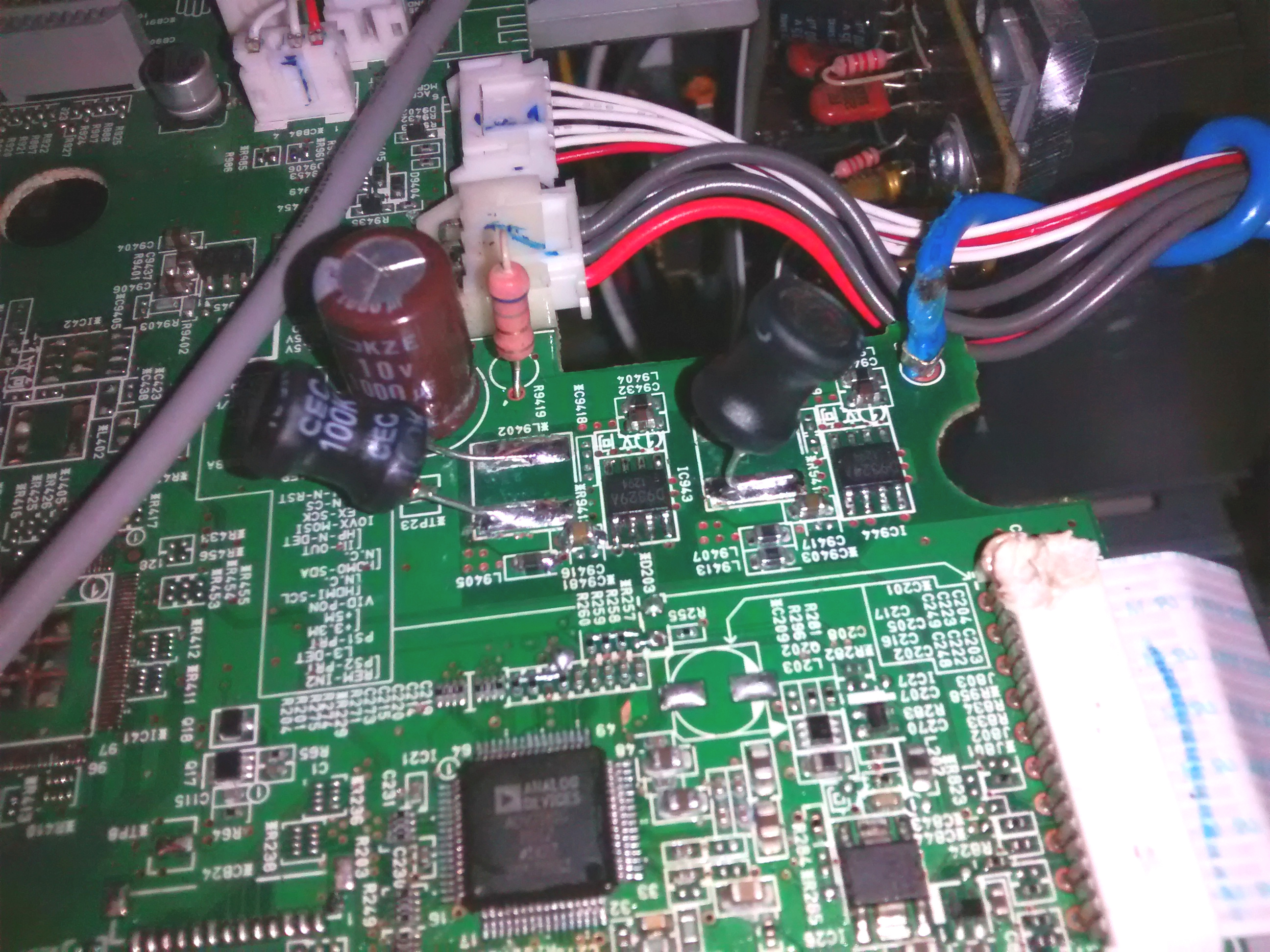

    Re: Strange noise when powering up
    And here is the development - after some time it started to make noise even after the boot procedure. At first the noise was stopping after some time and after that all features worked fine. Then the noise started to be continuous and some of the "smart" features stopped working.
    At that time I finally opened it and after several temporary fixes ( resoldering the power board ... which at this moment I cannot explain why it even worked ) I think I finally was able to find and replace the problematic parts.
    With tapping different components I was able to find the problematic nodes - two pulse power supplies - ic943 and ic944 ( BD9329AEFJ ) on the hdmi board.
    So, I resoldered the pins of the chips, replaced the two big smd inductors and for a week the unit has been working fine.
    I also have some scope screenshots from the time when the noise was occurring and I can upload them here if anyone is interested.
    Now I'm just uploading some visual aid from before and after.
    The strangest thing was that the unit was booting up fine, no errors were recorded and the system menu was showing all Vs withing the limits.
