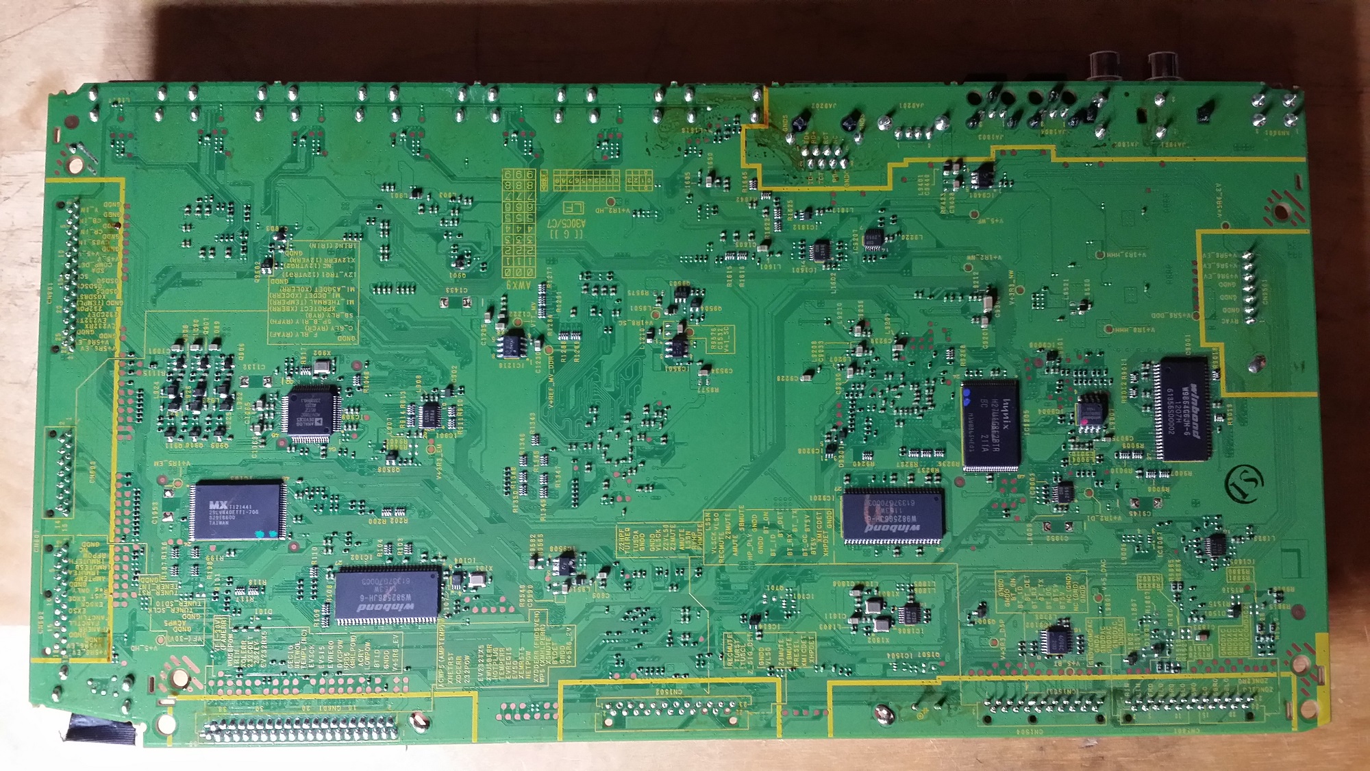

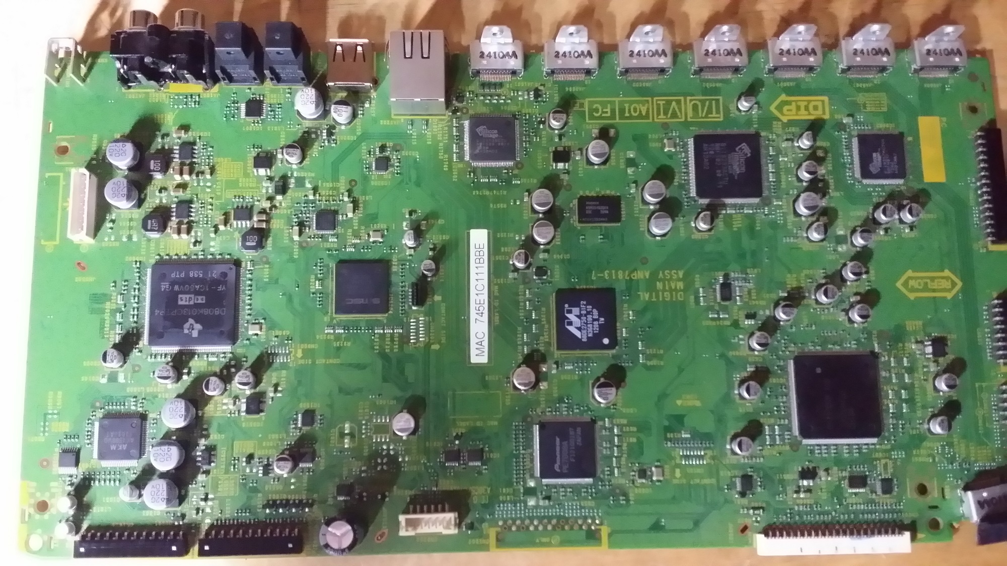

      Since you have the problem nailed down to one board, can we see both sides of it?

        Which are those ICs? IC9602 and IC903?
        I will take those pictures, when I get home.

                  I have almost screwed up IC1808. I have broke off somehow, pin #5. Luckily it is not used. I have created a short between pin #3&4, but those are all ground(luckily). It is hard to work, with such a small IC, next to a big Ethernet port.
                  I don't have a Leakseeker 89.
                  Last night I did not work on it, I had to repair Windows on my daughter's laptop(she is 8).
                  I took some quick phone pictures, though.
