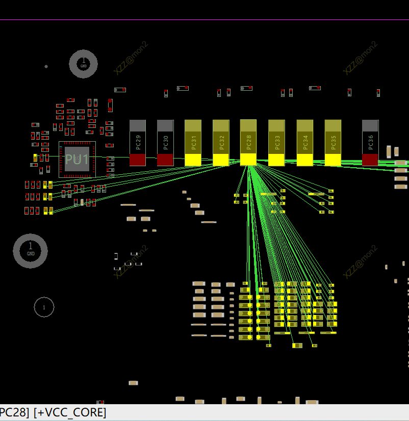

                Locate the VCORE caps as attached. Yellow tips of the parts are the VCORE rail.
                Measure the resistance from the source (1-2-3) mosfet pins you are referencing to these caps. What is the resistance? We are checking if there is a high side mosfet leak of the vcore power rail.

                  Done. From the source of the second dc-in mosfet to the highlighted caps in yellow it's the same 6 Ohms. The same caps relative to ground are 2.5 Ohms.
