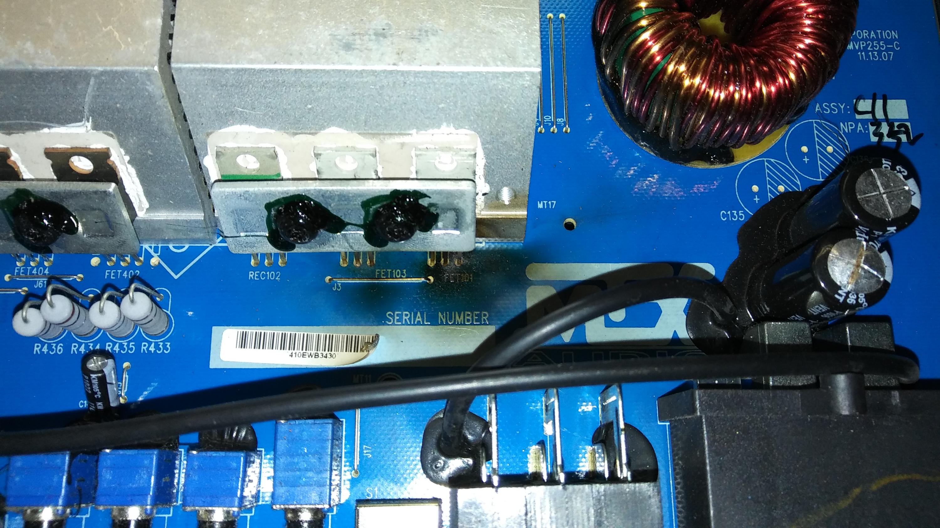

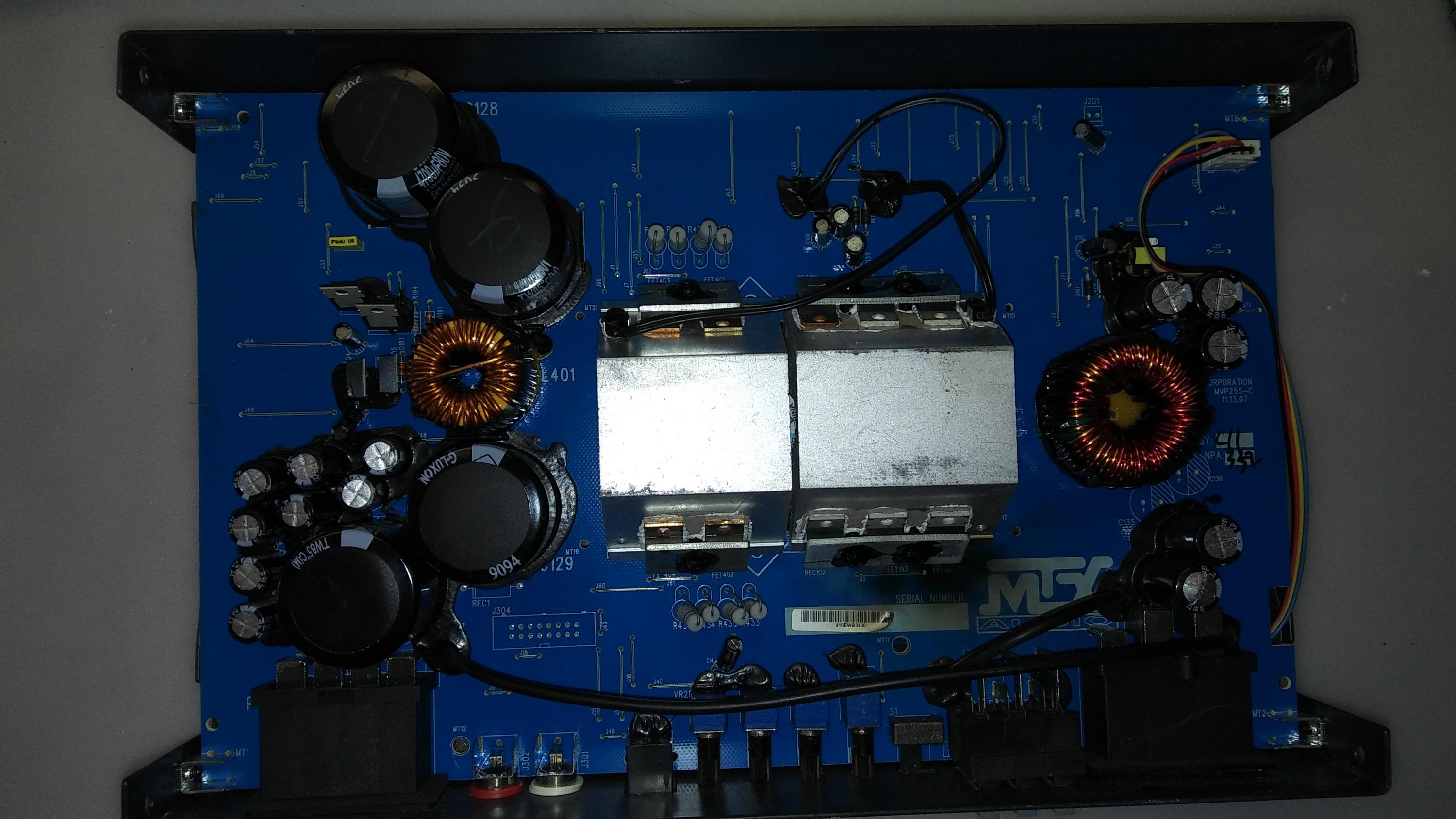

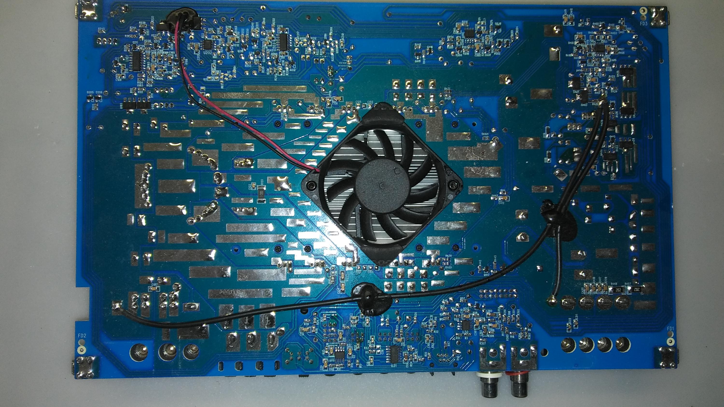

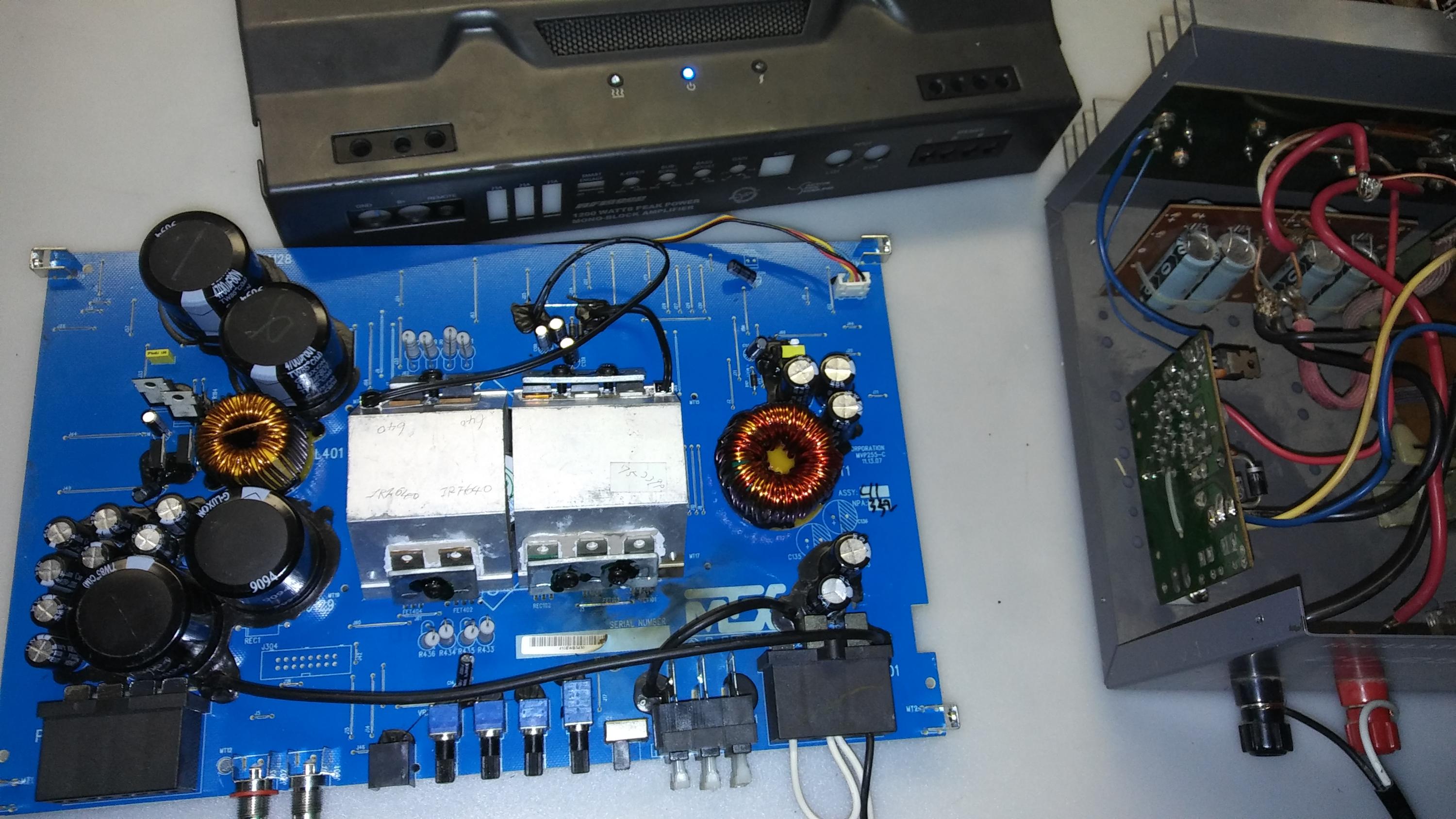

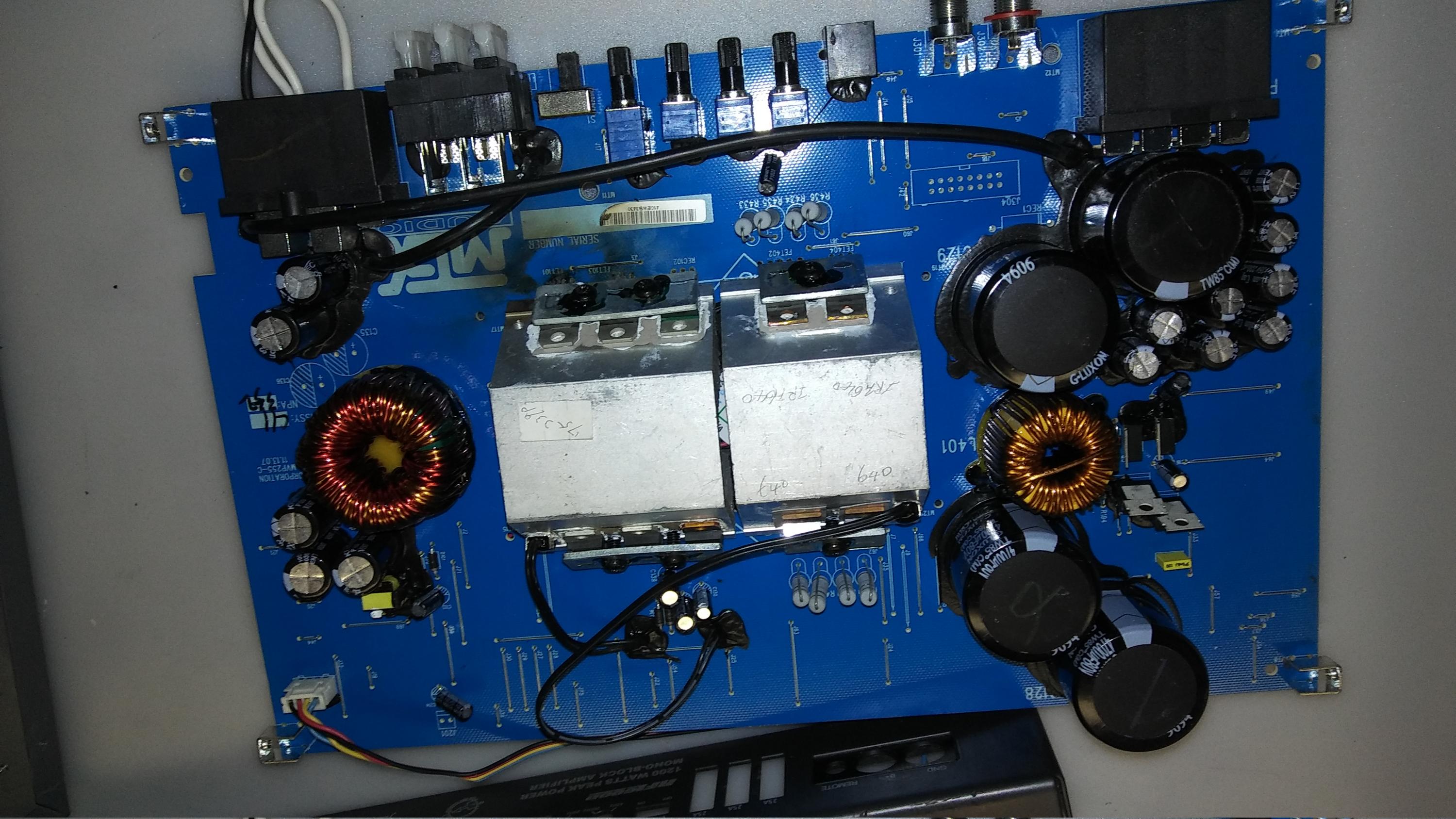

MTX RFL600D Class D Monoblock Amplifier repair.
  • capwizard
    • Jun 2016
    • 1991
    MTX RFL600D 1200W Max, RFL Series Class D Monoblock Amplifier, No sound. Two HUF75339p burned.
  • petehall347
    • Jan 2015
    • 4451
    • United Kingdom
    Re: MTX RFL600D Class D Monoblock Amplifier repair.
    and bad capacitors
    • capwizard
      • Jun 2016
      • 1991

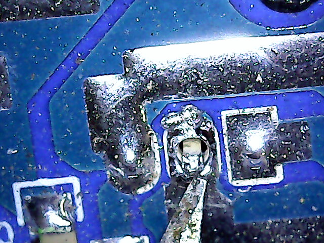

      and big bad connection. and Made in USA!
        Since the MOSFETs have the Drain connected together (the MOSFETs are connected in parallel, SOURCE are also tied together), when one does not make the connection, the one that is still connected will have all the current.
        • capwizard
          • Jun 2016
          • 1991
          After go through all the bad connections, change 4 x 75339, 4 x IRF640 and 470uf/63v capacitor. Yes it works.
          • Jaymay
            • May 2017
            • 2
            • United states
            Same problem here...the amp still holding up? At least what was replaced?
              • Jul 2011
              • 6070
              Good job
              You kept out of the land fill
