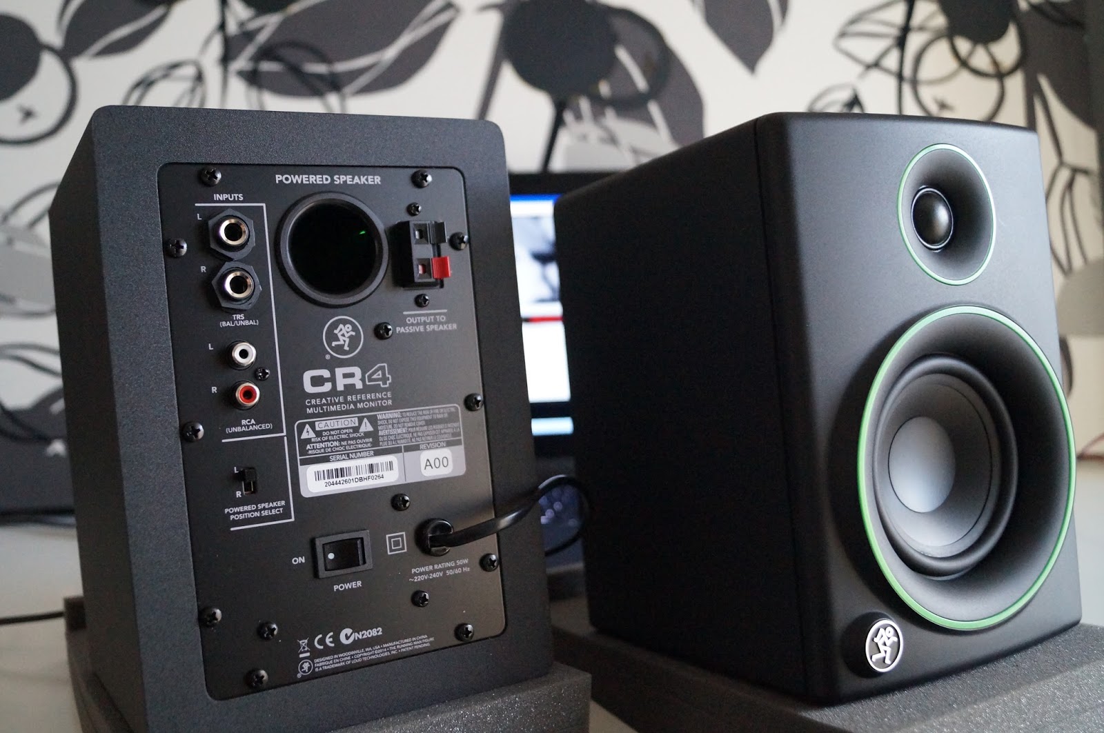

    If it would be of some assistance, here is the picture of the speakers/monitors. My version is for the European electric appliances standard, so its rated at 220-240V, 50Hz.

          I've edited your image. See the area enclosed by the yellow rectangle?
          Those two screws hold either the E-I transformer, or heatsink for the amp IC/module. Probably the transformer, which will remain warm anytime AC power is connected or switched on.

            Hi, thanks! That is exactly where most of the heat can be felt when touched. It is warm, but actually more towards hot. The previous poster mentioned that they are actually ON all the time. I read the original Owner's Manual twice and there is only one suggestion mentioned, instructing the user not to use the speakers near the heat source appliances. It also says that ambient temperature should not excede 40°C, although it is 22-24°C inside the room. I just want to keep them healthy and operational for the time to come, so that is the main purpose of this topic. Simple suggestions about how to keep their electronics in good shape through daily usage.

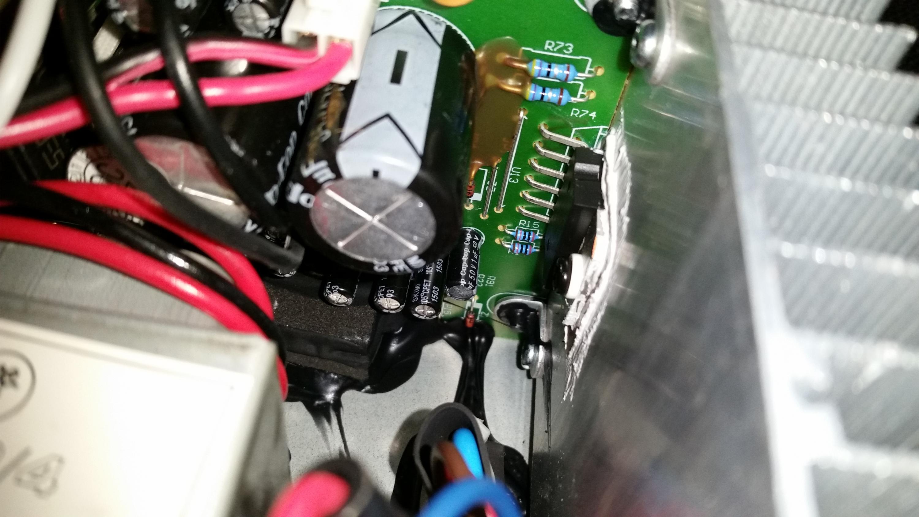

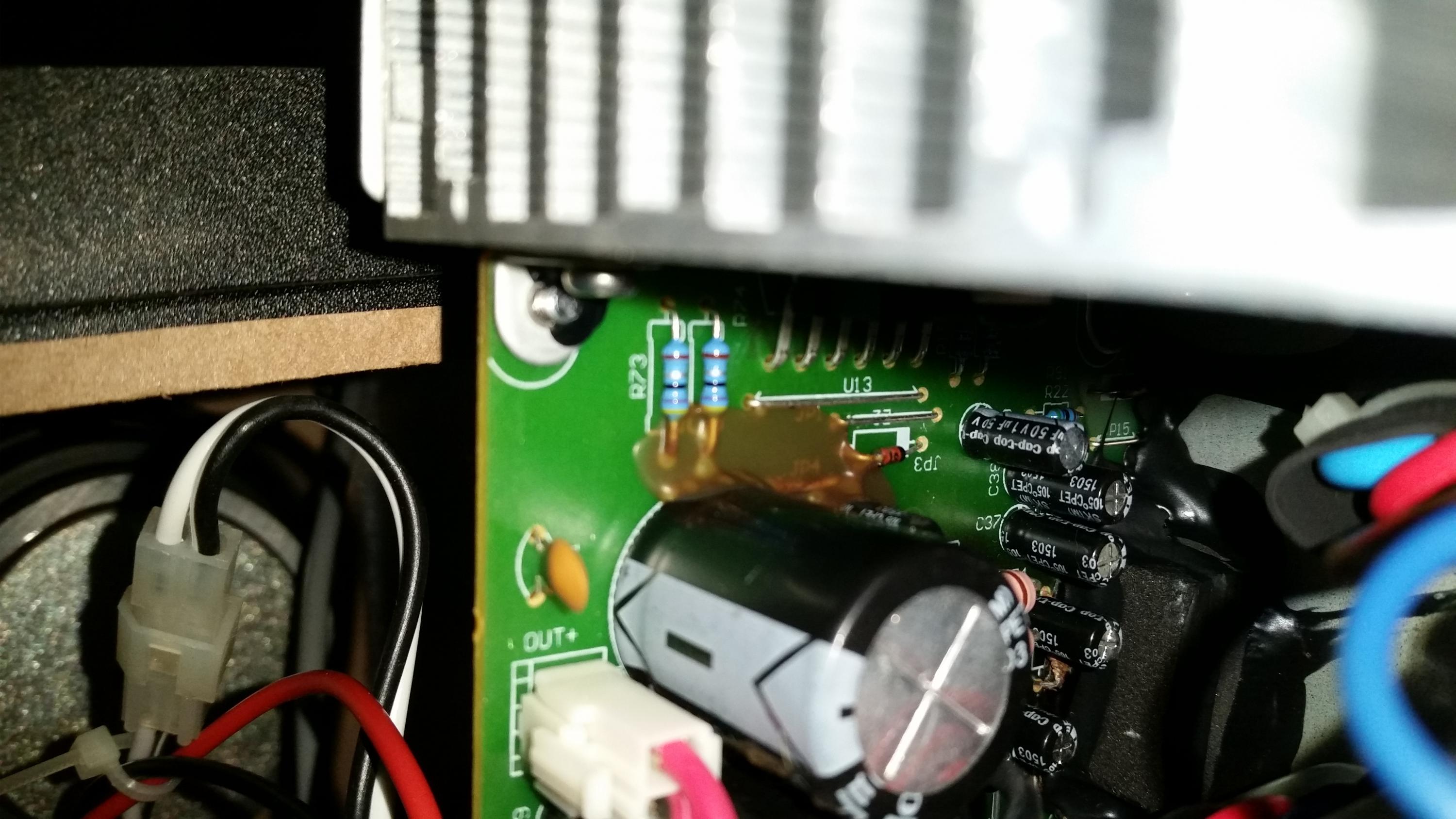

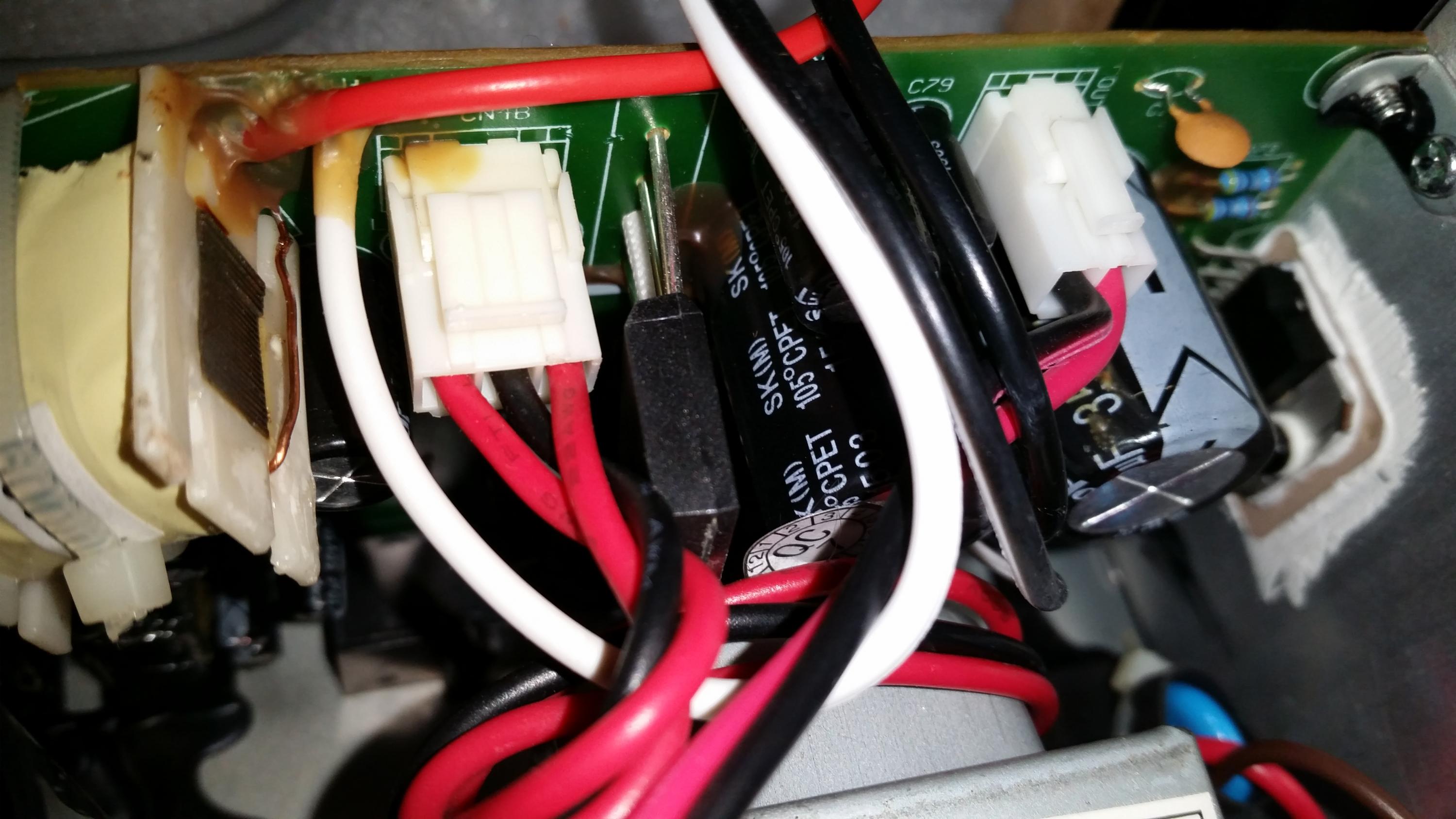

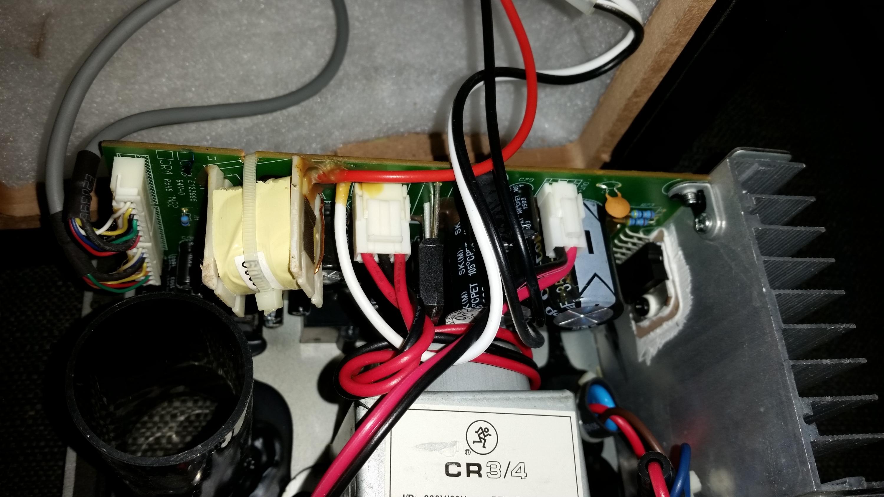

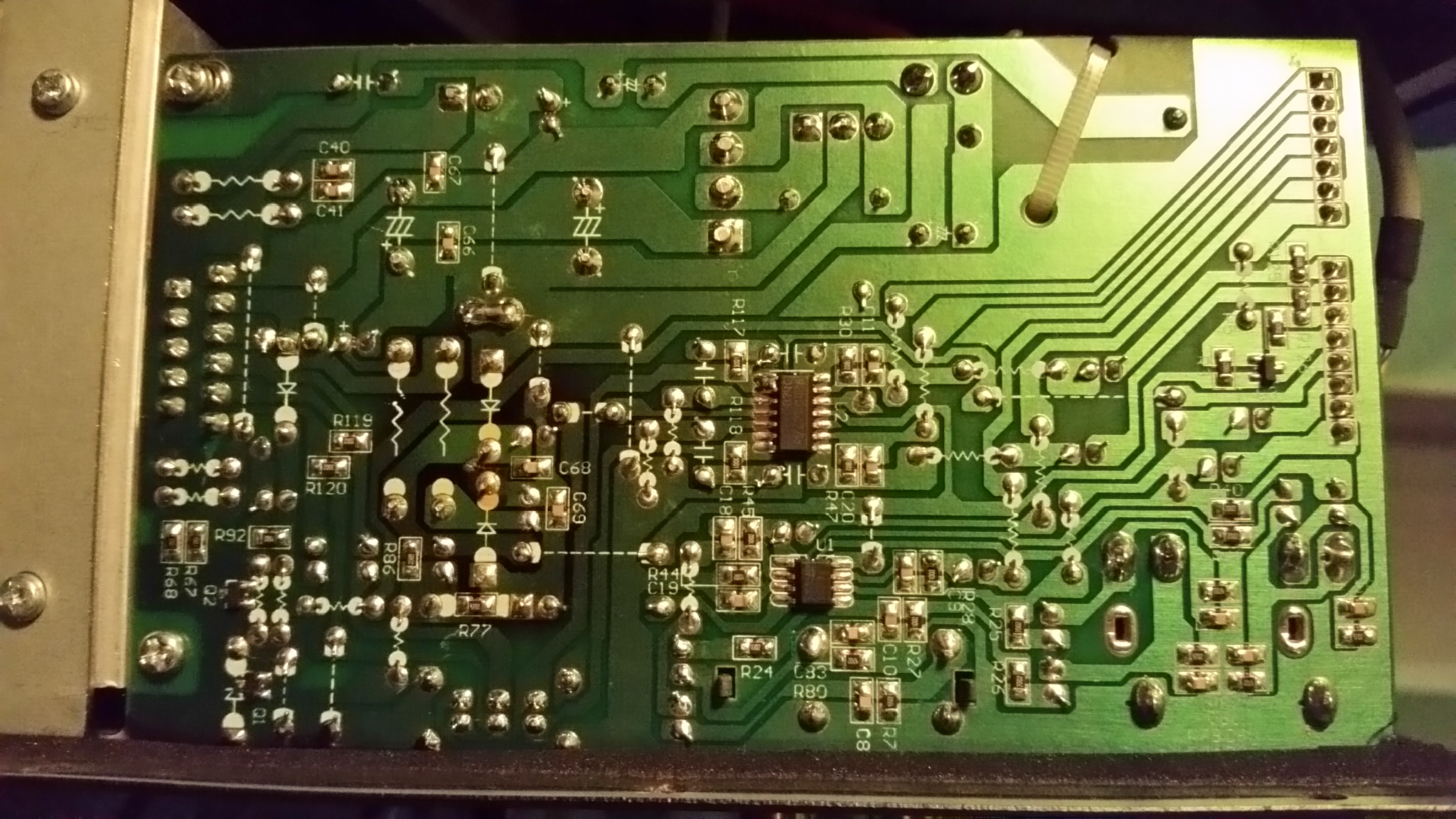

                                Ok, here are some images. I couldn't get a clear approach from the top of the board because everything is so tight in there.
                                Hopefully, you will be able to spot the area of suspect. :-)

                                  Guys, here is some new development. This afternoon I took the time and removed the power supply as it was blocking the view over the board. To my horror, I found a completely corroded and snapped diode (image). One of its leads was completely turned into corroded powder. I can't really make out the markings on what has left of it, but it looks like "41". The diode was mounted in the now empty space on the board. The board is slightly blackened in that area, that power supply must be producing a lot of heat. All the caps visually look normal. There is still some corrosion left beside the black rectangular box that you can see in the image (it's the left/right speaker position select switch), but it's very inaccessible to clean. I cleaned everything I could (image), but I will try to completely remove all the remnants of that corrosive gunk.
                                  If you look at the attachment (20190704_172813.jpg) from my previous post, the problematic diode was soldered where the R77 marking is (right side of the image, lower mid). The R77 resistor lies exactly "between" the diode solder contacts.
                                  Can this little diode be the cause of the intermittent noise, because everything else was working properly on the speakers?
                                  If you have any idea what exactly type of a diode it is, please let me know so I can replace it and see if there is any change. I guess the other two diodes in the vicinity are identical, but I can't make out the markings on them.

                                    That's pretty consistent with the photos from the link you listed a couple posts above.
                                    That zener diode and its pair (Z4), along with those two fatter resistors, burn off perhaps a bit too much power, to make the +/-15v(ish) to power the opamps, from the main power rails for the amp chip.
                                    In an ideal case, you'd wanna remove those two resistors and the remaining Z4, and power the line-level circuitry from a (dual) bench power supply, noting the current draw, and then recalculate the resistors and beef up the zeners (ie. their power rating; those glass ones are 0.5W tops).

                                        Re: Mackie CR4 monitors
                                        Bad brown corrosive and conductive glue strikes again.
