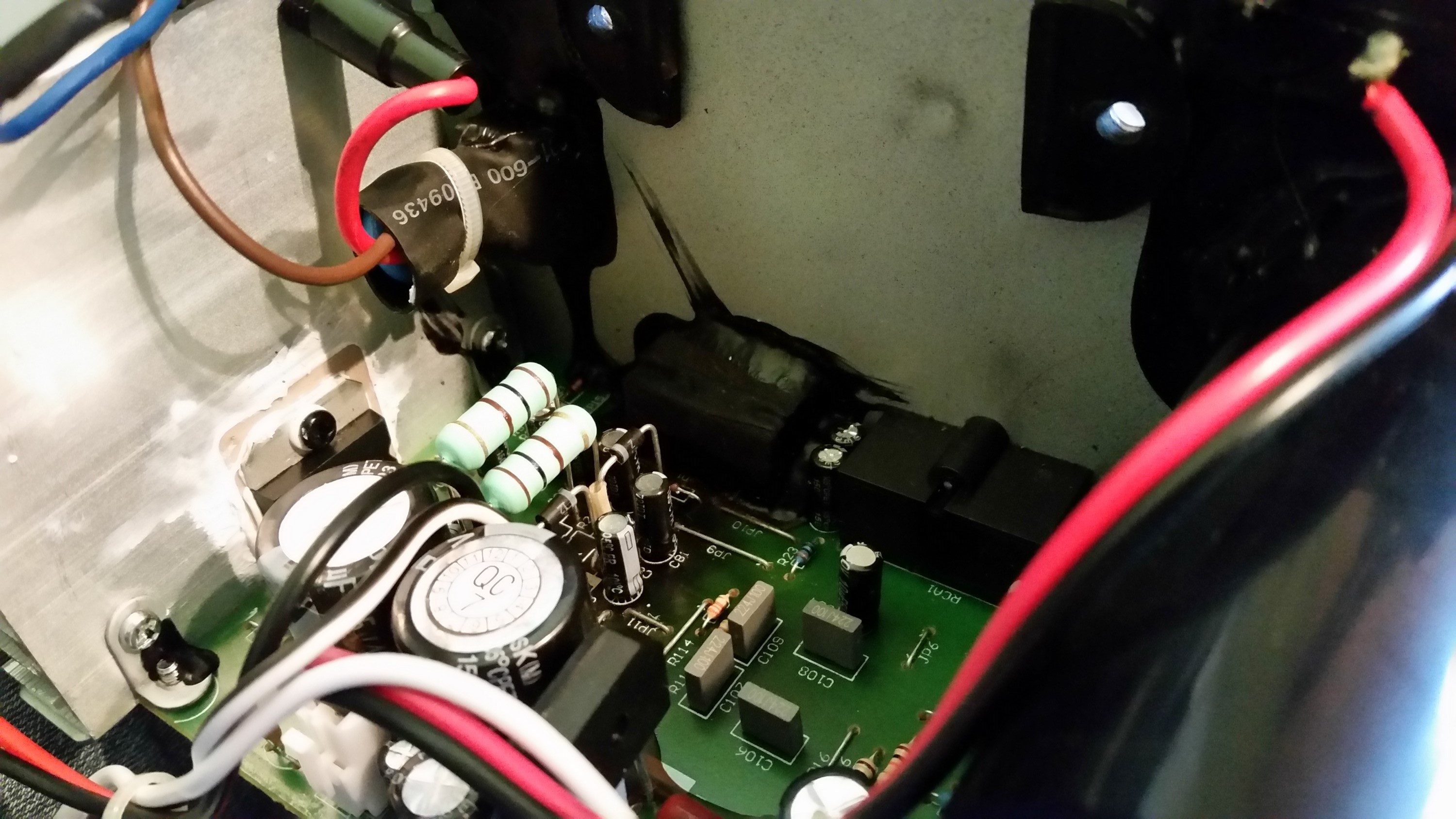

              Well, here is an update:
              I managed to find a 1N4742A alternative in the form of a ZY12 (12V zener 1.3W) diode in a local hardware shop. I also found wirewound 100 ohm 5W resistors. And I used Panasonic FR series 50V47uG and 16V100uF capacitors to teplace the dead ones.
              Now, I did not solder the diodes and resistors facing/near the board. I actually positioned them in a cascading manner. Looking from the bottom, the highest mounted comes the R1, then R2 5mm bellow it, then come the Z3 and Z4 diodes just bellow the R2 - but everything is above the two capacitors. Now, when the board is its normal upright position, the heat from both components will have a direct and unobstructed space to escape upwards. Hopefully, this will prolong the life of the present capacitors. Also, the slightly beefier components should not generate too much heat. And, by distancing the components from the PCB and letting the heat escape more efficiently, the PCB and the speakers should have their lifespan prolonged a bit.
              Anyway, after the repair, the speakers now work great, zero cracking and popping, and the back plate is now barely warm to the touch, compared to the previous state when it would get hot after 10 minutes or so. I will continue to monitor the monitors.
              Hopefully, someone will benefit from this experience as there are a lot of people getting disappointed in these otherwise great little speakers.

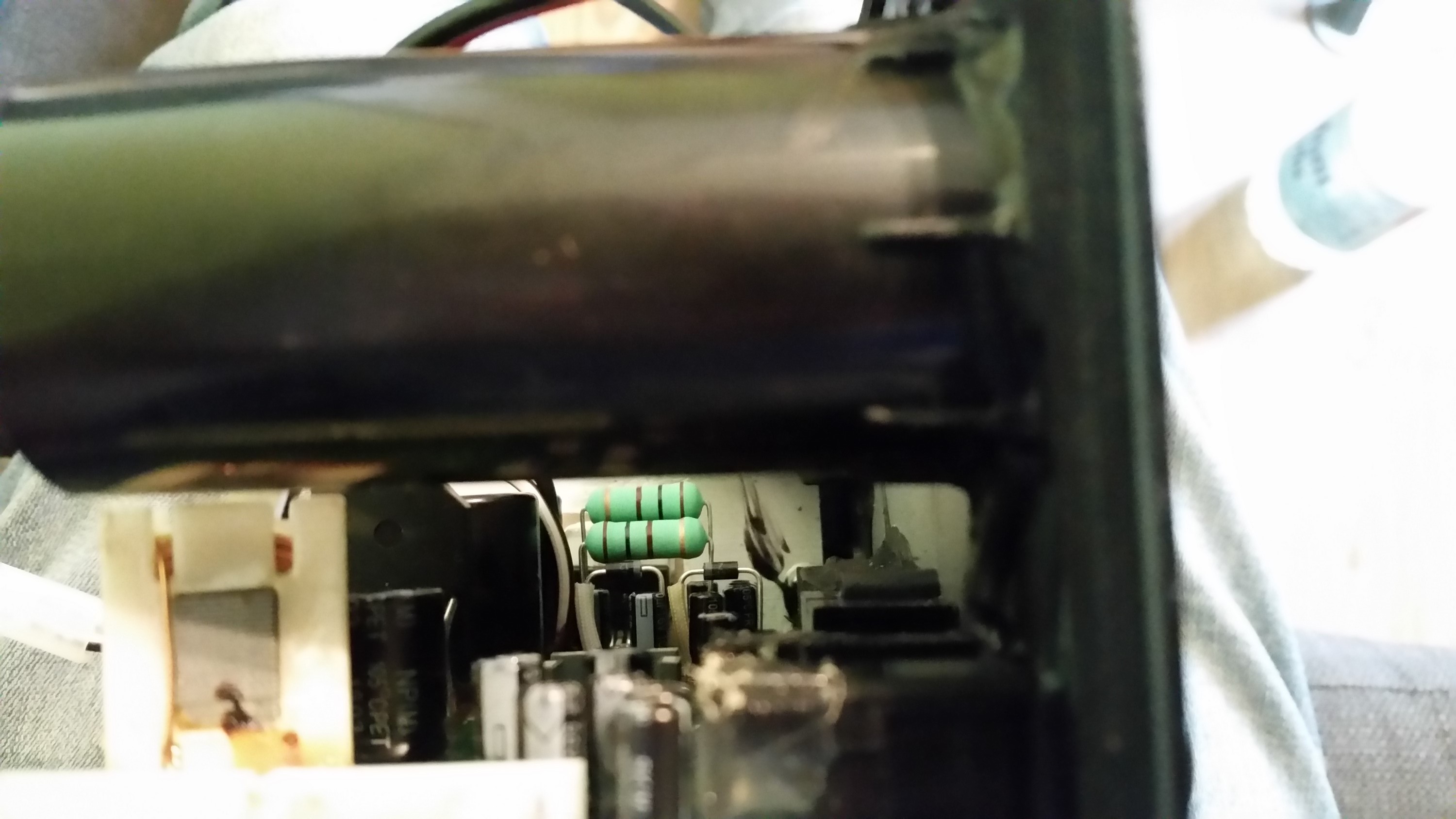

                    OK, here are a few images showing what I did. The components are mounted in a cascading fashion, so the heat release is not being directly blocked by other components (when viewing, the improvised schematics should be envisioned 90 degrees rotated counterclockwise to get the actual orientation):
                    (R1) ===>
                    | (R2) ===> heat goes upward
                    | | Z3/Z4 =>
                    ===============PCB
                    Total capacitors replaced:
                    3x 16V100uF CapTop SK replaced with Panasonnic FR 16V100uF
                    2x 10V220uF CapTop SK replaced with Panasonnic FR 16V220uF
                    1x 50V10uF CapTop SK replaced with Panasonnic FR 50V10uF
                    2x 50V47uF CapTop SK replaced with Panasonnic FR 50V47uF
                    Now, the original 50V47uF and 50V10uF capacitors measured OK, but because they were very close to the hot area, I replaced them anyway. The two 10V220uF measured almost 390uF, which is way off their rated value.
                    Now, upon longer testing, the back plate of the right speaker does get quite warm but only after several hours of non-stop operation and playing audio. I am still considering taking out the power transformer and mounting it externally in a separated case or alike, and then extending the wires to the speaker. It might actually be done in a "plug-in" fashion so that the power source can completely be separated from the backlplate if necessary. This would definitively take some heat away from the right speaker and the PCB.
                    But, after the repair so far, the speaker have definitively stopped clicking, crackling and cutting out.
                    What are your views/opinions/thoughts on the work so far?
