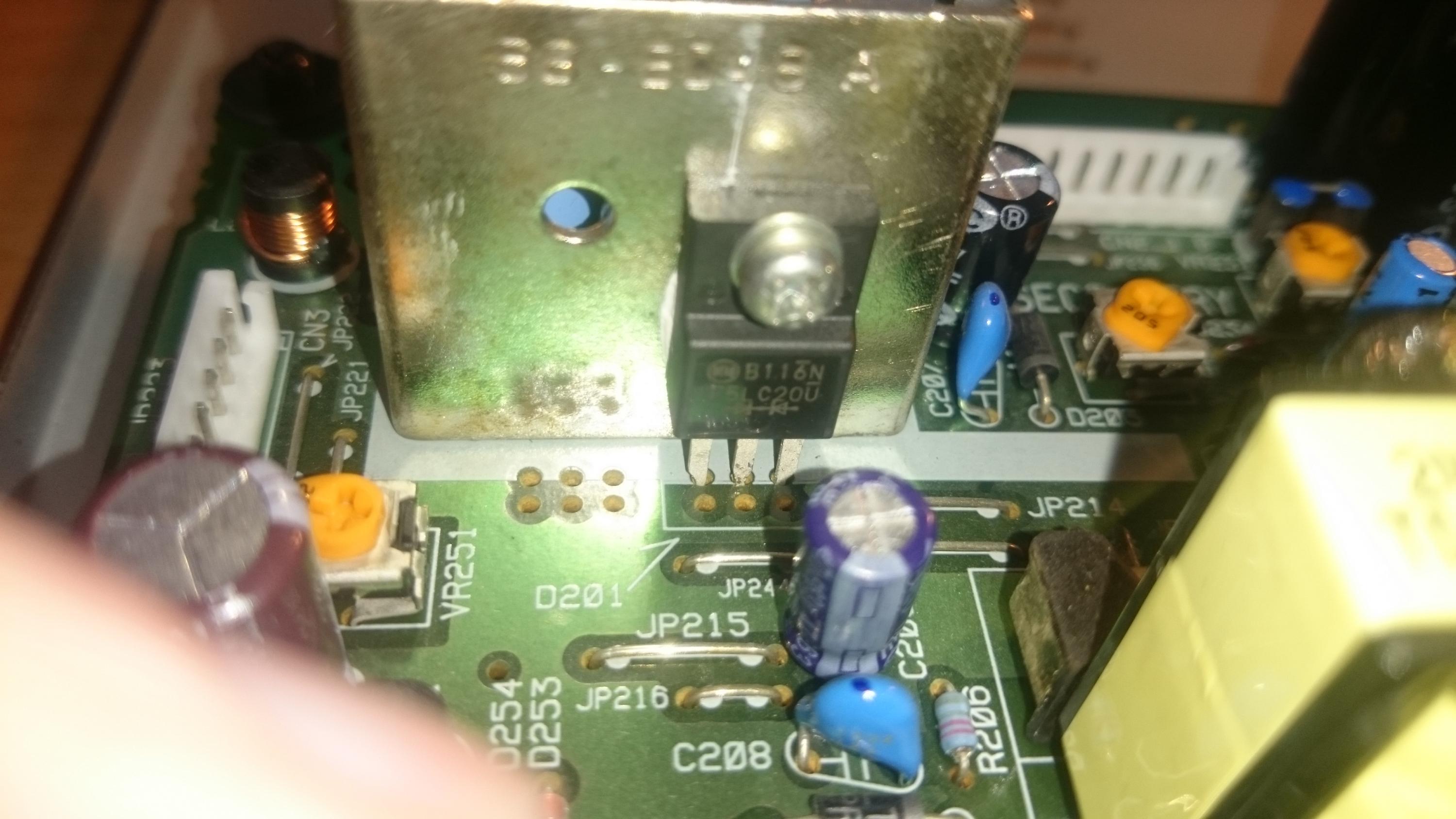

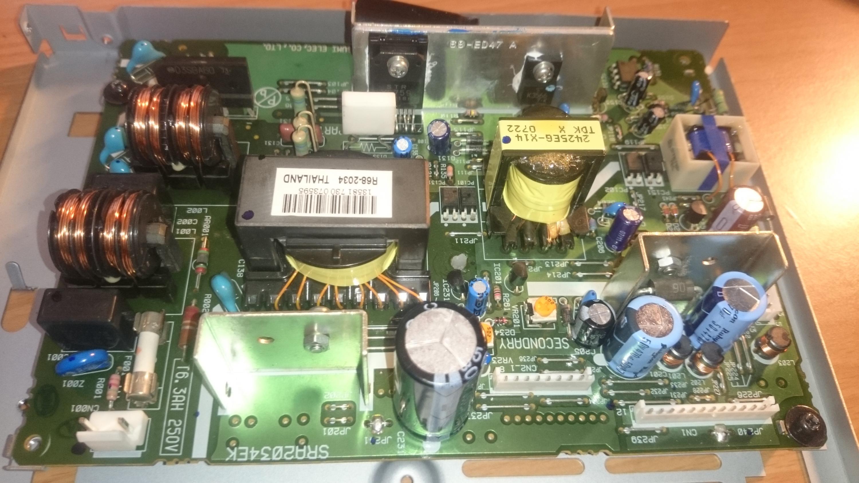

          On page 30 of the SM there's a (low-res) photo of the power supply. The MIP2C10MP is on the bottom left, and i guess it controls that smallest transformer. The STR-X6759 is around the middle-bottom of the board, and most likely drives the biggest transformer.
          But what's that other TO220-cased component, on the same heatsink as the STR-X6759? It looks like a FET driving that middle transformer, but is there some chip controlling it? Or is it somehow synchronously driven from the STR-X6759?

              Also take note of the markings on that smaller FET(?), and whatever chips might be on the bottom of the board

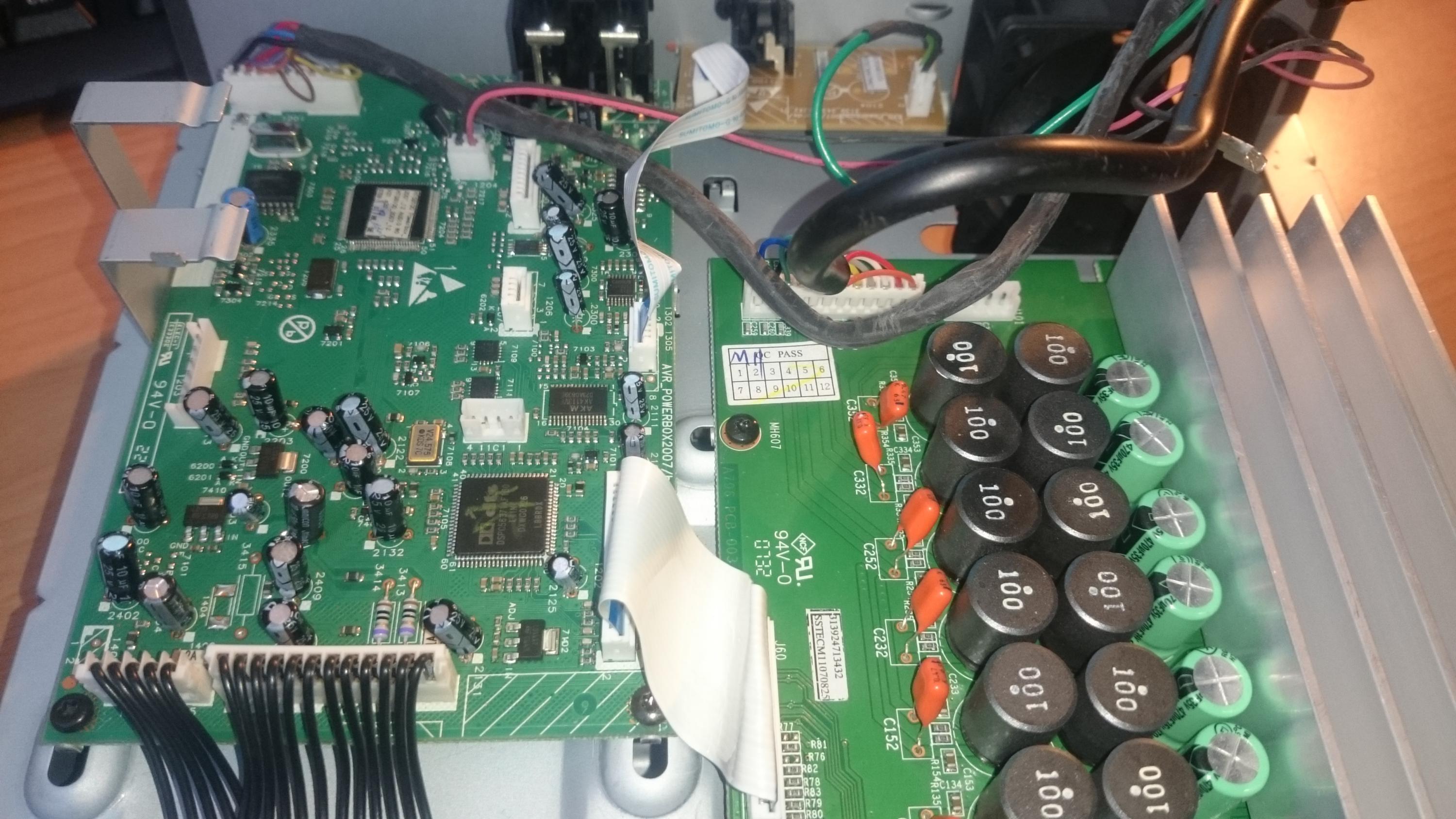

                    Re: Philips HTS8100 , lower stand by.
                    Here are the pictures.
                    Diodes are all looking ok. Nothing short in circuit.
                    Maybe the psu is ok?

                      A 2A fuse on the mainboard is OL. First picture , behind the first connector. I'll replace that 1. So stupid i didnt see it. haha

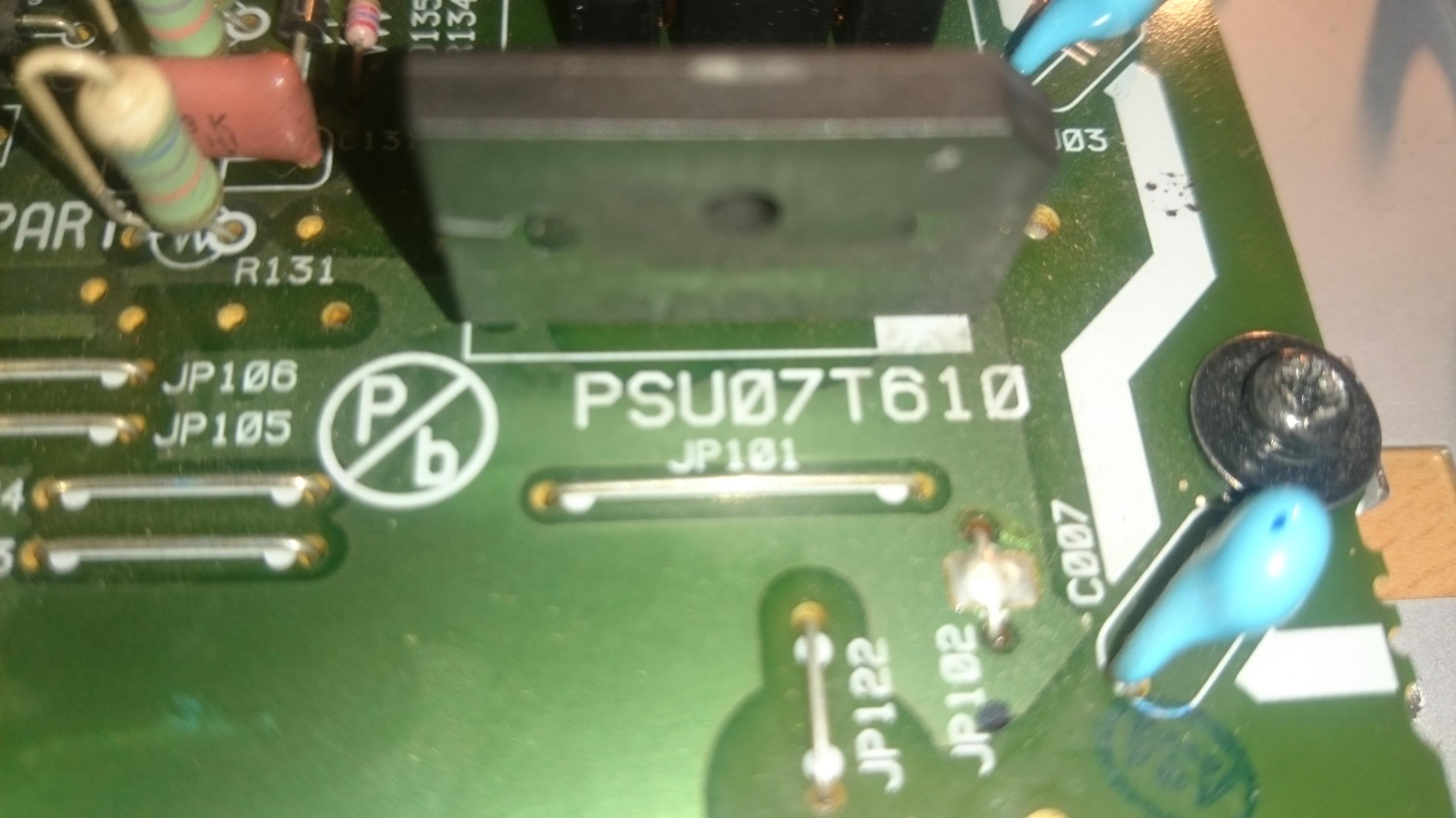

                              Some photos of the bottom of the psu board would be welcome.
                              Other than that, though, you might consider checking the in / out voltages of those SOT223-cased regulators, on the subwoofer signal board.
                              On the block-diagram of the "power box" in the service manual, i see a cable with 4 signals (so a minimum of 5 wires) going to the "center unit". One is "Wake_UP, and another one is "CU_DET". Check to see if the 12v and 5v that are supposed to be going there, actually reach the center unit. The 5v should definitely be active; the 12v might only be there when the whole thing's out of stand-by.
