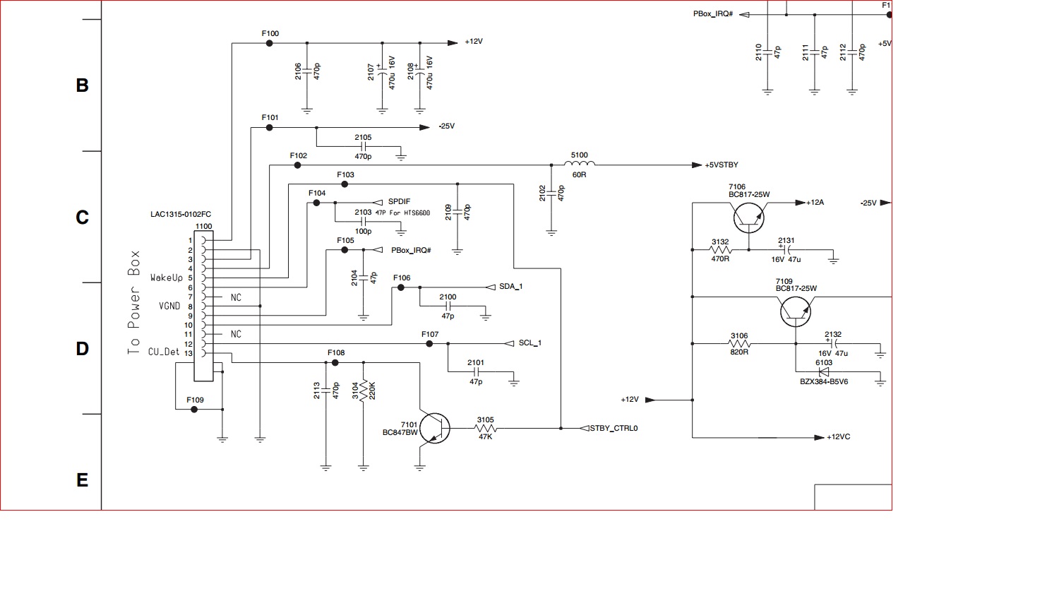

    Of course, it would be pretty fabulous if we had any idea what those voltages are supposed to be, normally...
    That's the connector coming from the power supply, right? And that 5-pin one is the one going to the central unit, perhaps? If that's the case, the two power tracks going from the 9pin connector to the 5pin one should be 12VL, +5V_ever and (obviously) ground.

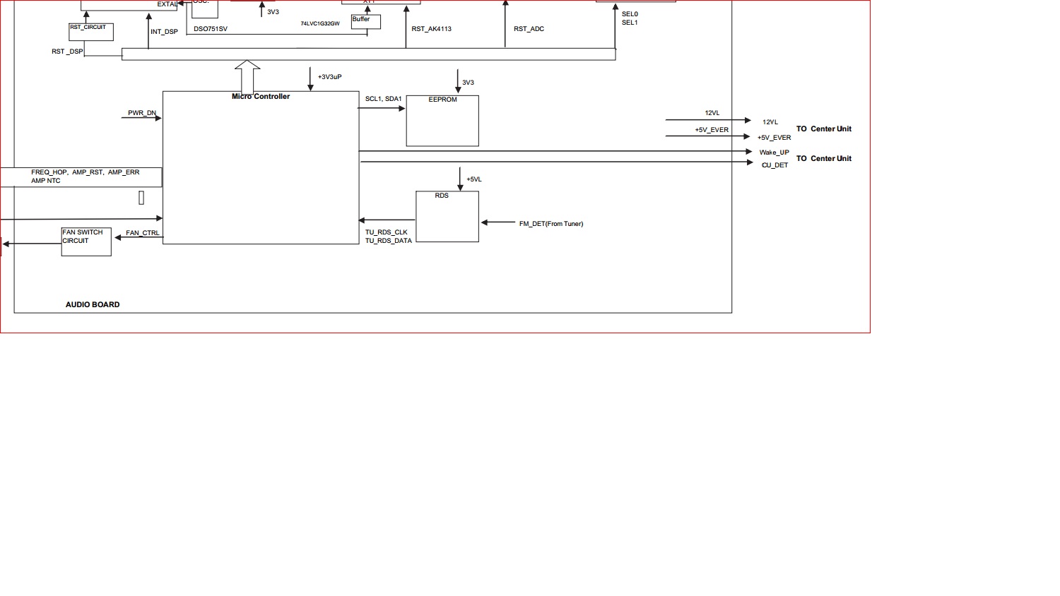

    Lemme just list the voltages from that block diagram, and see if we can figure out which goes where...
    12VL - pin8 (kinda sounds like some stand-by voltage to me)
    +5VL - pin2 / pin7
    -33V - pin6 (although the value's a tad low)
    -12VA -
    +12VA -
    GND - pin9
    GNDA - pin4
    Stby_PB - pin3
    5V_ever - pin2 / pin7
    Pwr_Dn - pin1
    Wait, that's 10 signals... If they're mentioned separately on that arrow, i'd reckon GND and GNDA are NOT joined on the psu board. Hmm....
    It shouldn't be TOO difficult to follow the tracks from the rectifier diodes on the secondary, to the output connectors. Those two blue Rubycon caps are quite definitely on the +/-VCC rails going to the amp board, so you can skip those.
    <EDIT> I count 12 wires on that connector - which ones have you "skipped"?
    PS: there are no clear top-down pictures of the "subwoofer DSP board", so connector names / designations don't really mean much

      Im sorry , bad communication from my side!
      The 12 pin black/white connector coming from the psu has no voltages except pin 10 --> 5.3V
      The 5 pin black/white connector has the following voltages
      Pin 1 : 5v
      Pin 2 :12v
      Pin 3 : 0v
      Pin 4 : 5.3v
      Pin 5 : -27v
      Other connector from the psu to the subwoofer board ( board with heatsink ) has voltages which are 5 / 12 and 32V
      Hope his helps!

          Ok, now it's getting confusing... On the power supply board, i see two connectors: one with 12 pins, and one with 8 pins (it's even written on the board).
          I can only assume the 12pin one is going to the dsp board.

            There are 3 connectors on the PSU board. If you look at the picture you will see the 2 connectors , 12 and 8 pin. Other connector is on the righthand side.
            8 pin connector is going to the small subwoofer board with heatsink. It has 5/12/32v
            12 pin connector is going to the AV board , it has no voltages on it.
            5 pin connector coming from the PSU is also going to the AV board and has these voltages :
            Pin 1 : 5v
            Pin 2 :12v
            Pin 3 : 0v
            Pin 4 : 5.3v
            Pin 5 : -27v
            Hope its more clear now!!

                  Just looking at this block diagram in the SM. 12 + 5V is going to the center unit because i measure that at the connector.
                  Maybe the microcontroller is not sending the "wake up" signal?
                  Or there is a problem on the wake up signal going to CU-DET? I'll measure when i get home!

                    The soundbar is working again! Got a nice blue light but lcd is very faint. Thats probably a capacitor problem which i will fix later on.
                    The reason it still did not work even though the voltages were present was because it needs the sub connected to the soundbar to actually work.
                    Im going to test the soundbar first....
