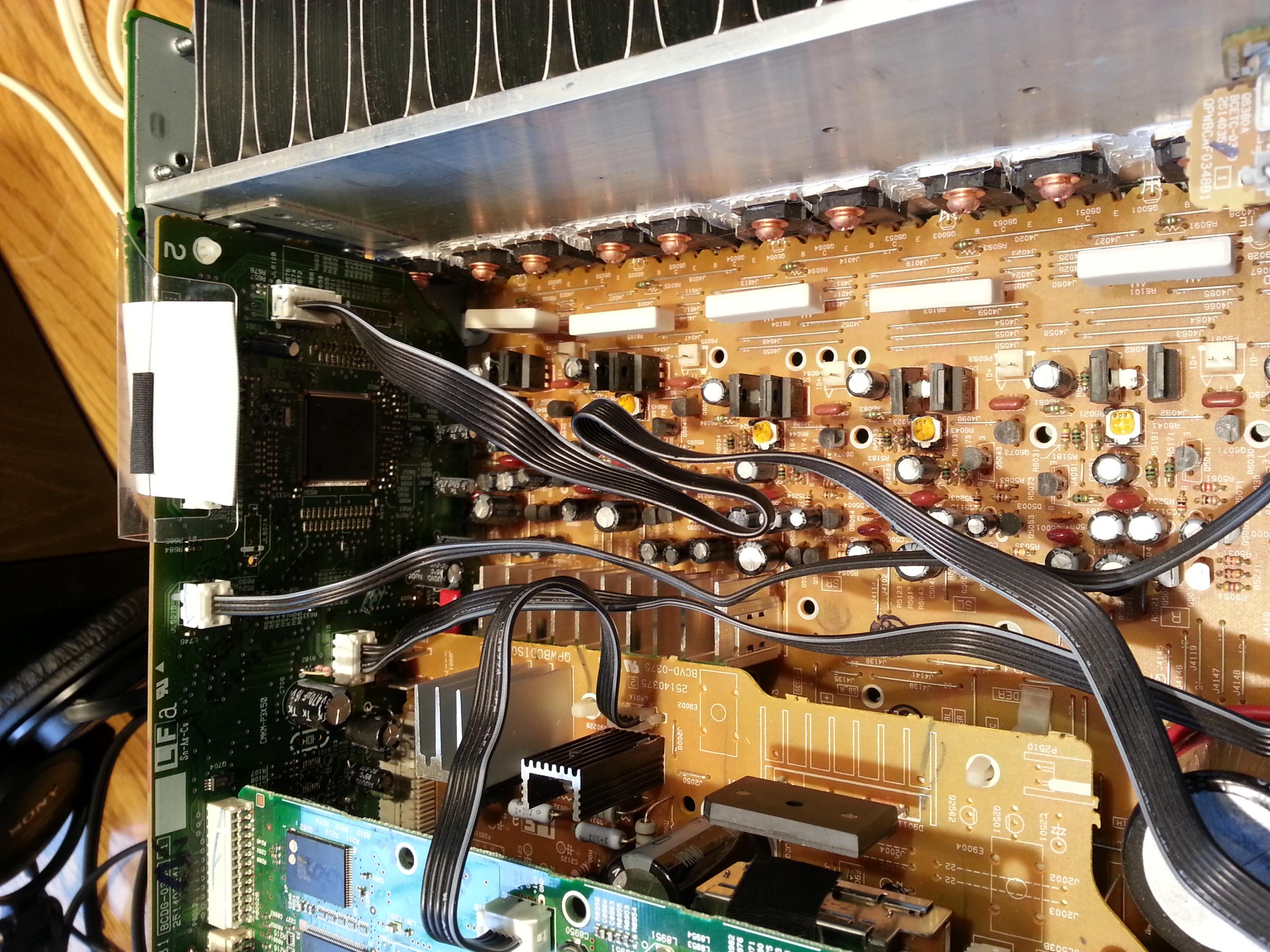

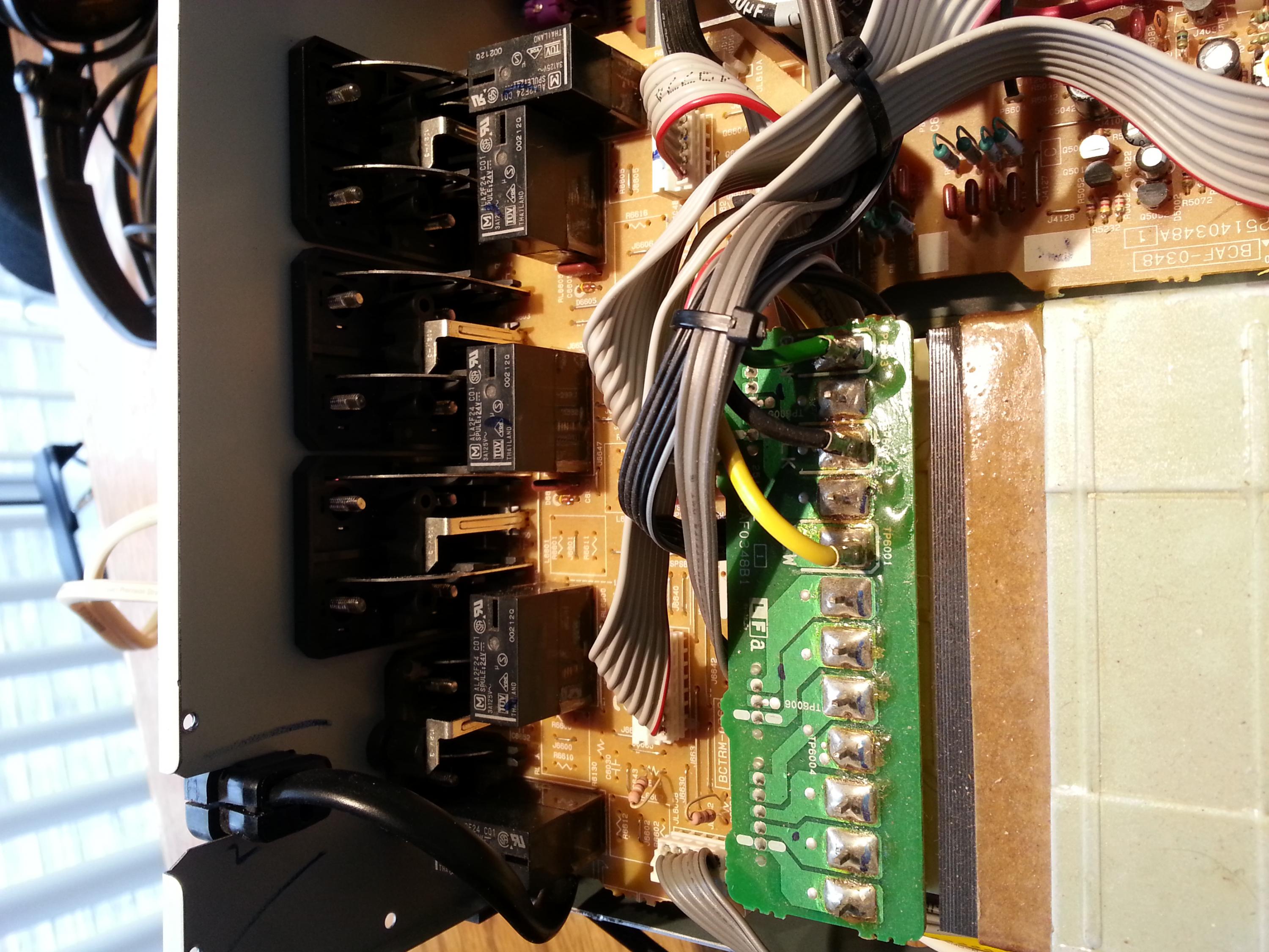

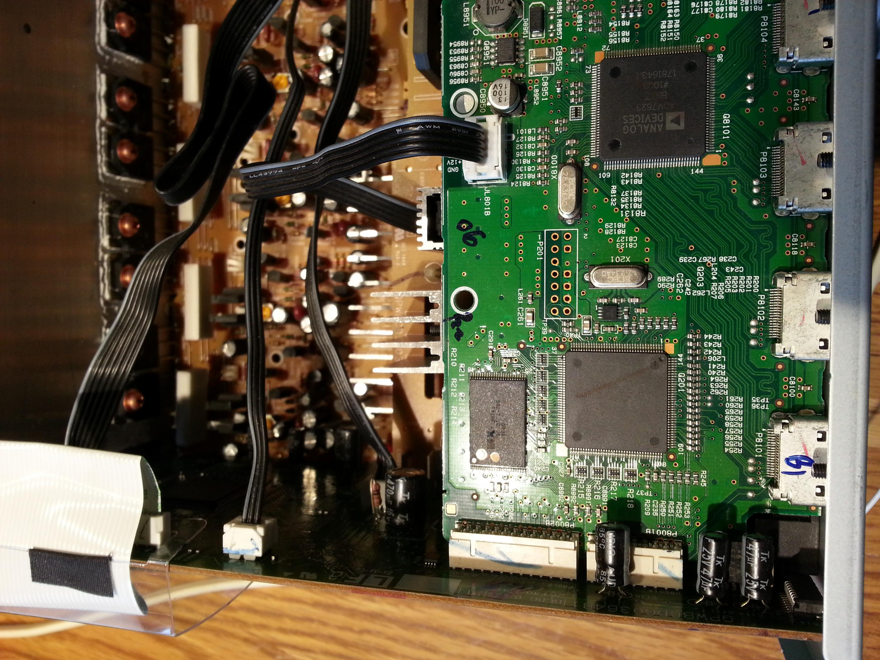

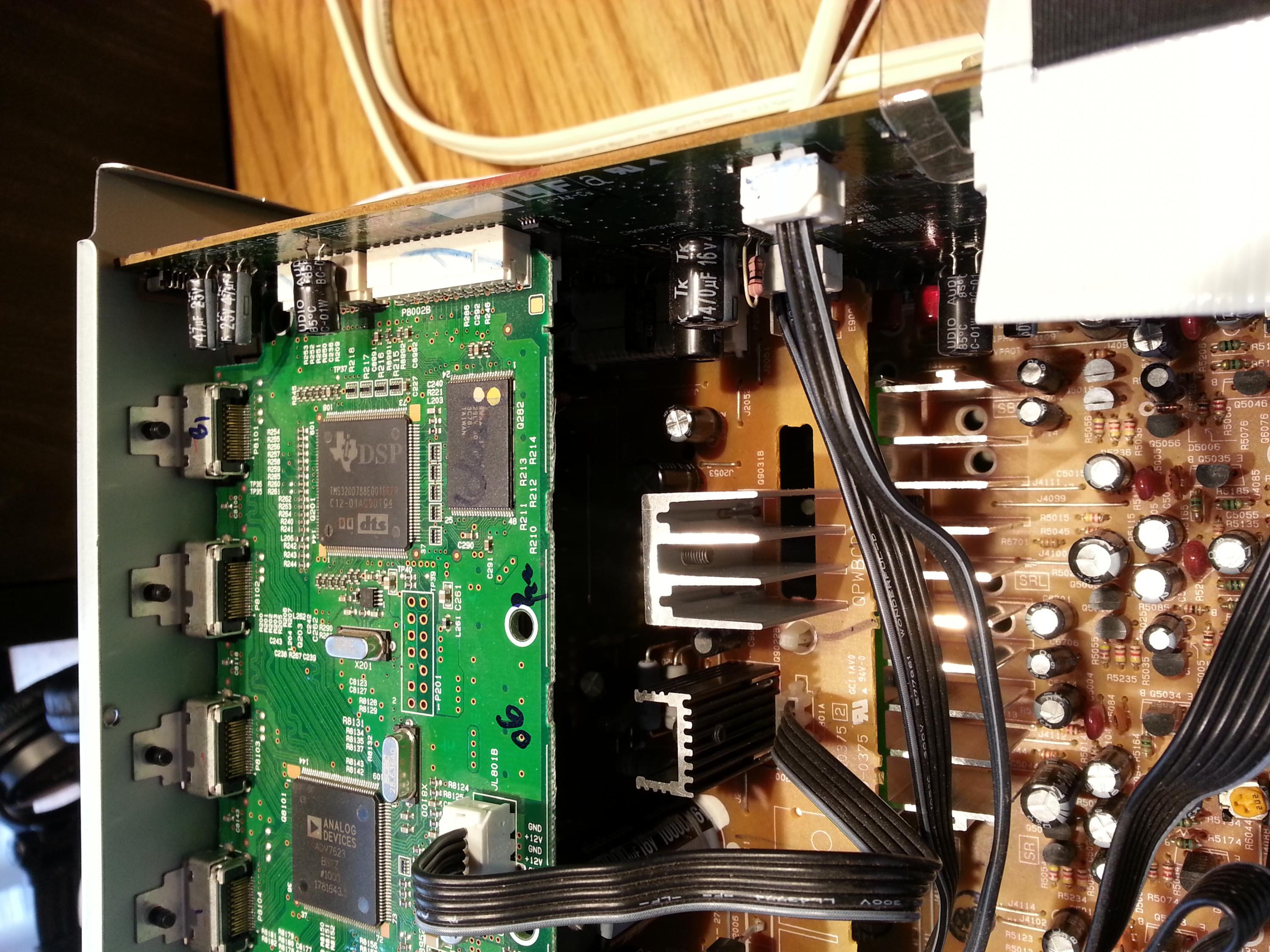

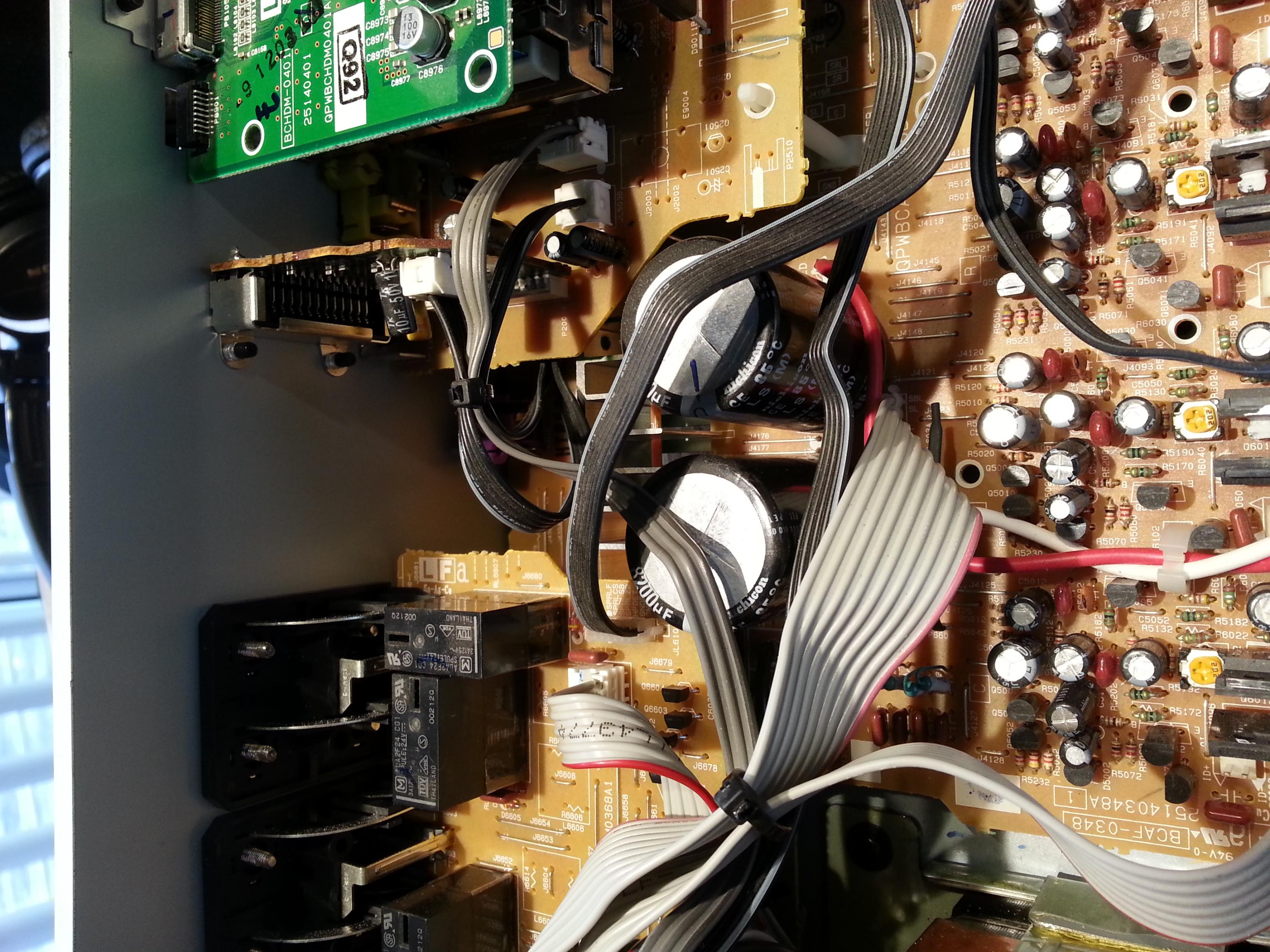

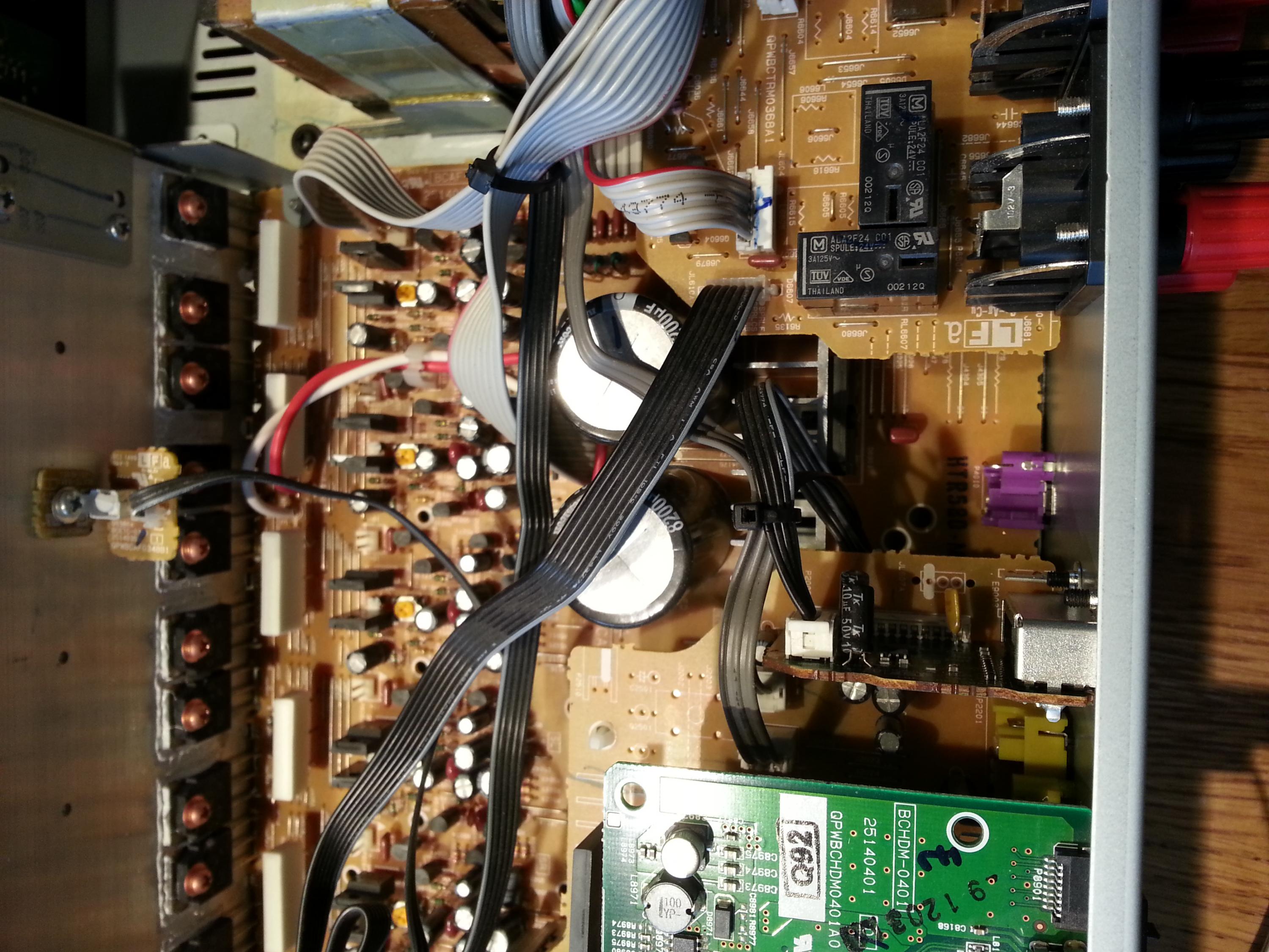

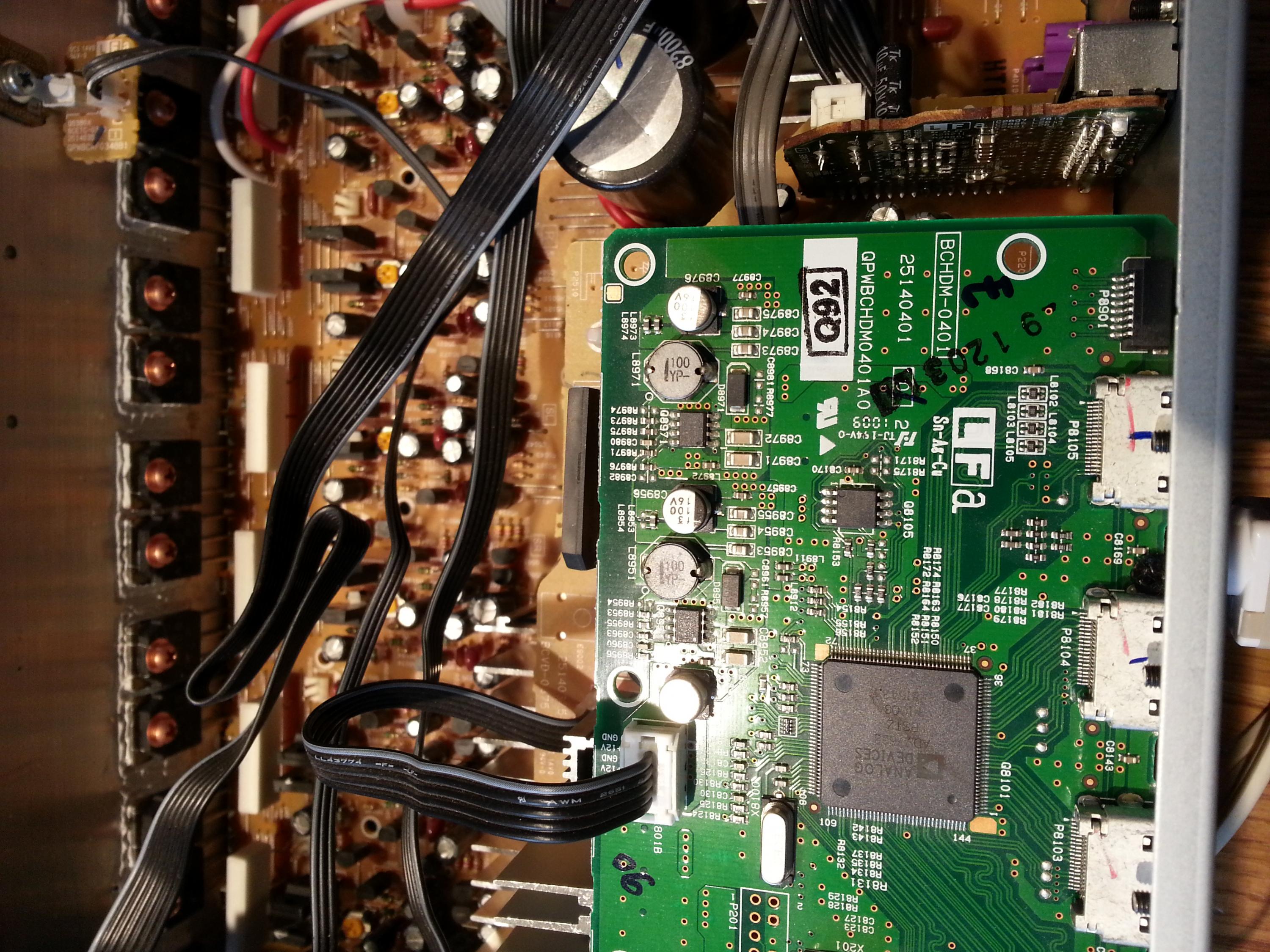

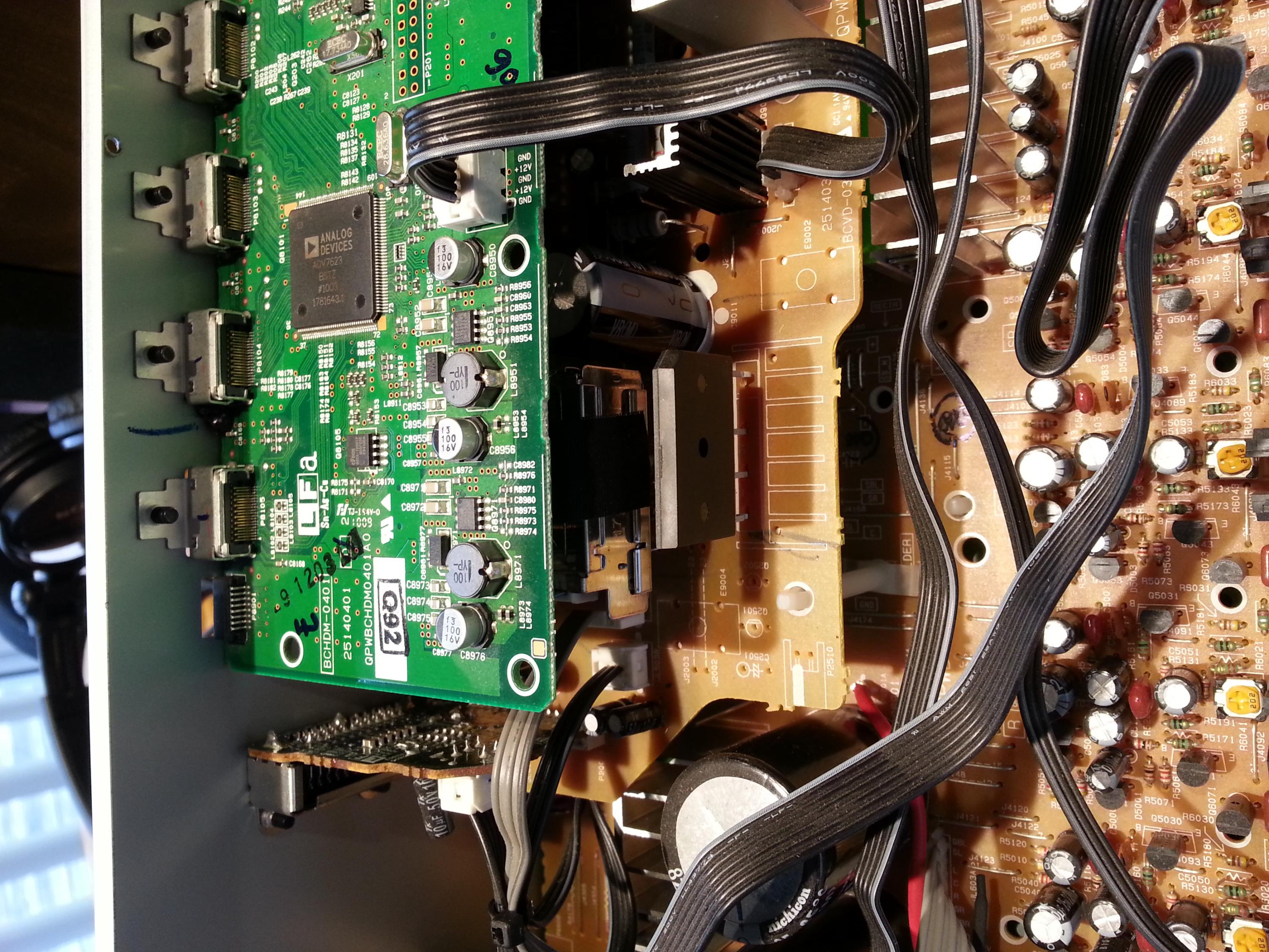

                    • harleyman58
                      • Feb 2016
                      • 89
                      • usa
                      Re: onkyo ht-r580
                      pictures inside of 580
                      • Khron
                        • Sep 2006
                        • 1350
                        • Finland
                        Re: onkyo ht-r580
                        If the relays do click, and SOME signal does end up in the speakers, then it should be reasonably safe to assume that whatever issue is present, is before the power amps.
                        If there was some power amp problem (DC on the output, or some short in the output transistors), some protection would've triggered, and the output relays wouldn't have clicked on.
                        See my post #7.
