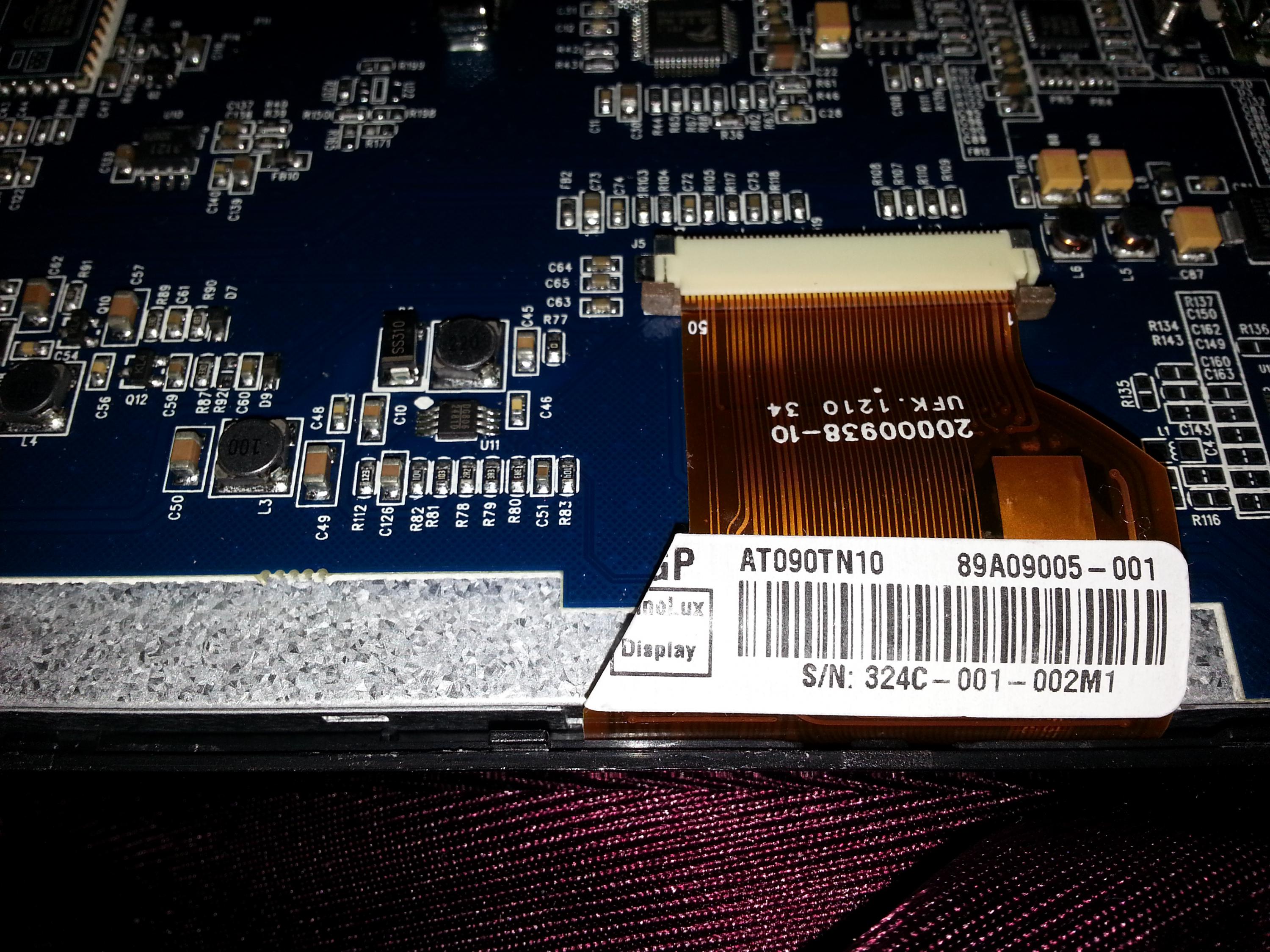

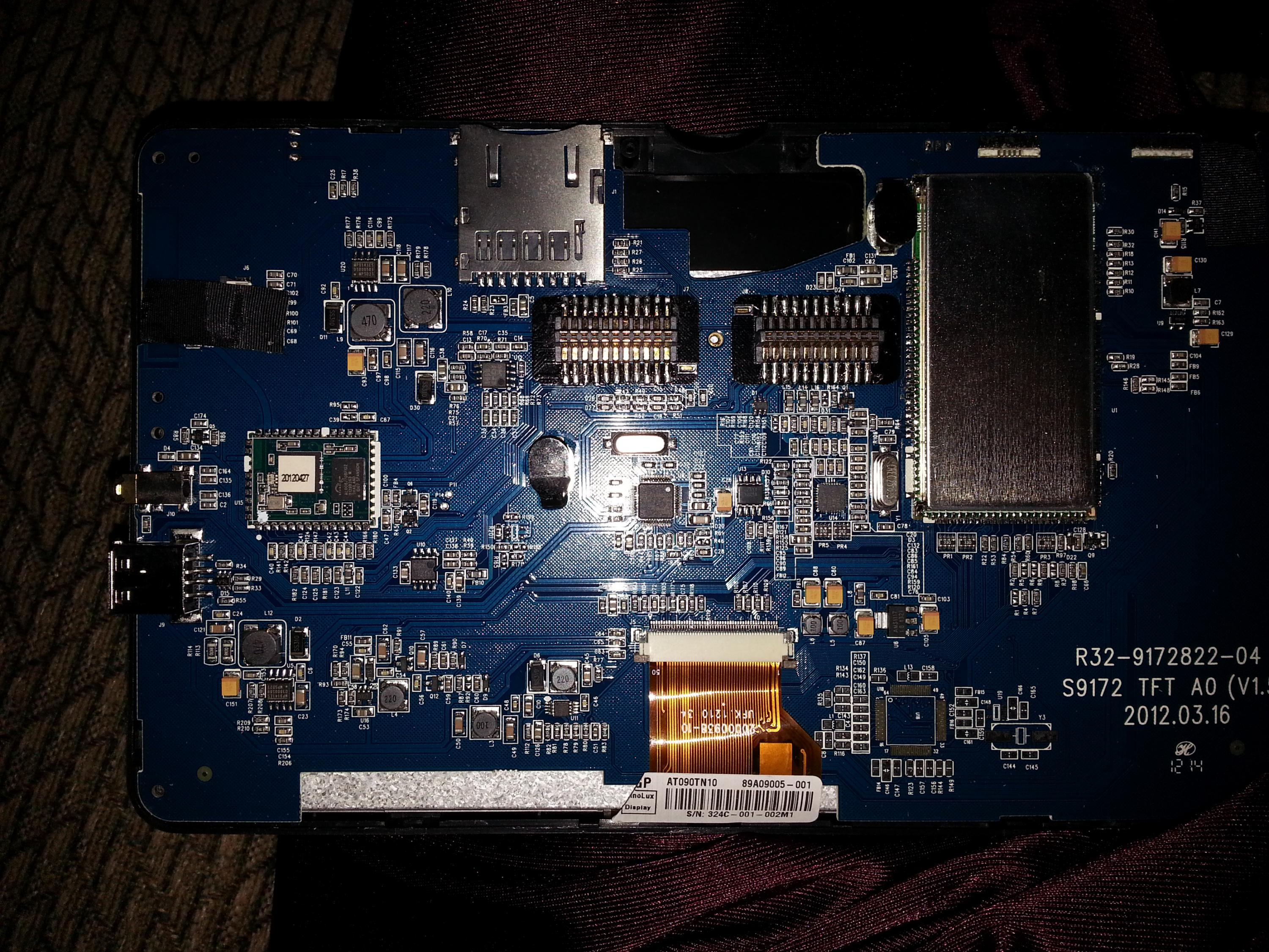

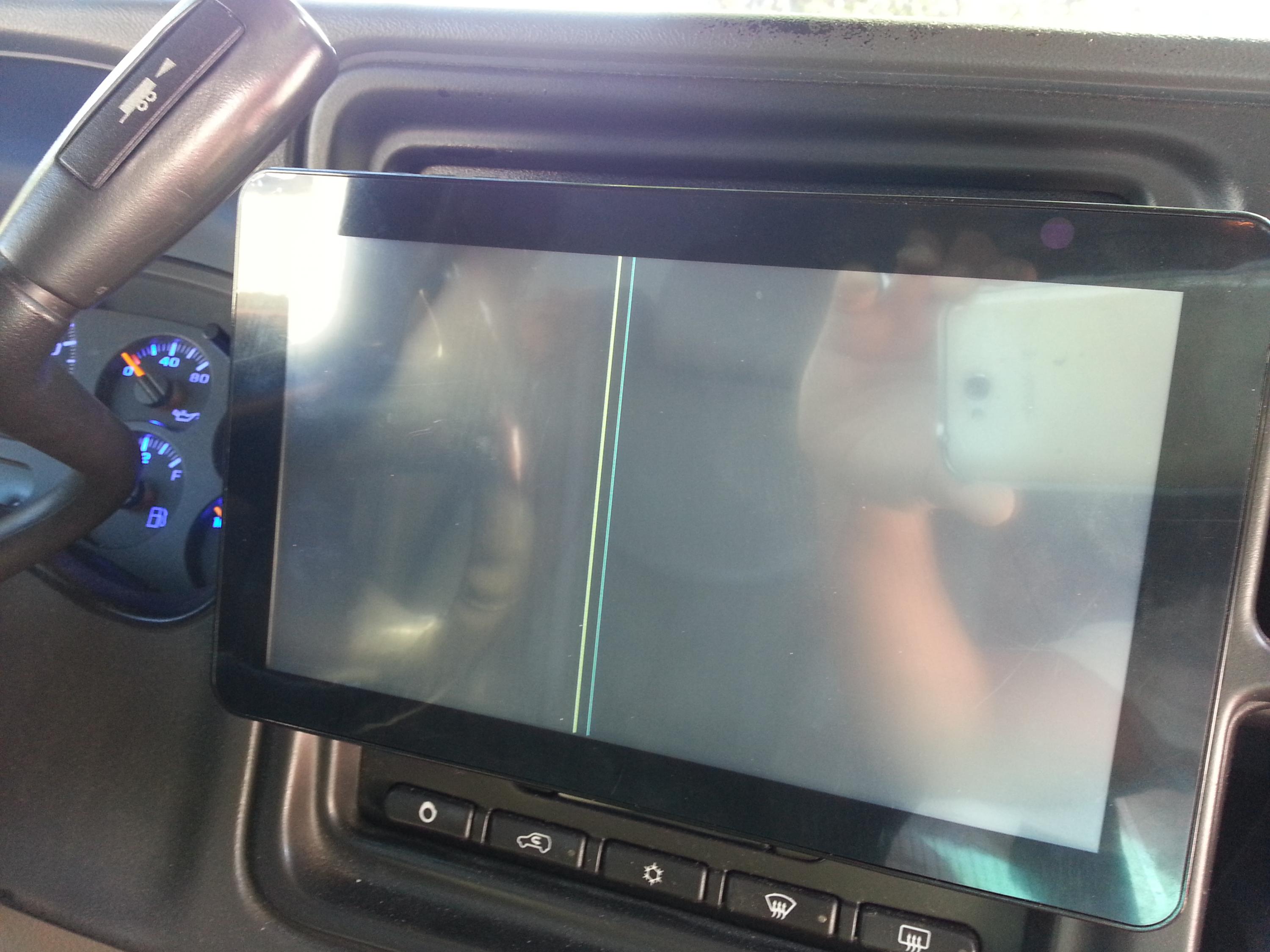

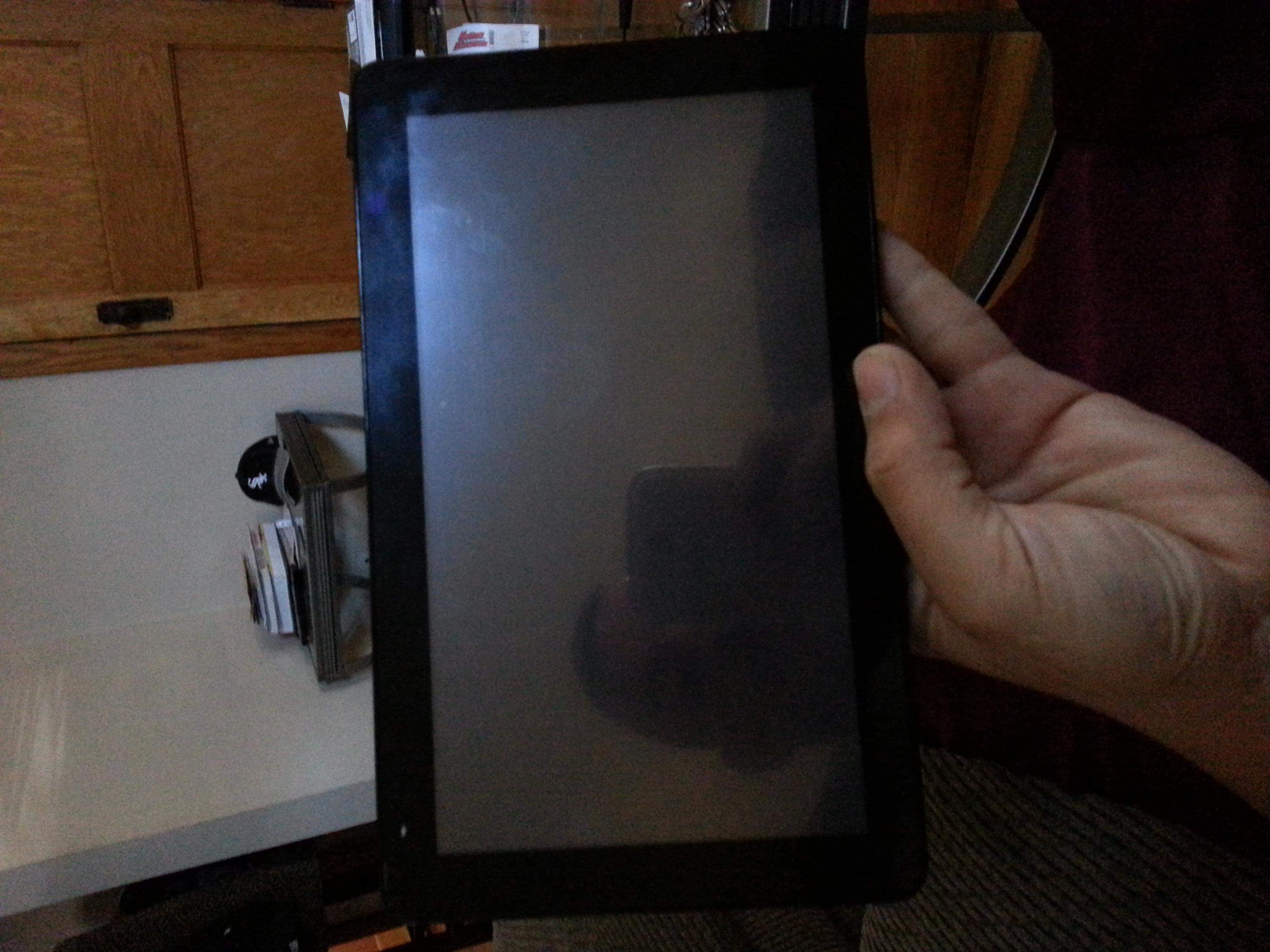

    So I dropped the detachable screen and now I get no image on the screen other than a vertical line and a split grey color
    I took apart the touch panel and there are no visible cracks or damage
    Is it safe to just order the screen?
    I found one on ebay with the same part number but it came off an RCA tablet
    http://www.ebay.com/itm/LCD-SCREEN-R...item35f06ce1a2
    Im waiting on the seller to let me know if it is compatible since it is the same part number
    Is there anything I can test or is the screen damaged?
    Thanks in advance

    The LCD has a few columns alive but the row scan is all gone. I'm not an expert and would check the 5 LCD power supply voltages.
    Datasheet for AT090TN10 LCD module
    I see a bunch on eBay that come with an HDMI board.
    Hope this helps

      Thanks for the info
      So would you say the screen is damaged?
      I would have to rig up a 5v system to power up the screen to test it or figure out how to test it in my truck
      For 20 bucks I guess I can order the one from eBay
