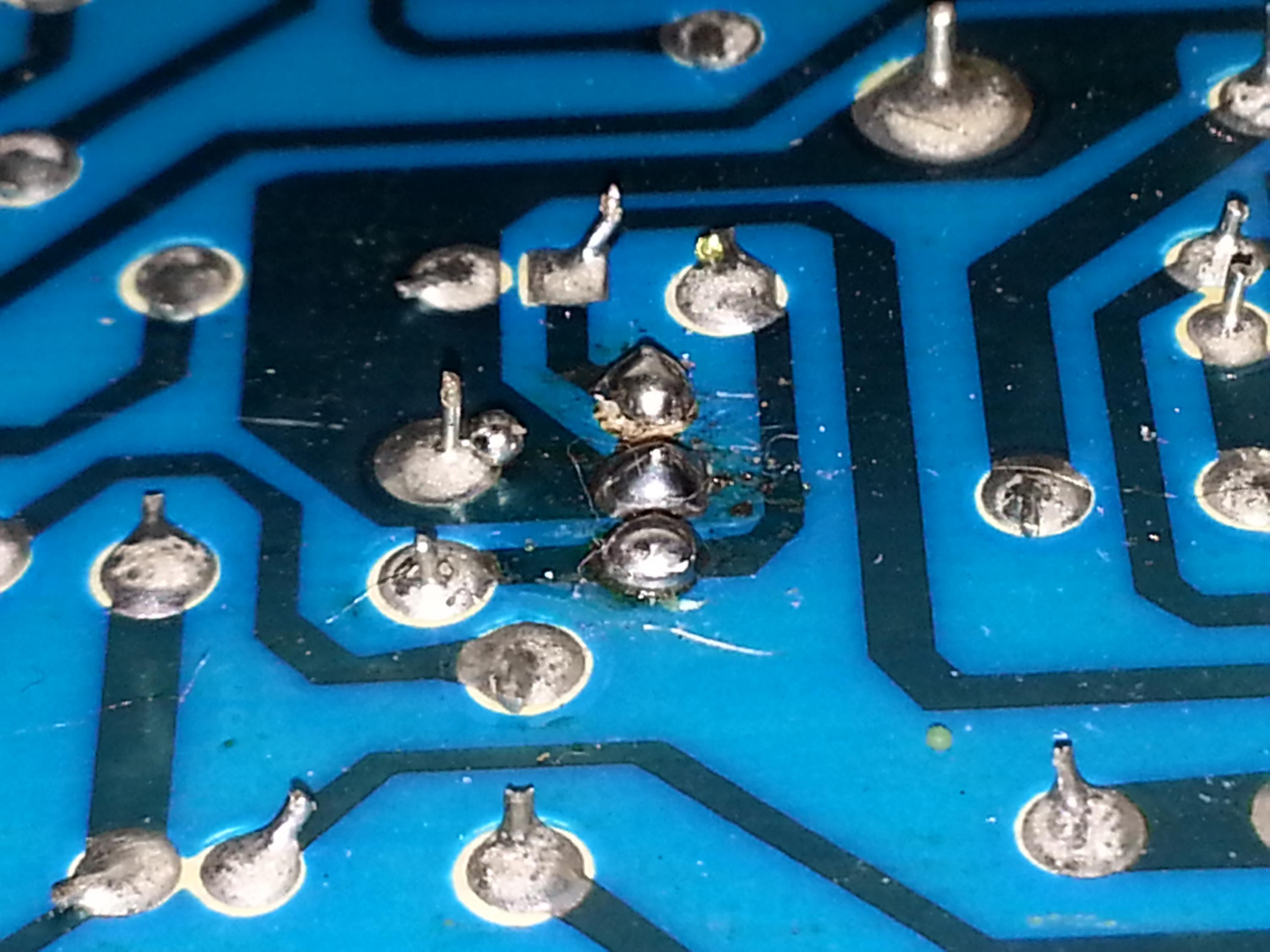

                                      Re: Fender PD-250 Passport has low audio output Right Side
                                      Thought I would post this picture. This is the solder connection that someone did when they replaced Q217 on the Power Amp Board.
                                      Computer and Small electronics troubleshooting and repair
                                        So some one worked on this unit before you? Did it work before after the repair was done? or you do not have the past history of this unit.
                                        You should at least verify if the correct type of the device was replaced, or look to see what else was done to it also.
                                        The power amplifier circuit is direct couple, so if one device failed it can have chain reaction and can wipe out lots of parts.
