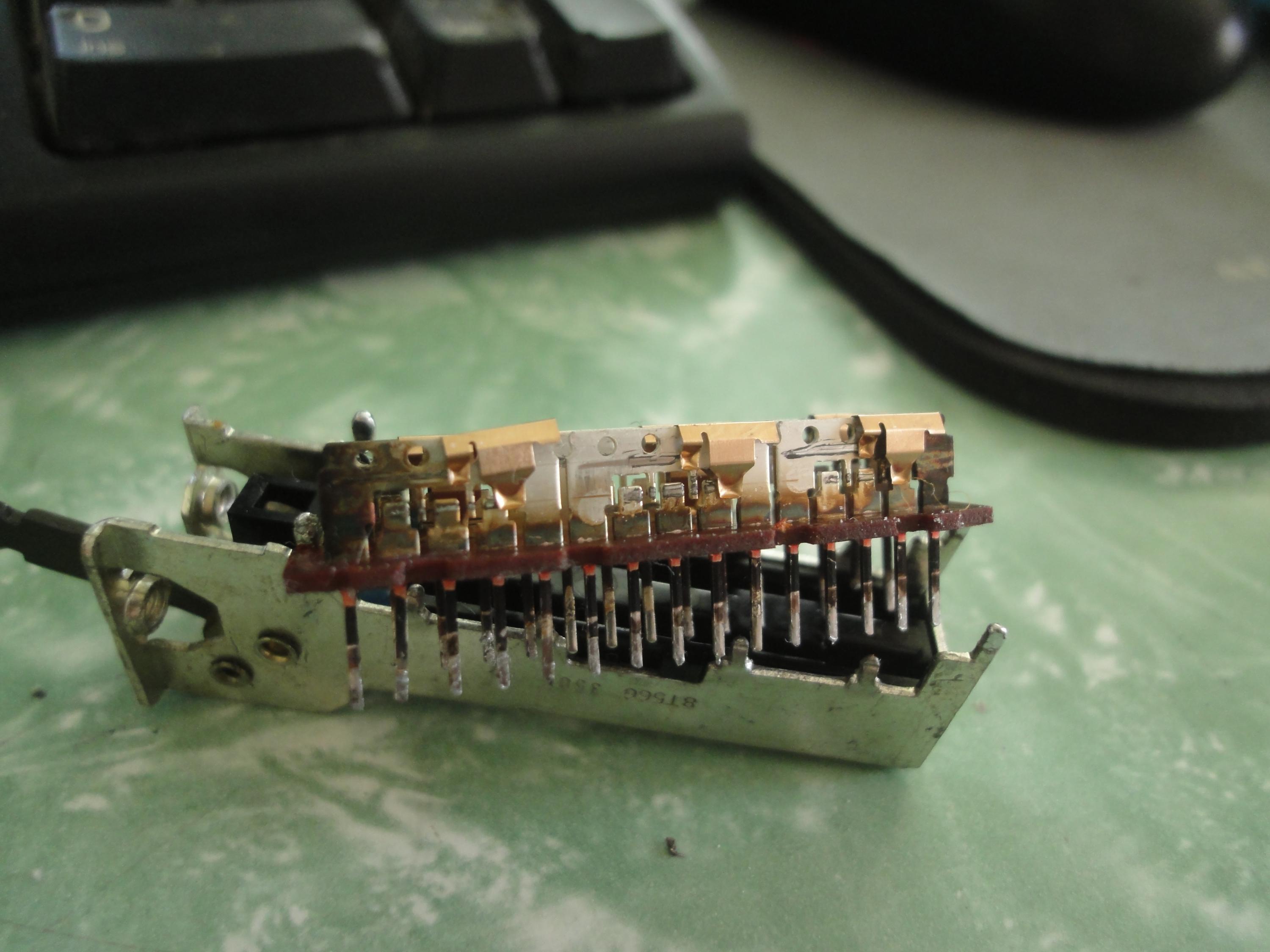

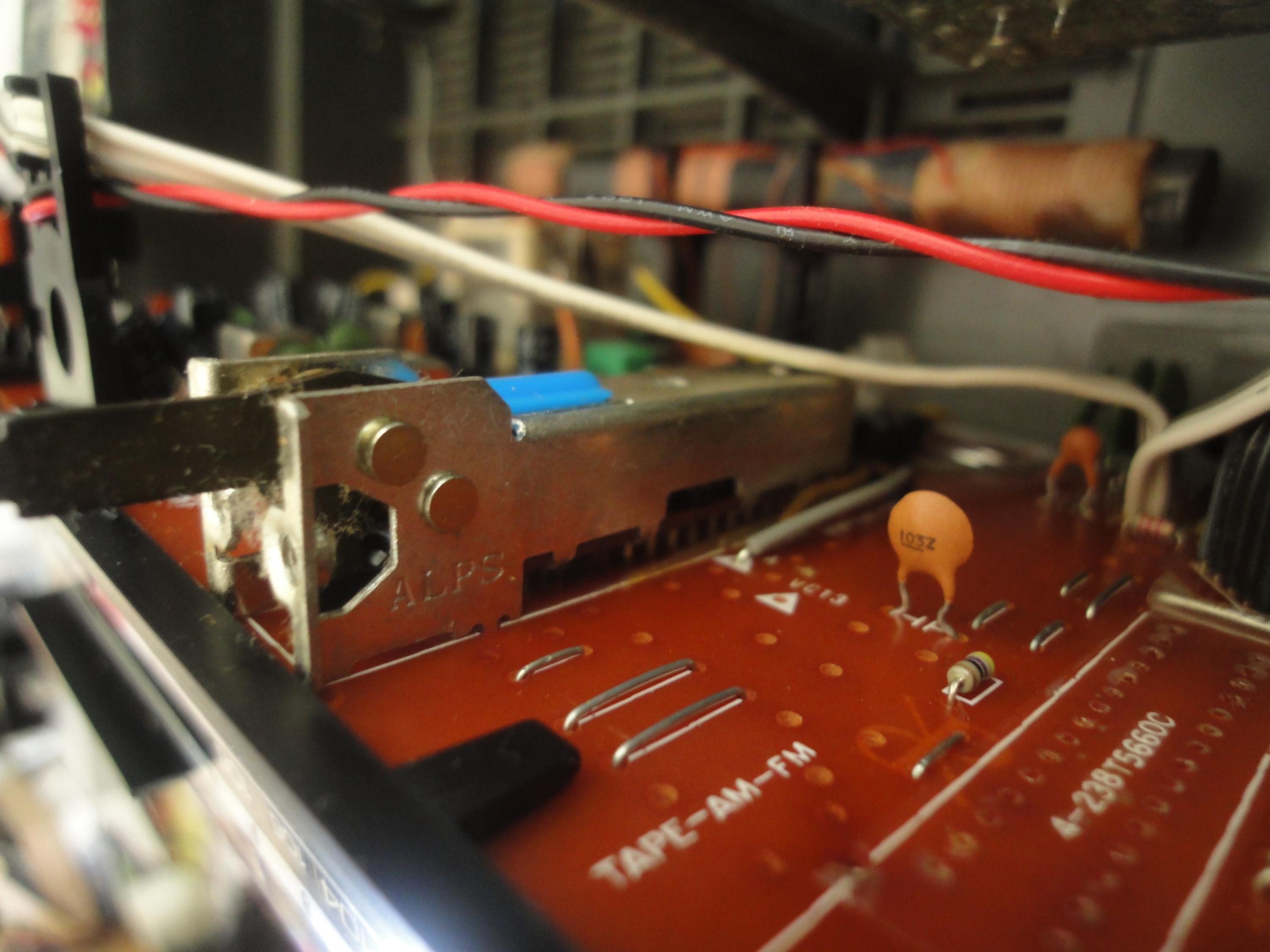

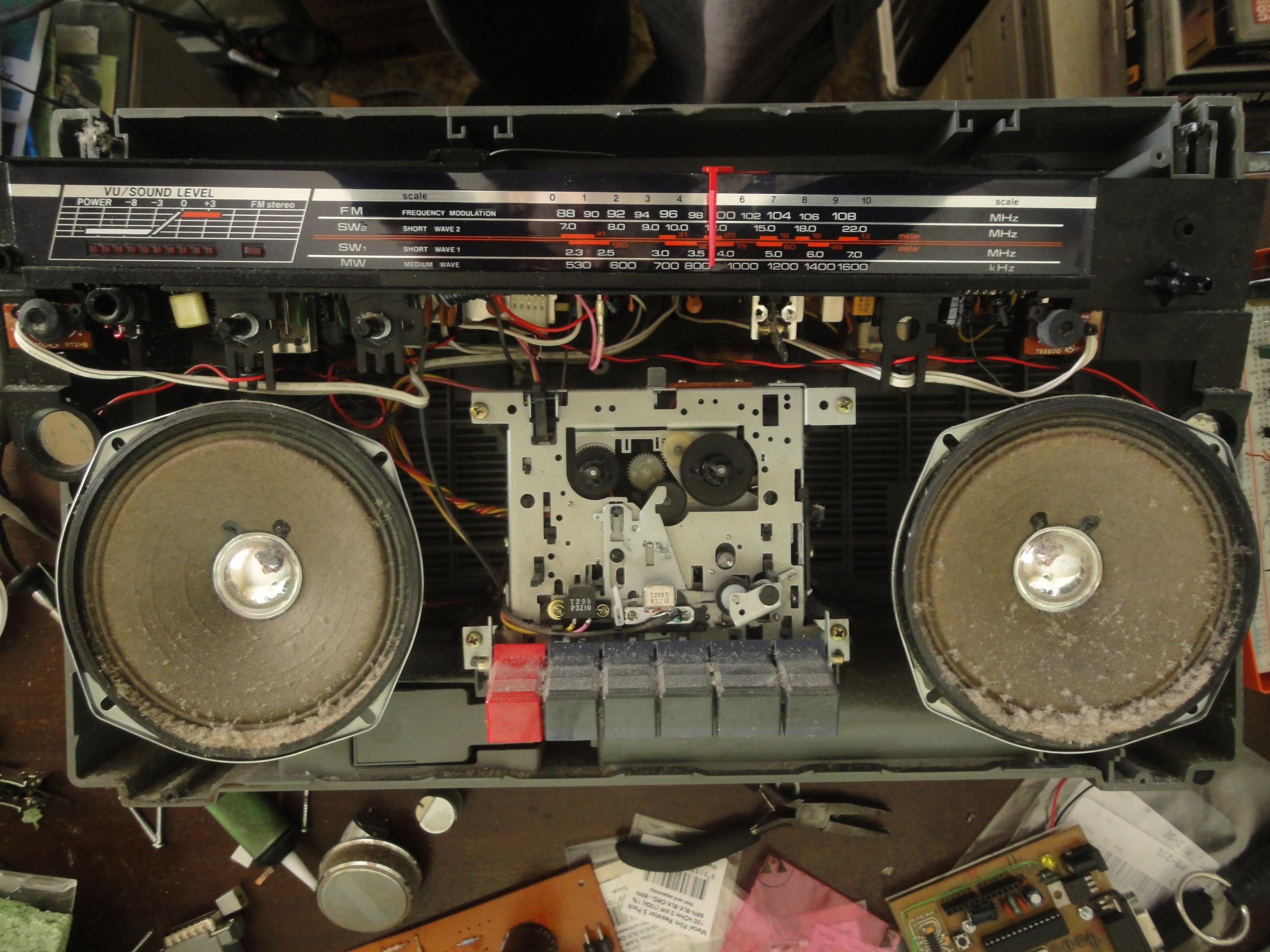

    Got a Sanyo M9820K radio to fix.
    The mode switch was not working properly, wiggling the lever sideways sometimes made the radio come on but not always.

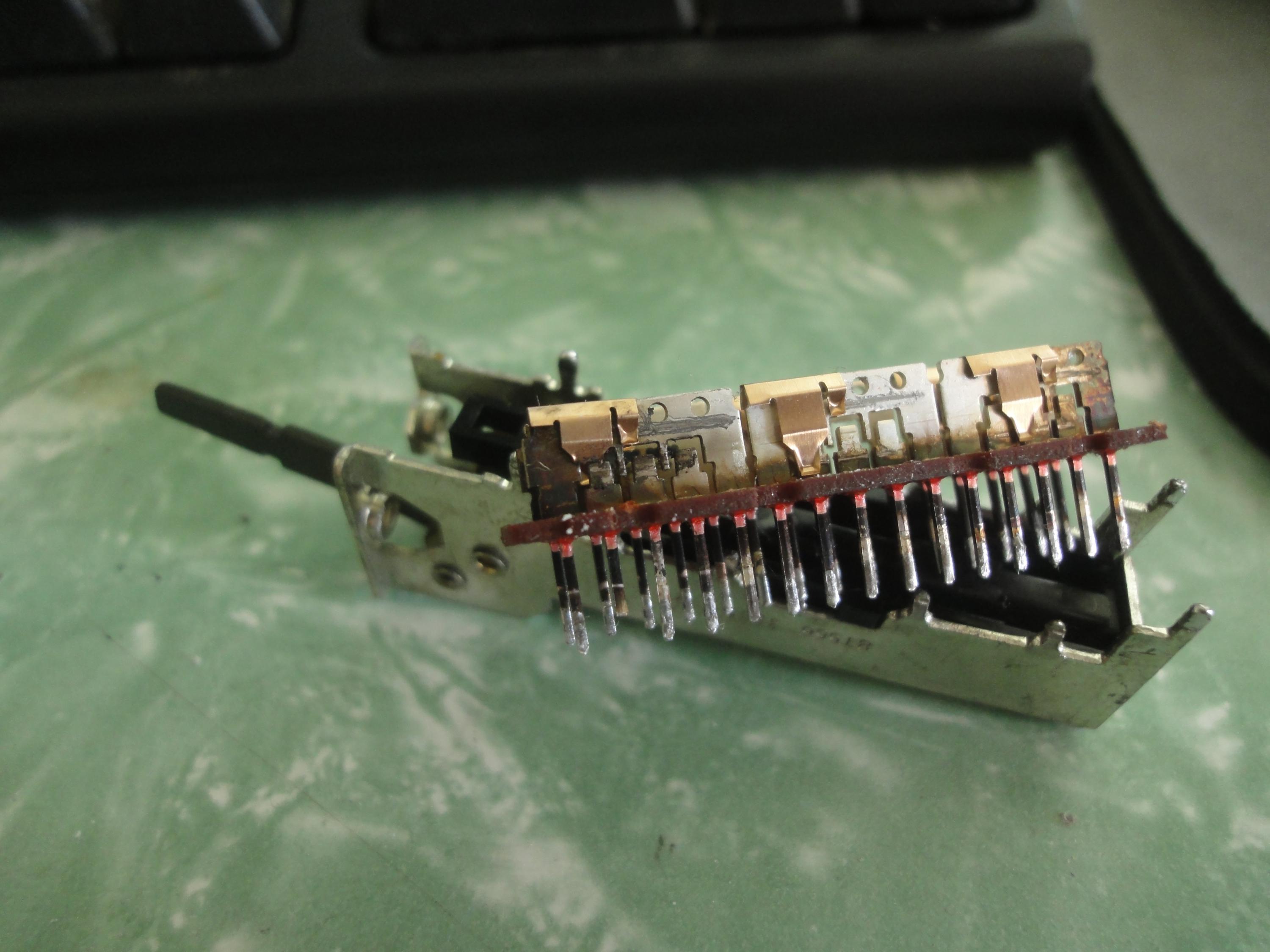

    I found the switch had intermittent\high resistance contact on one group of contacts. I opened it up, expecting severe buildup of crap. No, in fact, one of the contacts has been burnt away almost completely. I guess it's been switching the main power supply and after 20+ years or so it's died. Fair enough.
    It's an ALPS BT566 350F, seems to be 6P3T configuration and which I suspect is highly likely a custom part or at the very least discontinued long ago... (And why the eff do radios always have to have hugely complicated slide switches?? )
    Anyway, does anyone have some clever ideas on how I could fix this?
    I would steal a contact from the band switch, but it uses all 6 sets of contacts too...
    At the moment I'm thinking of just bodging a rotary switch in there somewhere instead, it'll look horrible, but should work...

    Re: Sanyo M9820K 'boombox' slide switch contact repair?
    find some old junk with a load of similar switches and take the contact from one.
    if your only after the spring-contacts then you dont need a 3-bank one.
    • ben7
      Capaholic
      • Jan 2011
      • 4059
      You likely won't be able to find one with the same dimensions, but you could get a 6P3T switch and "dead-bug" it on the board. Or, like you said, use a rotary switch.
