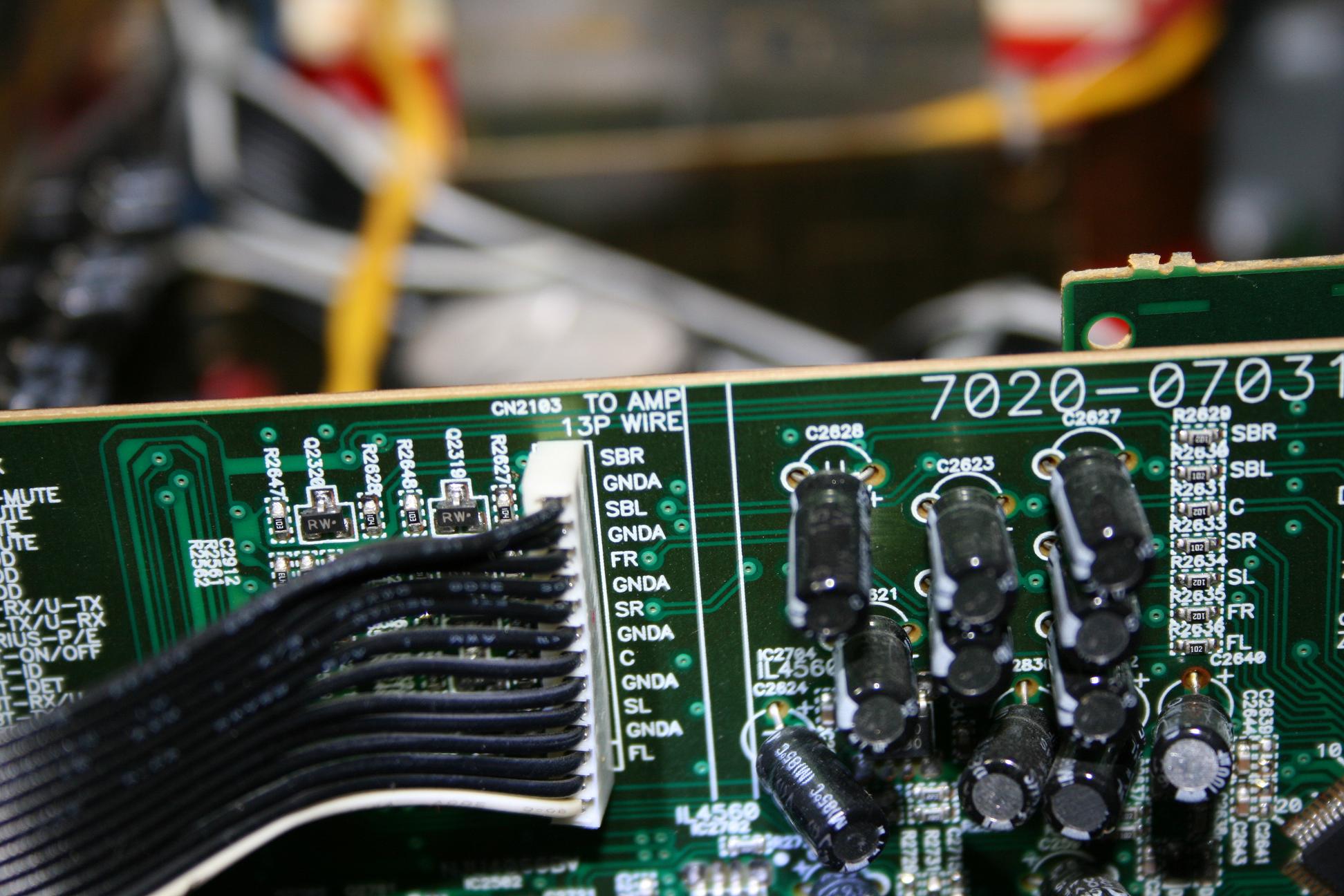

    Texas Instrument chip on VSX-921-K AV receiver

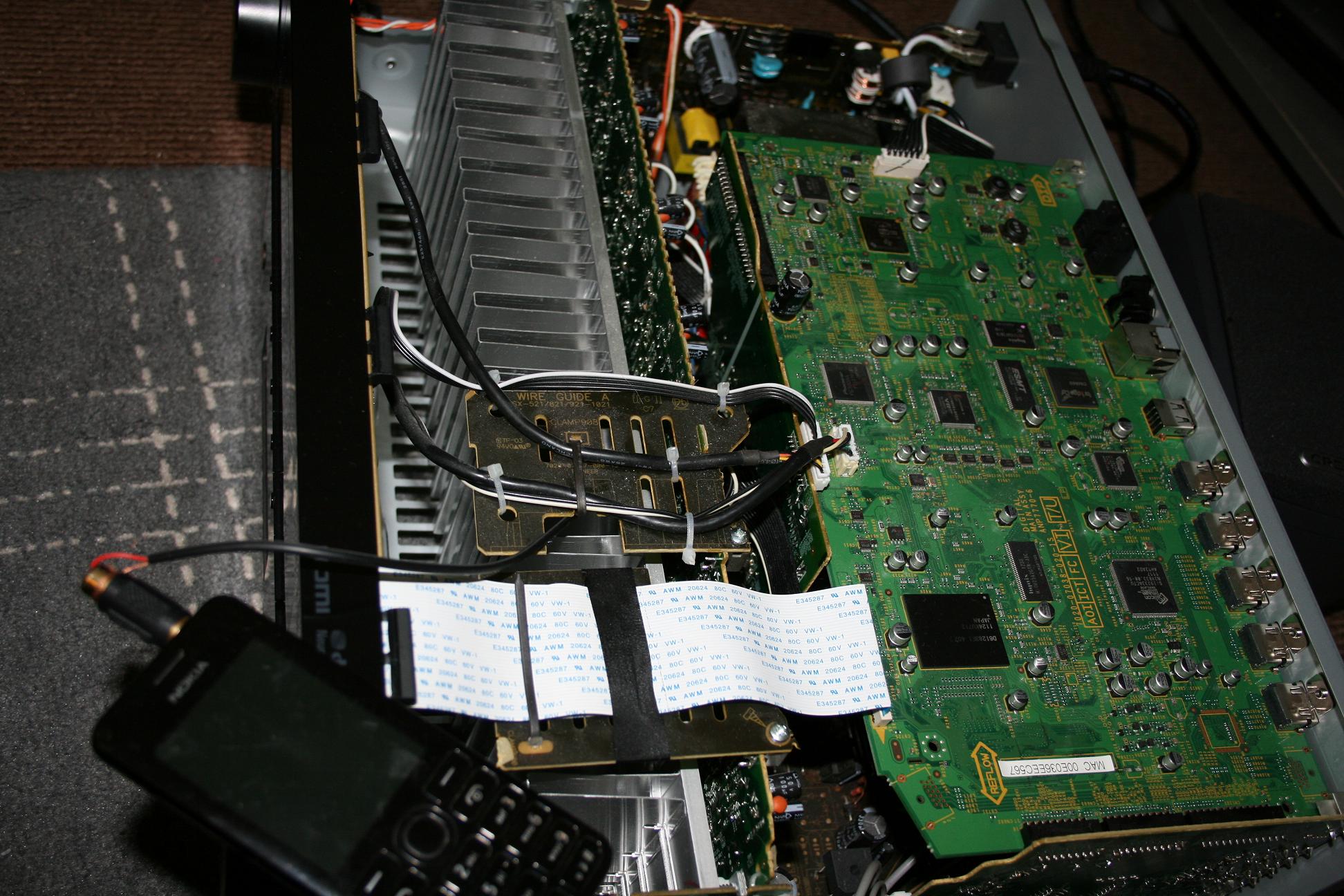

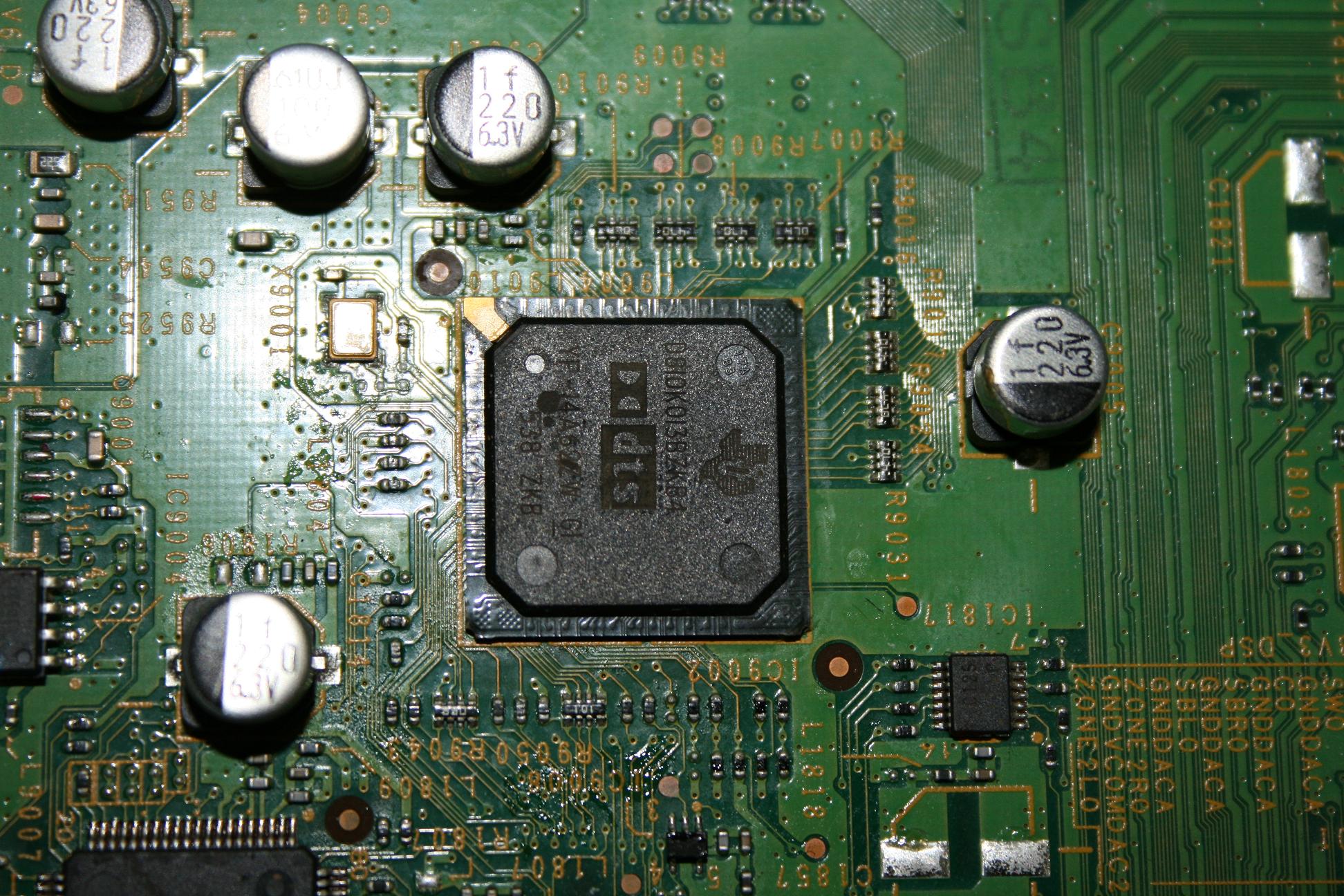

    Give us a help guys I'm trying to find out if this chip is faulty or not. It has test points around it but I'm self taught engineer and.....ok I'm just dumb. HELP!!
    Its dirty around it because I put flux and heat up but I'm not even sure if the chip works. The bruises on it were there before.

                  Re: Texas Instrument chip on VSX-921-K AV receiver
                  It's a DSP chip. Pretty hard to test. Handles all the fancy audio processing. I believe the service manual for Onkyo and Yamaha amplifiers (if yours is one of those) has ways to "bypass" this chip as part of the fault diagnosis process. Maybe worth taking a look?

                      should mention that it has no sound from analogue or digital or stereo or surround. but boots perfectly normally

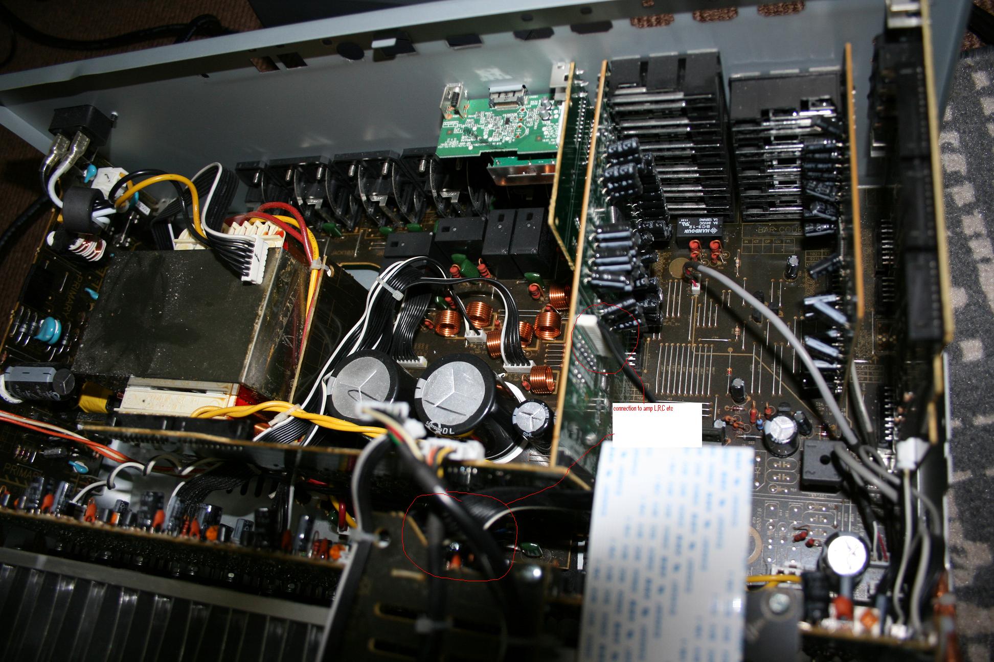

                          update, looks like the amp section works perfect, well the left channel does. I attached my phone to left channel input to the amp section directly and one speaker. It worked but was low volume. the volume on the amp iself had no effect on sound nor did any source selections or surround modes. normal cd input still did not work.
                          looks like the issue is from input to the amp section. so from the input board to hdmi board.
                          any suggestions guys?
                              That's kind of good and not. At least you know that the output stage is O.k. That nothing is working in digital and analog, tells you the problem is before that stage. No error indication is kind of weird, but maybe the problem is in the input stage. Maybe the input selector is bad? Try to see if you can feed it audio and get something back out on the REC side of the tape function.
                              Also look at page 53 of the service manual (ground points).
                              Page 16 and 17 show you the block diagram. Try to get the analog working (easier). I guess there is a relay that switches between analog and digital... see what that is doing? No DC on the RCA input jacks I hope?

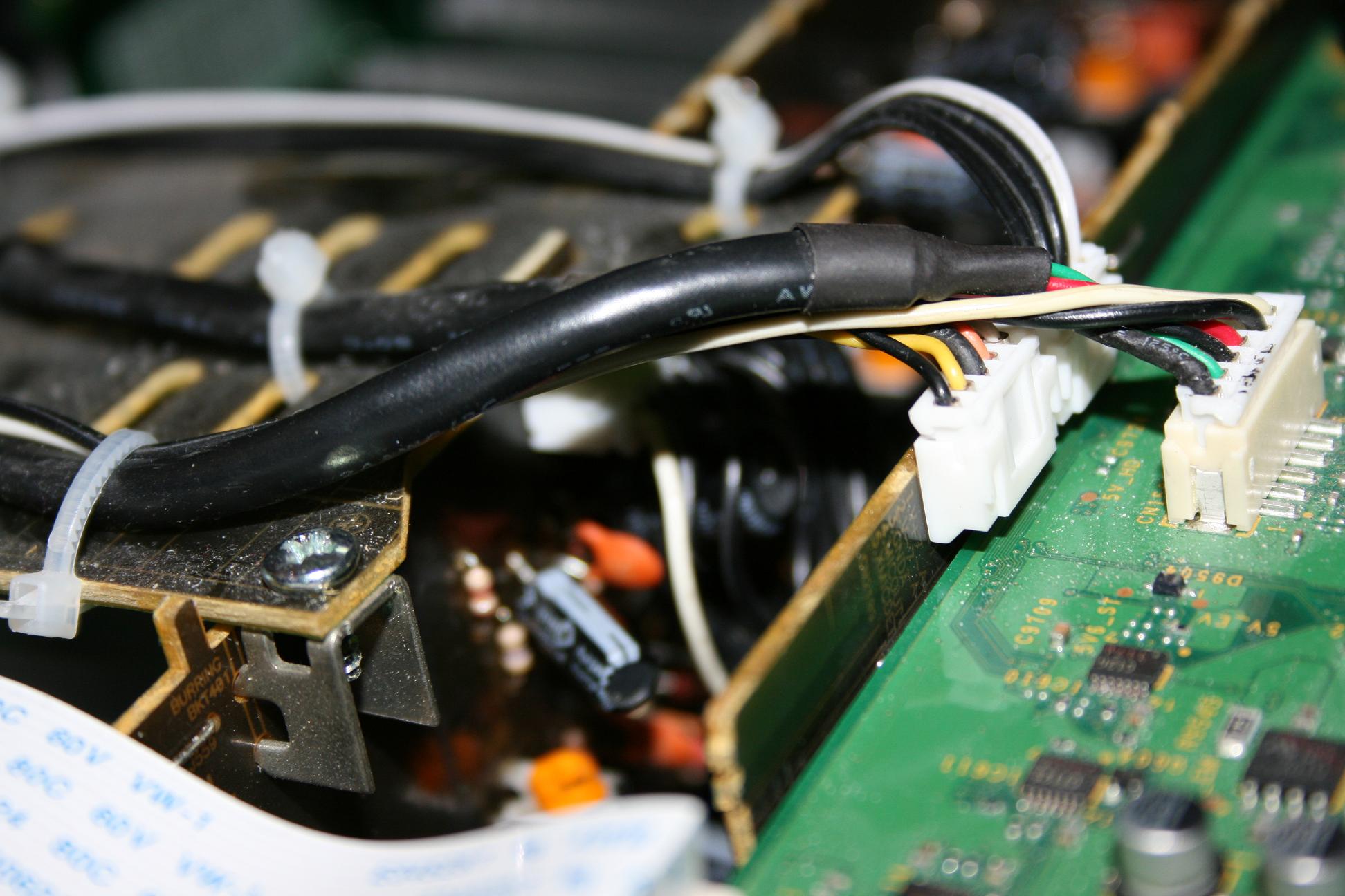

                                  ok i could only try one thing. the input selector seems to work fine and select any input. all the display and selectors seem to work fine on the outside. i input from phone to tv analog left line in and attached speaker to left line out and did the source selection. then selected pure direct sound and no surround sound. no activity. pages 16 and 17 look very easy to follow (i hope) and will give that a shot first as the grounding thing seems complicated as i have to rip the whole thing apart i think.
                                    I had no idea if the unit is together or apart. Some tare it apart, then wonder: why isn't it working? That why I mentioned the grounding thing.
                                    O.k. Seems like the selector is fine. It is always good to have a look at the block diagram first and get a bit familiar with things, before you go and dig into the big schematic.
                                    What happensd to the amp first place?

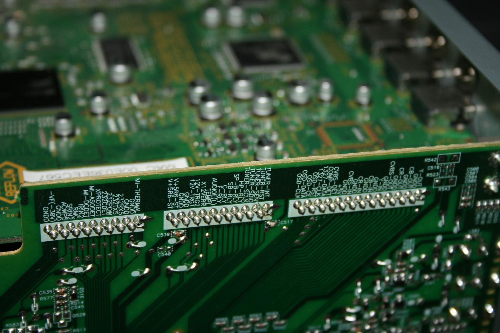

                                      was given to me. he doesnt know what happened either. just stopped working. been so busy had not had time to look into it.
                                      i did have a look today and still getting nowhere. i did manage to find fl-out from the dsp board and it had no signal. its either the dsp/hdmi board or the 7.1 channel audio board with this chip on it bd3473ks2.
                                      im starting to think that its not the hdmi board mainly because when put amp in direct mode it by-passes the dsp stuff. but i could be wrong.
