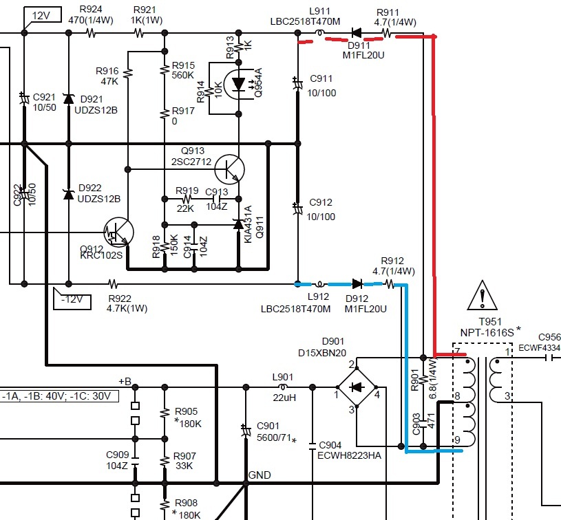

    Check again d901 in diode mode for short (I do not remember by heart the internal schematics of the bridge rectifiers, so I test each pin to each other pins, then switch the probes and again).
    You can use IPA to find the hot component(s) - drop IPA on the component and see how fast evaporates.
    Thermal print labels also can be used - cover area with a label and see where it will get black.
    This power rail doesn't have too many common points to ground - q502, d516, q501, q434+q436... all other possible paths include too many components that have to be shorted. So try injecting voltage again and check that components if they are getting hot.
