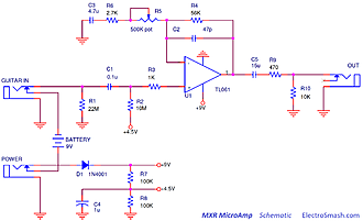

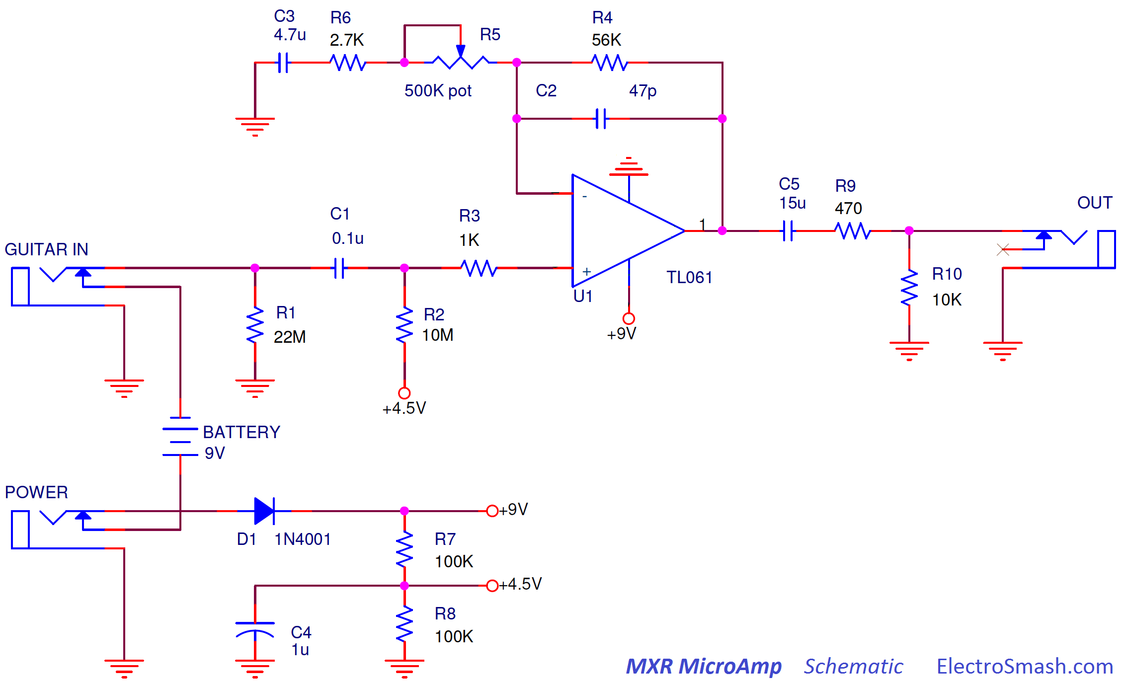

    I'm building this pedal for the second time and it has the same failure. Voltage divider not working as it should. Before the 10M resistor it works, 4.5v, but after it the voltage drops depending on the value of the resistor I put on. 10M=0.45v 2M=1.9V and so on. It should not do that, that resistor is just for biasing the input signal.
    Any idea?

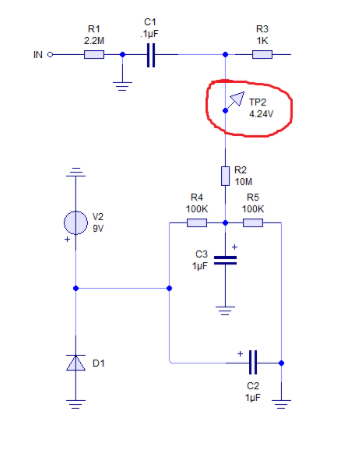

      Originally posted by stj
      schematic?
      Just R1 is changed to 2.2M and a 47uf power filter cap is added
        • 31013
        use a 78L05 to get the reference,
        a voltage divider is dependent on current.
        or increase the current by using 10k resistors instead of 100k for R7,8

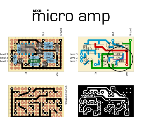

          still that doesn't make much sense to me, based on other circuits that I've made and references that behavior is not normal. Maybe there is something wrong with the board but I can't find anything
            • 31013
            a leaky c1 or a bad opamp maybe then.
