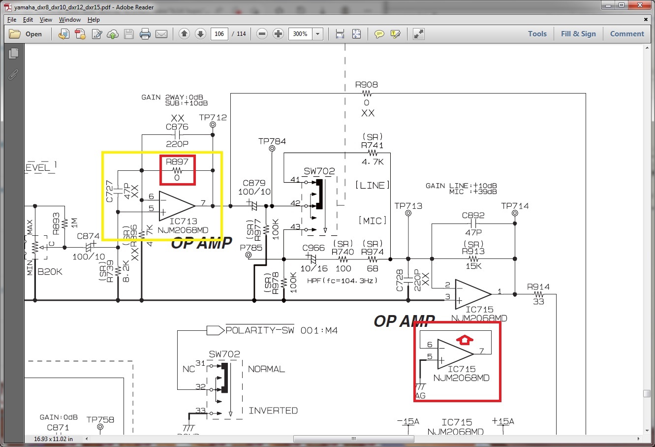

    Another updates: I install the parts I get sound but another problem. I don't have high I test the tweeter is good.

        Originally posted by MobileXT
        I have a shorted on the IC713 and IC715 both on PIN 6 & 7 so I ordered the parts from Mouser NJM2068M-D hopefully will get here by next week. Once I get the parts I will update you guys.
        IC713 has a 0Ω resistor (R897) across pins 6 & 7, IC 715 pin 6&7 are connected together (section of ic not used)
