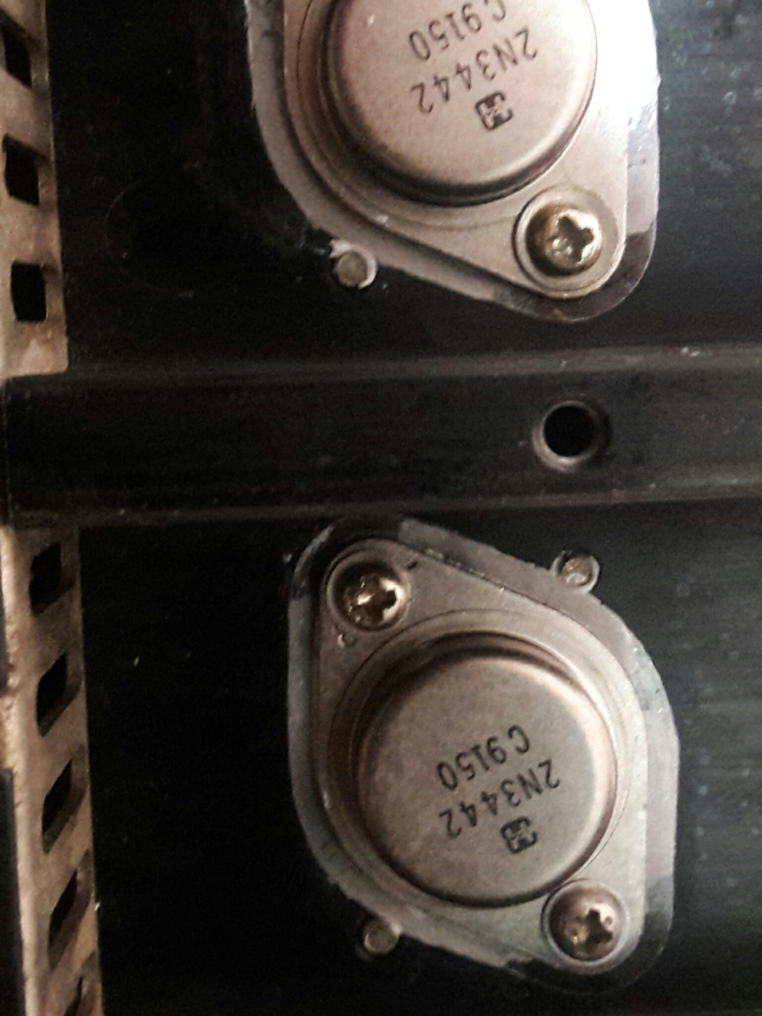

              Re: Sansui 5000a blows right channel fuse
              about 85% of the time when the output transistors goes shorted, it takes out the transistor's driver transistors and sometimes nearby resistors.
              chances are, only 1 output is shorted. becuase if they both were shorted, it would take the main B+ fuse and neither channel would be working, as its a rail to rail short.
              Now if one shorts, it shorts ether V+ or V- to output, blowing the output fuse. but you replace both.

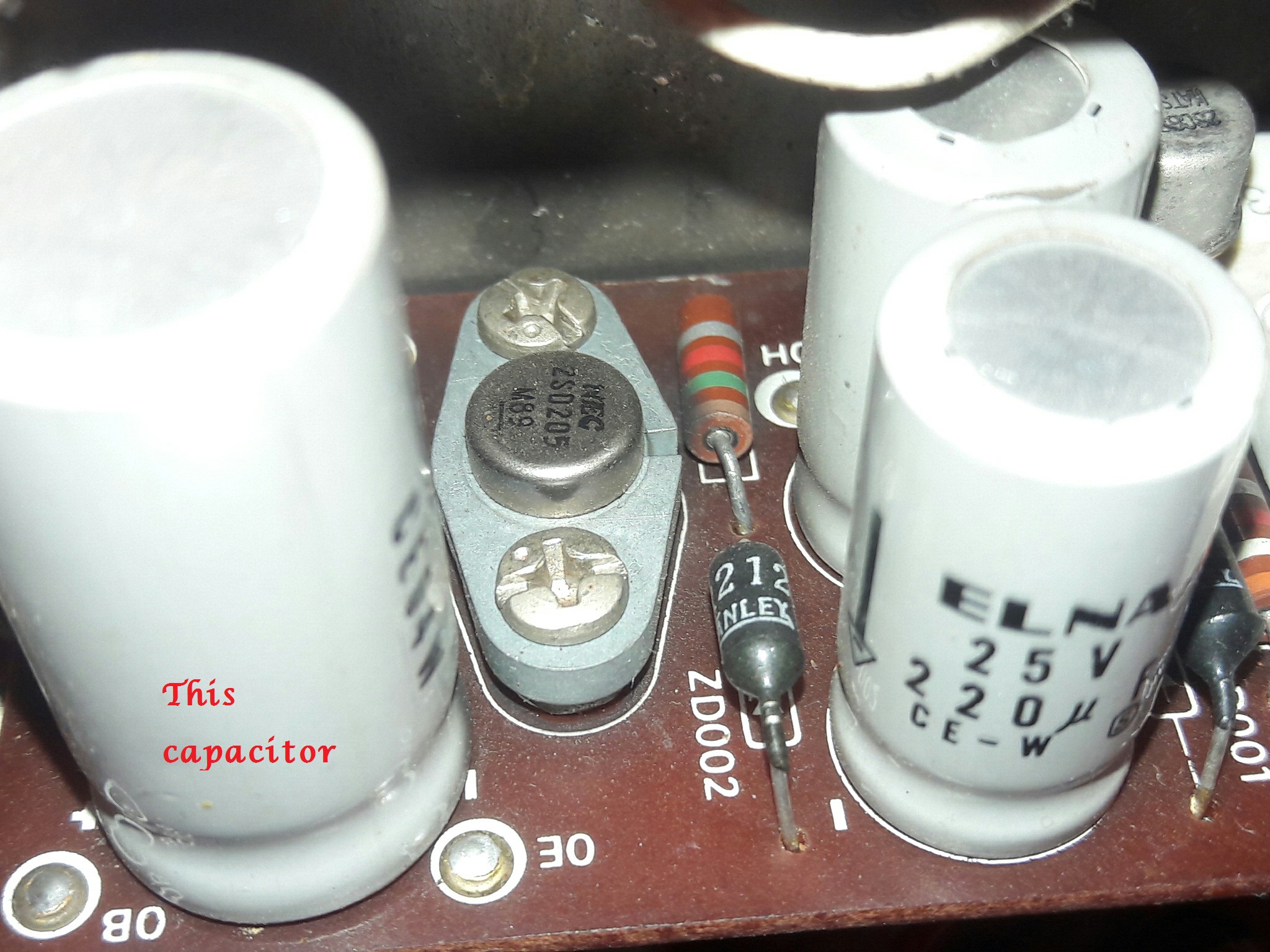

                Hi, I had the same problem with my Sansui 4000.
                I'am not sure if both receivers are similar.
                A dead ELNA cap on the driver board killed
                a transistor which in turn killed output transistors.
                The original ELNAs are now 30 years old.
                Replace'em.
                                  Hi.
                                  This is well know problem on this units and also on BA3000,A-700,1000X,A1100 etc.
                                  Alot of times the relay stuck dont work propertly also the driver transistors are bad.
                                  They use slow 6,7 MHZ transistors and if you change it with a fast ones the sound changes very much losing the warm.
                                  Very dificult to find the same ones.
                                  Also sometimes the TOSHIBA output transistors are pair with another brand and that seems to give problems.
                                  For sure you have to changes all caps and be carefull because you will find a lot of cold joints for sure.
                                  Dont mess with the cables and mark them if you put it out.
                                  Change all the driver trans if need it also make sure that the pcb screws make good contact.
                                  Also i sugest put all the signal cables away from main voltage ones change the main caps from 2000 to 5000 disable high low filter more powerfull diodes disable a b selection speakers new output speaker conections and good cleaning of all switches.You will see another machine..

                                      Hello
                                      thanks for your response
                                      You're not my country win 6013
                                      Repair work is not good, if I may, I will send for you to repair amplifier?
                                      I feel used transistor amplifier:
                                      This capacitor is also possible to cut loose than this?
