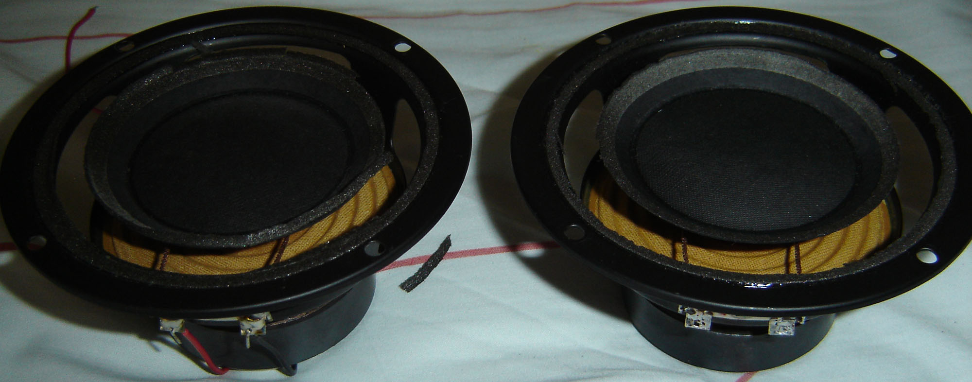

    I admit that the music was quite loud, but not so loud to damage the speakers.

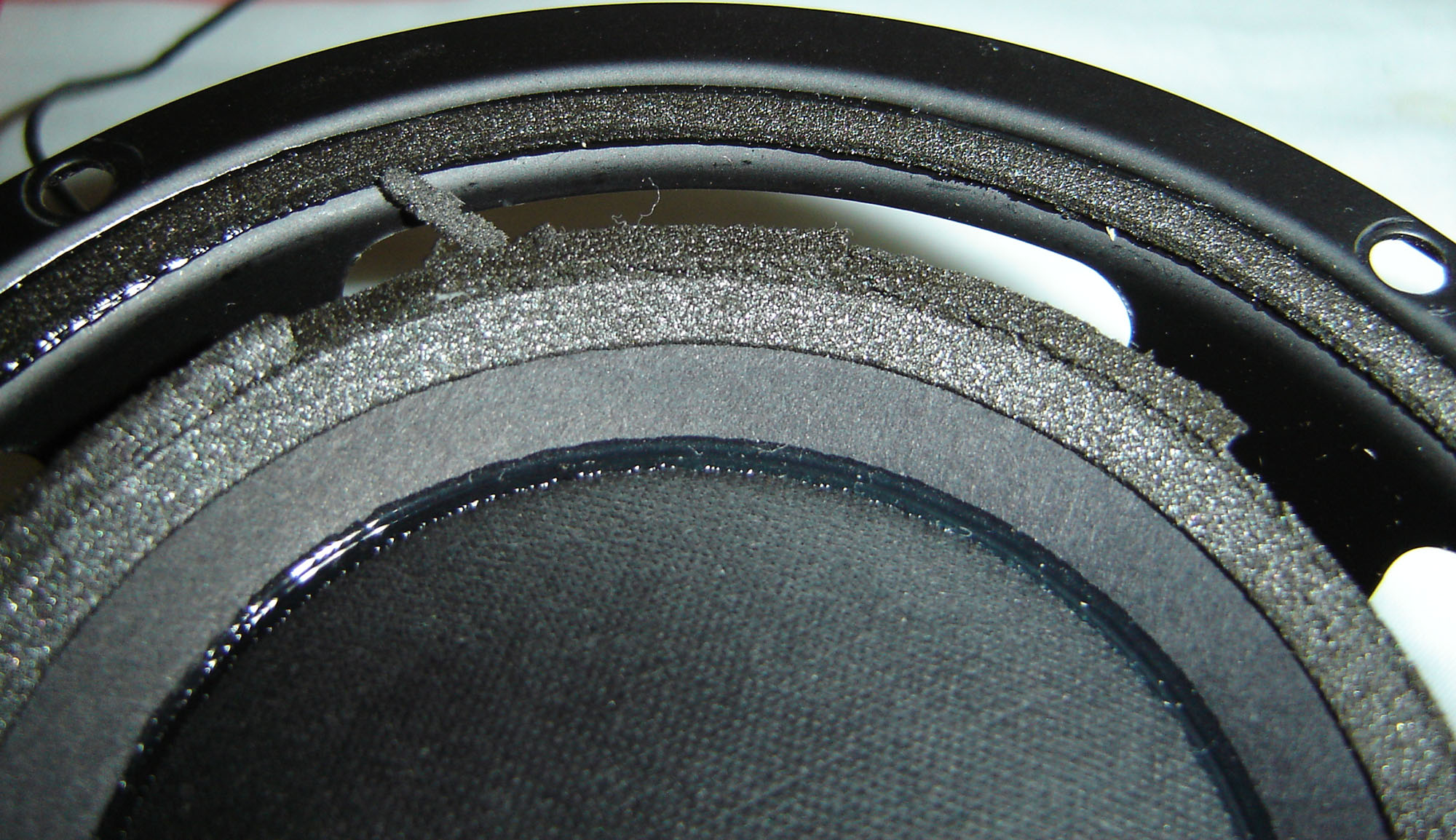

    Suddenly I heard some major distortion from the sub and I decided to take out the cover to examine the subwoofer speakers. The "paper" actually fell of the speakers in a ring shape. Touching the paper it is dissolving like it is 50 years old!
    How that happened? Is it possible to fix them? Are there replacements?

    Dry rot.
    It might be possible to get them re-coned/refoamed.
    This place has both kits and service: http://www.simplyspeakers.com/

      I found a local repair service and I sent the speakers there:
      http://www.megafoniki.gr/
      They told me the repair is going to cost ~40 euros both.

                  I just wanted to inform you that the speakers were repaired by Megafoniki. I received them 3 months ago but I couldn't remember about that thread to update it. It took too long for the suitable replacement parts to be found, but the result is excellent
