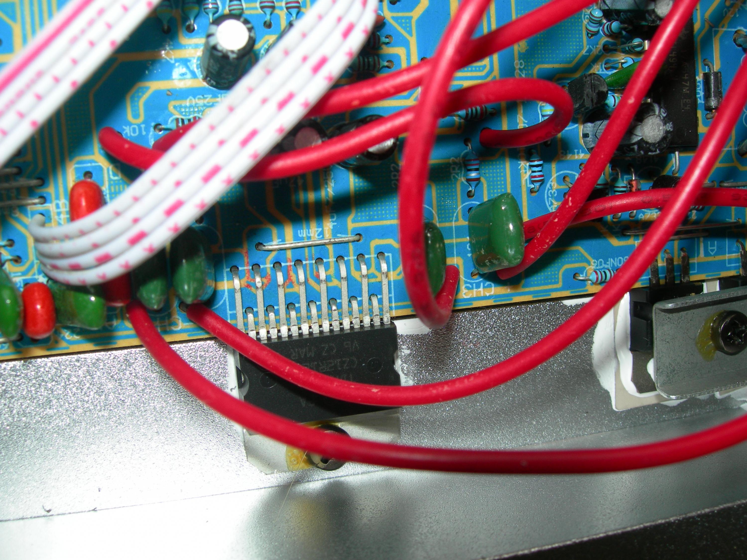

    Pictures!
    I just noticed instead of part #s they actually use device names, I suppose it makes it easier to reverse engineer but WHY? Especially in China!

      I've seen that style of PCB in a china special class AB discrete amp i have at home. Component values instead of part IDs... check. Tons of jumper links... check. Font... check. No idea who actually makes them tho, but it could be those guys: http://windy56wu.en.ec21.com/
      What's up with that SMPS in it? The 7377 is designed to run straight off the car battery.

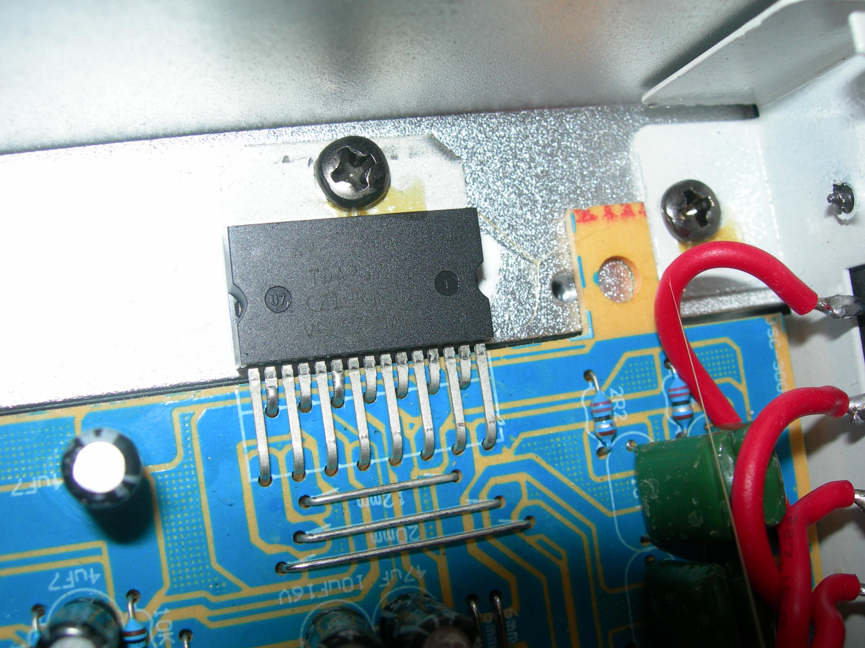

                                        The coil has about four windings. Not sure what all of them are for as only one provides V+ for the amps. Maybe others are just mechanical support or auxillary windings for other stuff.
                                        OK, so some diagnosis:
                                        - Vcc to TDA7377's is only 12.6V with 13.8V in; so the boost converter isn't working
                                        - Vcc to TL494 is only 5.3V; minimum is 7V for guaranteed operation. Something is not allowing it to power up as it has a limited supply, but not the full supply it needs.
                                        The ST 7808 regulator is fake as the printing and font is totally different to all of my ST voltage regulators.
                                        Maybe the TL494 is only powered up on heavy bass? That would make it a rather interesting Class-G design; or if it varies the supplies, a Class-H.

                                          Don't think so. You said you have a scope - check the outputs of the 494, see if it's trying to do anything. This may be an unregulated converter - hence the Vcc of the 494 isn't too important, since Vref isn't needed.
