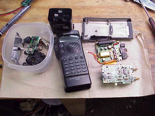

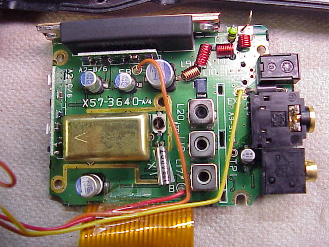

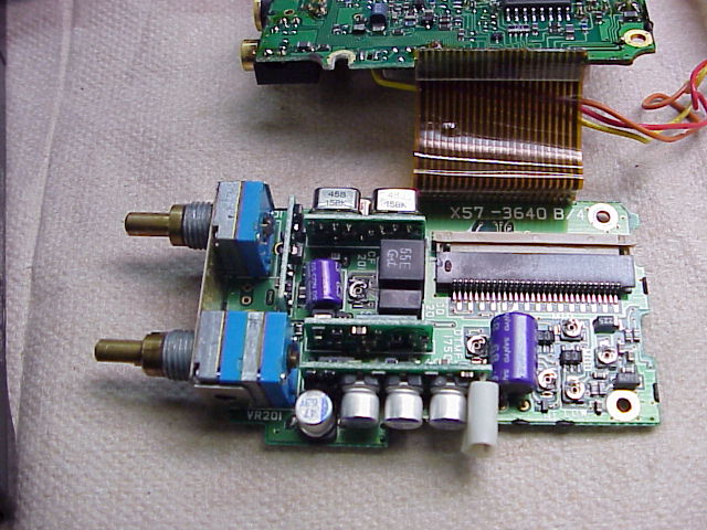

    kenwood th-27a
    every smt lytic in this unit is bad.
    they rotted on the shelf as p.o was sk.it worked before it was stored in a drawer 5 years.
    wouldnt come on so i got it for $1 at the estate sale.
    its gonna get smt tantalums in place of the lytics.

      Re: kenwood th-27a
      that one was easy.
      took a whole 30 min.that rig doesnt have ANY lytics in it now.
      works like a new one.
      also need to rebuild the battery.6 sanyo 2700 aa ready to go in!

        Re: kenwood th-27a
        Well done, your befor pics are great, any after pics?

          Re: kenwood th-27a
          no.i reasembled to test and it passed.sorry the sony camera doesnt have xray vision.
          i used smt tants i stripped from dead mobo's.
          btw the brown stuff that looked like flux was electrolyte residue.be warned if you do this that it stinks!
          i cleaned up the boards before replaceing the caps.
