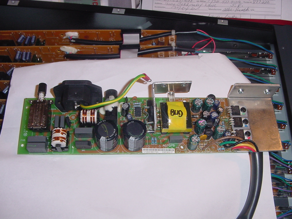

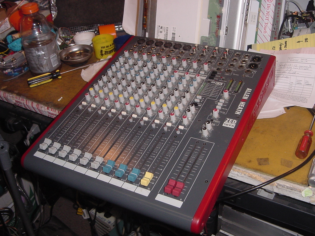

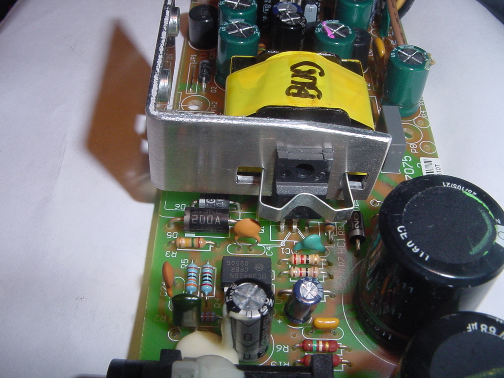

Allen N Heath ZED12FX mixer bad Power supply

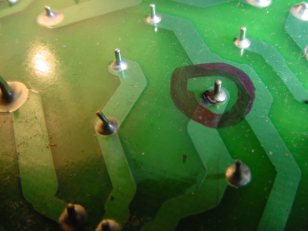

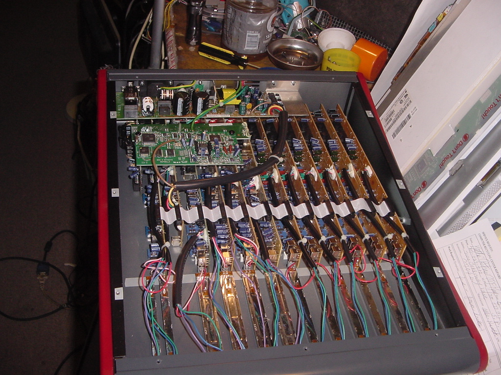

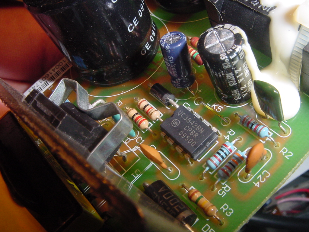

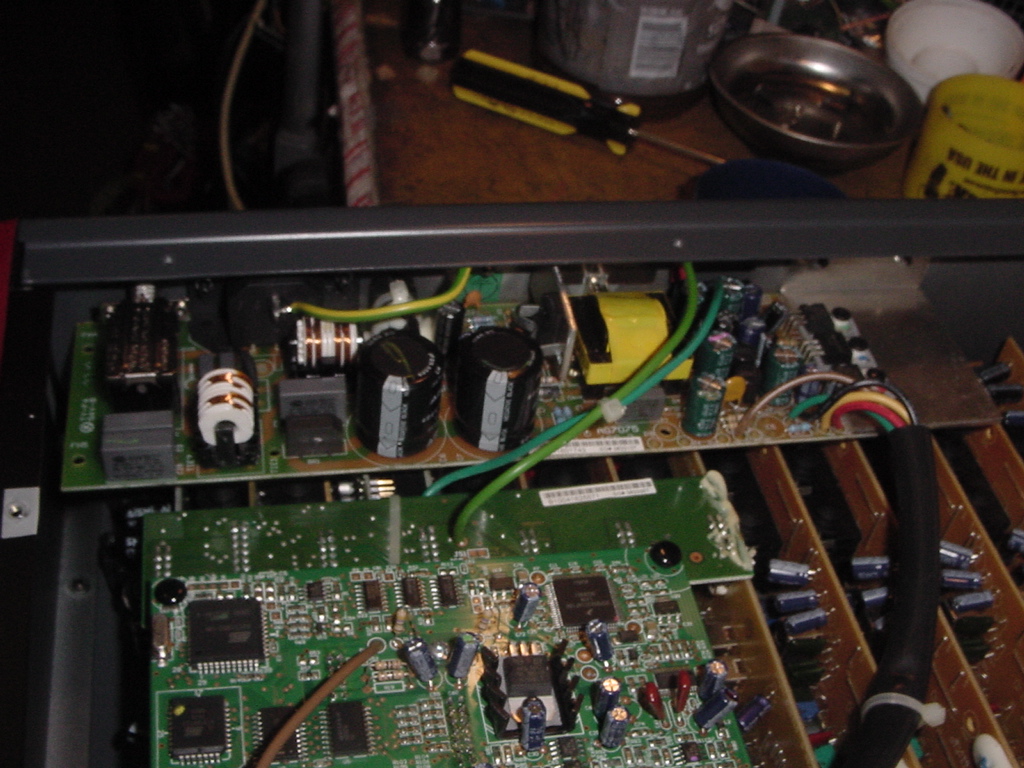

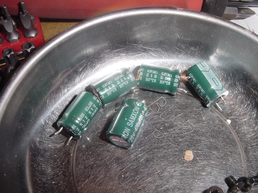

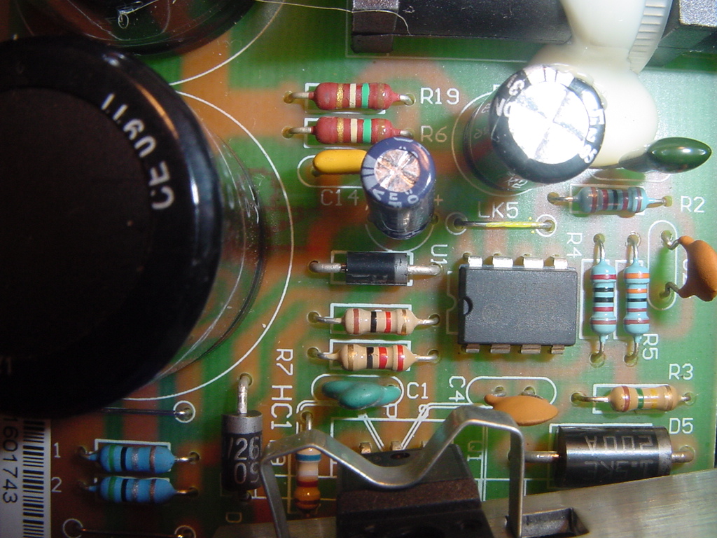

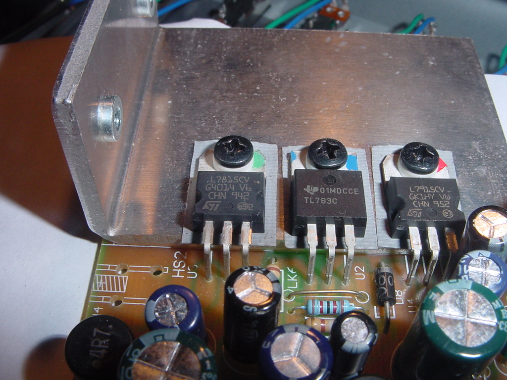

Cracked solder joint on the common mode filter choke pin. I also upgraded the caps to PANASONIC FM series and re-soldered a bunch of solder joints.Never stop learning
