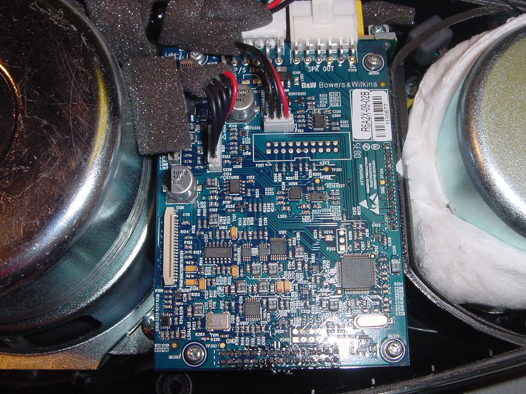

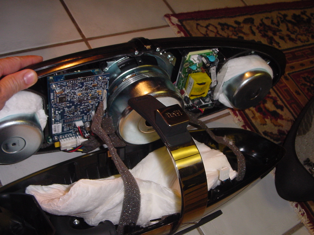

Bowers and Wilkins ZEPPELIN crappy caps
    This is what you get these day for expensive products.
    Re: Bowers and Wilkins ZEPPELIN crappy caps
        I know Samxon GF is problematic, but geez, I didn't think Samxon GK series was bad.
        I remember growing up reading Stereo Review and seeing all the positive reviews on the BW series speakers.
        Thanks for the "teardown".

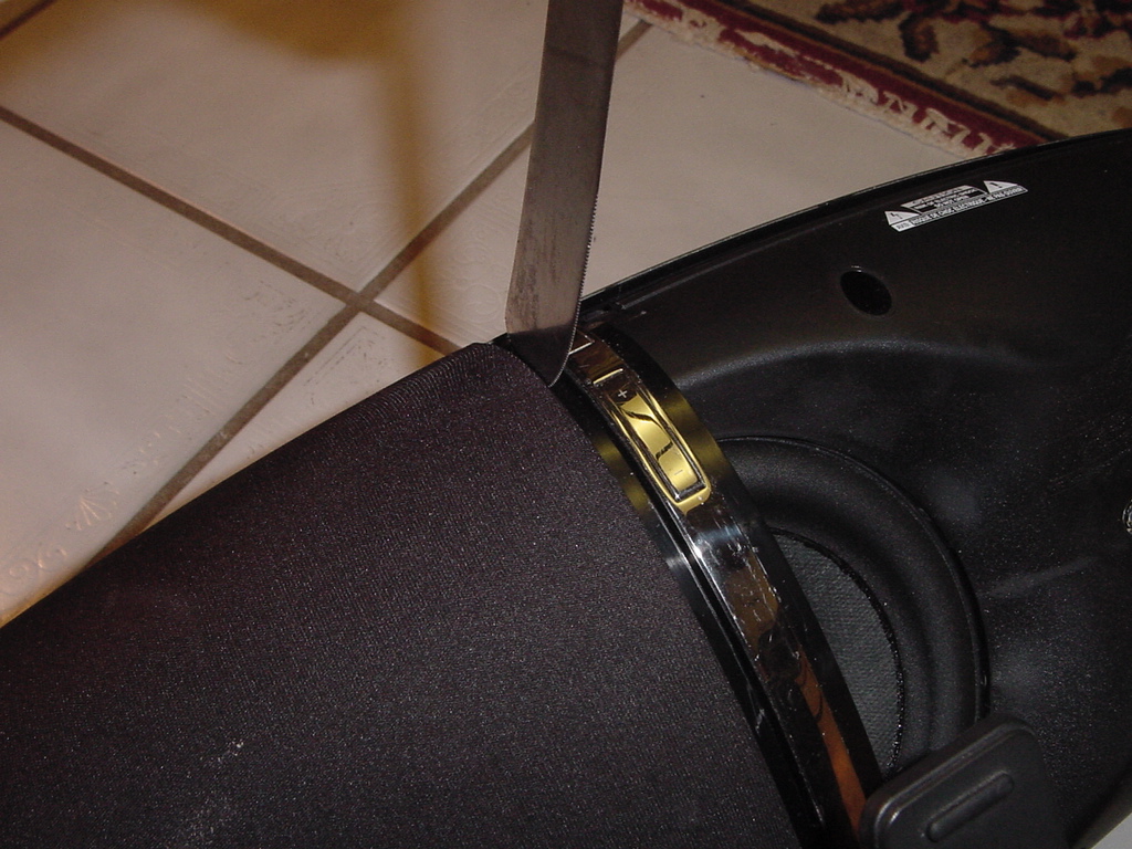

            Look on the bright side, for those of us who know how to repair stuff, it's dirt cheap if not free to acquire a lot of electronic toys and fix them to the point you feel they're MORE reliable than if you'd been given the same thing brand new.
              I have to admit, these things sound great, the second one (later model) I open up which suppose to have been upgrade with better power supply, but I found bad caps (Su'scon) as well. Sorry for people that paid $500~600 for this thing.
              They are sure hard to put the grills back on.
