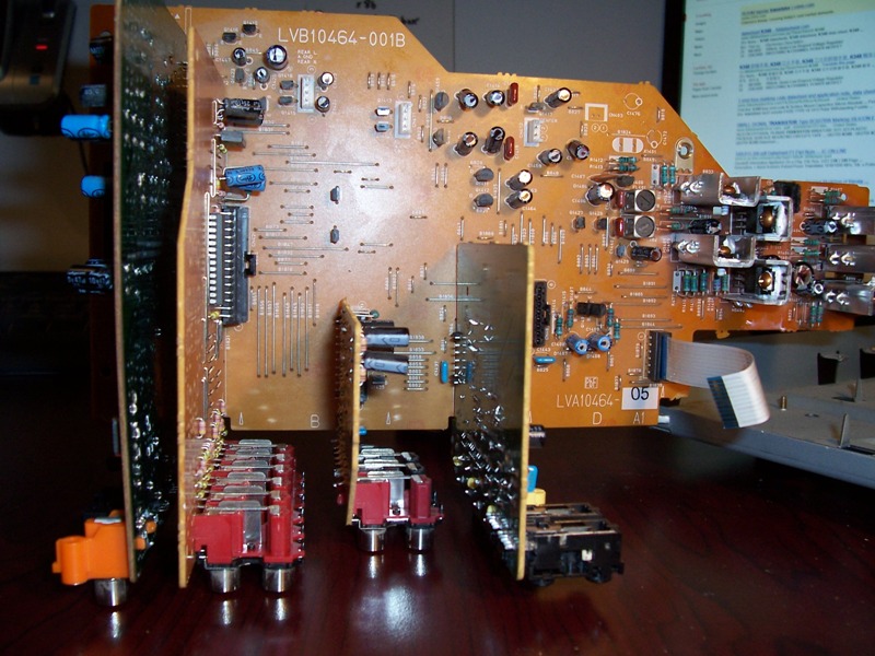

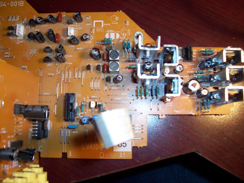

    JVC RX-6042 5 secs then shuts off
    i have gone through this amp and i can see anything visiably wrong. i have checked all the caps and replaced the ones that measure infinite ESR. i have pulled all of the heatsinked transistors out and tested them. im not sure what else to check for i cant seem to find any schematics online and im not 100% what i am looking at. i am much more used to looking at car amps. this appears to have 5 seperate audio amps they all look very similar. i have drop in boards for digital audio,analoug audio, radio tuner, and some analoug tv stuff. there is a main power board coming off of the mains transformer and from there it goes to what i think is a bunch of heatsinked rectifiers for DC.
    im not sure where to start looking so i took just a few pictures if anyone can help me i will gladly post more, im just not sure where to start.
    all caps have been checked and all TO-220 transistors have been checked
    but now i am only left with T0-92 and im not familiar enough with this stuff to know all of thiese pieces and part numbers. and now because they are so small its time consuming looking all of them up, and it doesnt stay on long eough to start stabbing away with a meter

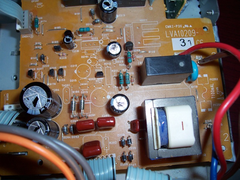

                Re: JVC RX-6042 5 secs then shuts off
                Post the schematic on a filesharing site, or export relevant portions to an appropriate size (pixels and filesize) image you can post or link.
                First random thought is, if main PSU relay is de-energizing, trace back that circuit to see what the protection or source is and what inputs or values it is using to determine on/off.
                Pull the daughter boards off, at least those that aren't soldered on, then see if power stays on. If so, it tends to indicate a daughter board fault. It also looks like there is a lot of darkened PCB area aroud some transistors, check that the solder joints and traces are intact.

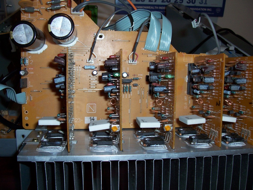

                          i pulled all 5 amp boads out of the unit and still the same symptoms. i thought it was worth a shot.
                          with the amp boards back in i measured the 3 speaker output relays and all 3 are energizing
                          with amp boards in i measured the speaker outputs and have 1.8-2v ac and dc on all channels well beyond 600mv
                          should i try with no amp boards in?
                          thanks for being so fired up for this project!

                            • 999999999
                              • Sep 2006
                              • 774
                              ^ don't hook speakers up to the outputs after having measured > 600mV DC, it can damage them.
                              As already implied in the topic, odds are either your output transistor(s) are shorted or an upstream bias transistor is shorted or leaky, though you could have a failed power supply smoothing cap (measure both power rails for excessive AC ripple).

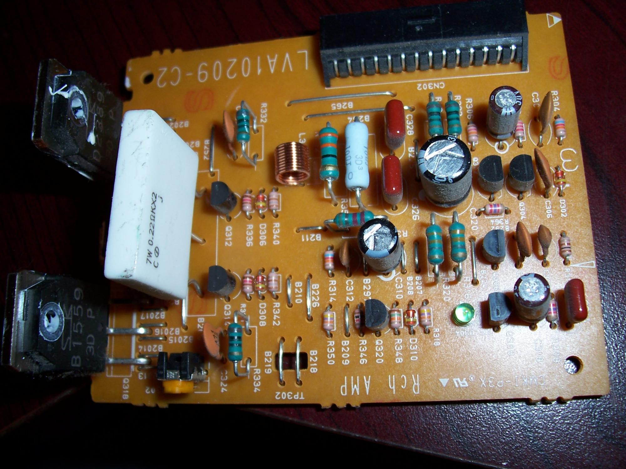

                                • scampo77
                                  • Dec 2010
                                  • 233
                                  i went through all the transistors inside this thing except these 2 big monster ones. im not sure what they do but they areright at the begining and there are 10x larger then the largest caps on the board. one has 2.5 ESR and one is open.
                                  is this my problem?
                                  ill go to the store tmrw and get new ones
                                  • 999999999
                                    • Sep 2006
                                    • 774
                                    If by the two big monster ones you mean those mounted on the big heatsink, yes those are in a position likely to fail in an amp.
                                    It's a good question why it's not only on one channel. You might trace back the audio path to see if it's DC prior to those transistors and keep tracing till you find where the DC starts.

                                      • Longbow
                                        • Jun 2011
                                        • 623
                                        I've had a better look at the speaker relay board and my thought is that all the protection transistors are checking that the speakers are connected correctly and not cross wired. That's the only explanation that I can come up with, since some lines are monitored on the amp side of the relay, and some are monitored on the speaker side of the relay.
                                        Ultimately, all the "cross wiring" protection on the speaker relay board gets mixed into one signal which appears on plug FW301, pin 5. Monitor this pin. Normal operation once the speaker relays fire, is for pin 5 to be +5 volts (it is labeled incorrectly as 0 volts). If this pin does not stay at 5 volts, the unit will shut down. Note that D1356, a 5 volt zener, supplies 5 volts to all the protection transistors. Make sure that R1355 is not open, and actually reads 3.9 Kohms.
                                        On the same board, another protection circuit monitors all 5 amplifiers. This circuit has 3 transistors (right in the middle) and 5, 100K resistors - one connected to each of the 5 amplifiers. This is a convoluted design, but necessary to prevent smoke. First step is to measure each amplifier output d.c. level and report the findings. The problem might be a blown amp, or it might be a problem with the protection circuit. You can do it!
