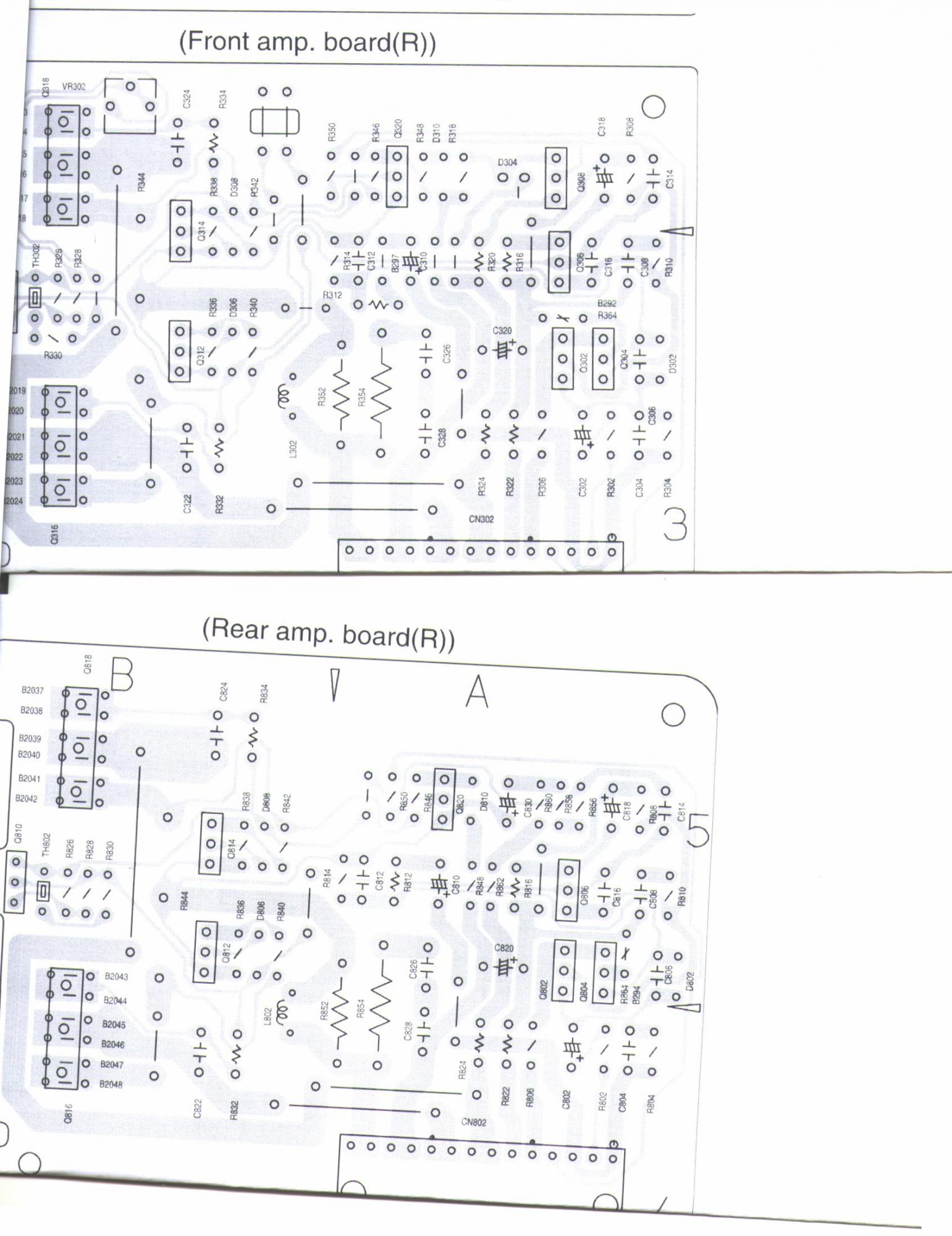

          Re: JVC RX-6042 5 secs then shuts off
          after many trails i am back and think i am close to getting this thing figured out. my fuse problem was the output case touching on the heatsink, i did not realize the case was connected to one of the legs. i have found 2 sets of darlington pairs shorted and have replaced them only to have one fail right away afterwards. on the third install it went up in a blaze of glory with flames and everything. although this wasent good it pointed with a big arrow to where i suspect my problem is.
          sandwiched in between the 2 outputs there is a collection of....
          3 resistors.
          R330 -470 ohm
          R326 -360 ohm
          R328 - 470 ohm
          1 thermistor (i think)
          Q310 - 2SD637/QR
          1 transistor (i think)
          TH302 - QAD0012-202
          i can get the radio to come on and play sounds it is just when i try to move the volume up and down that it explodes.
          R330 is the worst failure it actually melted right into the board.
          i have 5 individual amp boards and my question is if something is failed/failing should i order 5 parts and replace on all 5 amps?
          also with these failed parts, are they the failure? or a side effect of something else that has failed?

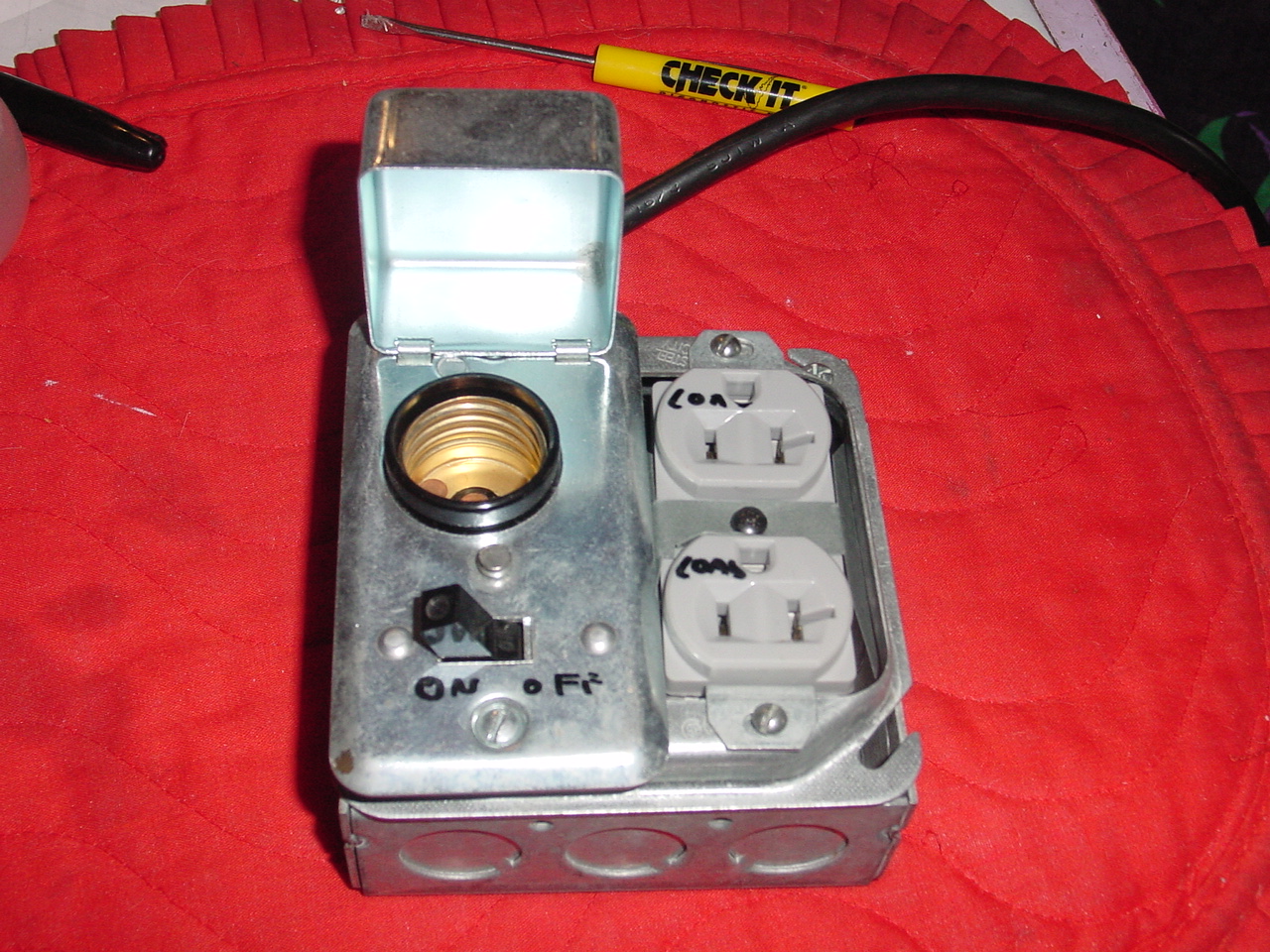

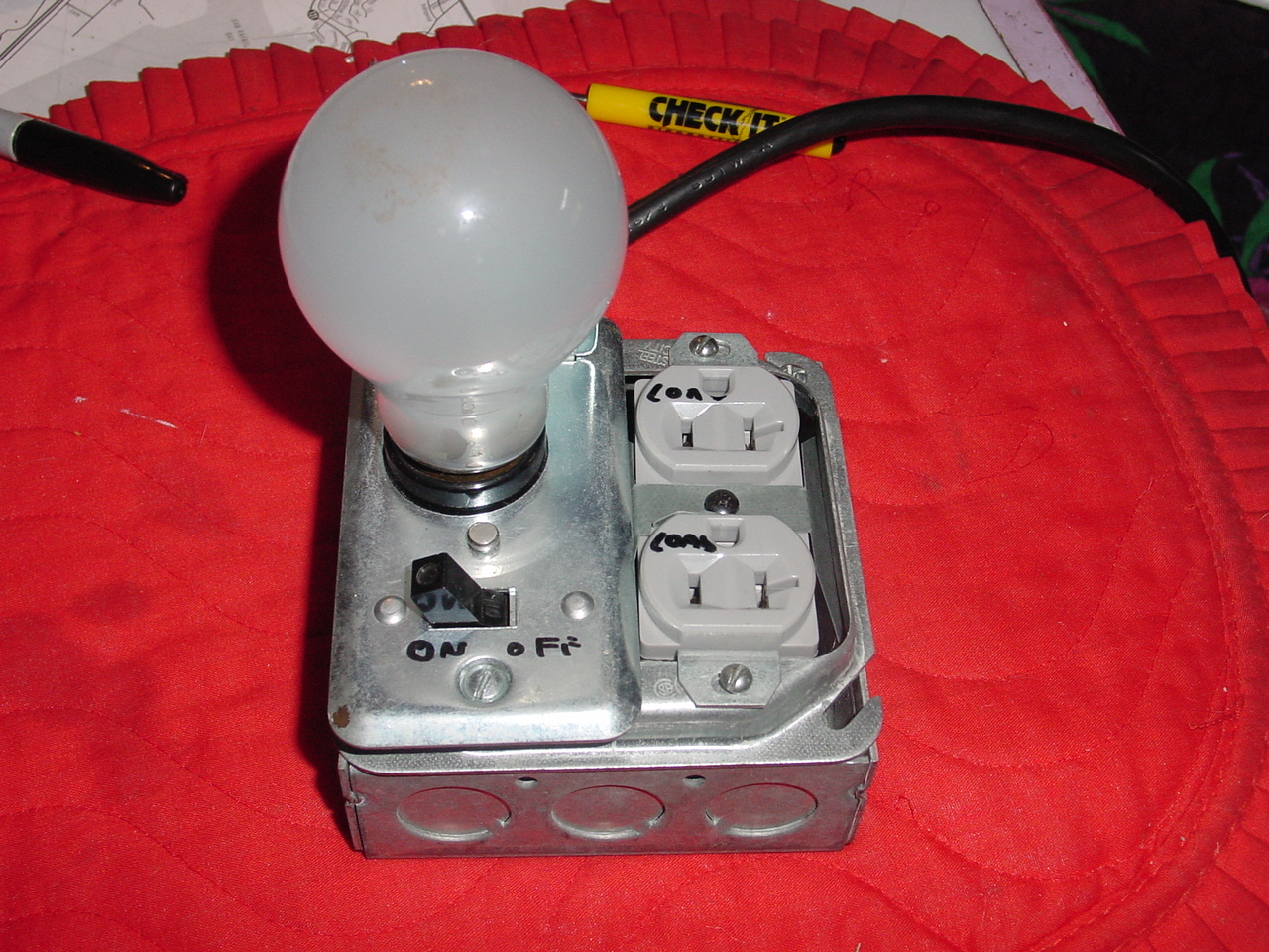

            One thing you should do to help you from blowing up new transistors, hook up 75~100 watts bulbs in series with you amplifier, that way if something shorted out the lamp will lifgt up real bright and limit the voltage to your amp. I used thsi setup for 35 years and saved a lot of new fuses and new transistors.
            to burn up the 470 Ohms resistor which is part of the Bias circuits (including the transistor) it must have shorted path for a lot of cuurent. You should monitor the bias current of the out put transistor by measure the DC voltage on the 0.22 Ohm resistor, typical class AB bias should be around 20~25mA (no input signal), so @25mA flowing through 0.22 Ohm, you should have about 5mV DC across the emitter resistor. Also check the DC offset, it should be in mV range. Pot VR302 is for the bias current adjustment. The service manual should tell you how much it should be.
              i put the lightbulb between the actual 110v plug and the wall outlet?

                      #30
                      Do you have clearer diagrams, it will be easier to explain how it works?

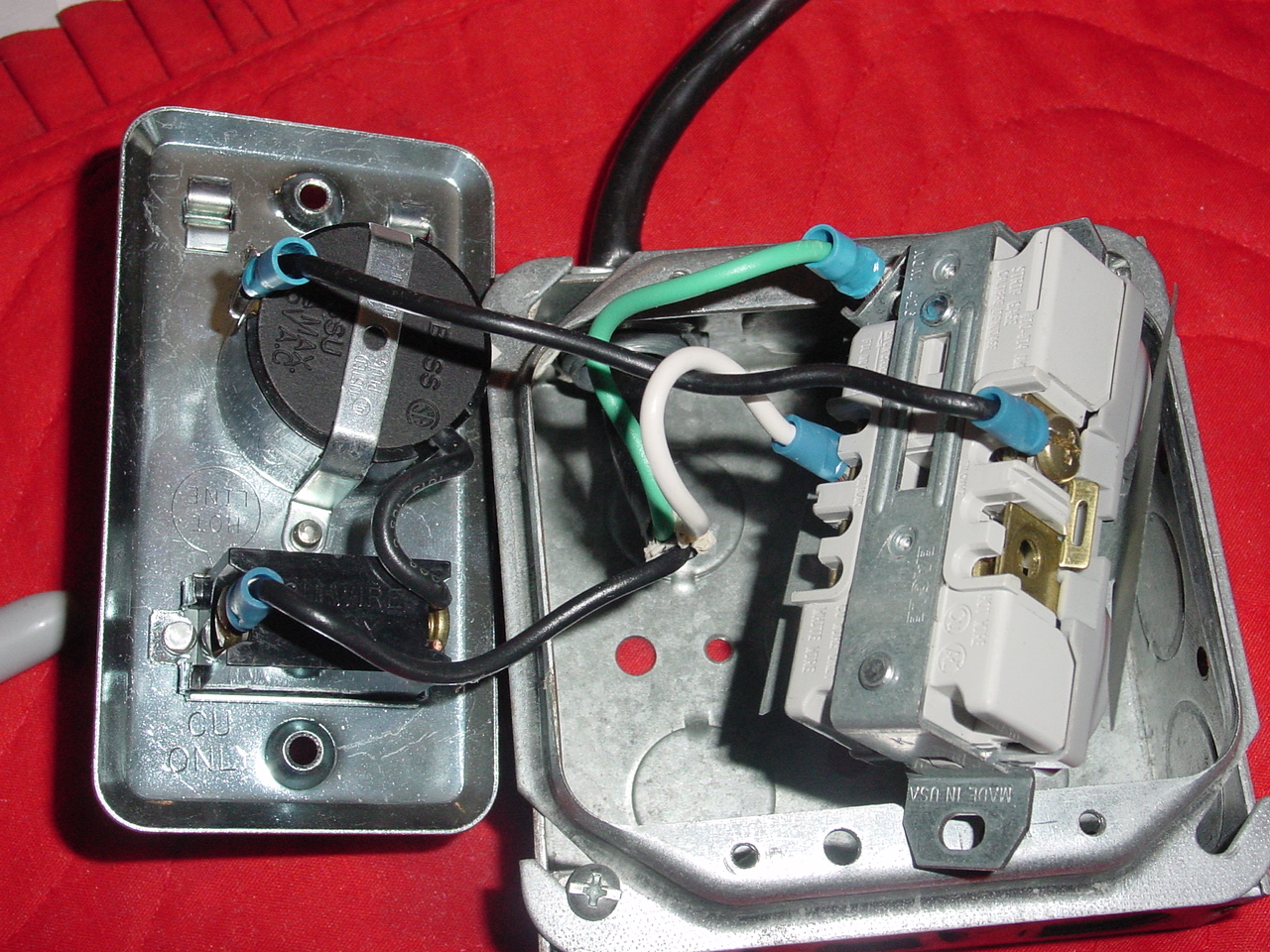

                        This is what I use to put the lamp in series with the Hot (Line) side of the load (the equipment you are repairing).
                        http://s807.photobucket.com/albums/yy352/budm/Tools/

                          #32
                          If you look on one of the first pages of this thread you will see all the pdf docs I am working with. There is a parts list, schematic, and owners manual. You can zoom in and print screen and open in mspaint so you can draw all over it.

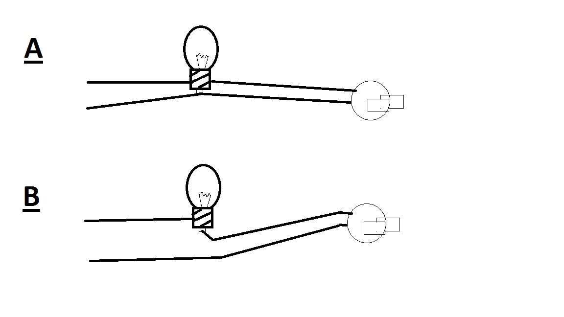

                                      i have ordered my parts but i am still very curious about the lightbulb inline thing. i dont quite understand how to wire it. i made a picture is one of them correct?

                                        #39
                                        Inline = in series
                                        You want the bulb in series with the PSU, so you want to use diagram B.
                                        Diagram A shows the bulb in parallel with the PSU.
                                        I think this method is typically done with a standard tungsten-filament incandescent bulb.
                                        In either case, I suggest you have a look at: http://www.repairfaq.org/sam/smpsfaq.htm#smpstslbt

                                          #40
                                          I use incandescent bulb, the wattage is depended on how big the amp I work on, normally, 100w bulb is good enough for moat work, that is why I made the box so I can easily change the bulb.
