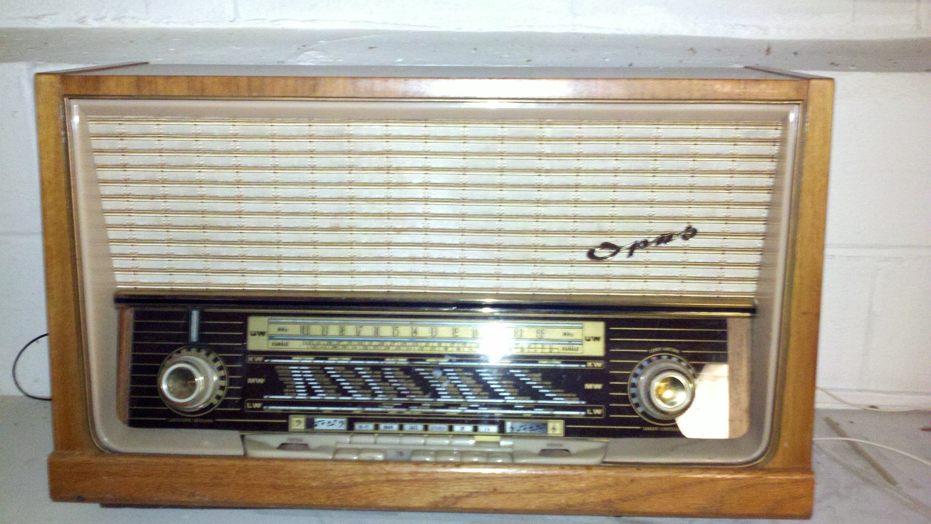

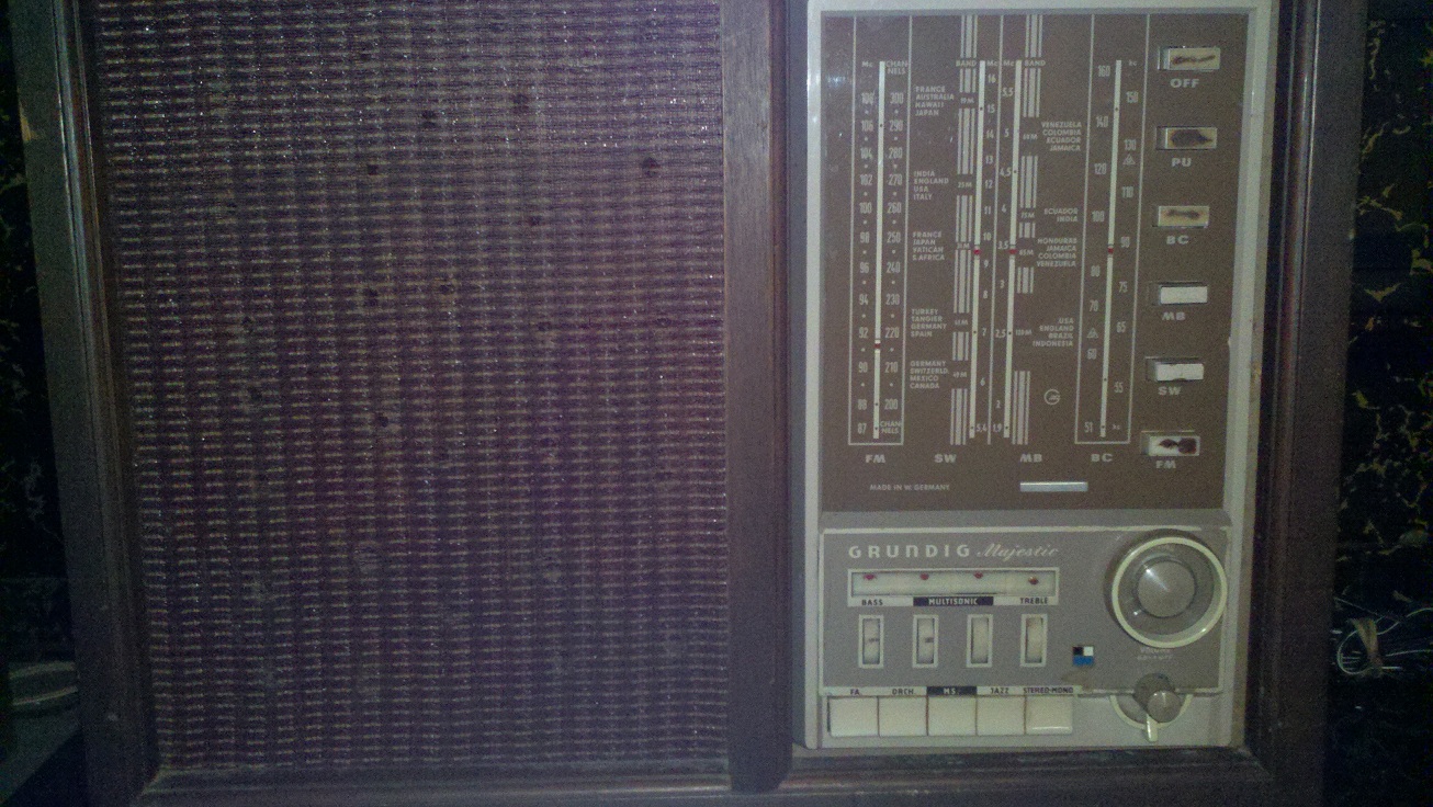

Anyone got info on these puppies? Haven't tried to power them on yet.
Found Some Cool Old Radios
Re: Found Some Cool Old Radios
The Opus is definitely a tube radio the Grundig may be as well don't attempt to plug them in without replacing all of the electrolytic and paper caps inside.
Paper caps are a replace on sight item on tube equipment. Electrolytic caps depending on how they were canned may still be usable or may have dried up. Again older electrolytic caps don't meet the same safety standards as their modern counterparts so if they were to fail there is a chance of fire.
Mica and ceramic caps can be left as is they are very reliable and almost never fail.
If either of them are line operated (no power transformer) replace the X and Y interference suppression caps with modern fail safe film caps.
In the old days they just used standard ceramic caps, mica caps, or even worse paper caps. I can guarantee that the paper caps will be long gone and the ceramics and micas aren't certified for suppression purposes. This is the only circumstance where you should replace a ceramic or mica cap if it's a line suppression cap.
Be careful with line operated units their power plugs aren't polarized so one side of the chassis can be live depending on which way the plug is in the outlet. It's best to avoid live measurements on these units unless you have it hooked up to an isolation transformer.Last edited by Krankshaft; 10-28-2011, 08:17 PM.Elements of the past and the future combining to make something not quite as good as either.
