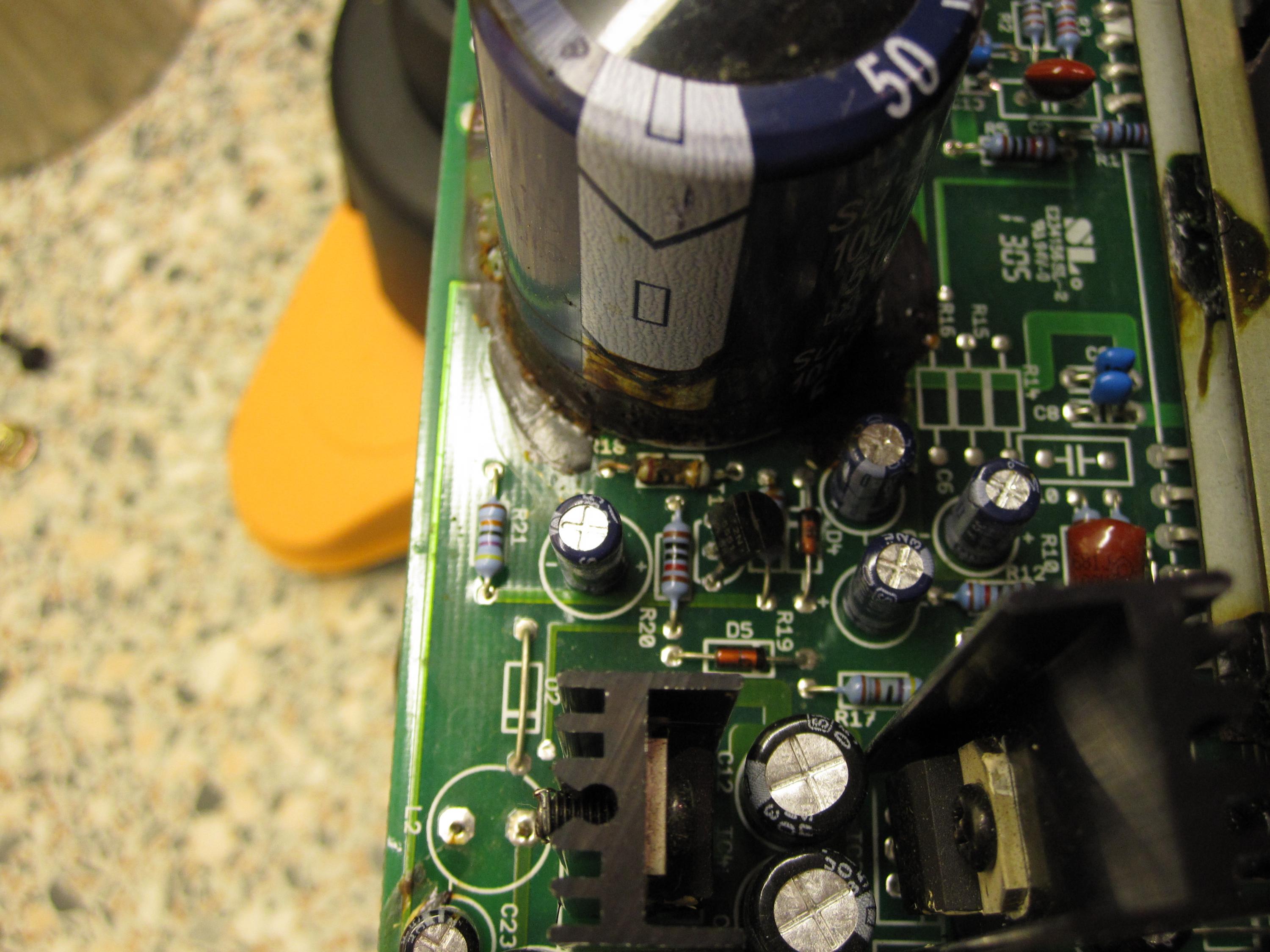

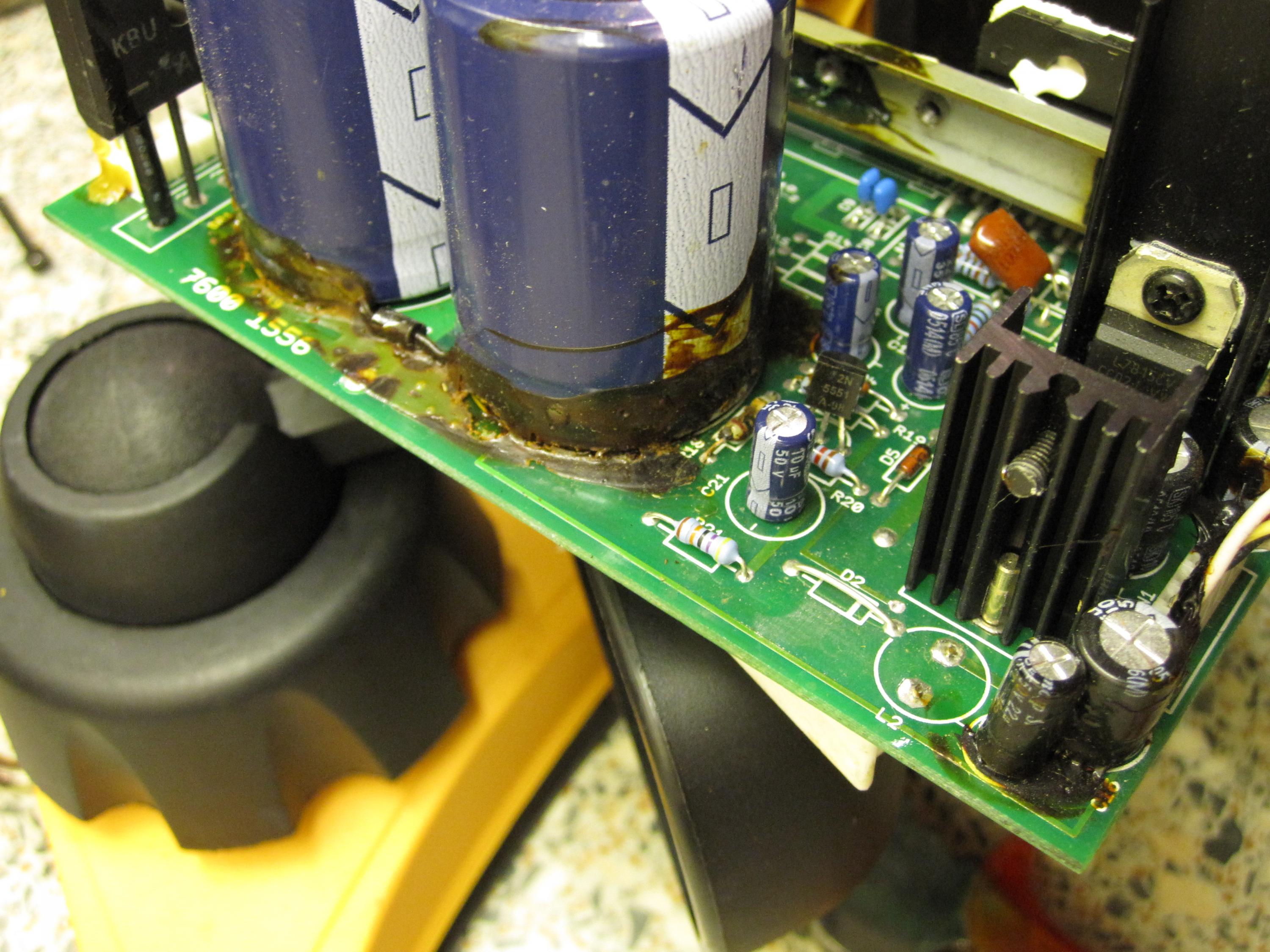

Hi there,i have a pair of 6ds that seem to have done the same thing over a year ago... Sound appeared to become distorted from one box. Then the next day it was gone altogether.. I did however manage to get the schamatics out of tannoy..so was able to start tracing the fault. As there was now no warranty support for thia product i pulled the apart and by a process of elimination, think i've narrowed the fault down to the amplifier board... But hit a brick wall when the caps appeared to test okay...
I'll sit down with this thread,the schematic and the amp module and see if i can't find the problam...
