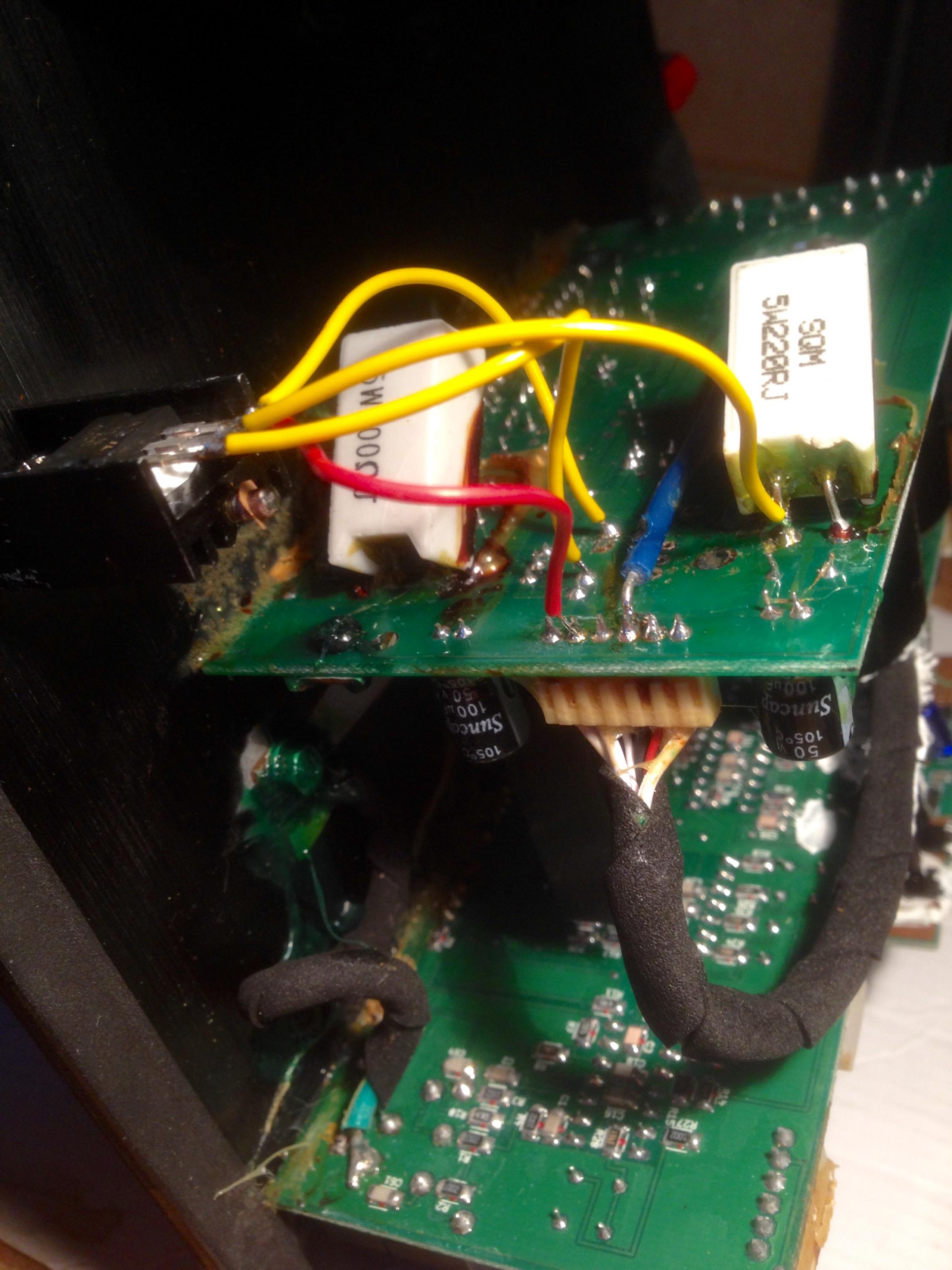

Khron asked 'Resistance between where the 7915's output should be, and pin 11 (of 14) / pin 8 (correction - pin 4 is ground) (of 8)? Answer - 976 ohm for all them. The 8 pin IC is labelled JR448AC LM833N. Another opamp? Google might know.
Edit - these measurement were taken with the 7915 back in circuit and apparently working.
The current challenge is, what's making the woofer cone extend outwards? This could be because the negative voltage rail is not reaching one of the amplifier chips. I'll try the stunt-double speaker with the HF output.

Wait - I've found a problem with my temporary 7915 wiring. Because the power board was upside down when I was soldering I put a wire from the 7915 output to the high frequency audio connector pin. I've corrected this. The pic below shows the red wire has moved from pin 5 to pin 2, comparing with the pic in post 139. I'll now recheck those speaker connector voltages. Hopefully nothing's blown up.
