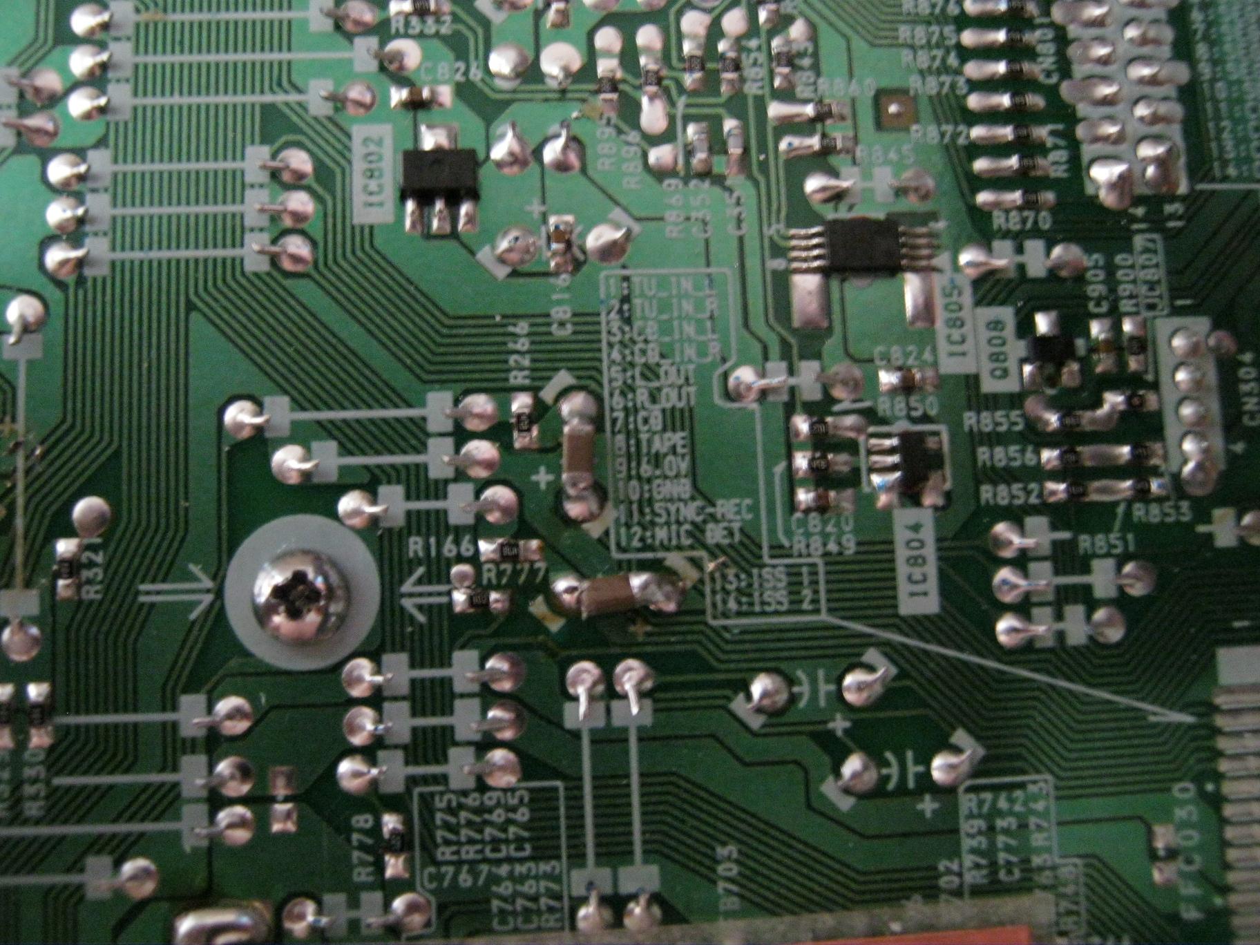

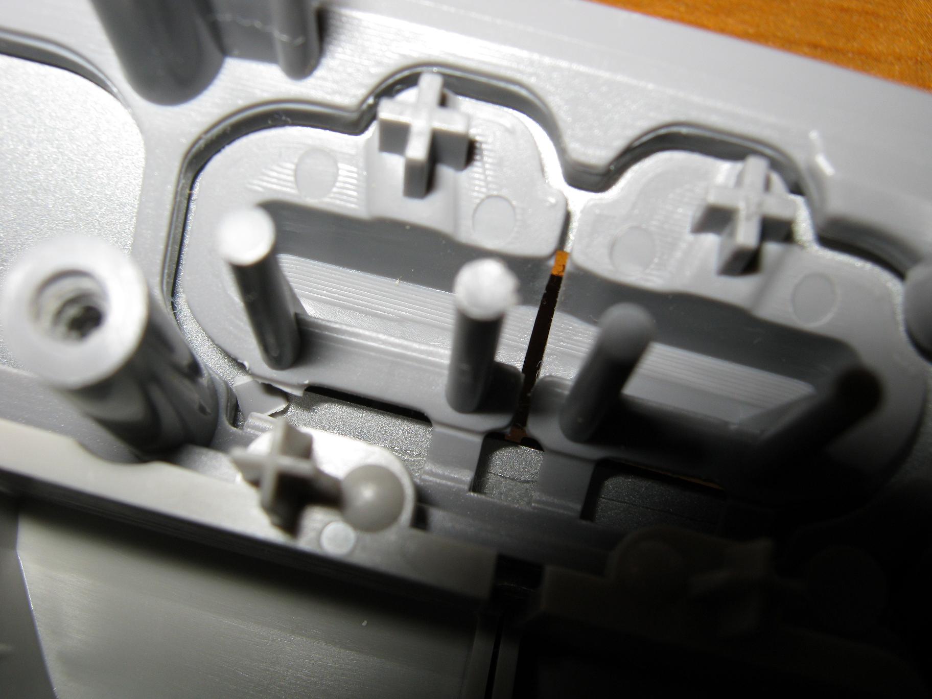

    I don't think I can fix the button. One of the tabs that attaches the button cap to the case has completely broken off.
    I also discovered that I can get slightly better sound by replacing the 1uF coupling caps on the output of the volume control IC. The datasheet for the chip (PT2257-S) recommends 10uF coupling caps. I found that 22uF caps would work even better, but I only have one of those. I don't want to use 47uF caps since that might put too much stress on the volume control IC and I don't want to fry it. The caps on the input don't seem to be as critical, even though they are 1uF as well. I will use 10uF caps on the output and 4.7uF caps on the input (if the leads are long enough - the 4.7uF caps are used).

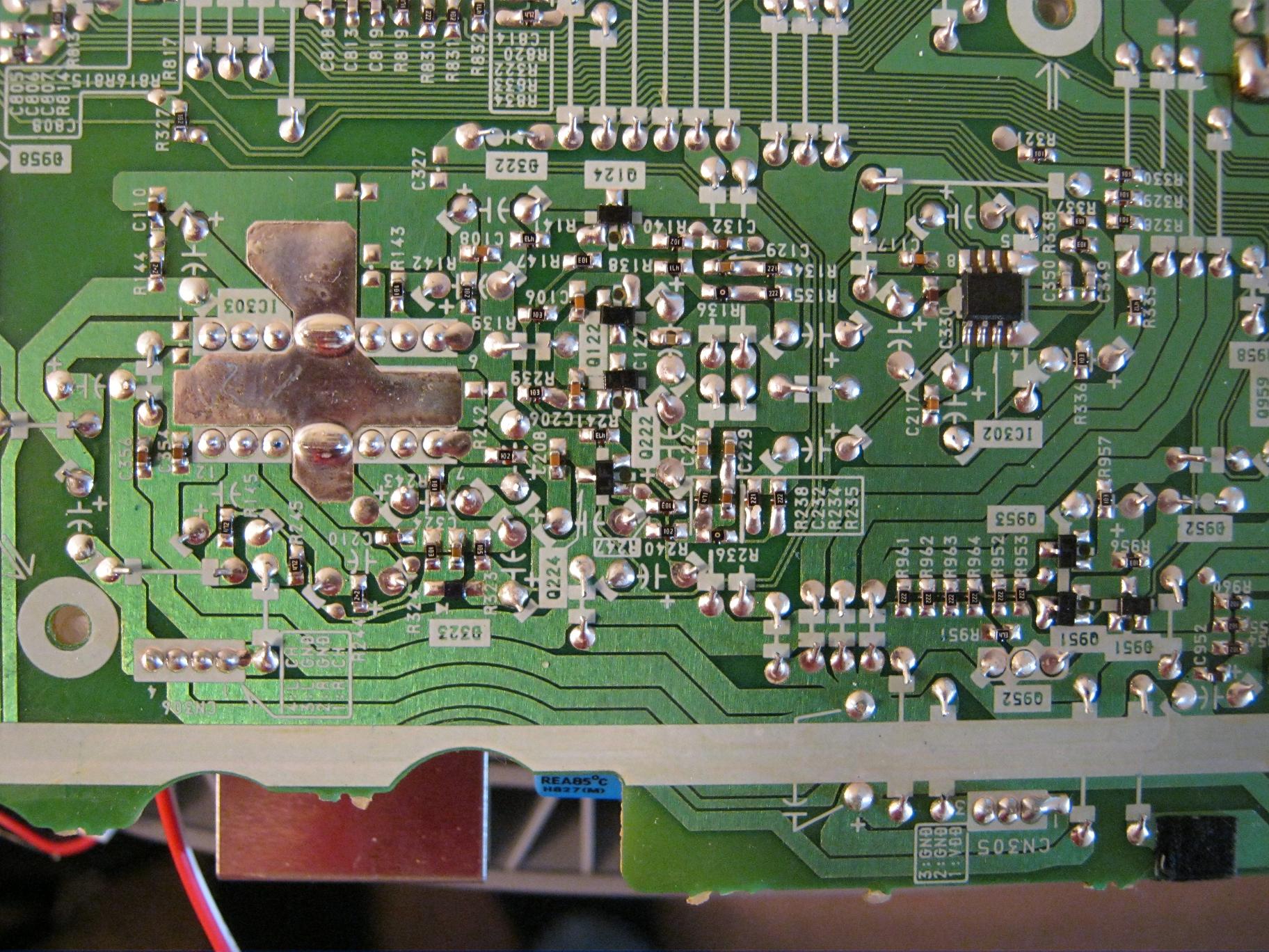

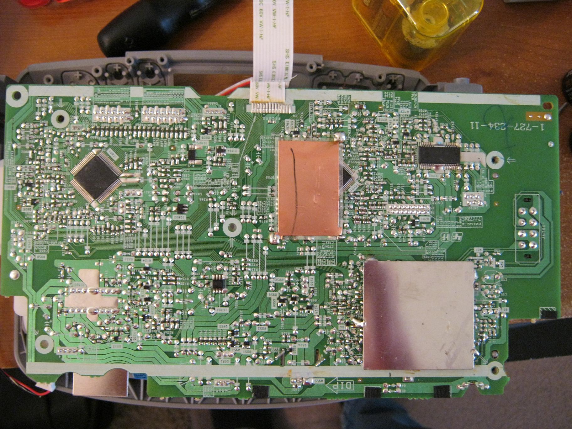

    This thing runs just as well without an antenna. It doesn't have any more trouble picking up radio stations than it did with the antenna connected.
    There are also a ton of bad solder joints. I could solder surface mounted components better than Sony could, and I have a crappy "50W" soldering iron that cost $20 and may need a new tip.
    Finally, someone signed the main board and the front panel board.

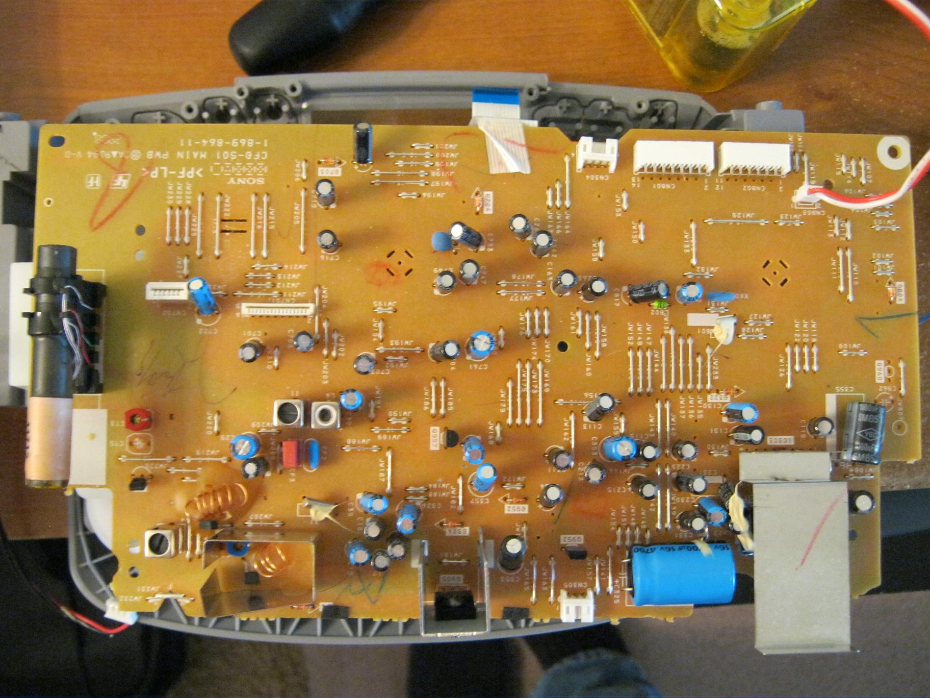

        There was another problem: the sound from the radio was distorted. I discovered that the coupling caps between the tuner and input selector IC had negative voltage across them! The voltage was positive when the boombox was first turned on, but it became negative after about half a second. I replaced these with nonpolarized caps and the sound improved.
        Now I will play a CD on this boombox and a properly working CD player to compare the sound quality. The lack of bass might be my crappy headphones.
        • lti
          • May 2011
          • 2557
          Re: Sony CFD-S01 ghetto blaster modifications
          There is almost as much bass as a decent CD player. I may upgrade the coupling caps between the CD player and input selector, but I can't find the ripple current specs on the old FOAI CD110 1uF 50V caps. The datasheet on the Foai website does not load. I have two 4.7uF caps left, but I don't know what brand they are.

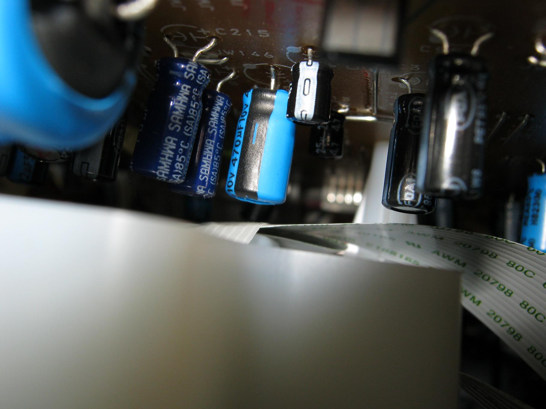

            Here are the details if anybody wants to do this:
            The capacitance of C115 and C215 need to be increased to a value between 10uF and 22uF. C163 and C263 need to be replaced with nonpolarized caps. I improved FM reception by resoldering JW231 and JW232. These are both soldered together and the FM antenna touches these jumpers to make the connection. Three of the four solder joints were cracked and the fourth must have been bad as well. None of the other caps need to be replaced, but I replaced C113 and C213 with 4.7uF caps as well. You can upgrade C162 and C262 as well (the CD player coupling caps), but it won't affect the sound very much.
            I didn't have any through hole nonpolarized caps with enough capacitance, so I used surface mounted caps and soldered them on the back of the board. The soldering looks bad on the bottom cap in the first image because both solder pads on the board were damaged. It was easy to lift pads on this board.
