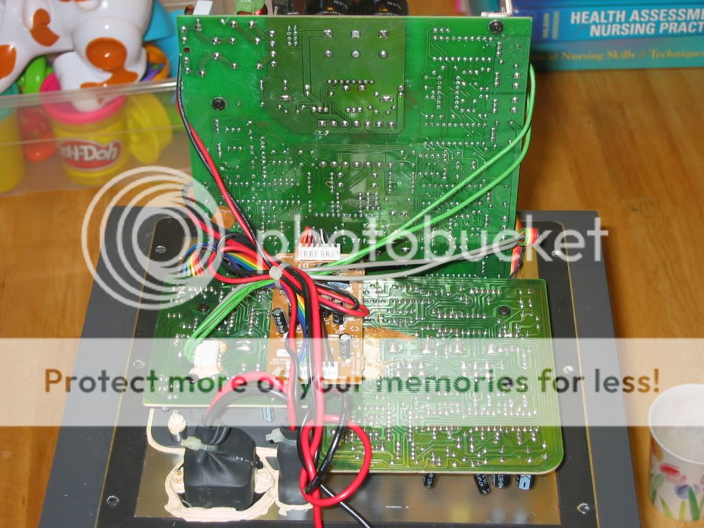

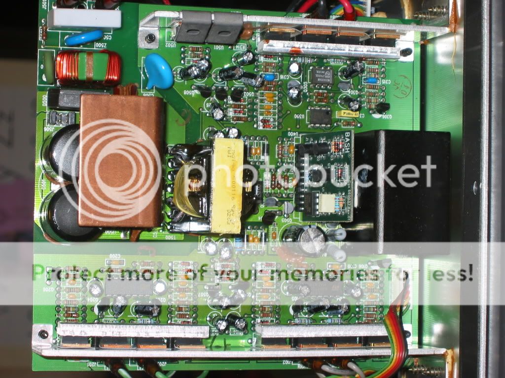

    Greetings all!
    I am an owner of a 8y/o Cambridge Soundworks computer speaker set (Megaworks 210D). Just recently, both satellite speakers and the sub have starting making an irritating buzzing sound. I have ruled out ground loop by disconnecting all inputs except the power cord and also tired various outlets in my house, yet the buzzing remains. Oddly though, sometimes the buzzing is very loud and at other time is barely noticeable.
    Doing my due diligence, I did some research and found that the culprit may be bad capacitors and/or zeners. CSW wants $75 PLUS round-trip shipping to repair the amp. My question is, is there anyone who would be willing to walk me through a repair given pictures of the amp board? I am quite teachable and would be willing to post a movie on youtube for others' reference.

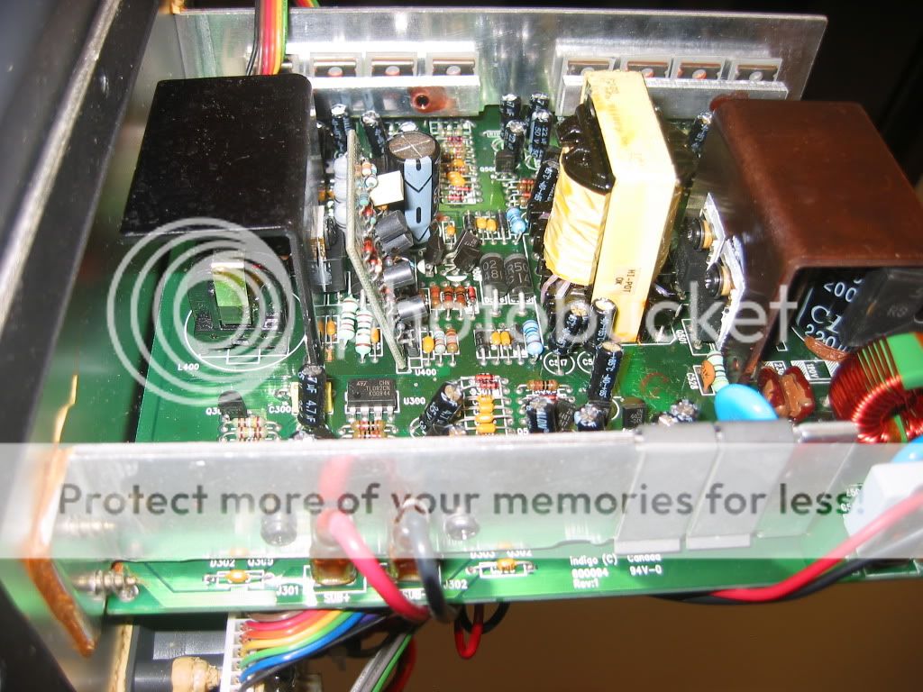

    The first thing we're going to ask you to do is open it up and take good clear pictures. Start with pictures of the power boards in the sub - unless you know they're somewhere else.
    Attach them using the manage attachments options.

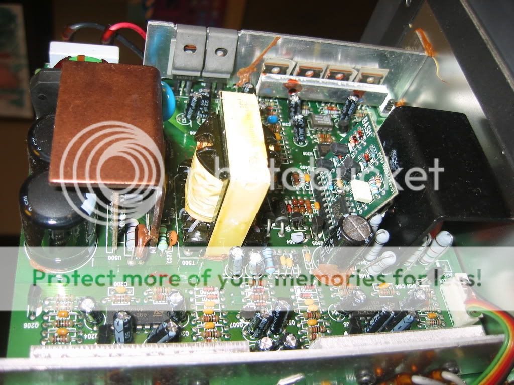

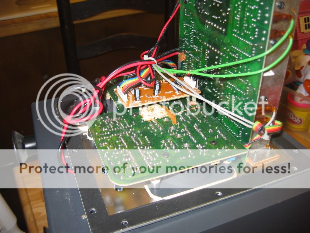

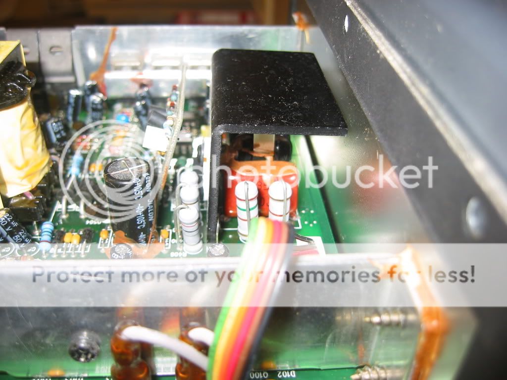

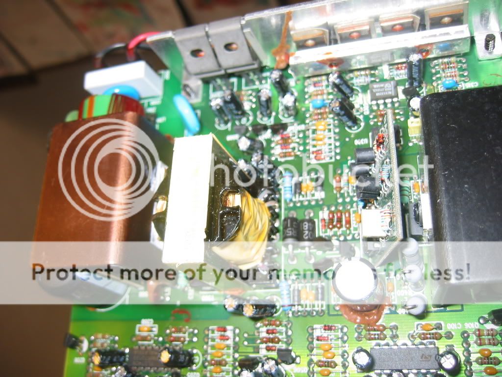

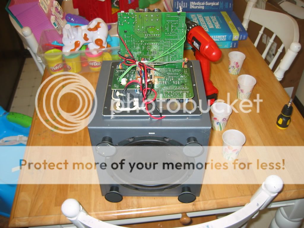

      I know it's been awhile since I made this post, but I finally got around to taking the pictures of the power board inside the sub. Let me know what to do next, thanks!
      • ljbrandt
        • Nov 2010
        • 32
        Re: Integrated Sub amplifier repair
        I should also mention the buzz heard in the speakers is loudest when the speakers are first powered and then slowly subside a bit when the unit 'warms up'. Hope this helps too.

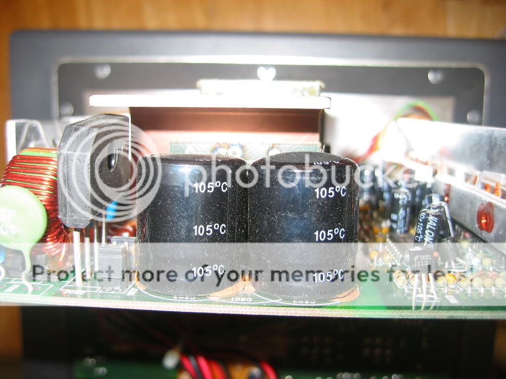

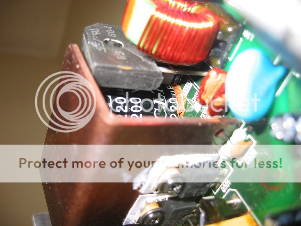

        • ipman
          • Jul 2011
          • 159

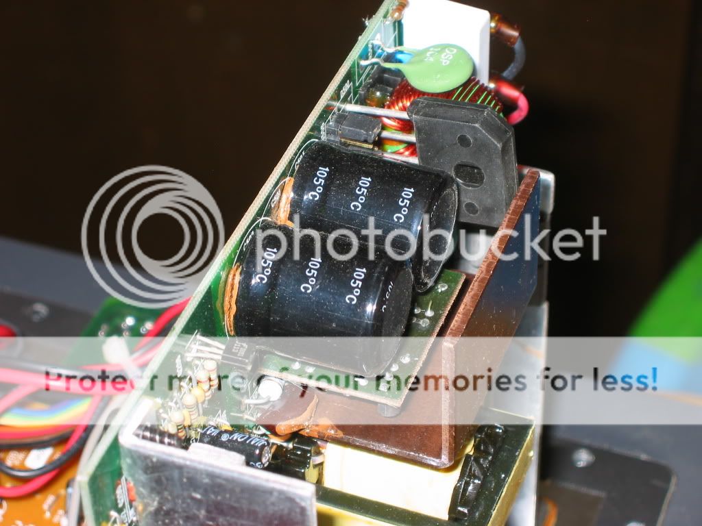

          I see one of the big filtering caps bulging. Can't read the value in your images.
          Remove it and measure capacity and ESR if you can.
            Does 220 uF / 200 V mean anything? I've never taken a capacitor off of a PCB...may have to look up how to's on youtube.
            • seanc
              • Nov 2008
              • 1319
              Have you any experience with soldering?
              If not do some Youtube searches...
              220uf is the capacitance, 200v is the voltage the cap can handle.
              Width and height also need to be factored in when looking for replacements.
              I would replace the pair.

                  Snap-in and choose the Panasonic if it will fit.

                      Despite what Newark says, the ECOS2DA221BA is snap-in. Look at the datasheet, also I've bought the TS-HA series before so I know they are.

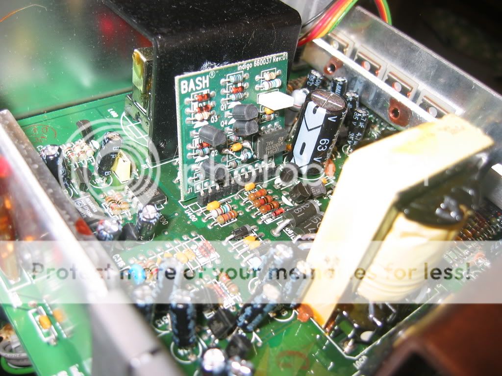

                          master hoarder
                          • May 2008
                          • 12175
                          • Bulgaria

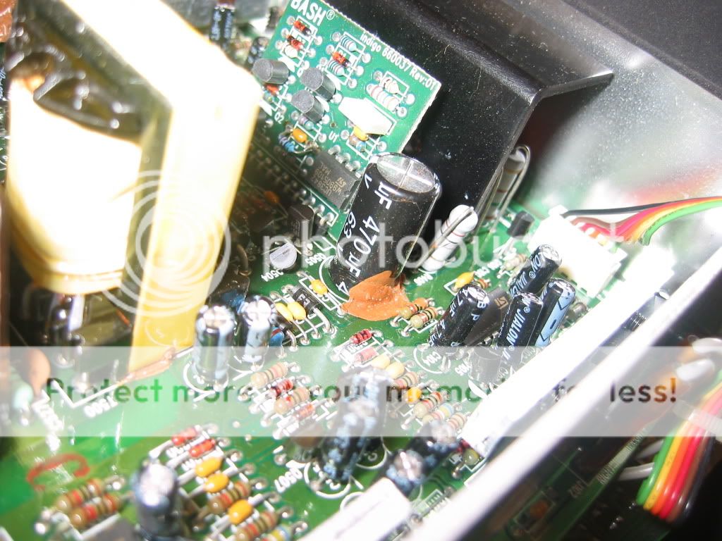

                          If you haven't ordered the caps yet, get a 63v, 470uF cap as well. There's one like that on your board and its quality looks rather questionable (as do the other smaller caps as well, but those usually don't endure that much stress so they don't need to be replaced). The power supply in your amp is an SMPS, so for the 63v, 470uF cap, any of these caps would be a good replacement:

                          • ljbrandt
                            • Nov 2010
                            • 32
                            Unfortunately, I have already ordered the 220uf 200v power filter caps. I did notice the 3rd cap, but didn't think to order it :-(. I may give the power filter cap replacements a try 1st and see if that works and then order the 63v 470uf later. One follow-up question though, I noticed a brownish substance between the large caps and the board...is this some type of adhesive to counter-act the vibration in the sub? If so, do you think this may cause difficulties in trying to remove the old caps...and would I need to use a similar adhesive paste when installing the new caps? Thanks in advance!
                            • seanc
                              • Nov 2008
                              • 1319
                              Yes it's adhesive, which you should find is nice and crispy and will break easily.
                              Don't bother replacing it.

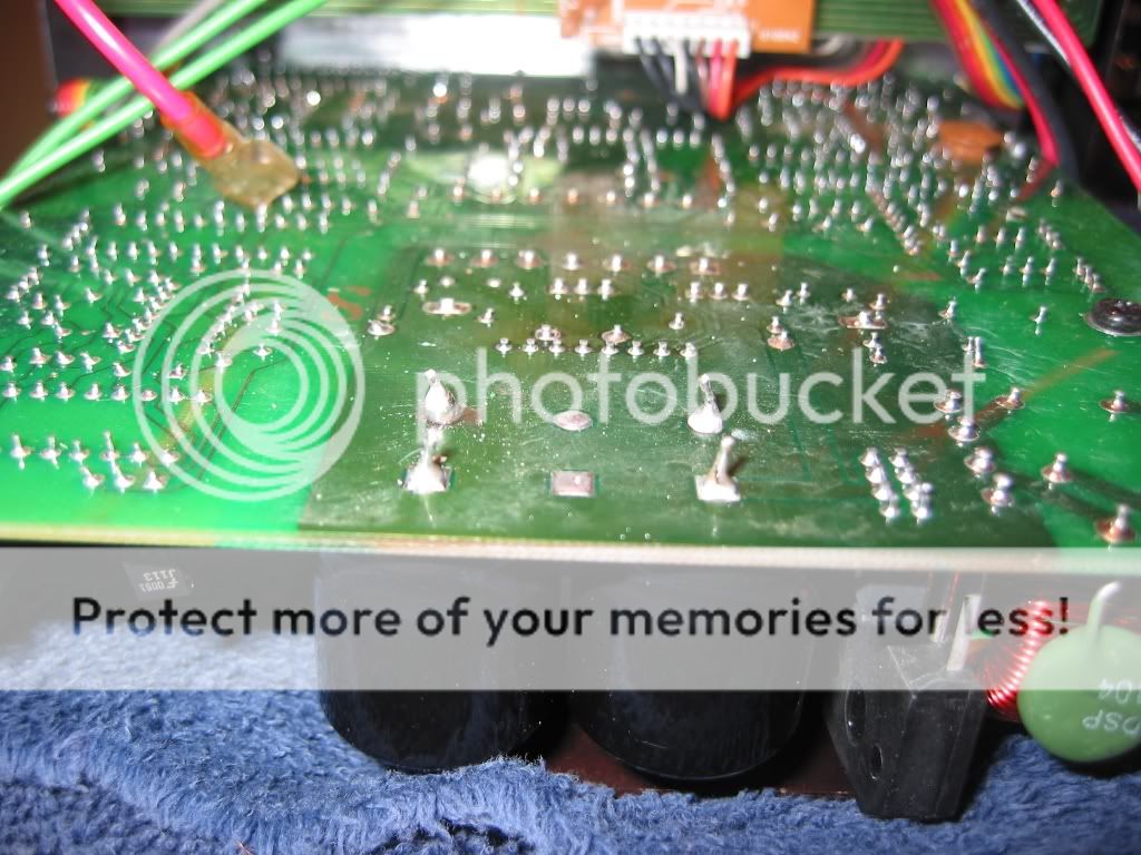

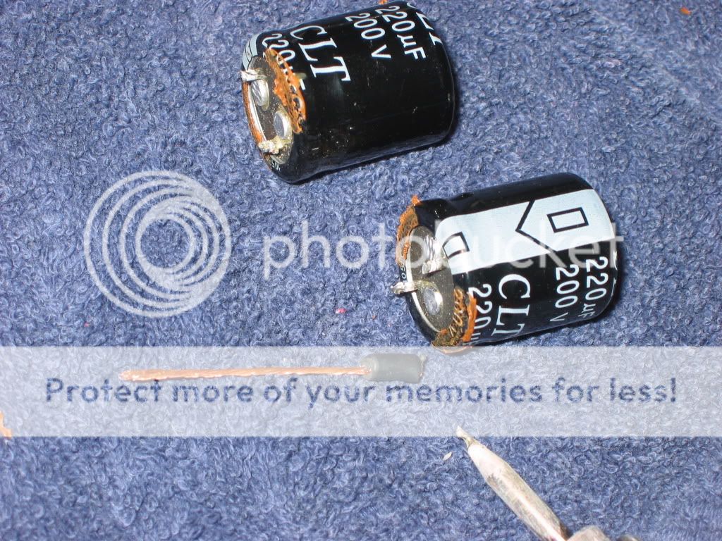

                                SUCCESS! Sounds just as good as the day it was new! Actually, I forgot just how good this 2.1 system really sounds :-) All from only replacing the two power filters caps - funny that I didn't even know what they were called.
                                I'm not sure the purpose of the 63v 470uF cap is, but I'll just let it ride for now since everything seems to be working. One thing I did find alarming though was that the brown "L" shaped metal piece just above the power filter caps seem to get VERY warm just from a short period of testing. I'm hoping this is normal for that part as I have no idea what it does.
                                Complete newbie, first time soldering, EVER much less messing with caps...but low and behold, a $2.99 soldering iron, $1.99 lead-free solder and a few youtube videos did the trick! Saved me at least $75 from having to send it in to Cambridge Soundworks.
                                Seanc, momaka & ipman - thank you so much for your help! If you guys ever happen to be in Montgomery, AL let me know and I'll buy you a beer!

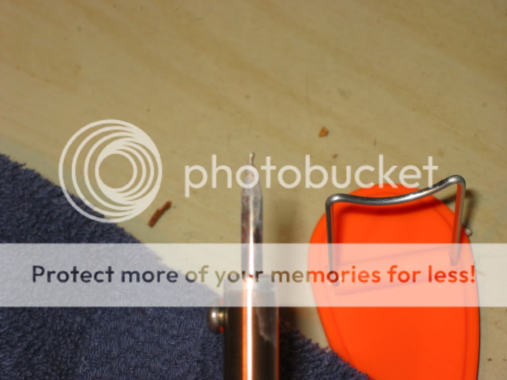

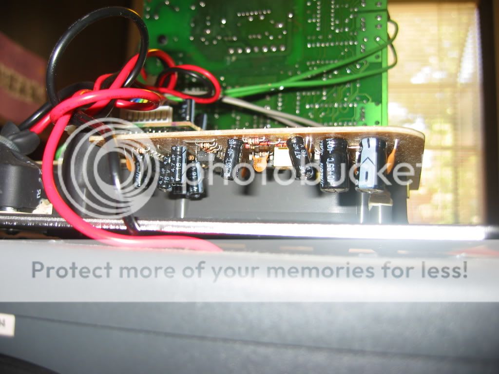

                                Here are some pics of the result - notice the top left solder joint gave me some issues...the solder just didn't want to adhere to the base of the joint and I ended up having to redo it a few times (used my vacuum cleaner to suck off the old solder). Not pretty, but I hope it holds..only time will tell. Thanks again guys!
                                Solder joints on new caps (not super pretty)

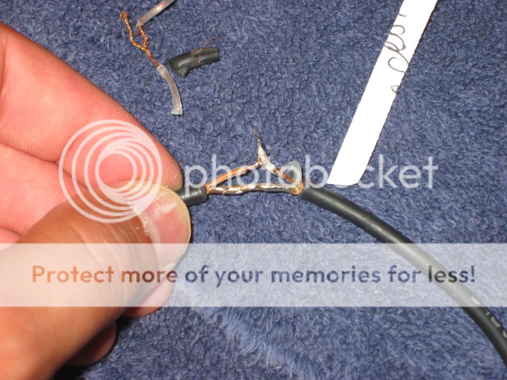

                                Messing around with repairing a broken microphone cord
                                Cheap Harbor Freight soldering iron...tip already broken
                                The old caps
