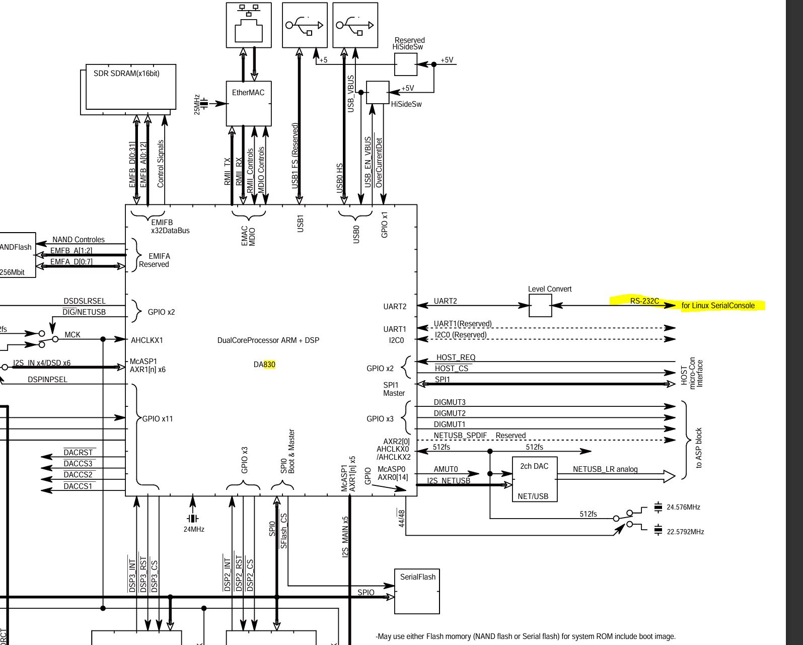

    I have a TX-NR609 which shows the usual issue with the DSP on the HDMI board.
    How do I know? I managed to revive it with heat. Then it failed again. I reballed it, it lasted 3 months then failed again for good.
    I ordered one from China - not knowing that
    1. It's likely fake
    2. It's likely pulled from another broken machine
    3. There is a revised version which does not fail, which was never sold outside of OEMs so unlikely to be found online
    I installed it and it didn't work.
    The bottom line is that I have this nice amplifier which works besides that IC. I don't want to throw it away but I don't know where to find the replacement IC or board. I could try China again - and maybe this time not wait 6 months before installing it so I could ask for a refund?
    I read a thread on a forum where someone with great experience on the subject said that the only way is to find a replacement HDMI board with the latest DSP version on it. I am unable to find it.
    Any ideas? I'd hate to throw it away even though it's not worth much.

    Try flashing nand with firmware dump... it's sometimes broken

      oh yes, I was supposed to try that - do you know where I could find the firmware?
      I believe on another forum there was a note about connecting via serial and see if the IC is trying to boot

                          Re: Onkyo NR609 usual Dolby/DTS DSP failure
                          out of curiosity I managed to connect to the IC via RS232.
                          If I spray it with cold gas it fails to boot or hangs during boot.
                          What's weird is that it just needs 60 seconds to warm up, then it ALWAYS boot.
                          My previous cases were more digital: either they'd work or they'd not.
                          All I can do is to reball it (it's an A revision which in theory is not in the list of affected chips) but I don't think it's the problem as it really takes a tiny amount of gas to stop it and if I mechanically tinker with it I don't see any effects.

                              The issue with this IC was acknowledged by TI, the manufacturer. Heating it up only fixes it temporarily. There is a newer revision available which should not fail but it was never made available to the public.
