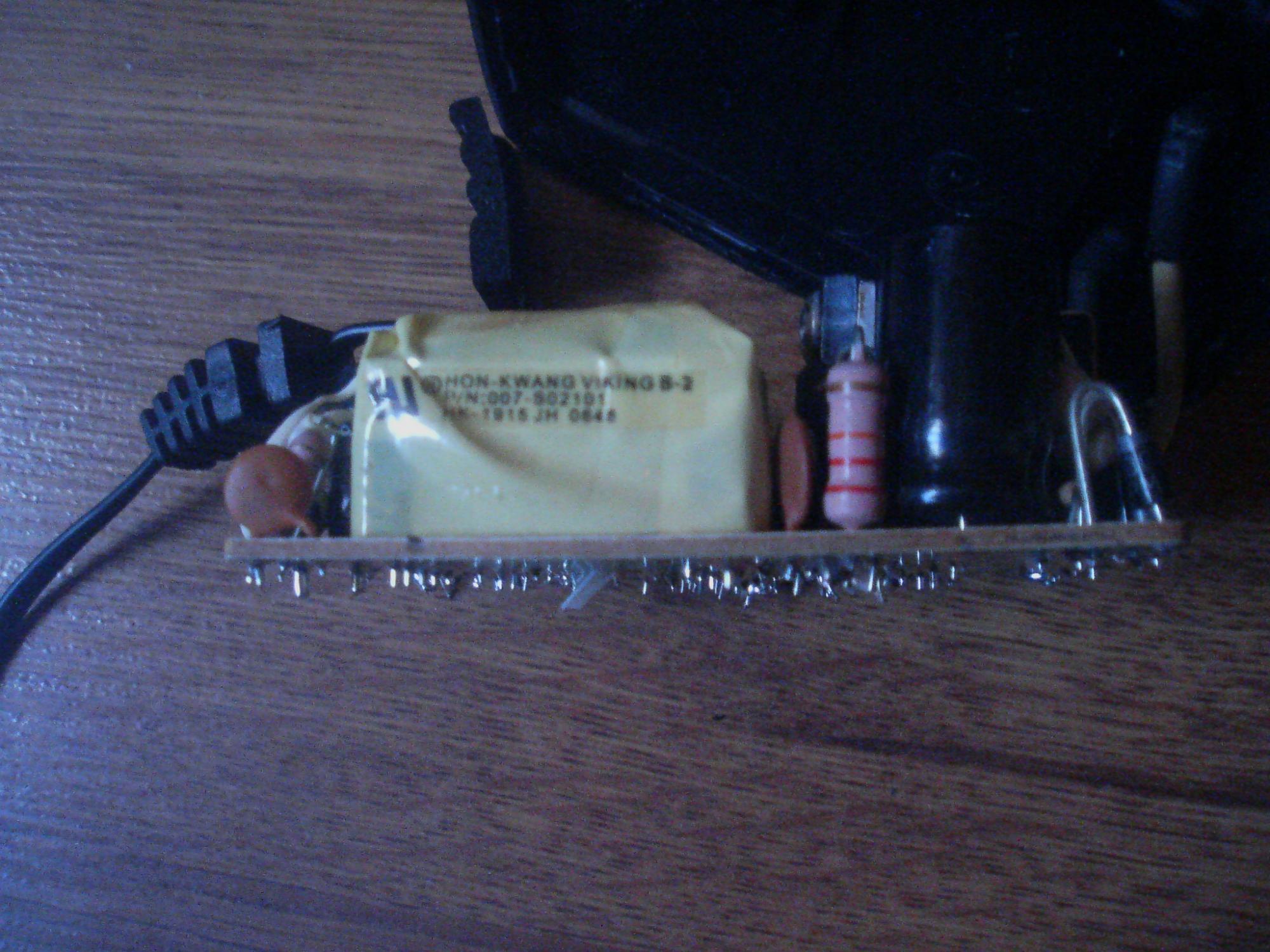

    I've had this thing in for a couple weeks, gotta wait for the firewire controller IC to arrive. For any of you who aren't familiar with this, it's a realtime firewire DSP, mixer and mic/instrument preamp. It costs ~$900 nowadays, when this one was bought 5 years ago it was $3k. And it was a factory refurb to begin with, so it isn't exactly a cheap device.
    Failure cause is a common one for this model. The owner borrowed it to someone who plugged the firewire cable in backwards, frying the controller. I have some other suspicions about this (as plugging the firewire in backwards swaps the +30v supply with ground, something which shouldn't cause a failure, since the controller IC is 3.3v so obviously powered by a regulator and protected by diodes).

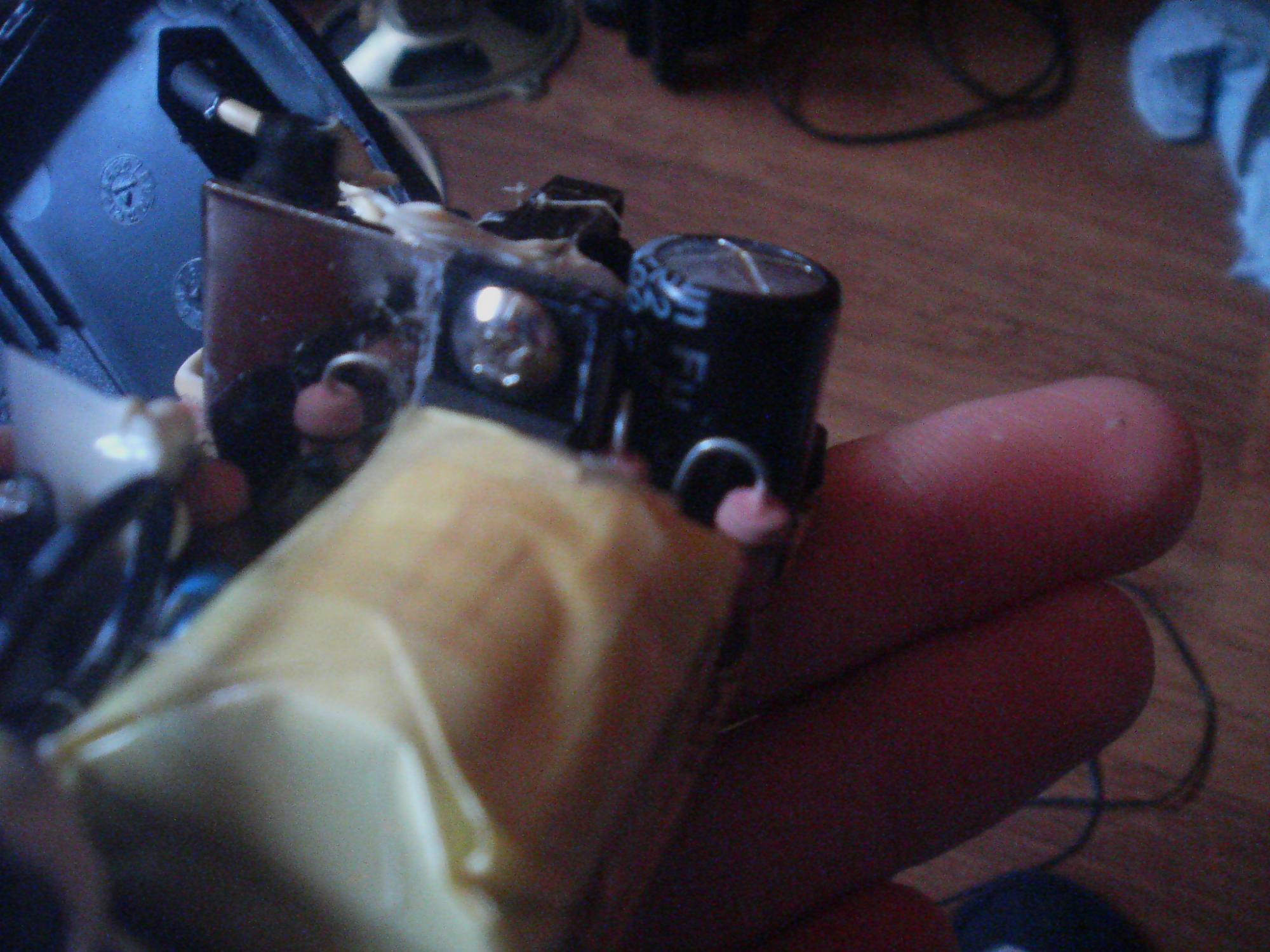

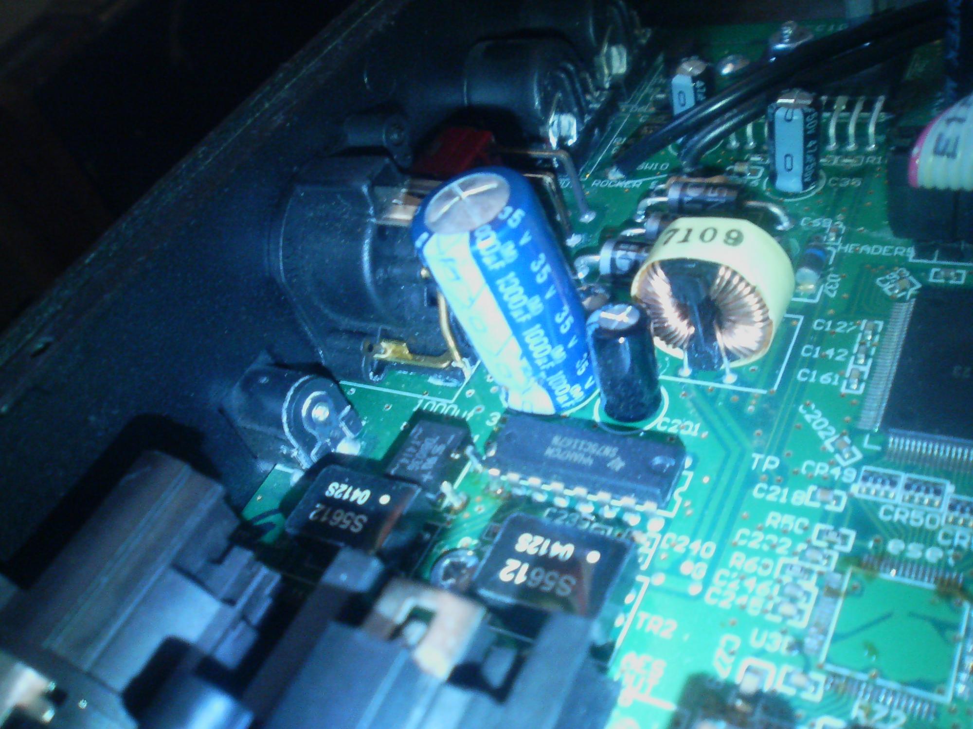

    But what's shocking is that i found the main filter cap bulged and leaking, which is an Elna 35v 1000uF, no mention of low ESR anywhere. Somebody should tell them that Elna doesn't make SMPS caps. The other caps are from Nichicon and Meritek. They look okay but NONE of them are properly pushed into the board and they wiggle around. Nice job guys.

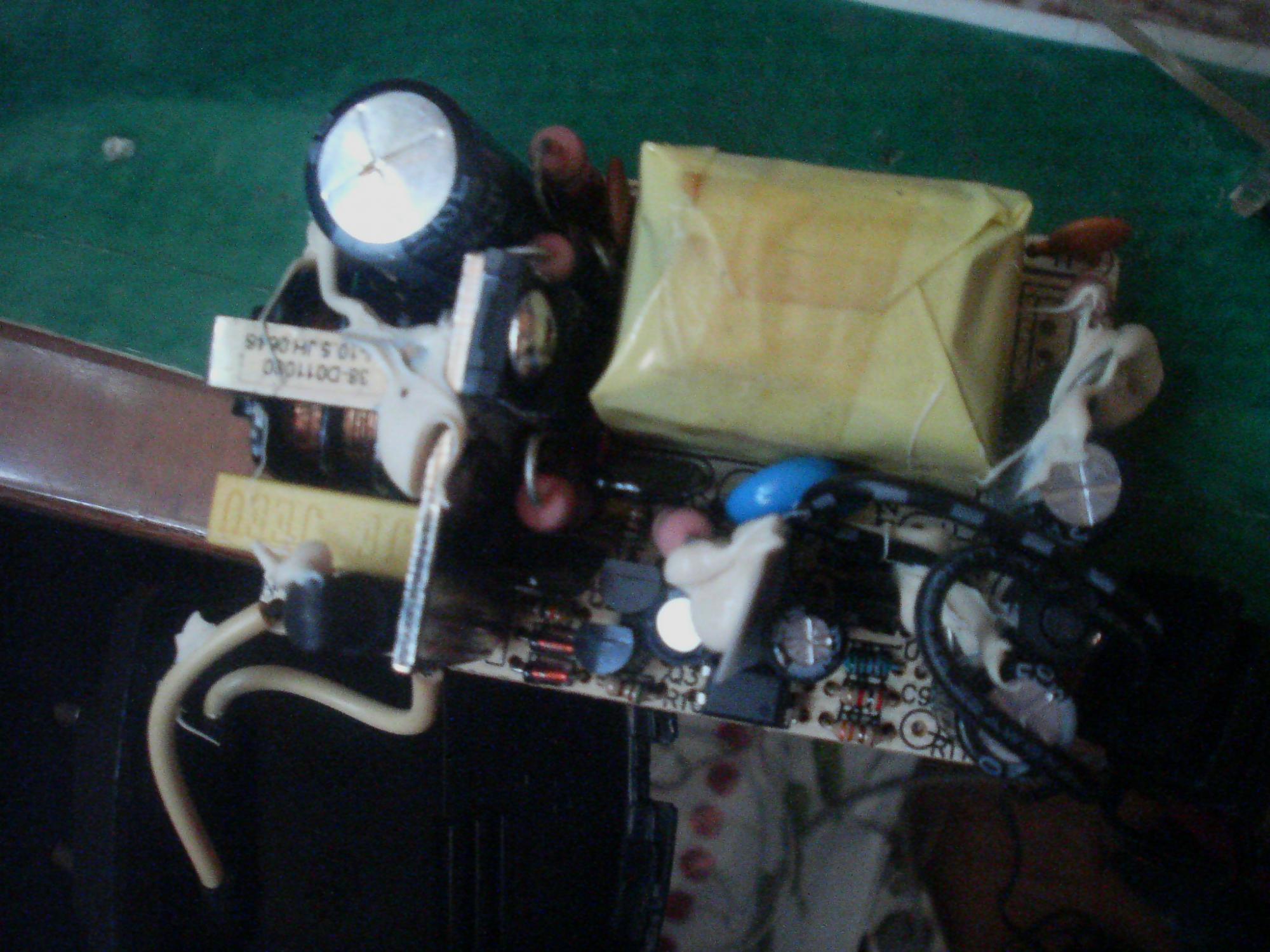

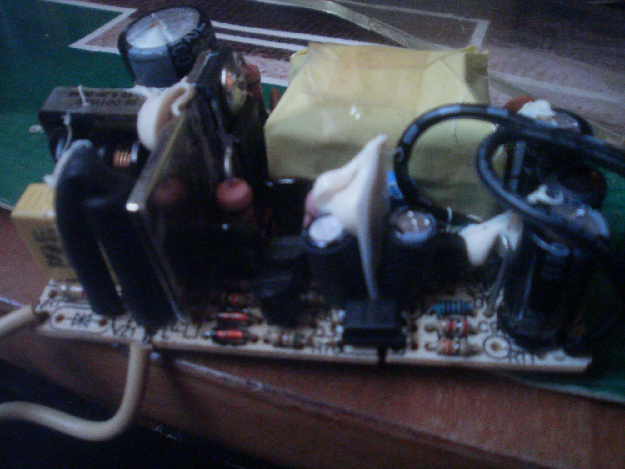

    I was bored today so i also took apart the power supply because it was buzzing and whining. What i found inside horrified me. I bet this didn't cost more than $0.50 to make. Caps are all Jun Fu, with the primary side cap leaking. Since the cap inside the device itself is gone, i'll also test the secondary caps, they could very well have gone open. There is NO CONTROLLER IC, it's a self-oscillating flyback with optocoupler feedback. Oh yeah and THE MOV IS MISSING. Is this a power supply for a $3k device??? Jeez.
    And don't let me get into what caused the failure in the first place - the bottom of the Firewire ports isn't soldered to the board, which allows the aluminum guard to split apart. Everybody i asked about this told me "no way it was plugged in reverse, it's foolproof!" but i was surprised about how easy it actually is to plug the cable the wrong way around in this thing. This is an unacceptable design fail. And all it would take to fix would've been a blob of solder.
    Sorry for the pic quality btw, i forgot where i put my camera.
    Edit: Primary cap tests OPEN. I threw it on the scope just for fun, and... 200mV p-p 50Hz ripple, 300mV p-p switching ripple and 600mV p-p high frequency ringing, most likely from the transistor switching spike. Those numbers are with the power supply UNLOADED. And consider that it actually goes thru a pi filter. I think this can truly be called "made by HongKongFlyApart, LLC".
    Edit 2: The 600mV spikes were coming from my cellphone charger nearby. I unplugged that and now there is "just" 400mV. Doesn't make it less bad however.
    Last edited by dood; 10-20-2010, 11:25 AM. Reason: Cut out duplicate text as requestion by OP

              The ICs arrived today. However i didn't find any SMD flux, and messed the first chip up by trying to tin the pins with soldering iron, which made a lot of unremovable solder bridges. Luckily i had ordered three chips.
              I then decided to practice on a fried video card which had the same format of chip (64-pin 0.5mm pitch). I unsoldered it with my hot air gun, and thought about what i could use as flux to put it back. Then my eyes fell on my can of solid flux, and a piece of flux had just cracked off inside. "Wait a second, what if i..." So i broke off another even smaller piece of flux out of that, put it in the middle of the chip location, and melted it with the hot air gun till it became one large thin flux puddle. I then placed the chip back onto the board, heated everything up, then used the tip of a small screwdriver to push the chip into the solder. Magic!
              "Okay, lemme see if i can repeat that." Flux puddle, check. Out goes the TSB41AB2 from the antistatic bag. Alignment, check. Heat, check. Screwdriver, check. Chip pushed in, double check. Power on.
              Hot damn. It works!!!! I also have found my camera so will post hires pics of the whole job. Edit: I put my UT60E on the SYSCLK pin (49.152MHz) and it reads 49.13M. On a meter that's rated for 10MHz. Someone mentioned that it can't possibly be accurate at that freq, well, take this. Pics tomorrow.

                      Nothing, it's just a joke. Read it 3 more times and you'll get it. Btw, the transformer was given some SMPS Shut Up(tm) treatment, and it's now so quiet i thought i broke it.
                      But darn this thing runs hot. After an hour of use, the new mains filter cap comes in at 55C at the top, while the heatsink of the switching transistor which is in its immediate vicinity reads 83C. Considering that this is with the power supply open, and its lid has absolutely NO venting slits, it's scary. No doubt the main cap is going to fail again in a couple years. I left the Jun Fus on the secondary alone, they tested good and have this weird form factor that i could not find readily available around here.
                      I haven't gotten around to changing the Elna cap on the main board, but the thing works fine as it is. Most likely because pretty much EVERYTHING has vregs, vregs and more vregs. The device itself barely breaks a sweat, so the only thing that killed that cap is definitely its high ESR. At least let's give them credit for engineering the device to work even if it's bad.

                        the mains cap getting hot is a bit strange.
                        what diodes/rectifier dies it use?
                        maybe the diodes are slow or poor.
                        • shovenose
                          Send Doge Memes
                          • Aug 2010
                          • 6575
                          Re: MOTU Traveler mk2 and power supply
                          well it sounds like theyre getting hot because of the nearby heatsink not because they theselves are getting hot

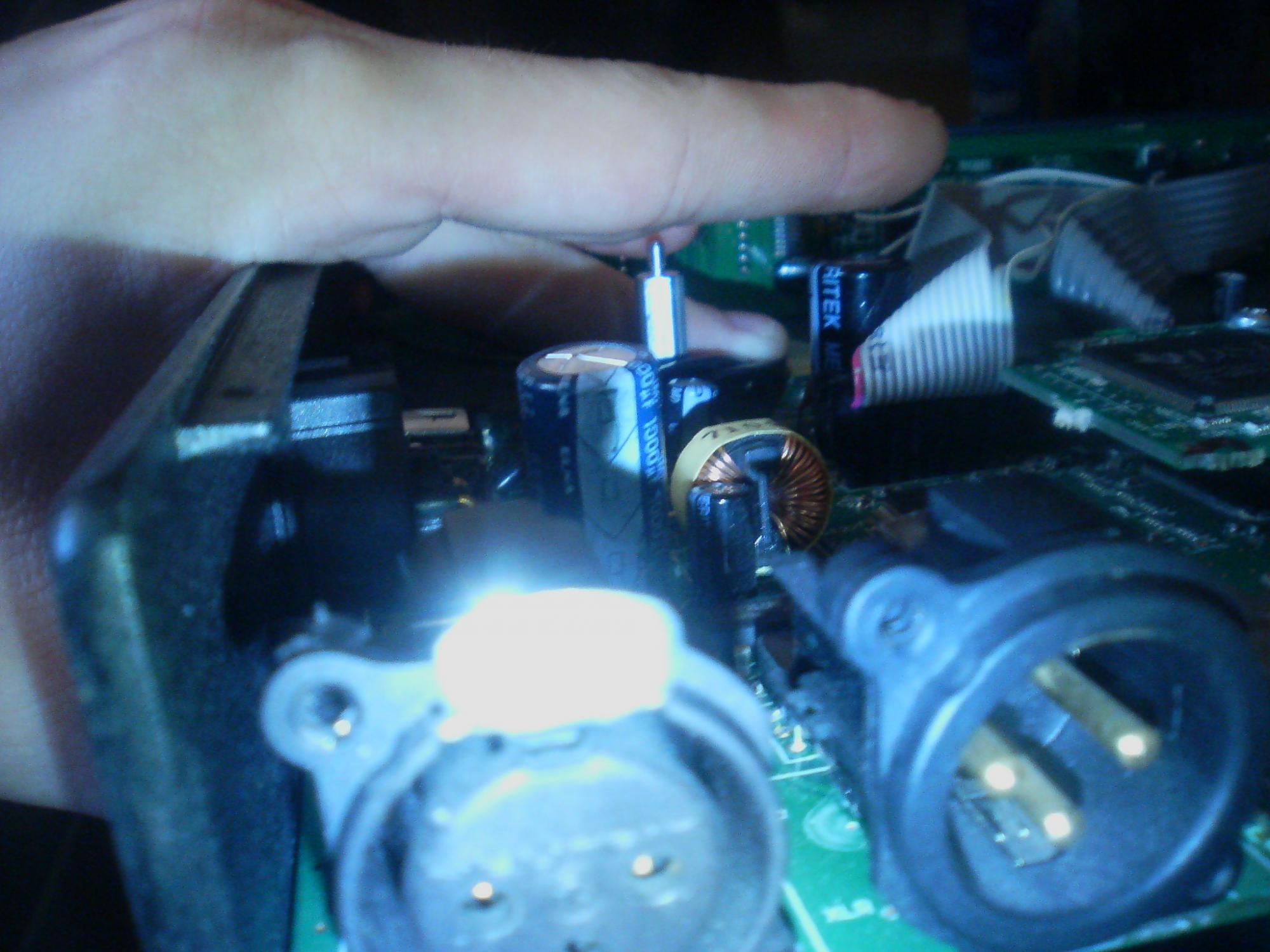

                            Yup, shovenose hit the nail on the head. Anyway... as it turns out everything would work BUT the firewire connectivity. Yup, the only pins which didn't get soldered properly were the firewire data pins...
                            I removed the firewire IC once again and tinned the pads with lead solder, then went for broke. Aka heat it till you're afraid that the IC will start melting. Device detected. Success! Upon a closer inspection the Elna cap is actually fine, i thought it was leaking electrolyte but it's simply a darker spot in the top, it doesn't scrape off like electrolyte would. It also tested good for ESR. I still don't like it but i'm supposed to remove each and every screw to get the board off, and i'm not gonna do that.
                            But here's the fun part. It works in the living room on both firewire ports on both laptops, but it will NOT work in my room on either of them. Also, if the case is touched while it's working, it'll crash the laptop. Whoever designed that power supply should shove it up his ass. It is definitely not my soldering at fault, as pushing on the board doesn't do anything, only touching the metal of the case crashes it.
                            Fortunately it can also be bus powered. As the owner uses a full-size PC for his work so he has 6-pin firewire with power, i'll tell him to power it by the firewire port whenever possible.

                                Well, guess it's time for the real facts. It's NOT the firewire controller that's causing all the trouble, it's the interface chip next to it which is a big ass mofo with no less than 144 pins. It chokes on firewire playback and does all kinds of nasty clicks and pops (that is, when it actually decides to recognize the computer). And yes it does respond to heat like i found out, but it'll work right for a few minutes at most. It's a Philips IC, forgot the model already but it's something i can't find for sale anywhere. The firewire controller i have replaced is simply "the middle man", its only special function is that it provides the 49.152MHz master clock.
                                Fortunately i've gotten the control software and the recording functions to work stable. The owner uses it to record mikes most often, so who gives a damn if it can't play sounds from the computer, it's not like he doesn't have other soundcards. One can route any of its analog inputs to the phones and monitor that way. Oh yeah and bar the room issue, now it works anywhere i put it.
