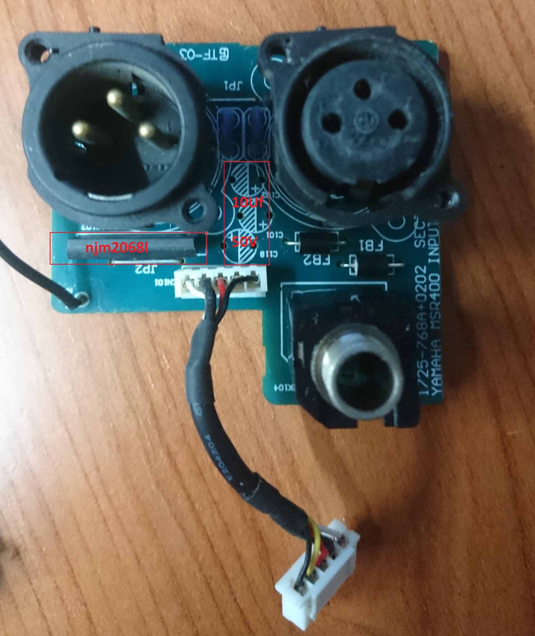

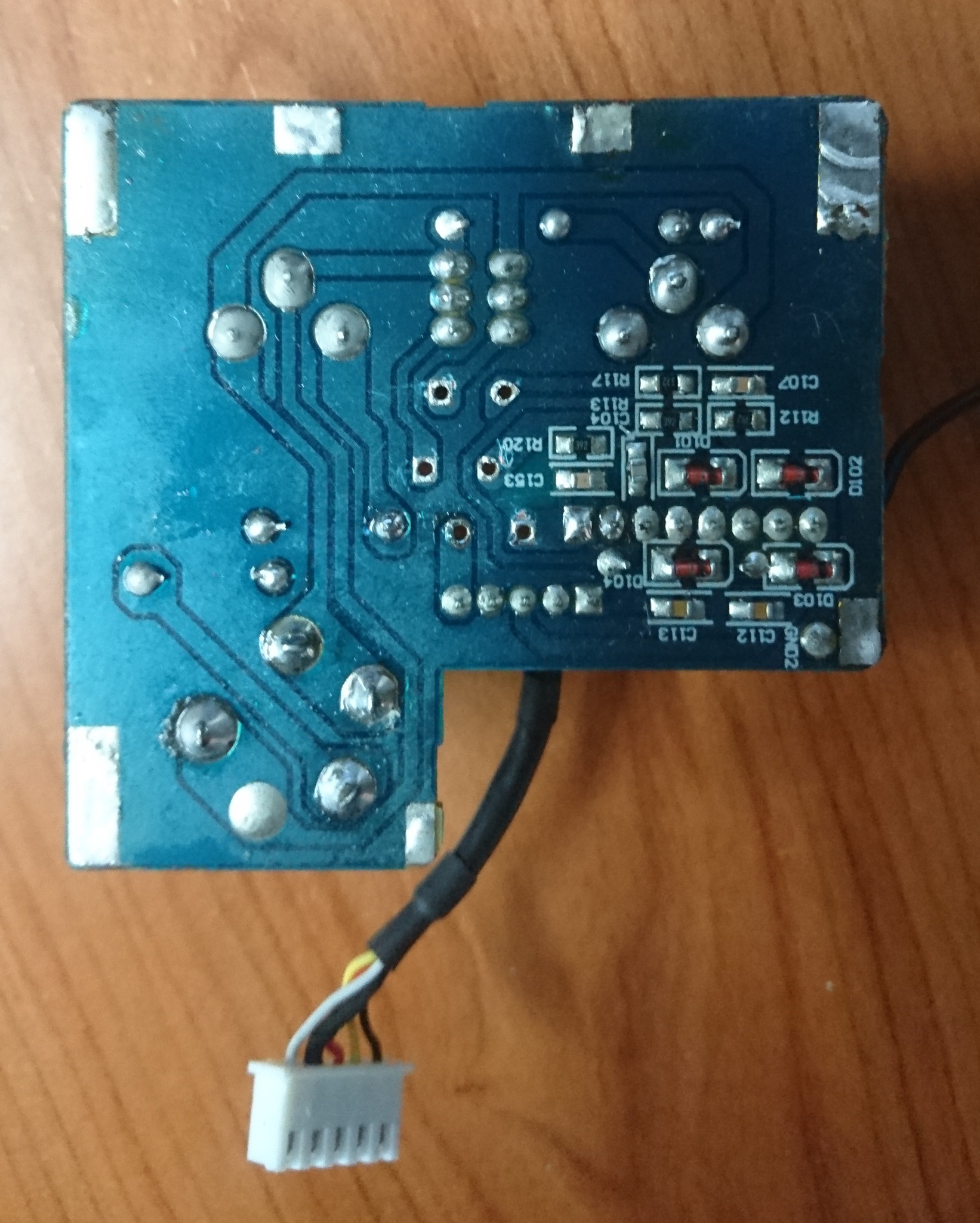

    Good morning everyone
    I have a problem with this input module of an active speaker of the Yamaha (MSR400), the signal transmitted by this unit and sent after the EQ module and then end up the amplification form is lower than normal, I attribute the problem to this Module because with that of the twin box works perfectly, I thought of the three capacitors highlighted in the photos and that I have not yet replaced or the operational highlighted NJM2860L, the strange thing I noticed that by trying with the jack by pulling it a little out of the normal position the earnings is normal, while when everything is inserted you don't have any signal, but the jack contacts are perfect, instead with the xlr as I said it is very low thanks for those who can help me
      This is a bad connection... try re-soldering the pins to the pcb for the jack & XLR sockets (even if they look fine)... if that doesn't work then there may be a physical problem with the jack socket itself & it may need replaced.... but from what you say seems like a simple bad connection....
