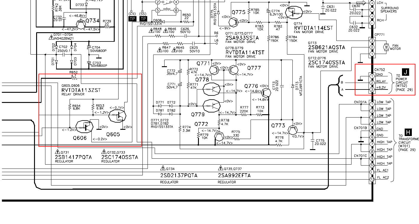

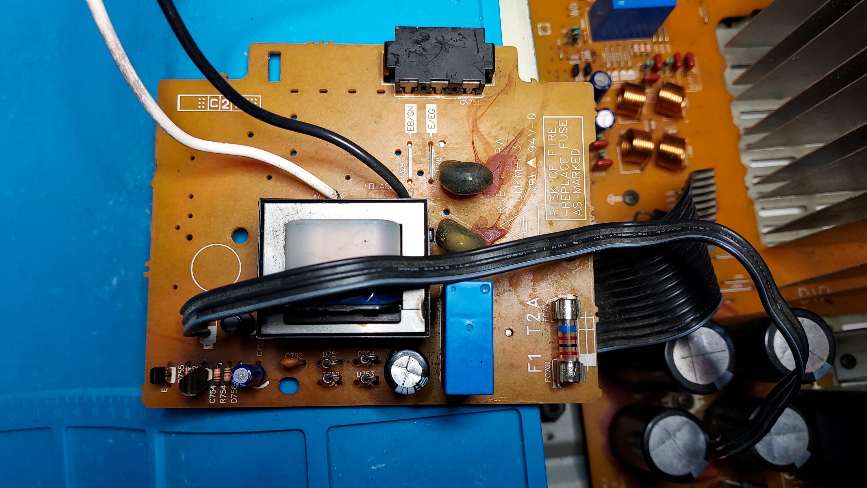

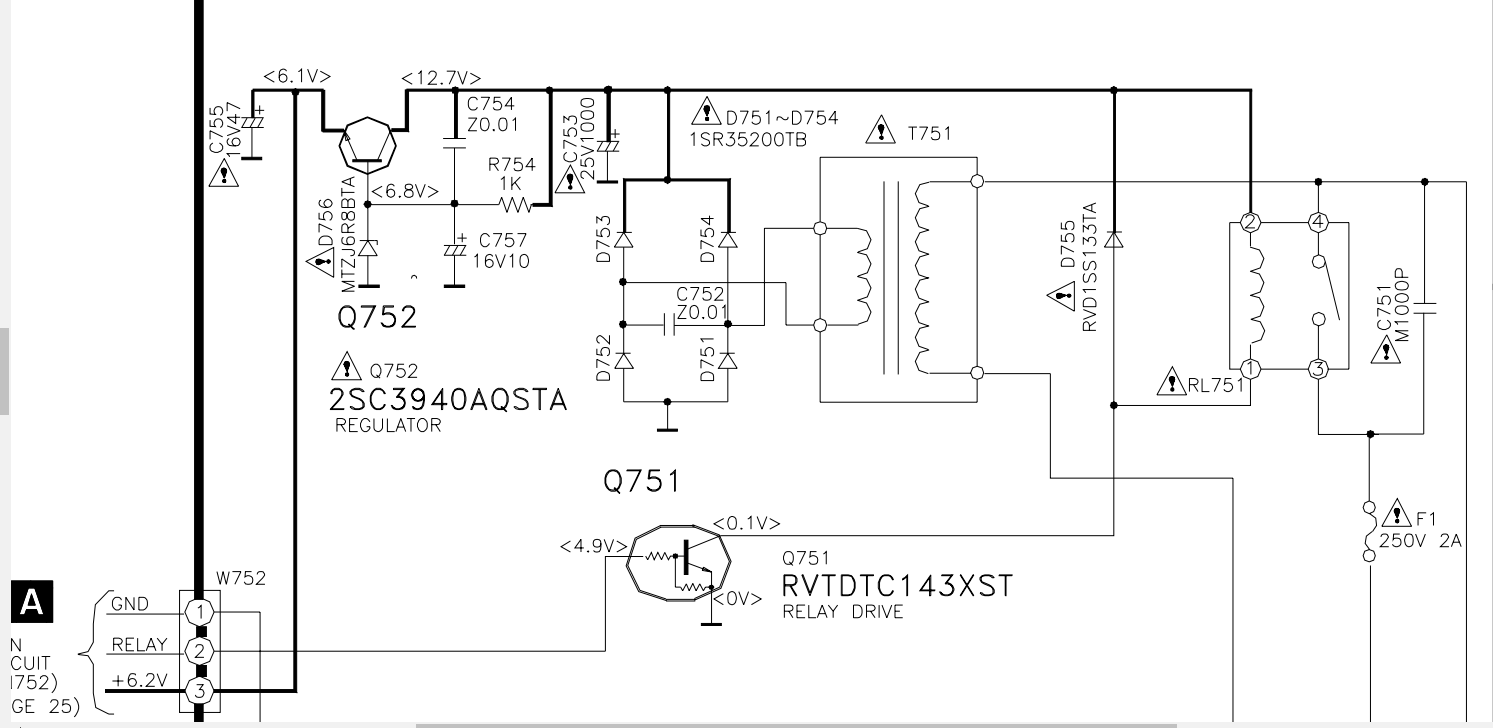

    I am trying to bring back to live this amplifier. So far I see that main transformer doesn't receive 220V. It doesn't receive voltage because relé is not activated and doesn't close the main AC circuit to the transformer. (It's not activated because Base of transistor is not excited.......base is connected to pin2 that comes from the main PCB)
    Between pin 1&3 I am getting 6.3V, which seem correct......is this the "standby" for the PCB?
    Pin 2.....the one connected to base is tagged as "relay". So as soon as it gets the right voltage, the relé will receive about 21V dc....... and then all voltages should be present in the PCB. (that's my analysis that maybe is wrong).
    What's the part that triggers this pin2?
    Is it this part? (don't see it conneceted to the connector, but it says "relay"..)

    This relay starts (gives a command) the microcontroller U901 (25 pin).

      Rely control is by U91, pin 25 (noted by lotas)
      Also locate Q902 and check if you have 5.1 volts on emitter and collector. (page26)

          Pin 25 in the microcontroller has 5.1V.
          Both Collector and emitter in Q902 have 5.1V
          In the power boton PCB, there is also 5V. As soon as you click the power boton it goes to 0 for a second, so I foresee some kind of trigger there.
          I will disassemble front panel in the meantime.......to see if I visualise something wrong there.
          What do you think about injecting voltage in the Q751 Base to power up everything? (or shortten C-E)

            Is there 5v on the Q751 base?

              Yeap!!! it's fixed...........it had "nothing".
              Desassembled front panel. Cleaned PCB and connectors with isopropanol and came back to life.
                Before cleaning...........base had 0V. Now it has the voltage you mention.
