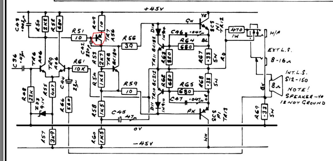

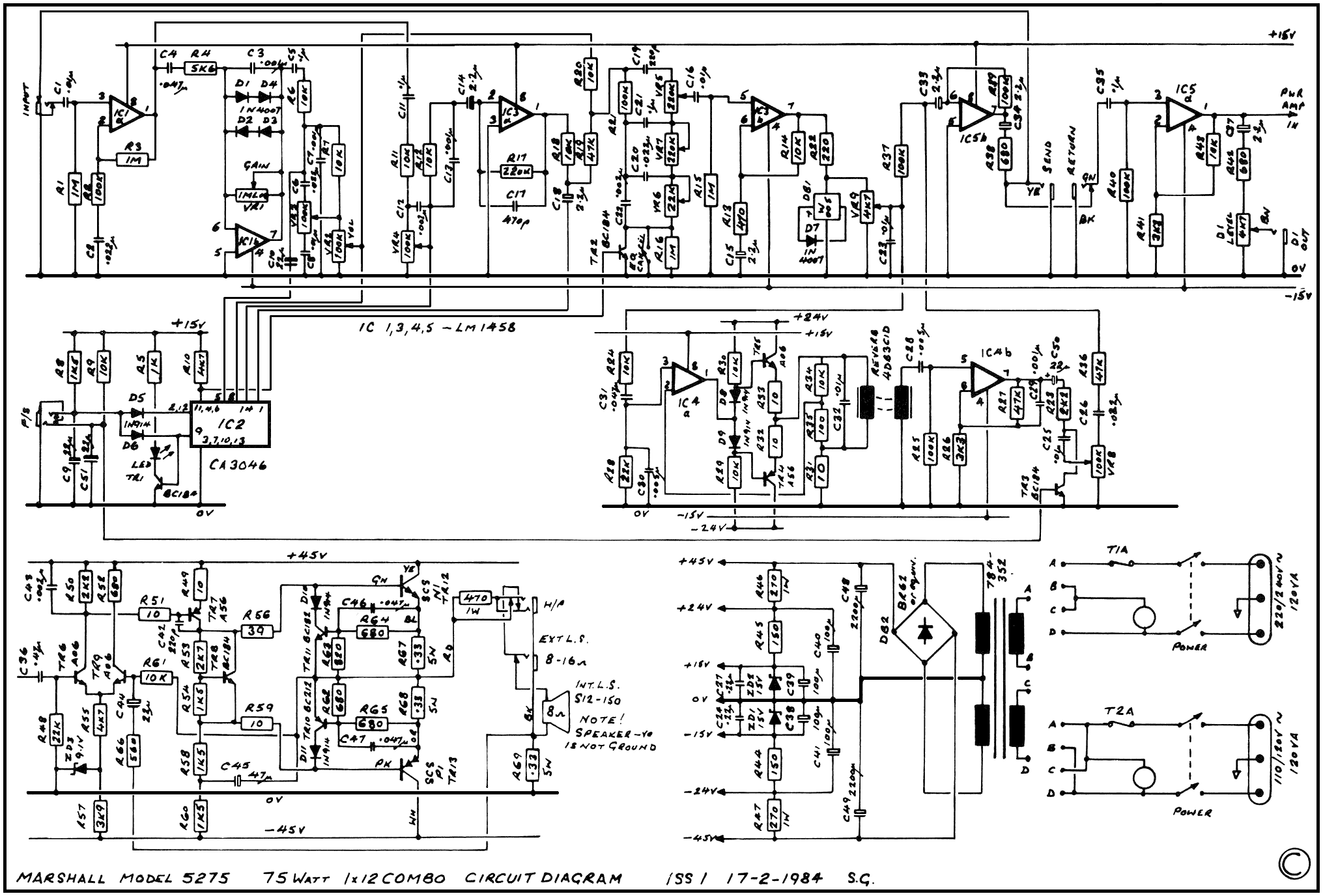

    Attached you can find the schematic.
    I checked all the +/- voltages, 15, 24 and 45 and all are OK. The input fuse is not burned.
    With the speaker connected or disconnected the R44 R45 R46 R47 are soon (10 seconds) very hot.
    With the speaker disconnected I measure 45 volt DC on the speaker output terminals. So I checked the two darlington MJ3001 and MJ2501 disconnecting them and to me they seem OK. I heard that a positive multimeter check on a darlington doesn't assure it to be good.

          Without the speaker connected you should have close to zero volts between 0 (common) and the connection between R67 and R68. If you measure +45volts, either TR12 is turned on or shorted or TR13 is not turned on or open. both transistors need to be biased so the resulting voltage to the speaker is near zero volts. Check that you don't have an open resistor in the driver or output circuit.
          Did you check R67 and R68?
          R44 R45 R46 R47 will get hot, they are dropping the voltage from +/- 45 v to 24v and 15v

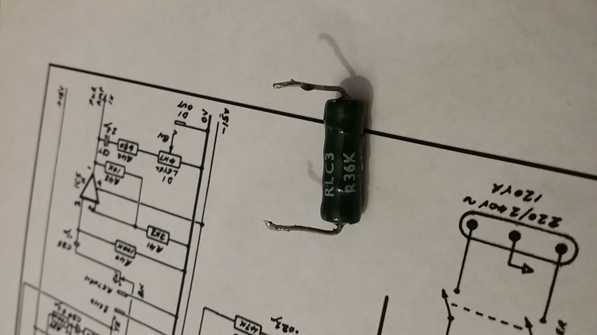

              R_J I checked the R67 and R68 and to me they both measure 1.8 ohm each at my not professional multimeter (0.8 ohm is the internal probe resistance). I don't understand the true value from the schematic. .33 is 0.33 ohm? I attached a picture.

                  If you measure negative (-) 45volts between 0 and R67/R68 that means either TR12 is biased OFF or TR13 is turned ON, so basically connecting the emitter and collector. Did you check ALL the resistor values between C36 (input cap) and the output transistors? All it takes is for one to be open or higher in value and the bias gets upset, Also check D10 and D11
                  It may work without TR12 and TR13 but it may not, sometimes you need to install about a 1K resistor between the emitter and base of Tr12 and TR13 with the transistors removed.

                      Follow RJ's advice and take out the transistors. Check the voltage after and I am ready to bet it will be 0 . A brief description of the final stage is like this. Signal comes in in base of tr6. Tr6 and tr9 are a differential amplifier that is needed for the final stage feedback through r66 also sets the DC bias to 0 v in case the transistors are not paired right or circuit is drifting, and that is done through r61. Tr7 and tr8 are driver circuit for final transistors . If you measure the voltages on these transistors we might be able to help better. Also if you want to short the input like I said use a 10 uf cap from r51 to 0v line and check if the oscillation goes away. An oscillation depending of the stage where is happening can drive the output voltage one direction or other but not commonly to the point where you see full negative of positive DC . Did you happen to read the output voltage on ac scale?

                        Can someone say me the .33 on R67 and R68 what mean? What value should I expect?
                          Re: Guitar Amp Marshall 75 reverb issue
                          those are .33 ohm resistors.... 5 watt rating

                            I powered up the amp with TR12 and TR13 disconnected. The -45V DC still present at the base trace of both TR12 and TR13 and some other points connected!
                            At the speaker output a voltage of about 9.5 V DC that after some seconds were 9.4, after 5 seconds 9.3... and so on.
                            Going backwards in the circuit I measured again TR7 (it was already measured at the first check) and noticed that the base emitter junction was open. I took out it from the circuit and all the junctions were open, so BC, BE and CE forward and reverse (I don't know if the heat during the desoldering opened the other junctions...). Another doubt I have is if TR7 was damaged by the amp working without TR12 and TR13, but I hope no.
                            I haven't yet powered up the amp without TR7, I'm not confortable with this amp with several stage. Is all a set of components in equilibrium and I'm not aware what can happen removing an active component.
                            By the way maybe TR7 is the cause of the fault. Without connection with the +45 DC (by means of TR7) the R59 and R56 were directly connected to -45 V DC via R60, R58, etc.

                              Replace TR7, it will likely fix it, I doubt soldering it caused it to go open.
                              without TR7 working, TR12 would likely not be biased on so Tr13 base would have been biased on causing the -45v to show up on the speaker
