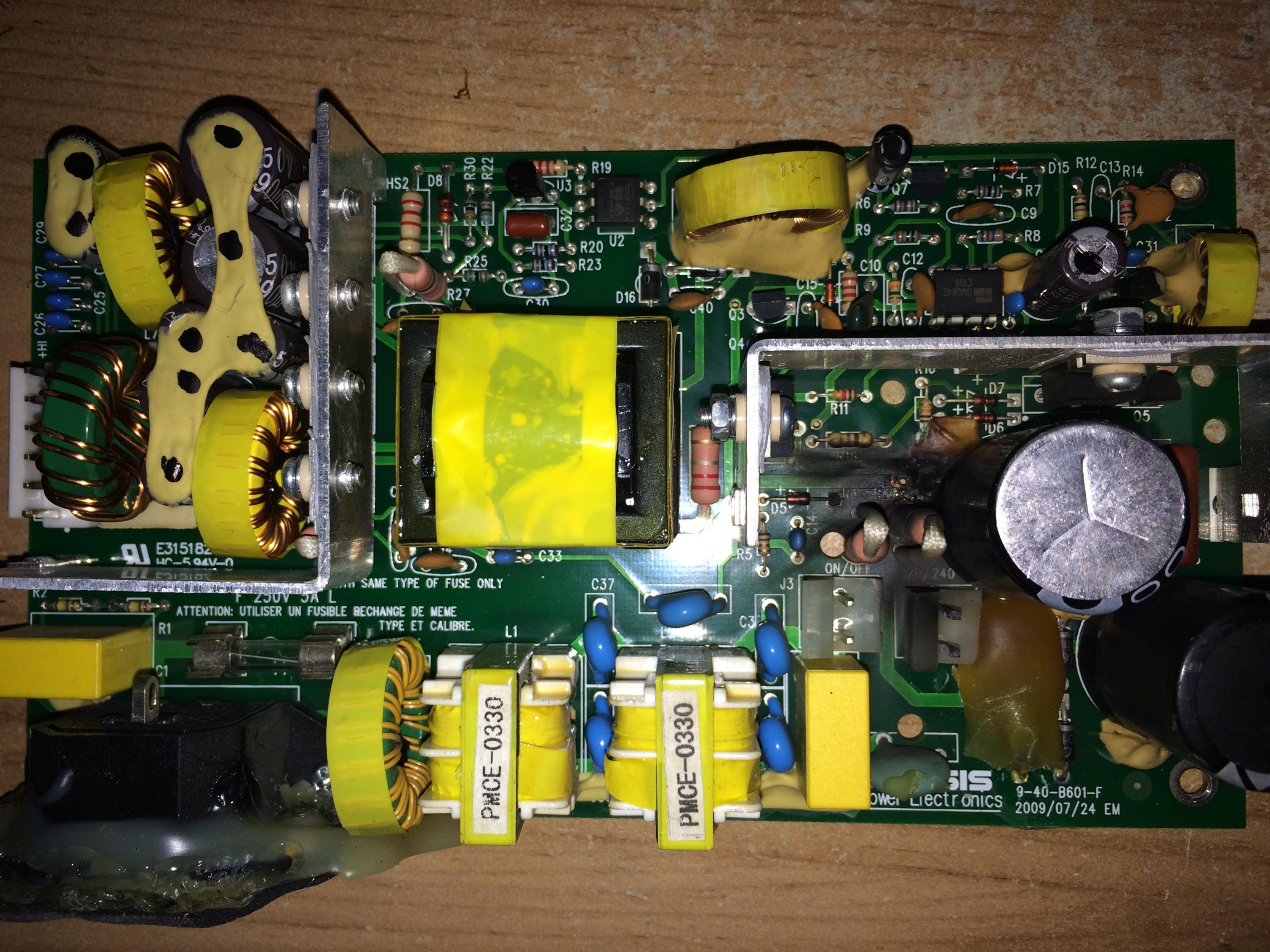

    Hi all!
    Inherited a set of these speakers from an old housemate who ran away to avoid paying rent. I'm a musician and haven't looked at a circuit board since A Level Physics ten years ago.
    They worked for a while, but then one dropped out, and then the other. Now neither of them turn on at all (no light, no sound).
    Figured it's finally time to get round to repairing them, but the main thing I've noticed is that the common issue (C8 proximity to resistors) is not possible on this board.
    I don't know if these speakers are a more recent production than the ones commonly described in the guides here and on Youtube... I read through this whole thread and am still totally unsure.
    On my board, C8 and the little blue C14 have swapped places.
    So, C8 is between U1 and R24, and C14 is next to R3 and R4.
    There is also only one little C14, instead of two like on this video: https://www.youtube.com/watch?v=ThjO7vlb79E
    I have no idea what process I should be undertaking to fix the speakers then, as the video guides now seem inappropriate due to it being a different board!
    I don't really know what to look for in terms of 'signs of damage' or anything. The big black power cylinders all seem to have flat tops (one is dubious, but more flat than warped).
    Guessing I should start with the fuses? I can say with certainty that one of the fuse 'beds' needs replacing (the metal clips that hold the fuse in place are broken).
    Thanks for any help, I hope you can excuse my extreme lack of knowledge!

      Edit to above:
      C8 and C14 have swapped places, but I noticed that there *should* only be one C14. C11 is still in the normal place (so on my board, between U1 and C8).

        I know for a fact that i've mentioned encountering at least two revisions of the power supply board (or one pair i've had slightly differed from what's in the service manual)

          Ahh, must have missed that. As I say, I have extremely minimal knowledge on this subject... only some patience! So some of the things I've read I haven't understood.
          So currently I'm planning on replacing, and have ordered parts for:
          C1 & C2
          C8
          C35
          The two big guys
          The fuses
          The 4 diodes
          I'm not confident I've got the correct parts though. I made sure that all the important stats such as V, A, temp, etc are the same, but my C8 and C35 replacements are definitely different physical sizes to the originals... Is this normal?
          The C35: https://uk.rs-online.com/web/p/alumi...75462035305626
          C8: https://uk.rs-online.com/web/p/alumi...31353037333226
          The replacement fuse clips I got have a sliiightly different fixing: http://uk.rs-online.com/web/p/fuse-clips/1678351/
          but they went in ok; just a little raised from board, as you can see from the picture would be the case.
          Haven't managed the other bits yet, need to wait for the soldering iron to cool down so I can switch to a thinner tip.
          Also just noticed on the back of the board, where my R3 & 4 are, the board has turned a little black (on both boards). Nowhere else on the board is as dark as these two areas, so I figure I should replace these two as well... will order now.

            Have C1 & C2 been damaged? On the schematic in the service manual, those would be the two 220nF RF filter caps on the mains input.
            Do you at least have a multimeter at hand? You COULD measure those two resistors, y'know... If they're out of spec (+/-5%), then they'd warrant replacing, otherwise replacing them won't really do anything.
            Assuming you DO have a multimeter (please say that you do! without lying ), and since the fuse was blown, i'd also check whether the switching FET (Q1) has turned into a wire or not. Drain is the middle leg, and Source is the leg on the right, as viewed from the front of the part.

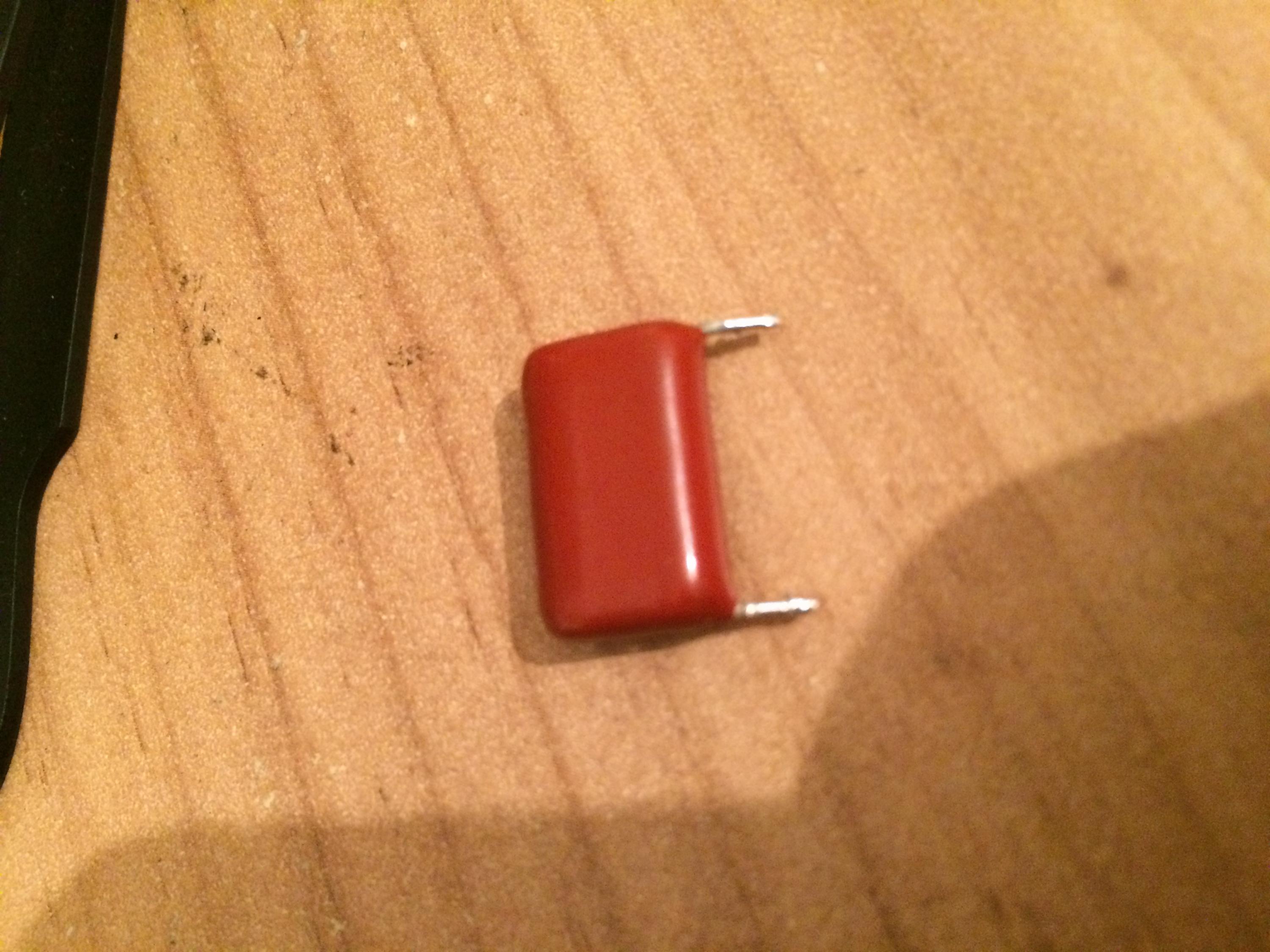

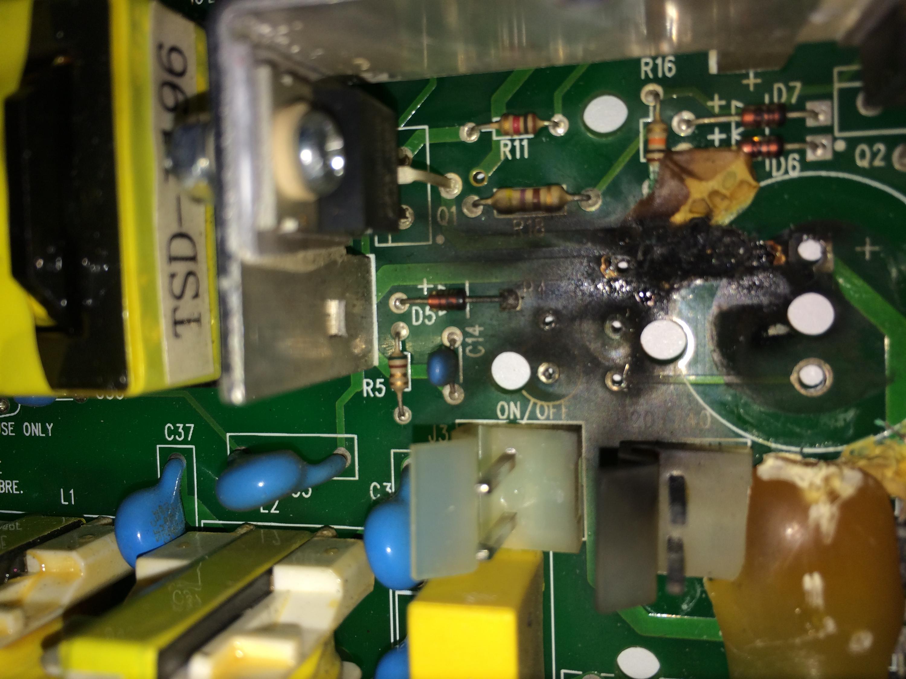

                  So, after having not used my M1s for a while I turn them on and one gives out the most awful sound and I immediately turn them off. When I turn them on again there is a bang.

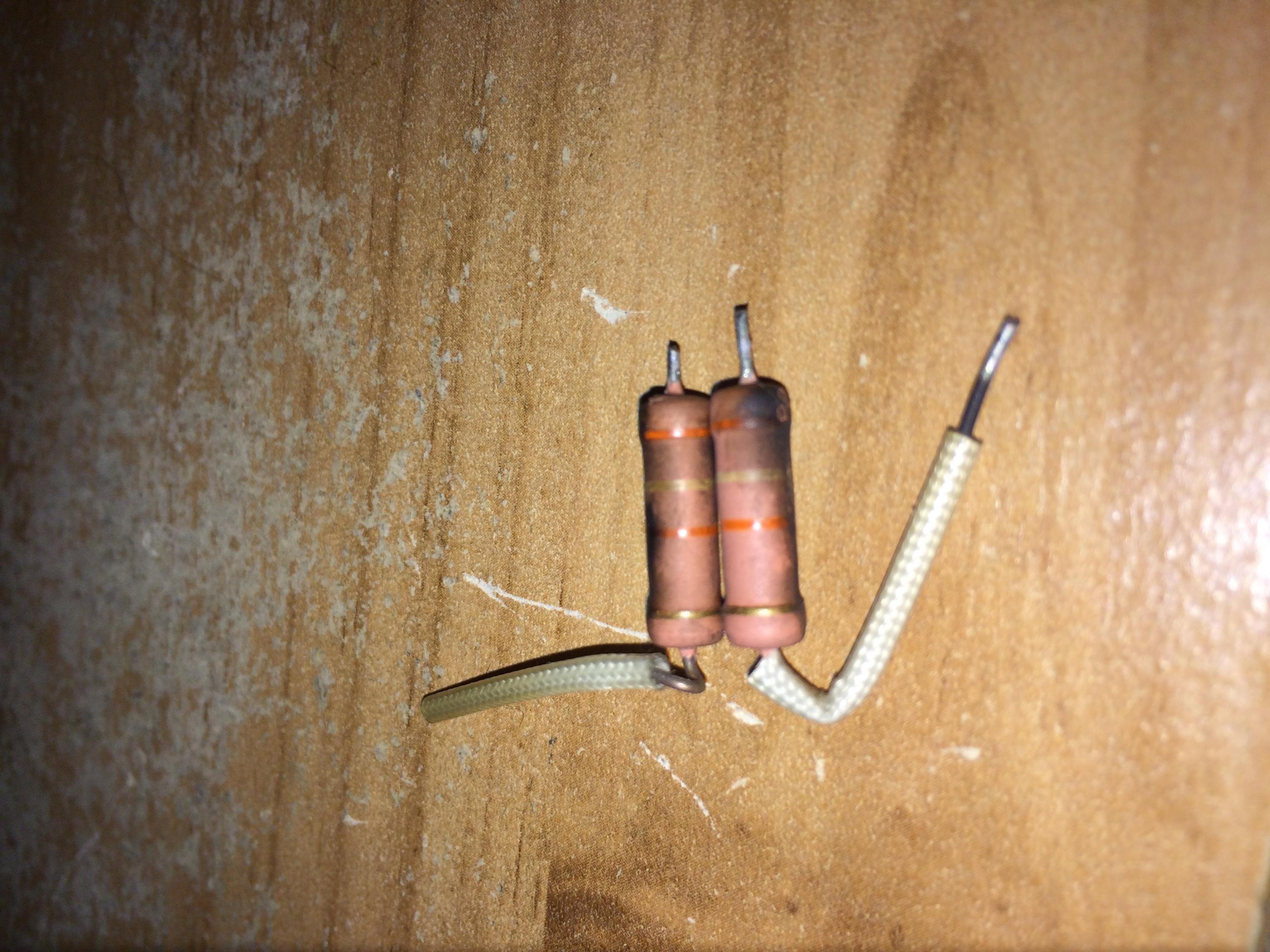

                  Opening it up its seems C6 had blown, taking with it the trace leading to R3. I removed it along with C7, R3, R4 and C16.
                  Through this thread I've discovered that my board is likely one of the revisions. The serial in the bottom right corner the PCB ends in F instead of E as shown in the service manual Khon kindly provide (Godsend), C8 and C14 have switched places and there are several other slightly variations which is what my questions are in part about.
                  First off, the pieces I removed:
                  C6 is blown and C7 looked cracked, they are also Fuh Yin caps so they will be replaced.
                  Would these be a good replacement? Or do you have a better suggestion? Anything with a long life maybe?

                  When I removed R3 and R4 they tested 37.0k and 37.5k, however the components list in the manual lists them as 47k 2w 5%, but the bands as far as I can make out seem to be orange, yellow, orange, gold. When I check out that colour code though I get 34k, but it does says non-standard. So now I'm really confused? The schematic says 47k but that manual is for the E board not my F revision, and with them both measuring around 37k seems maybe they got bumped down, but with the bands coming out with 34k I'm unsure of what to do here.

                    I forgot, some pictures.
                    Also is that big blob of hot glue they've put all over my diodes gonna be a problem? should I just replace them? I doubt I can get them out of the resin without destroying them. You can see it in the Board picture over Diodes 1-4

                      1) I'm pretty sure the stock C6 / C7 are 10mm-pitch snap-in capacitors. If you go with the Rubycon KXW you linked, you won't be able to sit them flat on the board, and they'll be especially sensitive to vibrations.
                      2) Since they're quite "roasted", just replace them with a pair of 2-3W 47k's (the actual value isn't that critical, they're only for balancing the voltages acros C6/7, and discharging them after you switch off the power)
                      3) Yes, that Vishay cap should be fine - or any other PET / PPS 680nF 160-250v cap. That being said, i'm not sure there is (or should be) any reason to suspect the stock one's damaged. If you don't have a capacitance meter, the least you could do is test it with an ohm-meter - if it's not shorted, it's probably fine.

                      12) Nah, those diodes should be fine, they don't need to pass a lot of current anyway. They look like 1A diodes, and since you're drawing (let's exaggerate) 100W from this supply, they'll only need to supply less than 0.5A - multiply that with 0.7v drop across them, that's a measly 350mW.

                                          Hmm... You have a multimeter, right?
                                          Disconnect the cable between the power supply and the amp board, set the meter to diode test, and measure each of the rectifier diodes on the secondary (D10, D11, D12 and D13).
                                          PS: You should be able to find the service manual among the first pages of this thread. The power supply schematic is on page 14. Refer to that, when you name the part names (not necessarily what you can read on the board itself), just so we're on the same page.
                                          Ah, i found the caps you mention. C34, at least in the schematic, seems to have its legs tied together(?). C38 and C39 are the snubbers on the two secondaries. If you look at the schematic, "of course" it would appear that one end of each would be "shorted" to ground - there's only half of each secondary (a few cm of wire) between that end and the ground
                                          Not everything is what it might seem at first...
