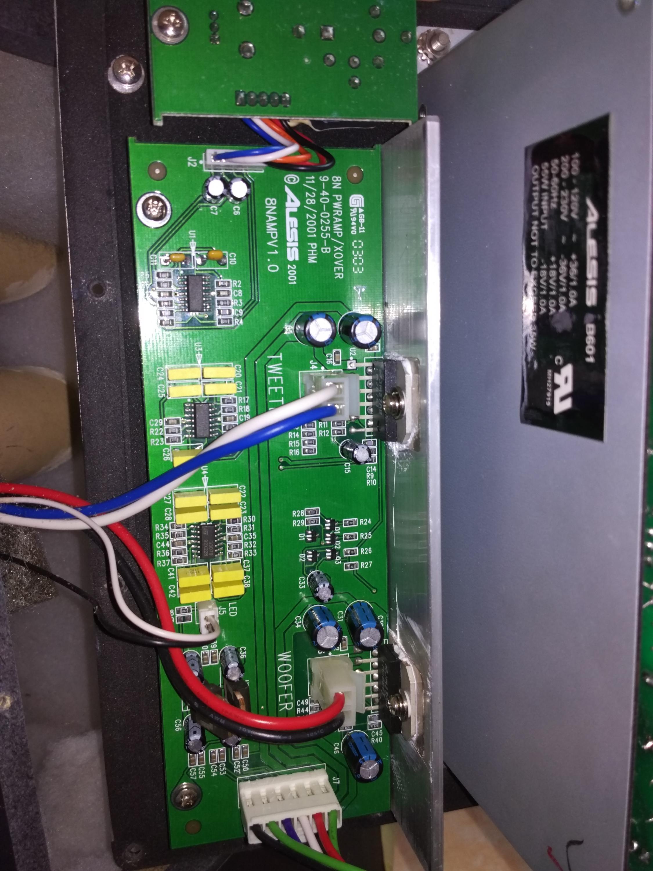

              Re: Repairing Alesis M1 Active mk2 Monitor Speakers
              Oh, right - the video was a little bit confusing then.
              Then you'll want to focus on the woofer side of the crossover (U4A-D and associated components), as well as the woofer amp (U5).
              If the power supply was at fault, you might expect the tweeter to show some symptoms as well. But on the other hand, it has all the high-passing in the active filter.
              If you put your finger on the dome, i assume / hope you can't feel the same low-frequency stuff the woofer's putting out, right?

                  #288
                  I just realized something - since the noise is low-frequency, there's a (greater) chance that a multimeter could pick it up on the AC range.
                  That way, you could check a ballpark-value for the ripple on the power amp supply rails, for example. Or on the input of the power amp. Or the supply rails for the opamps, and so on.

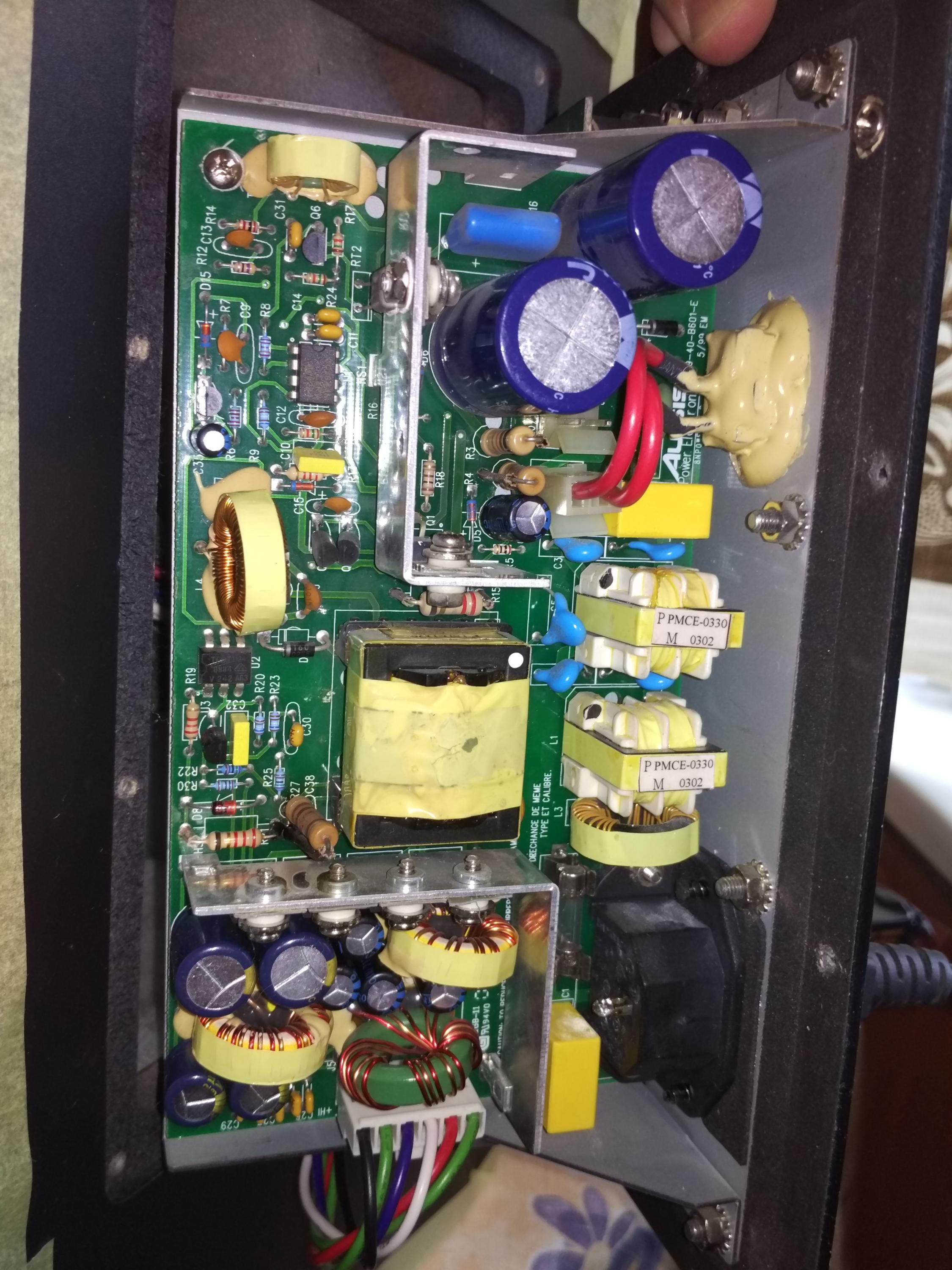

                            By the way... having spent a fair bit of time studying the schematic for this power supply, I still don't understand some parts.
                            One of these is how Q2 gets turned on. Is it T2 that drives it? Or is it a pin 3 of T1? And what does Q5 do?
                            The other grey area is the circuitry below U1 on the schematic. I'm guessing that Q6 is opened by RT2 if Q2 overheats, which would disable the PWM output by forcing pin 1 of U1 to ground. What do D15, Q7 and C35 do? Do they implement some kind of slow startup by charging C35 via R24 which would make Q7 "switch off" and stop pulling pin 1 of U1 low via D15, enablng the PWM to start?

                              #294
                              Originally posted by Khron
                              Well, in high-frequency situations (which switchmode power supplies are), you usually want to minimize the caps' ESL (equivalent series inductance), which means leads as short as possible.
                              You might have a bit of digging to do in this thread, but i think i've detailed the little "swapsies" i did in the (first?) ones i fixed, back in the day.
                              I agree that moving it closer would be better, but I'm not convinced that the inductance of the component legs would make that much difference. The UC3844 datasheet says this about pin 7: "A bypass capacitor, typically 0.1 μF, connected directly to GROUND with minimal trace length, is required on this pin. An additional bypass capacitor at least 10 times greater than the gate capacitance of the main switching FET used in the design is also required on
                              VCC."
                              The cap with minimal trace length is C14, there is no such requirement mentioned about the big cap, which is C8. And isn't the sizing requirement of the big cap only relevant if the chip directly turning on a FET, where you need to overcome gate capacitance quickly to go from fully closed to fully open, to minimise the amount of power dissipated in the interim stage? But in this design, the FET is driven by a pair of BJTs, which are presumably easier to turn on, by virtue of being current and not voltage controlled?

                                #295
                                My reasoning was sort of "for both purposes" - both minimizing lead length AND getting that cap out of that crowded hot-spot. Two birds with one stone, and all that
                                Even though the datasheet doesn't specifically mention such details, it belongs to the "best practices" category (regarding board layout).
                                That current still needs to flow into and out of the gate capacitance of the low-side FET, even if the UC3844 isn't the (direct) driving element.

                                        #299
                                        Oldschool is plenty - since the problem is pretty low-frequency, just about any scope will do.
                                        My thought was to try to work back from the woofer output back through the power amp input and then the crossover, and see where the "bad signal" starts.
