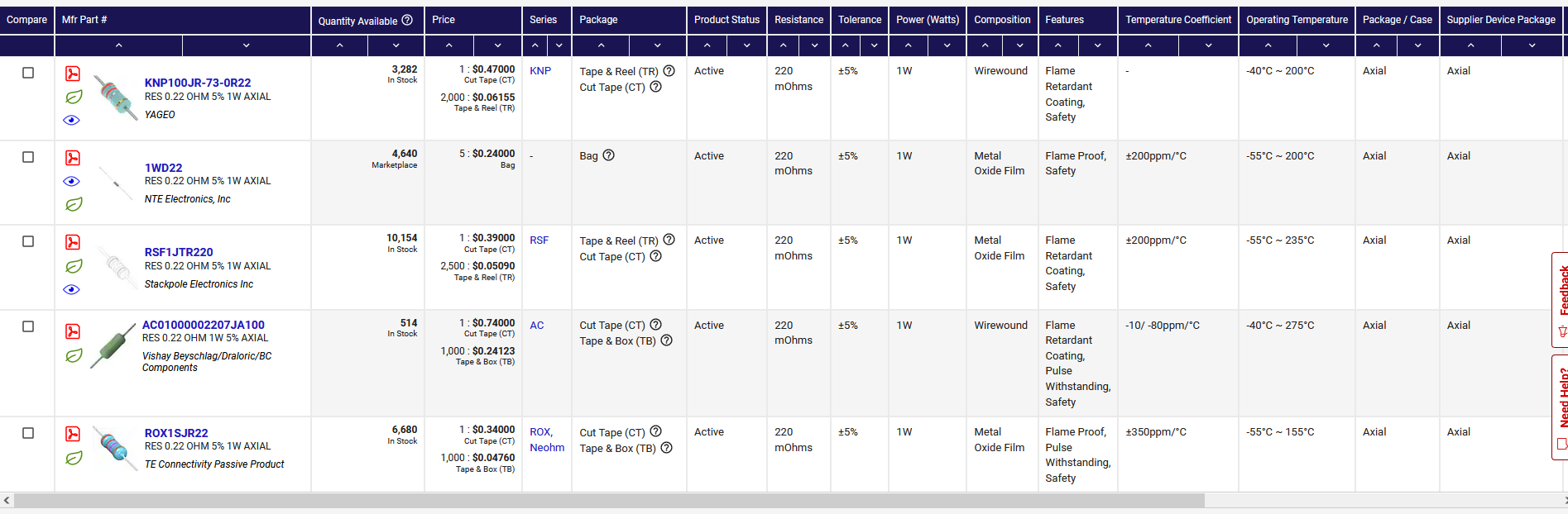

            I have discovered the following resistor issues on the non-working power supply:
            R24 is supposed to be 15K ohms, but it only measures 3K in circuit
            R15 is supposed to be .22 ohms, but it measures 22 in circuit - this is a resistor that I replaced, and it appears I replaced it incorrectly with a 22 ohm resistor. I have the old one, and it measures .22, but it is in pretty bad shape, including the post is broken off at the body of the resistor, so I don't know if I can get a good reattachment.
            So, I plan to order R24 and R15, and see if this fixes the problem.
            Skeeter
            • Skeeter
              • Jun 2022
              • 28
              #426
              Re: Repairing Alesis M1 Active mk2 Monitor Speakers
              Since I know you are the pro, what Resistor do you recommend from the following? (pics attached)
              R15
              R24 (Only 1 kind in stock with the parameters offered at DigiKey)
              Thank you for ALL your help!!
              Skeeter
              UPDATE!! I swapped the 22 ohm resistor with the old .22 ohm resistor (which is in terrible shape), and IT WORKS!! Basically, the .22 ohm resistor is barely holding a connection, so I still need to order a new one, and I will still replace the 15K resistor, because it measures only 3K. Wow, did I learn a LOT from you! Thank you for your patience with me.
              Thank you! I am rather elated just now
                I recommend a metal film replacement for R15: RR01JR22TB
                For R24 you can always go with better ratings, here is a 1% one: RNF18FTD15K0
                But you can just lift a leg on the current one and measure it, likely it is ok as I explained above.
                I would also order some braid and a flux pen to wet it with, then clean up some of the solder, especially R27 seen here for example.
