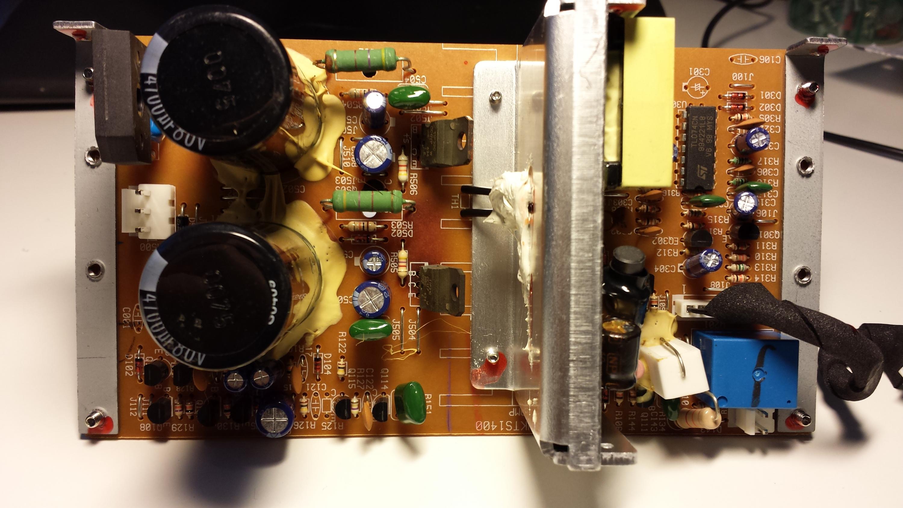

    Re: harmon/kardon sub-ts14 makes high-pitched squeal sound
    I'm following this thread ever since my gf's subwoofer has the same issue... I'm stuck at trying to remove the board and PSU from the wooden shell... all screws were removed... yet no luck.... any help would greatly be appreciated
    Dave
    • gtdavelo
      • Jul 2013
      • 2

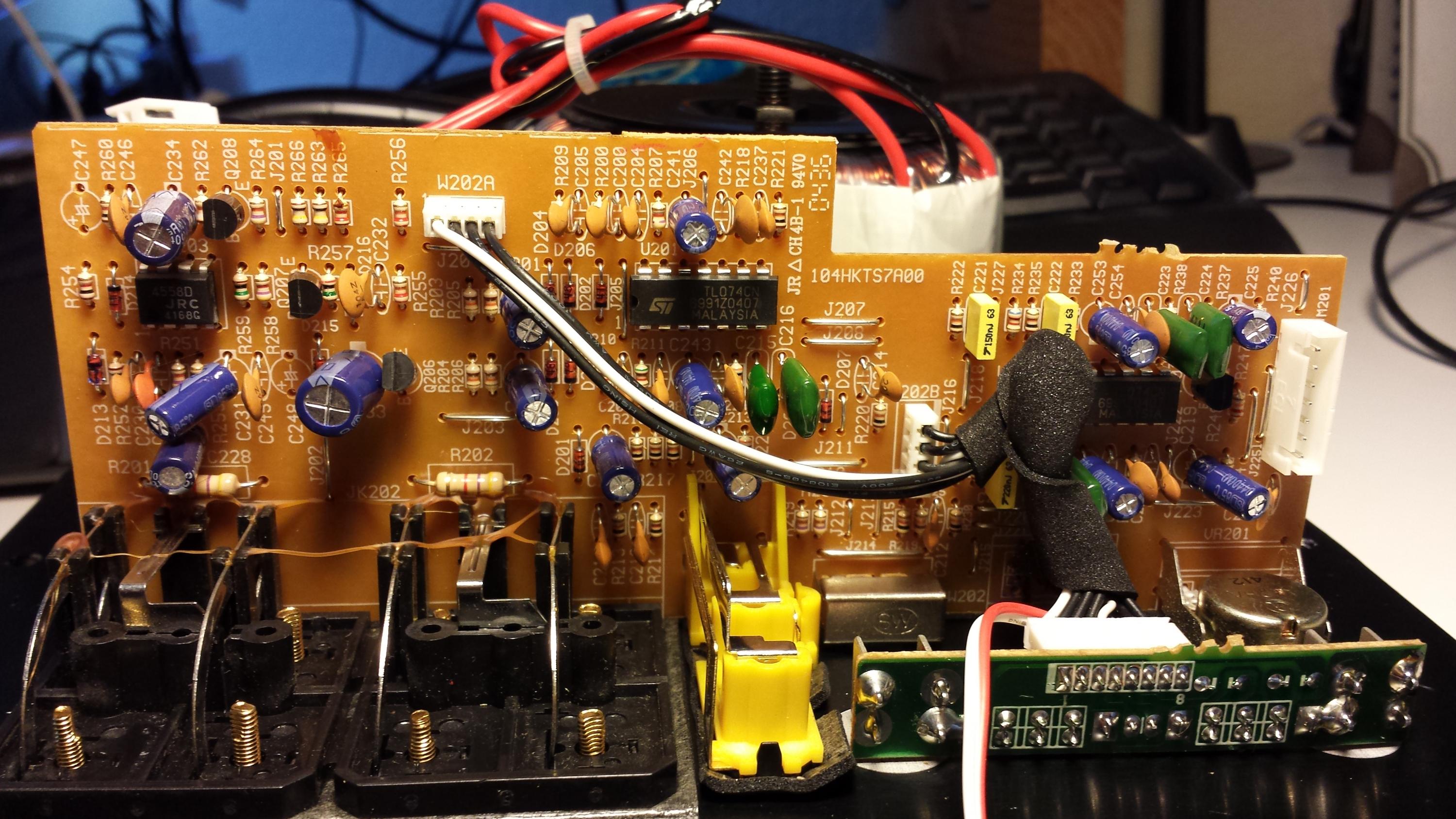

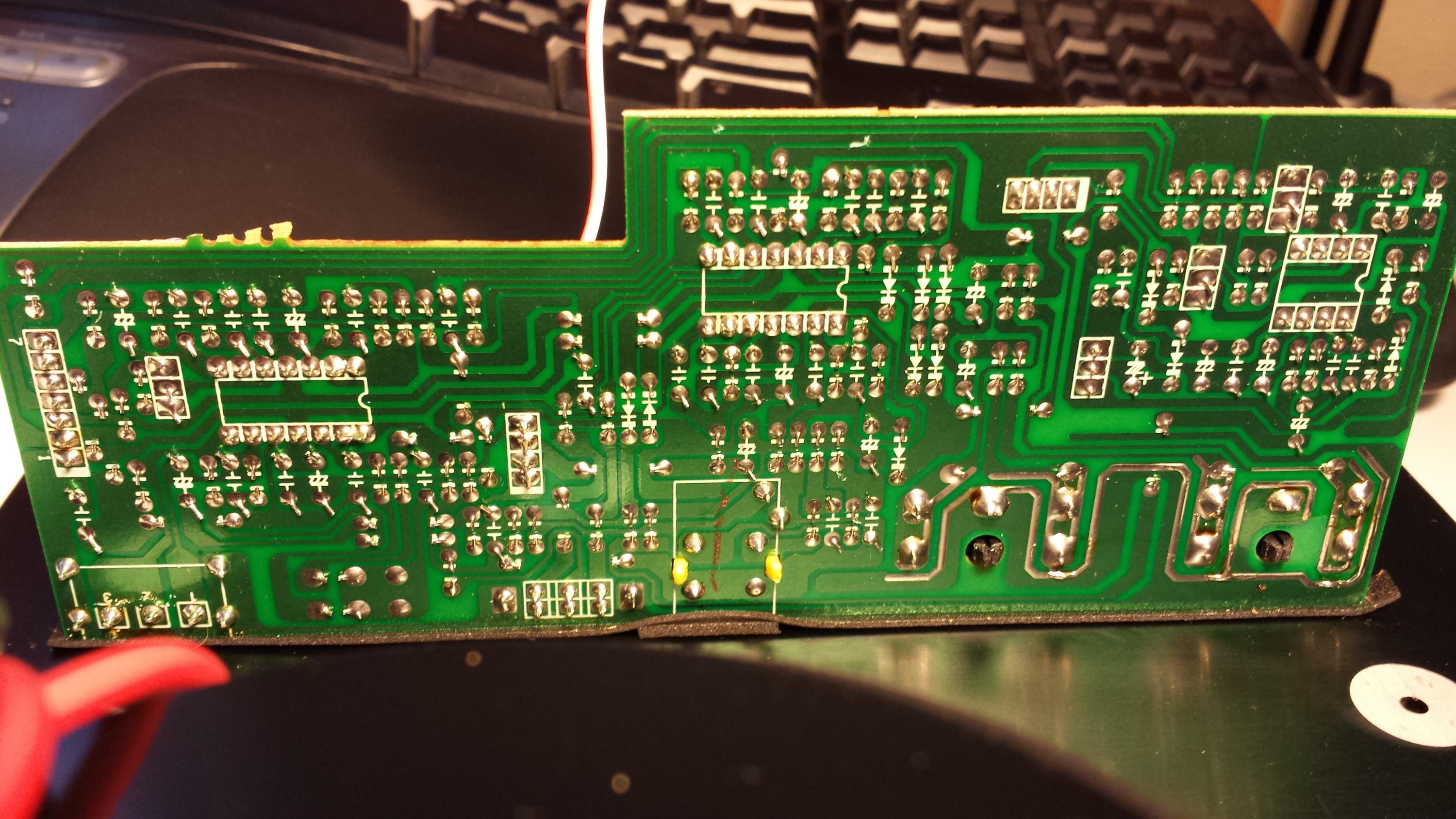

      I took apart the boards from the encasing.... found the Service Manual online... but after examining the board with the naked eye, I see no obvious issues.
      Any help would be greatly appreciated!
      Dave
        I spot..... degraded glue!
        • ben7
          Capaholic
          • Jan 2011
          • 4059
          Replace the bipolar electrolytic capacitors on the power amp module (the one on the heatsink). I other threads with similar power amp modules, which had bad capacitors.

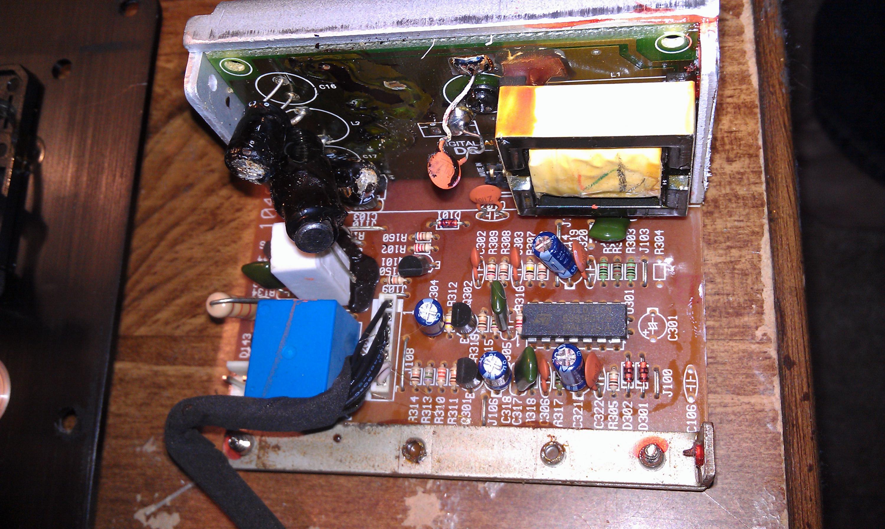

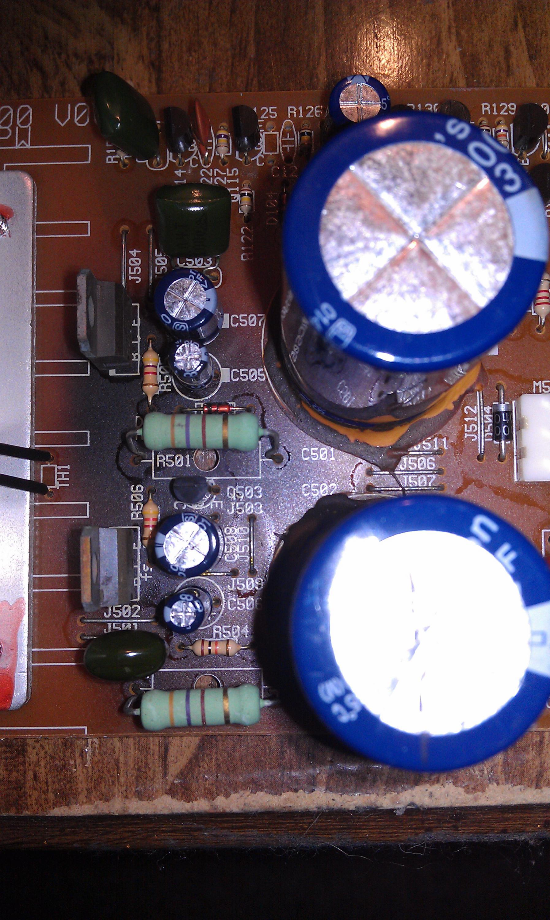

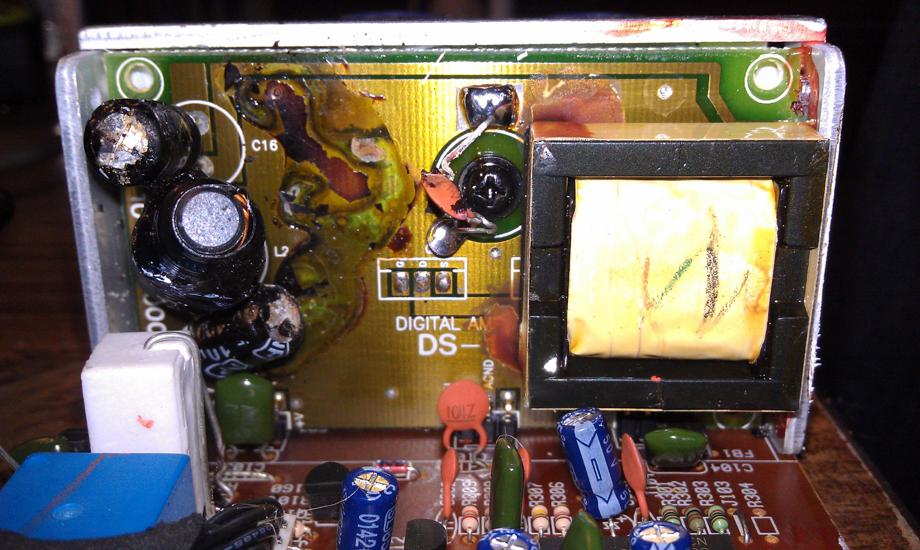

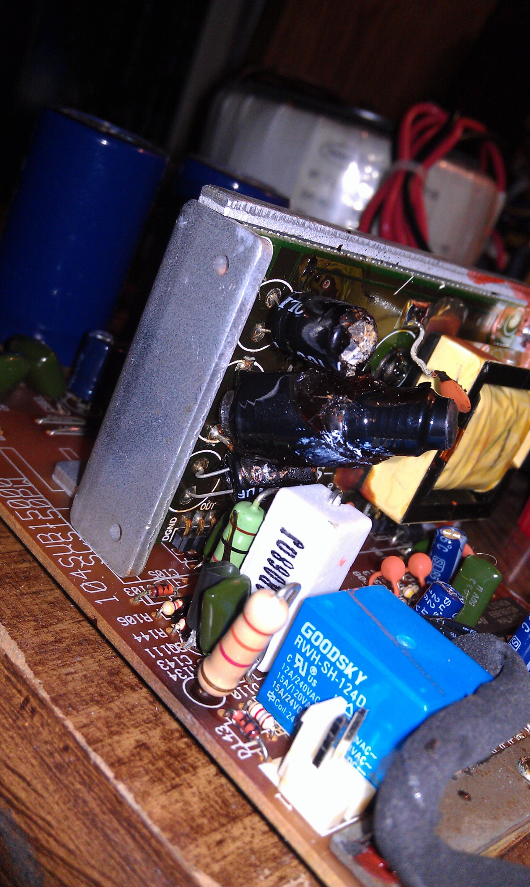

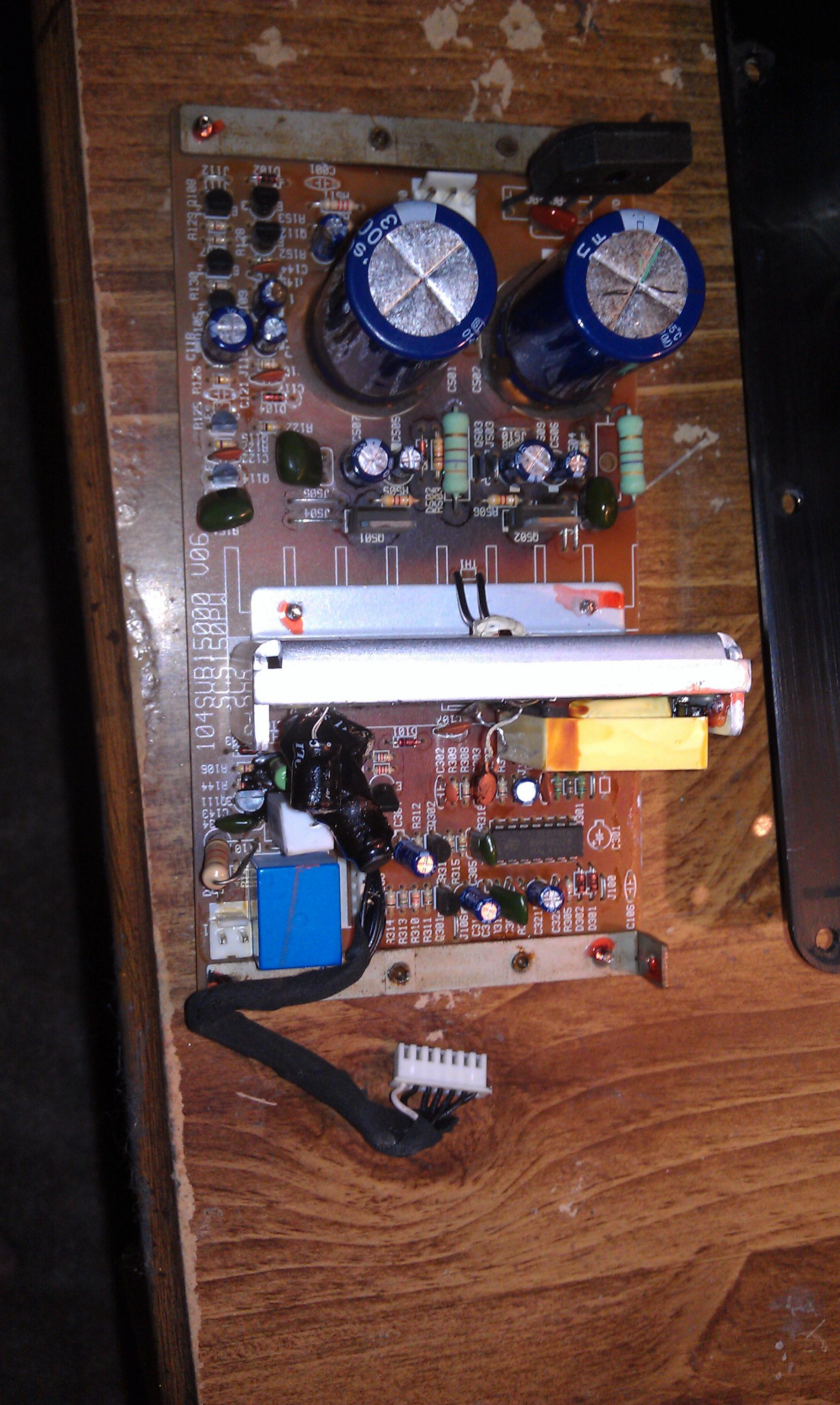

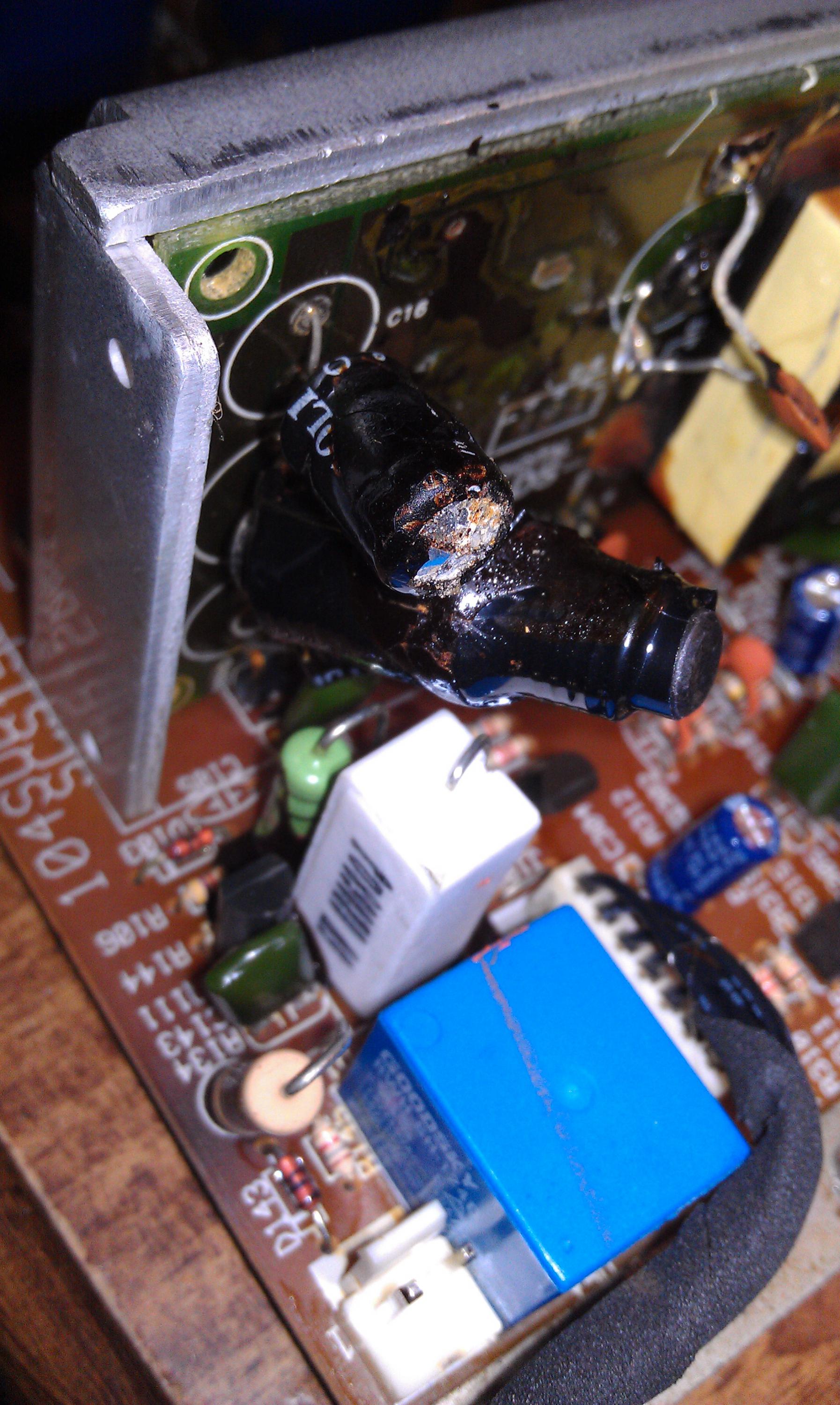

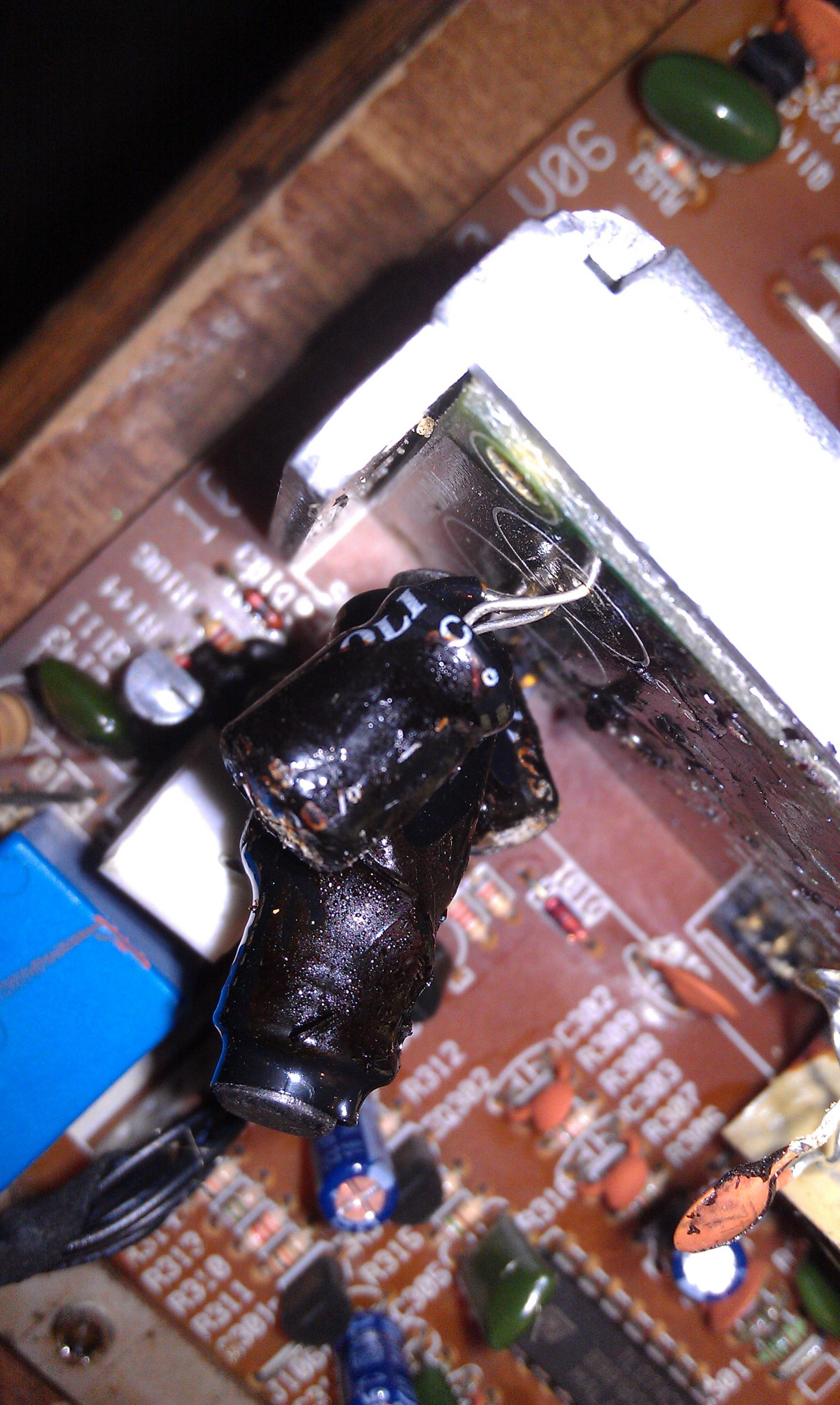

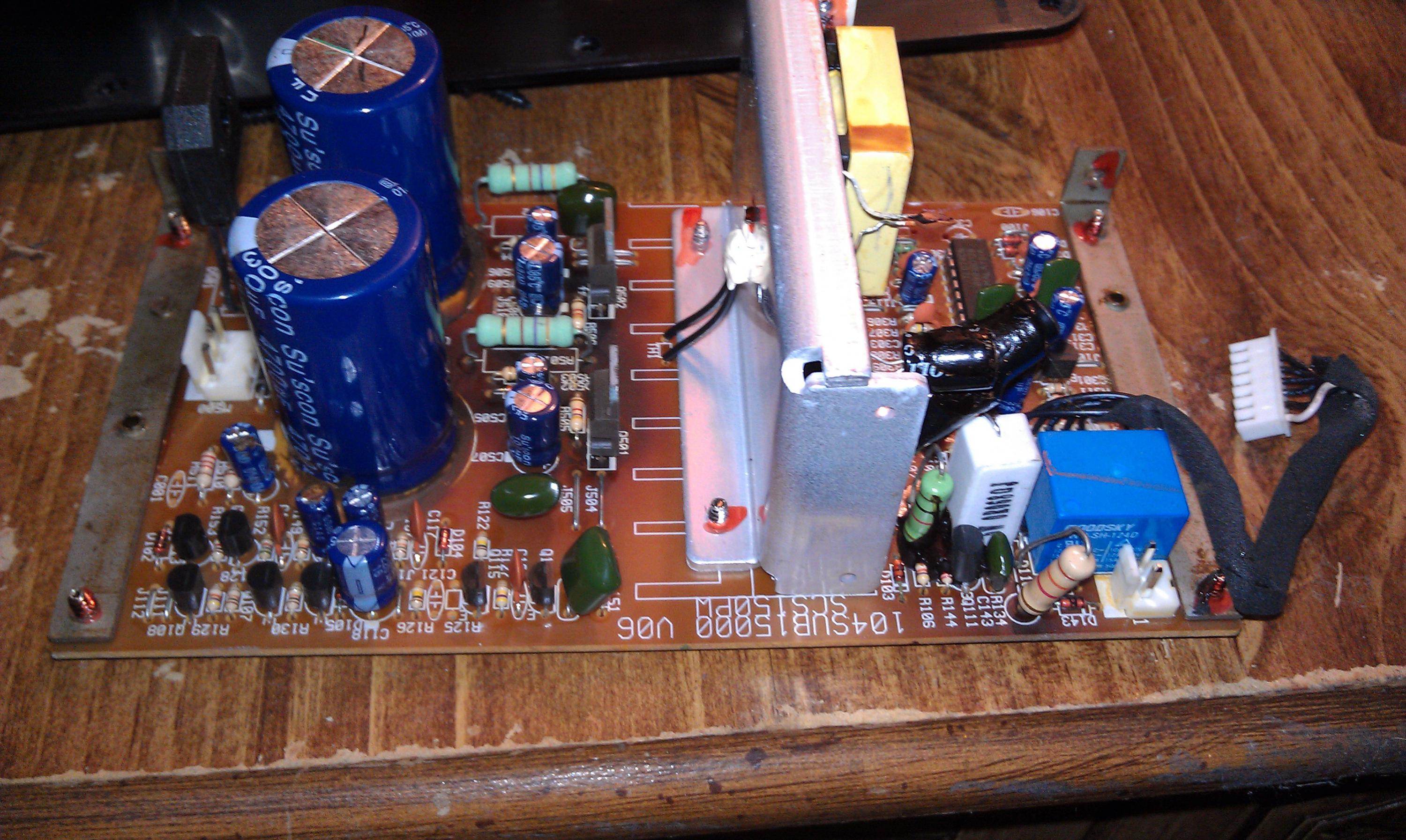

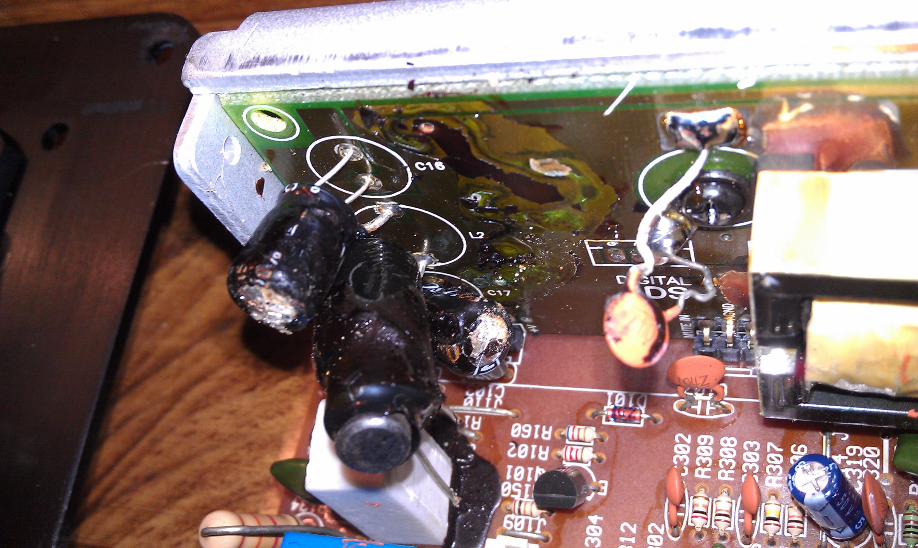

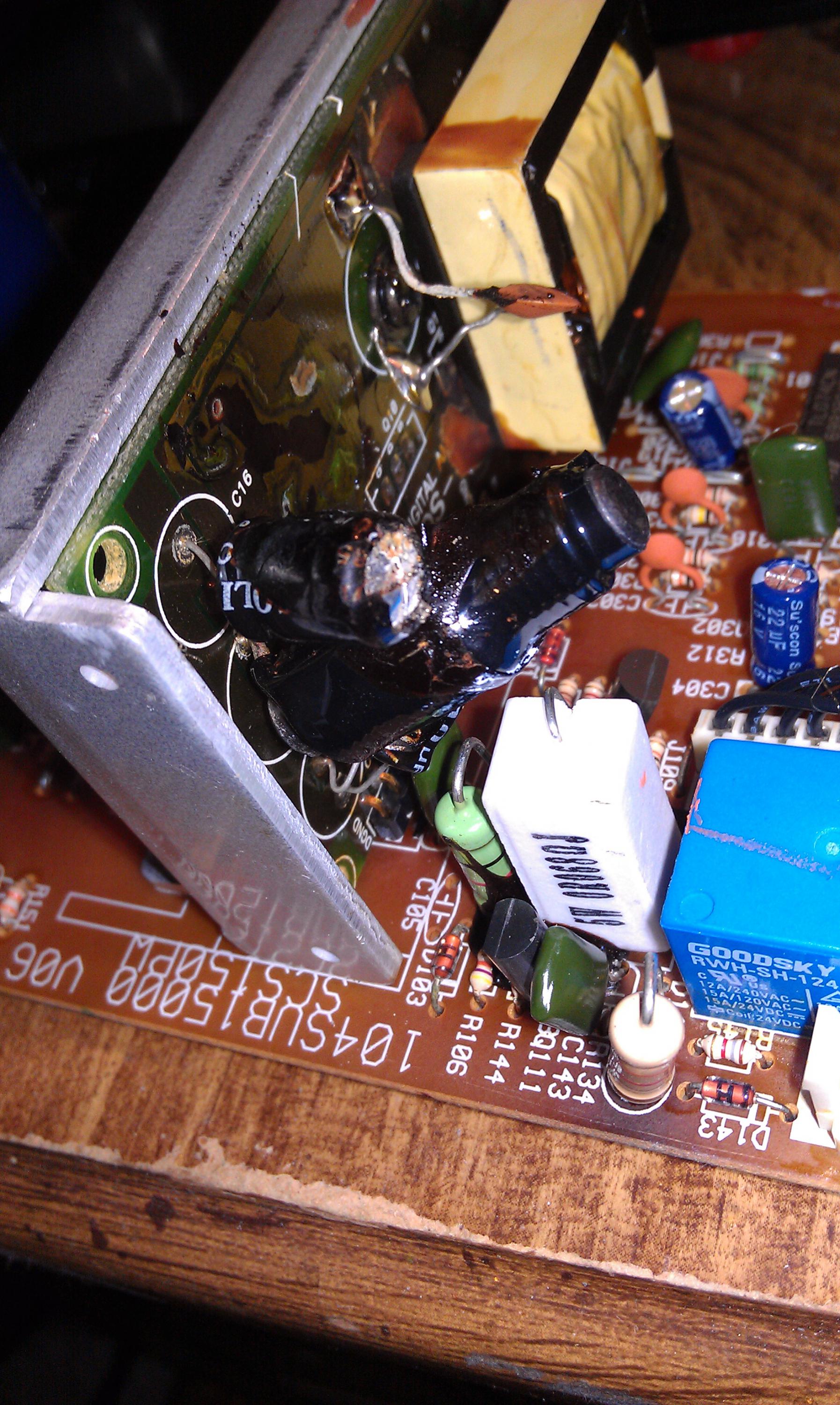

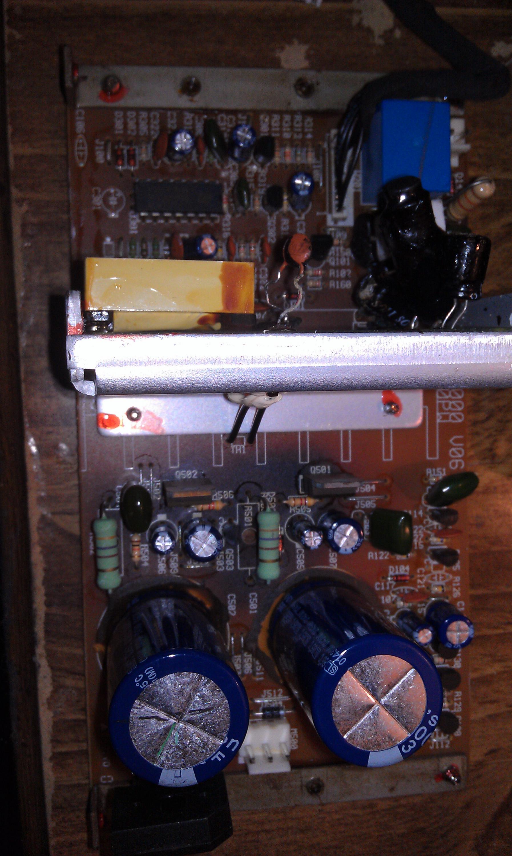

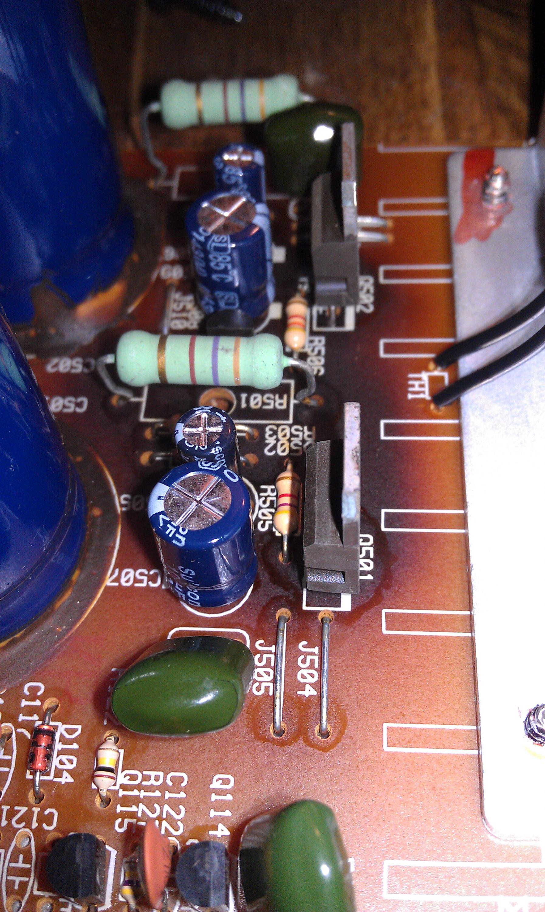

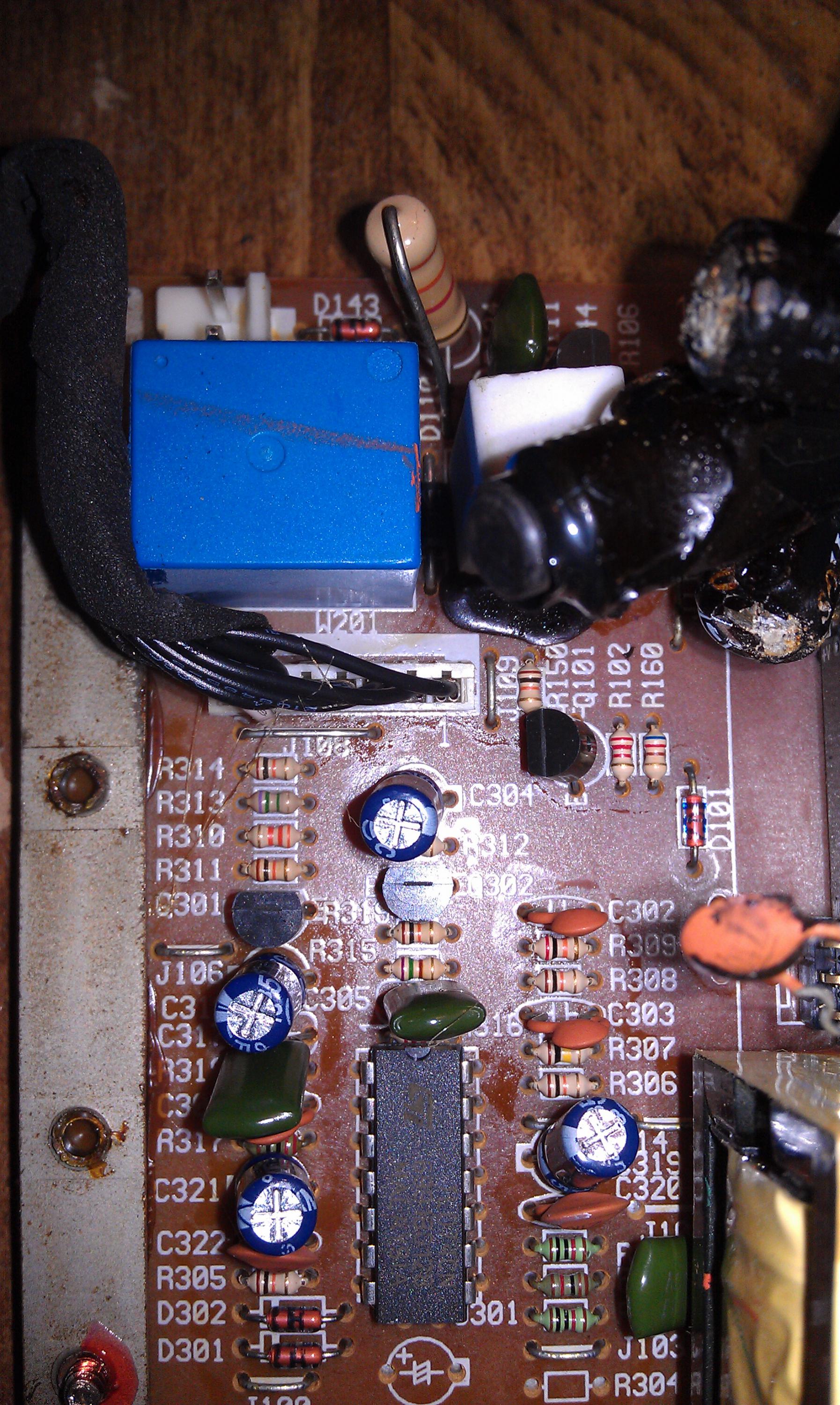

            I'm in the same club here folks! LOL. I've included some pics of the crispiness that happened. Looks like I'm gonna have to replace the PCB 104ds15000 for sure and possibly the PCB 104sub15000. However, here's the problem. JBL/Harman doesn't sell the PCB's alone anymore, they are only available as part of the entire replacement Power Amp Class D Module 012-7500-00022 which goes for $177 and change. Would it be worth the trouble to have a custom PCB made and then just replace the bad components after testing?
              You may be better of with sub-woofer plate amplifier as the replacement instead 9if the speaker is still OK, just have to modify the cabinet.
              http://www.parts-express.com/cat/sub...amplifiers/332

                    #29
                    From the pictures, easily can see degraded glue (again!), blackish PCB area due to heat from those naked heatsinkless transistors and leaking capacitors. Would suggest checking those transistors (possibly replacing them as well) and replace all capacitors on that board.
