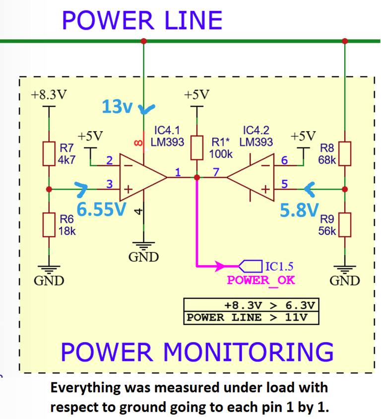

Sencor SVC7020BK robot vacuum cleaner problem
    • 31288
    Re: Sencor SVC7020BK robot vacuum cleaner problem
    q21 may be partially shorted,
    the base shouldnt draw enough current to heat a resistor
    • Awesomerp
      • Sep 2022
      • 29
      • Lithuania
      Re: Sencor SVC7020BK robot vacuum cleaner problem
      It still gets hot after replacing Q21, but thank you for all the knowledge and tips really appreciate it I will try to figure it out what's going on when i will have some spare time. At charging and why it stops driving.
      Last edited by Awesomerp; 09-26-2022, 02:21 PM.
      • Awesomerp
        • Sep 2022
        • 29
        • Lithuania
        Re: Sencor SVC7020BK robot vacuum cleaner problem
        As I understand the main objective of IC4 is when the positive inputs are higher than negative inputs, to provide an output of whatever voltage is on a pin8 which(vcc+) and step it down with 100k resistor to 5V? And if the negative input is higher than positive the signal will go to Pin 4 ground?
        But I don't really quite understand why there has to be 2 op amps in this comparator. Also do voltages of both of the outputs add up and then are being converted to 5V through a 100k resistor?
        Last edited by Awesomerp; 09-27-2022, 06:25 AM.
          • 31288
          Re: Sencor SVC7020BK robot vacuum cleaner problem
          the comparaters are active-low
          if either trips then the mcu thinks there is a fault with either the 8.3v or the battery voltage.
          if both voltages are u.k. then the output should be high because of r1
          if the output is low then either one of those resistors in the divider circuits is bad or the chip is bad.
          those chips can slowly drift out of spec which is why i pointed it out some posts back.
          • Awesomerp
            • Sep 2022
            • 29
            • Lithuania
            Re: Sencor SVC7020BK robot vacuum cleaner problem
            thank you
              • Jul 2011
              • 6070
              Re: Sencor SVC7020BK robot vacuum cleaner problem
              Originally posted by Awesomerp
              thank you
              I would also recommend changing the LM393 as well for the same reason as what STJ mentioned earlier
              • Awesomerp
                • Sep 2022
                • 29
                • Lithuania
                Re: Sencor SVC7020BK robot vacuum cleaner problem
                thanx!
                • Awesomerp
                  • Sep 2022
                  • 29
                  • Lithuania
                  Re: Sencor SVC7020BK robot vacuum cleaner problem
                  Could someone help me to identify what these codes mean below LM393 part.
                  "78K"
                  "D83D G4"
                  Maybe there is a website where I could find the datasheet of this exact one and see the specs of it to choose a similar one to buy.
                  Or is it enough to choose the same pin out and size one?
                  Last edited by Awesomerp; 10-01-2022, 10:15 AM.
                    • 31288
                    #29
                    Re: Sencor SVC7020BK robot vacuum cleaner problem
                    they mean nothing,
                    it's production tracking data
                    • Awesomerp
                      • Sep 2022
                      • 29
                      • Lithuania
                      #30
                      Re: Sencor SVC7020BK robot vacuum cleaner problem
                      I see, well ill use size and pin outs to determine the similar one then.
                        • 31288
                        #31
                        Re: Sencor SVC7020BK robot vacuum cleaner problem
                        it's probably an SOIC package
                        • AlexVG
                          Replacing the WiFi module on a vacuum cleaner iROBOT i7
                          by AlexVG
                          I have had an iROBOT i7 with a camera error (error 68) version REV M, year 2018.
                          I bought a liquid damaged Mainboard with WiFi module, from the same vacuum cleaner, but a different year and a different version (REV G).
                          (This board does not respond, only the LEDs light up in a circle.
                          The liquid damage is catastrophic and restoration is impractical).
                          (I bought this board to get the WiFi module and camera).
                          The boards are completely different in the installation of elements, even the connector for the WiFi module is different.
                          If...
                          10-22-2024, 07:20 AM
                        • ex250
                          SDJ01RM vacuum robot not powers on, all dead
                          by ex250
                          Hi friends, I have this vacuum robot at home that is not starting any more, no leds working, power button doing nothing, battery reading seems ok arround 14.4v, I suspect that mainboard is faulty, seems that there is not any clear brand model on it, and of course could not find any schematic. The trand of the vacuum is the Roidmi SDJ01RM, on some sites appears as vacuum mop Eve plus 60 or similar
                          If any one could point for where to start... would appreciate, new board is quite expensive arround 100 USD or more
                          Many thanks and Merry Christmas to all...
                          12-24-2022, 05:12 AM
                        • rtstorm
                          Xiaomi Vacuum Cleaner Charger PSU
                          by rtstorm
                          Hello my vacuum cleaner dock died, 0V on output. I replace the caps but still no voltage. I found out that this resistor is broken (showing 0 Ohm) do know the value of this? Is this really 0 Ohm resistor?...
                          05-24-2024, 10:07 AM
                        • Henke
                          Electrolux EUO9GREEN Vacuum Cleaner doesn't start
                          by Henke
                          I have a vacuum cleaner that won't start. I have desoldered 2 capacitors with low value. But i don't know if they can cause that kind of problem. Someone here with any thoughts and inputs?
                          I marked the capacitors on the pcb picture with red and blue dots. The big one marked with 334 K measures 216 nF and the other one marked 224 K measures 109 nF.
                          01-08-2024, 11:37 AM
                        • flat-earther
                          Hoover FM216LI cordless vacuum refuses to charge
                          by flat-earther
                          I have a Hoover FM216LI cordless vacuum which isn't charging its internal battery.
                          I opened up the unit, and it has 6x Samsung ICR18650-22P cells connected in series.
                          5 cells were at about 3.3-3.1V. one was at 2.4V, so I assumed this cell was bad that's why the vacuum wasn't charging so I replaced it with another 18650, but after that the problem still persists, the vacuum turns on a bit and then cuts out since the batteries are empty.
                          So I think the over discharged battery wasn't the culprit, it was a symptom of the unit not being able to charge its batteries....
                          06-06-2025, 03:14 AM
