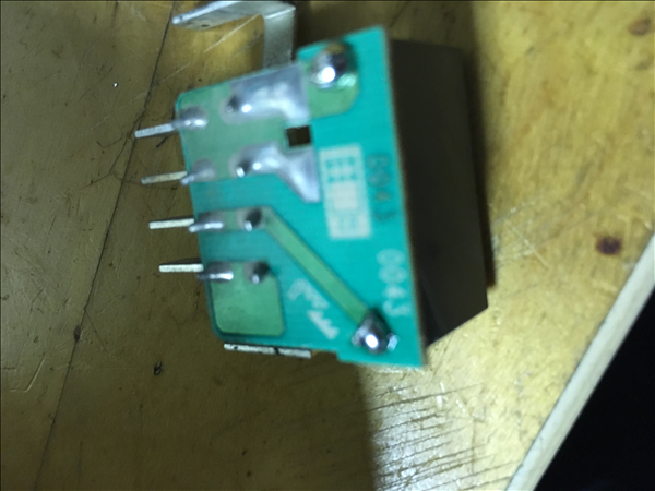

    Disassemble unit and start to inspect.

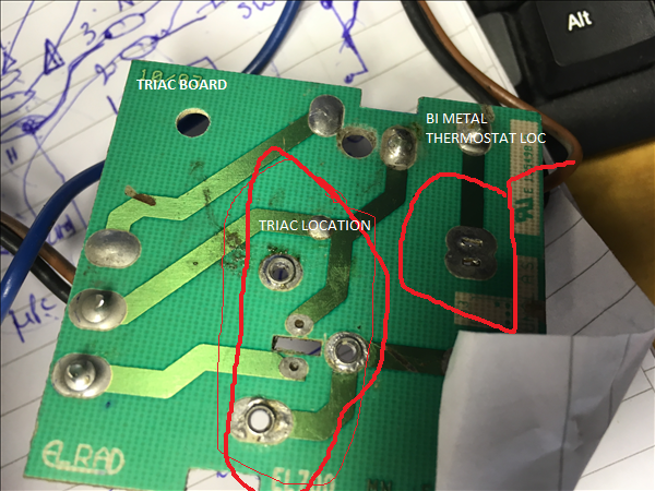

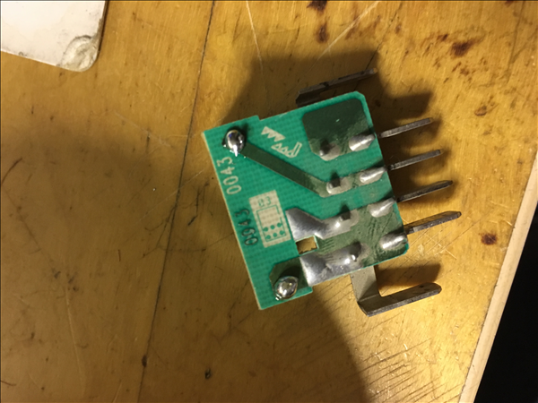

    Remove motor by unplugging connectors and removing triac board and main controller board.
    Note triac board has btb16 600BW Triac Snubberless 16A 600v and 36txe01
    bi metallic thermostat rated at 16A shut off normally closed 85 degrees c.
    Check thermostat....wide open. Check triac short MT1 to MT2.
    Measure pins on connector to motor. Blue /Black/Brown
    Remove connector and measure between Blue[Neutral and Line Brown] 5.0 ohms....why triac short?

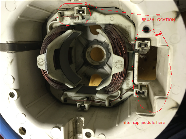

    Remove vacuum rotor by removing nut clockwise and pulling off. Note where spacer and washer are located. Unscreww 4 screws AFTER making hacksaw cut to mark position of cover. Pull apart but armature rotor may come with it.
    Watch the expander spacer washer under the bearing. Watch the brushes as they pull out. Remove the small plastic plug that holds the capacitor that is across the motor to neutral to suppress EMI. Open the capsule and push out little PCB. Mine had desoldered itself from the board. Resolder and reassemble motor. Check capacitance of cap . I measured around 196 nanos and should be 220n. Good enuff. Check resistance is approx 5 ohms and run motor up without triac attached using 12v power supply. All good then move on if problem not here. Use a car battery with a fuse if no stand alone power supply. I did a video here.

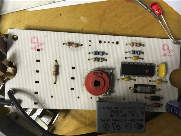

    Desolder main pcb from plastic carrier.
    At this juncture we have to discuss the circuit and connectivity so will pause here to upload some pictures.
    Needless to say mine still does not work as i need to replace the triac and the bi metal switch. i could not find the original protector but found
    thermorex-tk24-t02-mg01-o85-s75-bi-metallic-switch-250-v-16-a-opening-temp. I have no idea if i can make this fit but lets see as i might have to mod the pcb. So far Triac few pounds and switch the same.
    If you have found dodgy components here then just replace the two items and re-assemble the machine. If not then meet you back here.

        . This is an odd ball resistor that i dont know what it does.
        The triac gate is fed by a 75 ohm resistor from pin 13 with a voltage divider of two 10k's that goes to pin 8. Hanging off this is this 390 ohm res which appears connected to the incoming mains and the gate. What is going on here does anyone know? I thought it was the zero cross. There is also a 510K and a cap to pin 9 but the 510k goes to neutral.....is this teh zero cross cant see how.

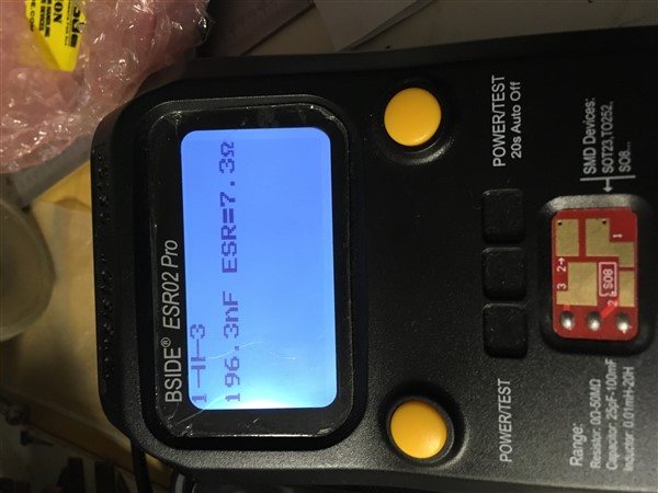

                      Thank you as the main issue was the triac board and the little cap that lives in the motor itself. The suppression cap in that board had unsoldered itself and the thermostatic switch had gone open circuit on the triac board.On the main controller board R1 had snapped in half.

                                  I did not say the path of the motor current is going through the 10K ohm resistors. My statement was "Also, the path to ground will be through the two 10K ohm resistors." In this statement I was explaining why the gate would not have a lot of current to it. You previously suggested that the gate would see a lot of current if the path of gate current was going through R1. Your ground symbol in this case is the ground of your controller
                                  In your drawing of the circuit there is no voltage specified on the zener diode. I was unable to tell what it's voltage was.
                                  Yes, I understand the purpose the thermostatic switch.
                                  13,14 and pin 15 which you call micropins of this IC what are they connecting to inside the Micro IC?
                                  How does the oscillator speed control circuit connect to the micropins internally in the IC to set up the turn on time for the traic?
                                  You are right when you say that R3 is draining the current to the gate. However, R1 is feeding the gate.
                                  Understand that the traic can conduct in both directions and as the polarity of the AC Volts swings the gate voltage will also, swing.
                                  The motor you showed has 4 brushes instead of 2 brushes. I wonder what the other 2 brushes are for?
                                  If I had more time I would try an understand what the zener and the connection to the Micro control pin 16 is doing. I will leave that to you.
                                  Thankyou so much for your feedback. Much appreciated.
                                  The zener is a standard 5.6V i think as i measure just over 5v when running
                                  This is the supply to the micro.
                                  The motor has two brushes only the only two little tabs are for plugging the capacitor module into which is a supression cap. Goes between MT1 and neutral effectively. The motor is a regular universal motor voltage into one winding then to commutator . Out of commutator to other brush then through winding to neutral. Commutator and brushes all in series as normal.
                                  Pin 16 is the supply to the micro.
                                  Pins 13/14/15 inside the micro are open drains or collectors which can sink 20mA when on or the port pulled logic low if you like.
                                  Oscillator runs at 4 meg. Sequence is:
                                  find zero cross of mains via an interrupt on pin
                                  Load register inside the micro with count
                                  Get value of speed contorl via analogue to digital pin.
                                  Use look up table to decide on on point of triac gate
                                  Send two lots of pulses to make sure the triac latches spaced by a few microseconds. This is because as you know Zero voltage cross is not same as current through motor....inductive it lags.
                                  This is simplistic program example in reality its a little more involved but there are examples out there...see microchip ST et al.
                                  THe gate switch point relative to the zero cross point of the incoming mains controls the speed of the motor in quadrants 1 and 3 of the triac. In each case gate negative. Gate current via the drains or collectors of the micro flows to micro ground via the zener circuit.
                                  Anyway upshot of all this is it needed replacement of the triac and thermostatic switch and the gate biassing resistor 390 ohms.
                                  All back together and working.
                                  Thanks for all the suggestions and help.
