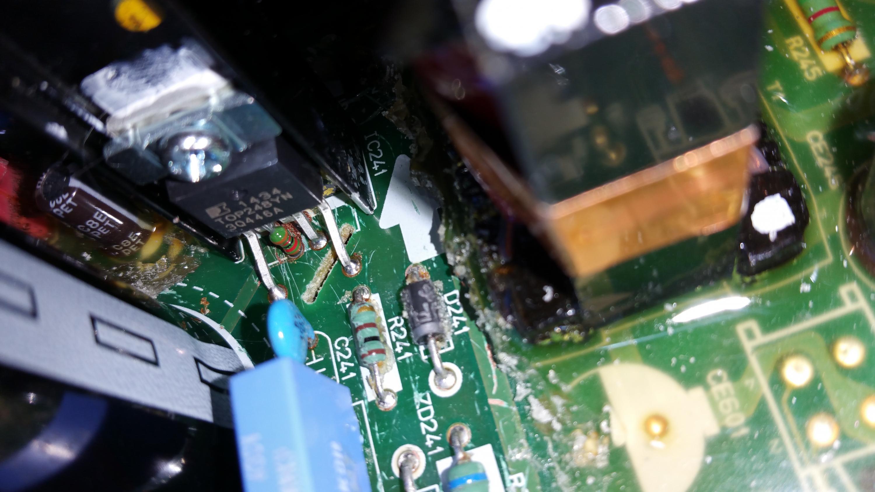

            The current-limit graph Fig. 54b is scaled only for the Y-axis, so a TOP242 at 0.45A is 50% of a TOP243Y or 33% of a TOP244Y.
            Like Fig. 6 values. I'm assuming it's a (Y) TO-220-7 package you have.
            TOP244Y seems at the limit of big, going from 1.35A down to 0.45A (~45kohm) is the lowest current the part can do.
            I would try TOP243Y and 16.5k-19k for the resistor. The current-limit accuracy is +/-7% for the IC, so 16.5k is for a low bogey to keep at least 0.45A available. The transformer can take a bit more anyhow.

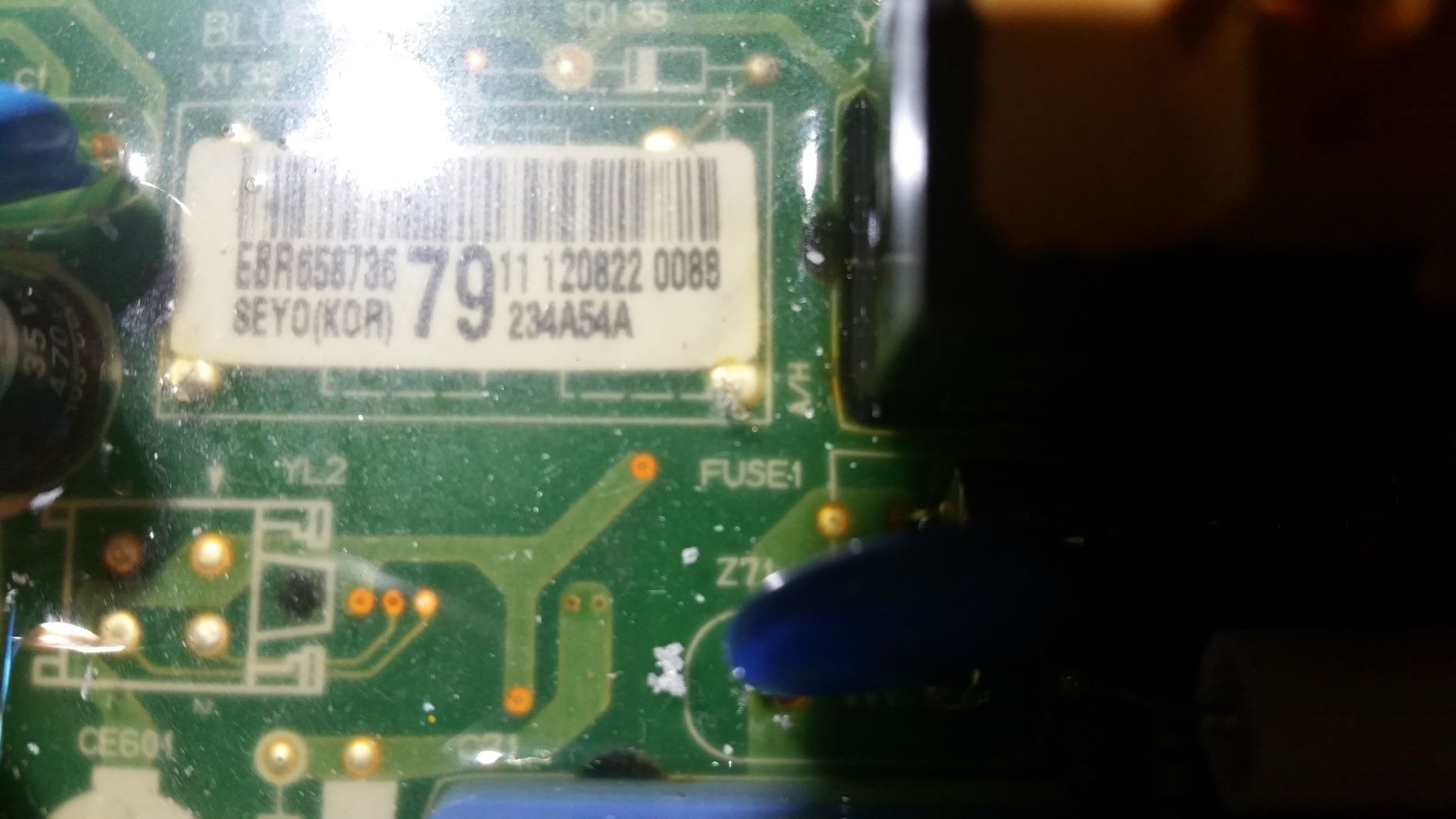

            Can you post your control board part number, for the search engines.
              Re: LG Washer/Dryer Power Fail
              I just can't be doing with carting a machine that's 99% functional to the scrapyard for the sake of the 1% of its faulty components that stop it from working (says the man with two 25 and 50 year old cars in his garage awaiting repair). The S.Korean joke is the big sticker on the front boasting a "10 Year Guarantee" on the DC Motor. If there's no way the rest of the product would last that long it's not a lot of help although if it did come to scrap I would definitely recycle that motor for something - a wind turbine or E-bike perhaps.

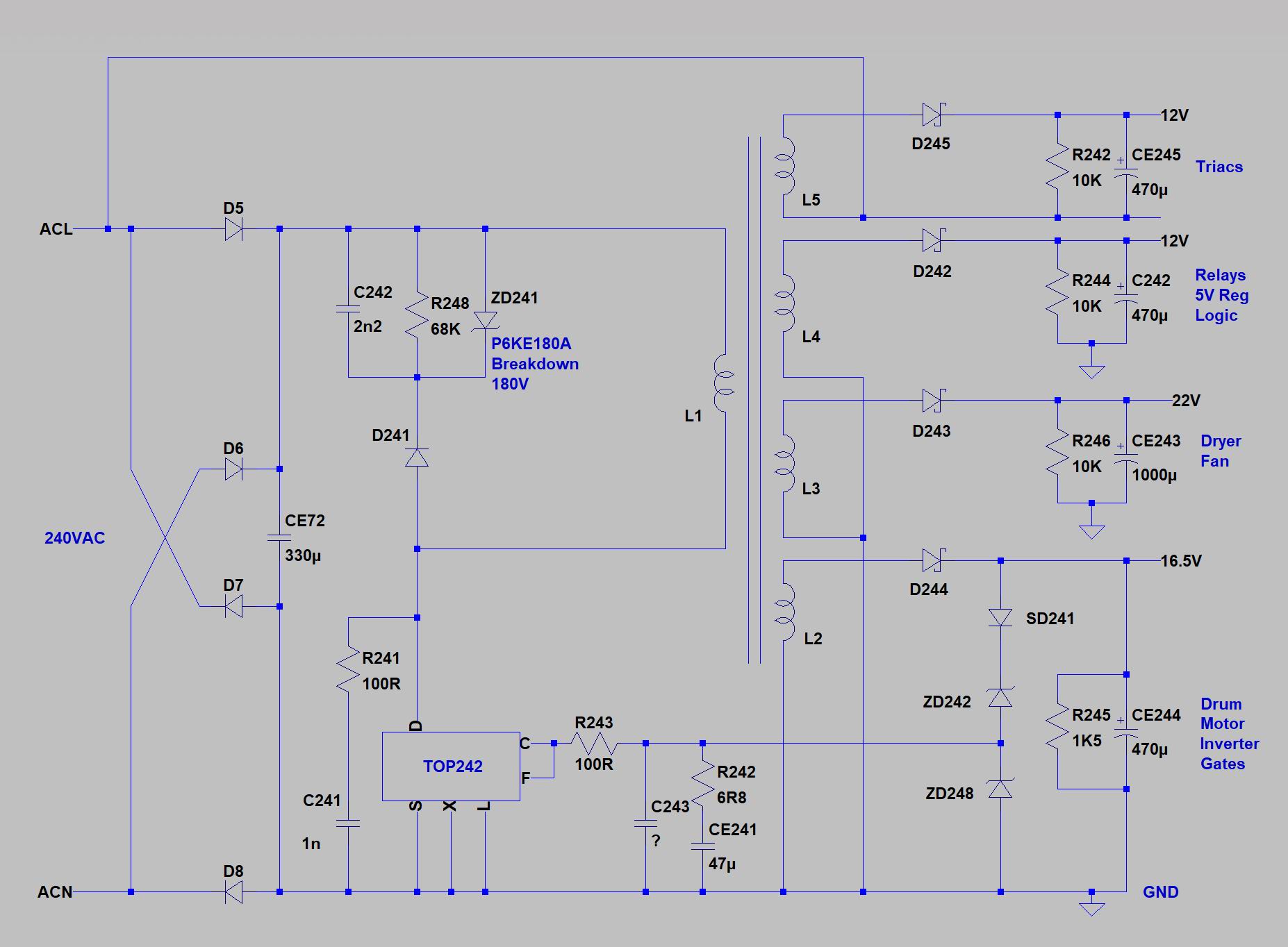

              I can confirm that the switcher is a (Y) TO-220-7 part:
              and I think the board ID is EBR658736:
              Looks like my machine will be the lab-rat here as I've got a TOP244Y on its way as I figured it was the lowest on-resistance part that could be limited down to 0.45A. You seem to agree with that, and I'm sure the transformer primary would handle a teensy bit more current if required. In the thermal image the transformer is pretty close to ambient, and I'd like to get that 22V fan supply higher than the saggy 18V it is now when loaded.
              To do this I'm prepared to tweak the resistor between 33K and 47K while keeping an eye on the transformer temperature.

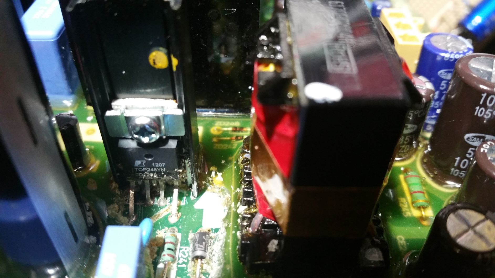

                  That looks like a TOP246 to me.
                    #29
                    Um, I also see TOP246YN in the pic. That is a 2.7A, RDS(on)=2.60R. Upgrades would be different than what we've been talking about; TOP247,248,249

                        I see what redwire sees. That isn't a TOP242, it's a TOP246! So you need a new switcher first!!!
                          #32
                          Oh! I really done goofed. I can't begin to explain what led me to read that wrongly. So now it's even more baffling...
                          Going back to my plug-in power meter test, and seeing 8 Watts from the AC input then @ 80% eff., the baseline load supplied by the TOPswitch when the machine is idling is just 6.4 Watts. I can then easily and repeatably get a 80C+ rise on the part by adding 13.5 Watts of load by running the dryer fan for 5 minutes. This takes the IC from around 60C when idle up to the ~140C trip-point. Surely even the TOP244YN should manage 20 Watts without this much drama?

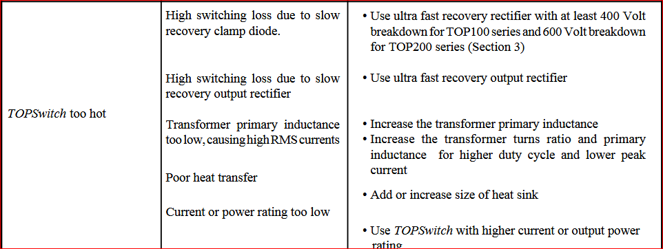

                              I think the IC can get too hot from the SMPS having low efficiency or heavy load. The thermal IR camera can show if another part is stealing output current.
                              But running hot with low loads on the PSU?
                              Power Integrations AN-14 lists reasons for a TOPSwitch to overheat. As budm mentioned, the snubber zener can apparently cause trouble too. So there are some supporting parts to check.

                                  I went over the PSU circuit once again and found another CR snubber that I'd left off my first schematic (R241, C241). I've also corrected some part ID's.
                                  I've now desoldered most of, and tested all of the individual parts around the TOPswitch and nothing has been out of spec. DZ241 is a 180V Littelfuse TVS so I took it out and tested it with a scope using the flyback from a relay coil. Sure enough it clamps at about 180V. I'm pretty certain there's nothing wrong with any of the supporting parts although I have replaced the big DC cap CE72 with a EPCOS / TDK B43545A5337M000 becuase the original has probably clocked-up enough hours already.

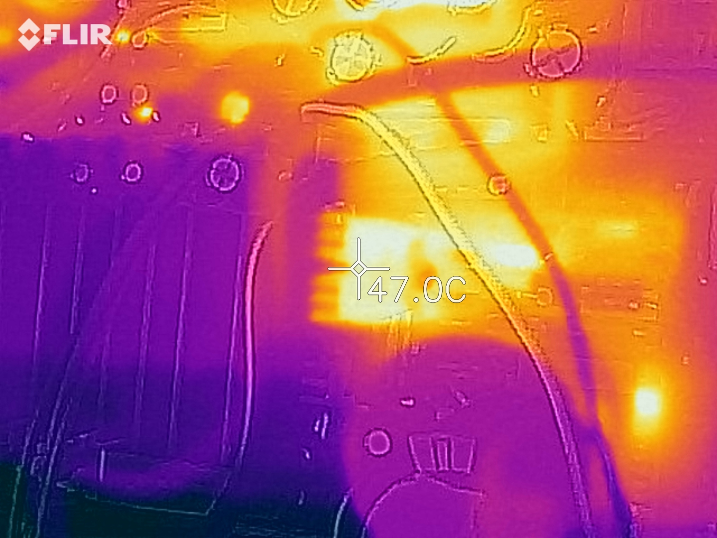

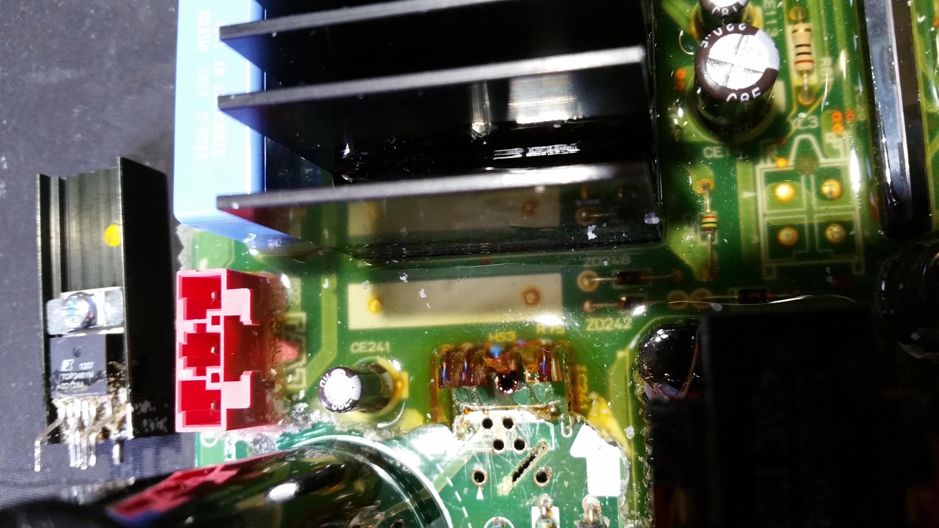

                                          D243 was a Silicon but is now a Schottky. I finally extracted the TOP246Y:
                                          And replaced it with a TOP248Y plus 12K resistor in series with X pin to maintain the current limit (plus a little bit):
                                          So now with the Fan running, after 30 minutes it's only getting to 47C and not tripping the thermal shutdown anymore:
                                          I'm coming around to the notion that the dryer fan bearings are worn and putting extra load on the PSU. When I monitor the supply rails with and without the fan running I see the following:
                                          [Ideal] Idle -> Fan running
                                          [12.0] 13.1 -> 13.2
                                          [16.5] 16.0 -> 15.9 (Feedback tap)
                                          [22.0] 23.7 -> 19.5 (Fan supply)
                                          (Ideal is what is printed on the silkscreen against each rail)
                                          Feedback is from the "16.5V" rail so that rail stays closest to the design ideal. The Control input circuit is pretty slack though - using 9.1V Zener (ZD242) plus a diode drop (SD241) plus Control pin input current of 6mA * R243 to maintain 5.8V at the C pin resulting in a theoretical stabilised output of 16.2V
                                          Anyway, this TOP248Y upgrade has indeed remedied the "Power Fail" problem for now, and as everything else is working correctly I can keep an eye on the Fan and see if it continues to draw more and more current (unless it falls apart first).
