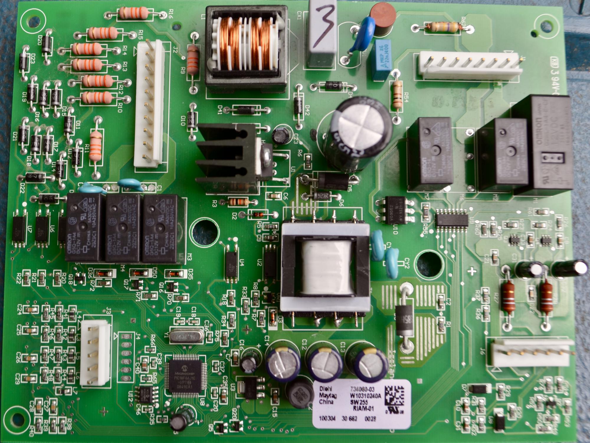

    Recently I had a coworkers refrigerator that stopped cooling after seven years of service.
    This Control Board is located on the backside of the refrigerator. The control board part
    number W10213583D replaced by WPW10310240 can be purchased for a repair service on eBay for
    $80 but as we have learned in here why replace when you can repair your board yourself.
    The Control Board has four 10uf 50v CAPs and I found the two 10uf 50v Capacitors off by themselves
    were bad. The two 10uf CAPs side by side tested good. I would recap the entire board.
    The refrigerator is now up and running for the last two months. Good Luck with your repairs.

                Replacing the 4 caps 10uf @50 and the 47uf@25 should fix the issue.
                Go for the low ear value caps with the higher temps since this board will be placed back in a cabinet
                If time allows there is 4 other caps that could be replaced this will provide piece of mind to you. You will be saving over $200 for a control board and even higher cost for a new refrig

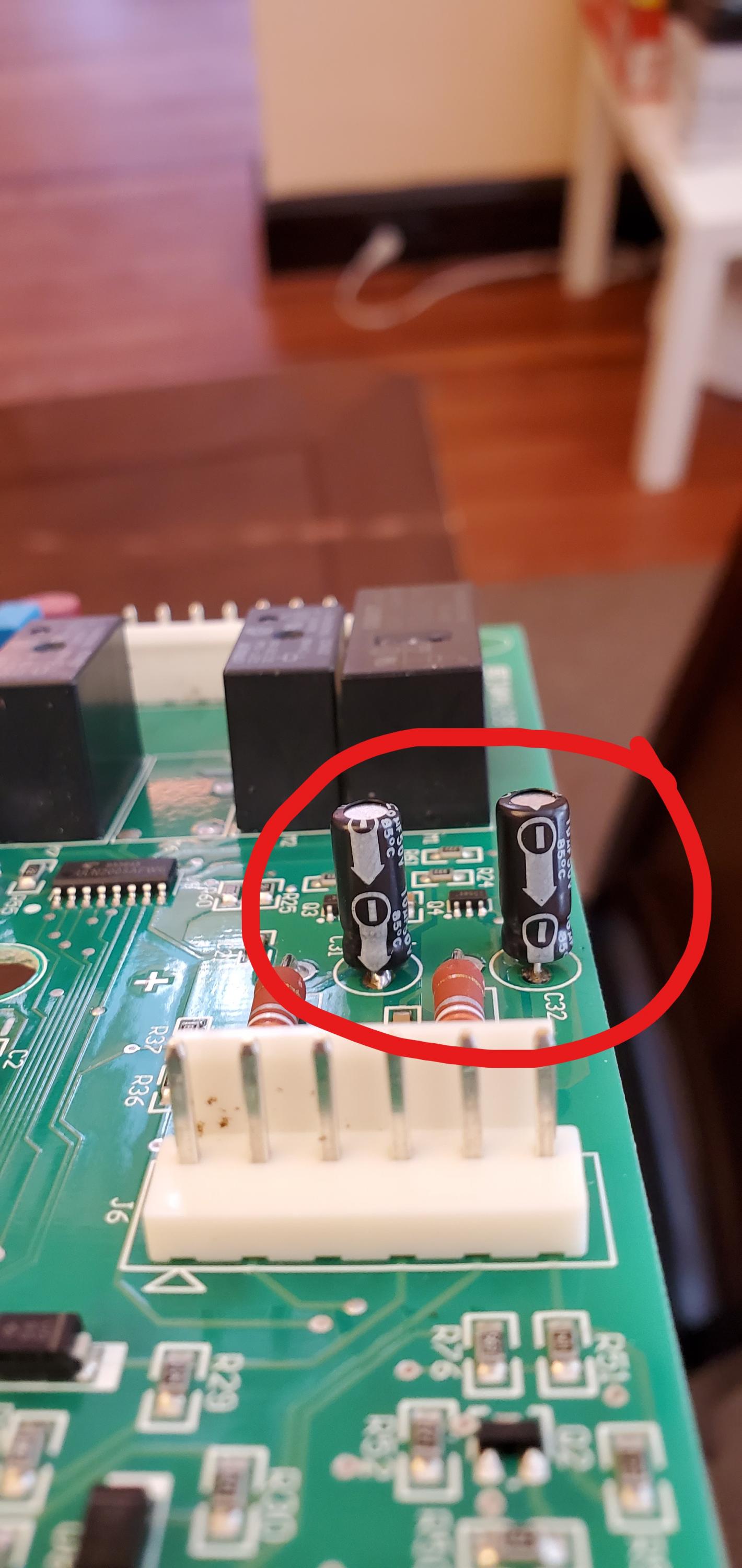

                        I just did this repair last night and got my Maytag refrigerator up and running again. I'm new to this and not that great at soldering but I replaced the 4 10uf 50v and the 47uf capacitor. I didn't have any capacitors on hand so I had to run out to MicroCenter to get them, but soon realized the capacitors I put in from MicroCenter probably aren't very good (they are rated up to 85c).
                        Anyway, fast forward this morning my refrigerator controls went out again, compressor still functioning. It appeared the controls just rebooted. I'm thinking my soldering work wasn't very good or it was because of crappy capacitors?
                        Should I redo solder with good caps? If so, what caps should I get?

                          Post some pictures of your work, that way we can see if you did something wrong or not, The caps should be good quality and rated at 105° but the ones you replaced rated at 85° would not have failed this soon.

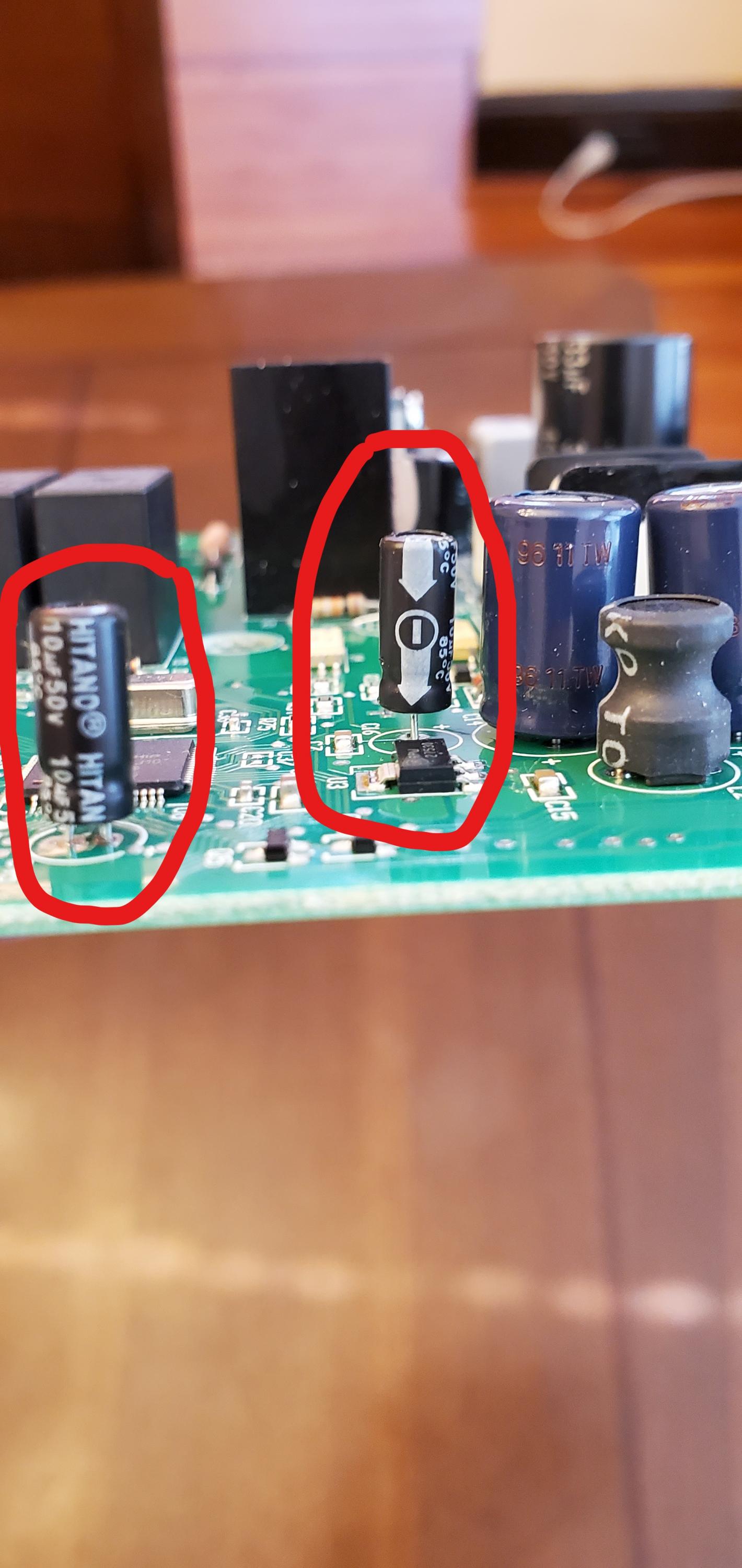

                            Thanks for taking a look at this. This morning the refrigerator was operating correctly. It may have been the heat that caused the control panel (main board) to shut down the other morning as I had gone from room temp to cooling overnight after the repair 'succeeded' the night prior. When I popped the cover open this morning to remove the board, it was indeed quite warm in the main board compartment. They should really adequately cool the board, but I think the reason they can't do this is because of the presence of water (from water line connecting the fridge).
                            I've attached pictures, I put the caps a little higher off the board as I thought this may enhance their cooling, let me know if this is a mistake.

                              Um, the one cap 10uF 50V top of the pc board looks like the pads are shorting or a blob is there. It doesn't look so great. You really need a solder sucker/wick to do this kind or work, yanking them out can cause new damage. I'd fix this and see how the board does.
                              For the time and money, I just order the highest quality parts from Digikey and eat the $8 shipping fee. Hitano caps I'm not sure if they are decent.
                              Why did you not test or change the other two blue filter caps C14 35V ?
                              There's very little factory solder on the big connector pins, so do not trash them or pins might fracture and make bad connections.
