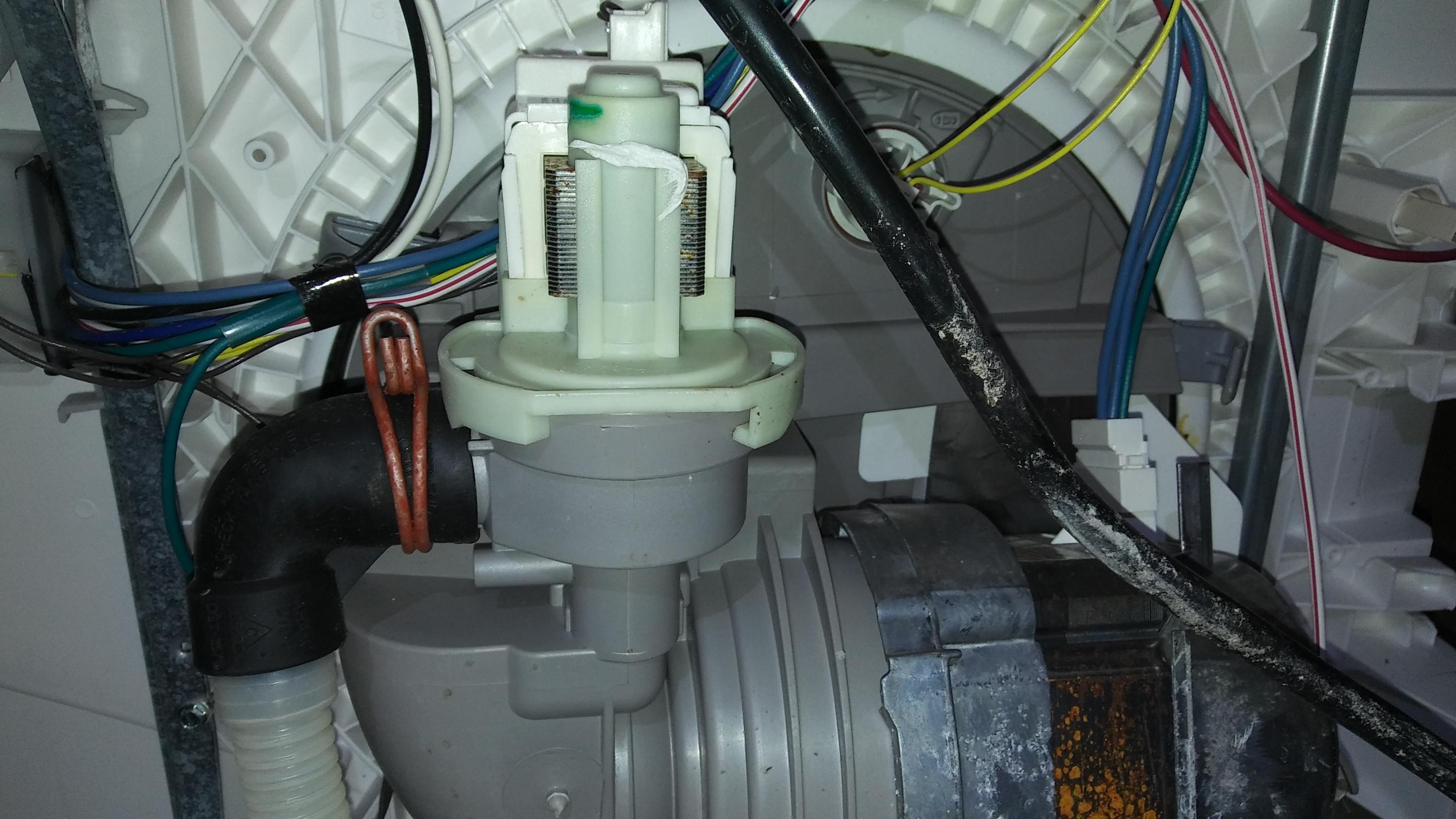

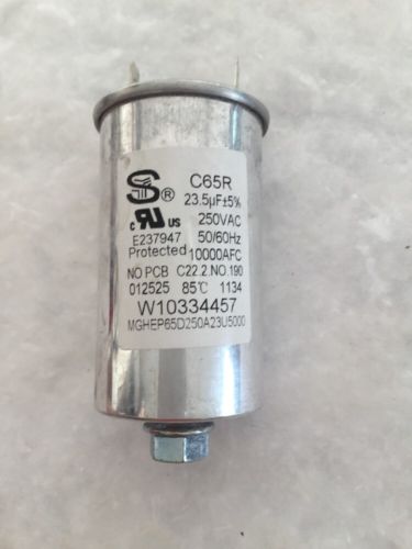

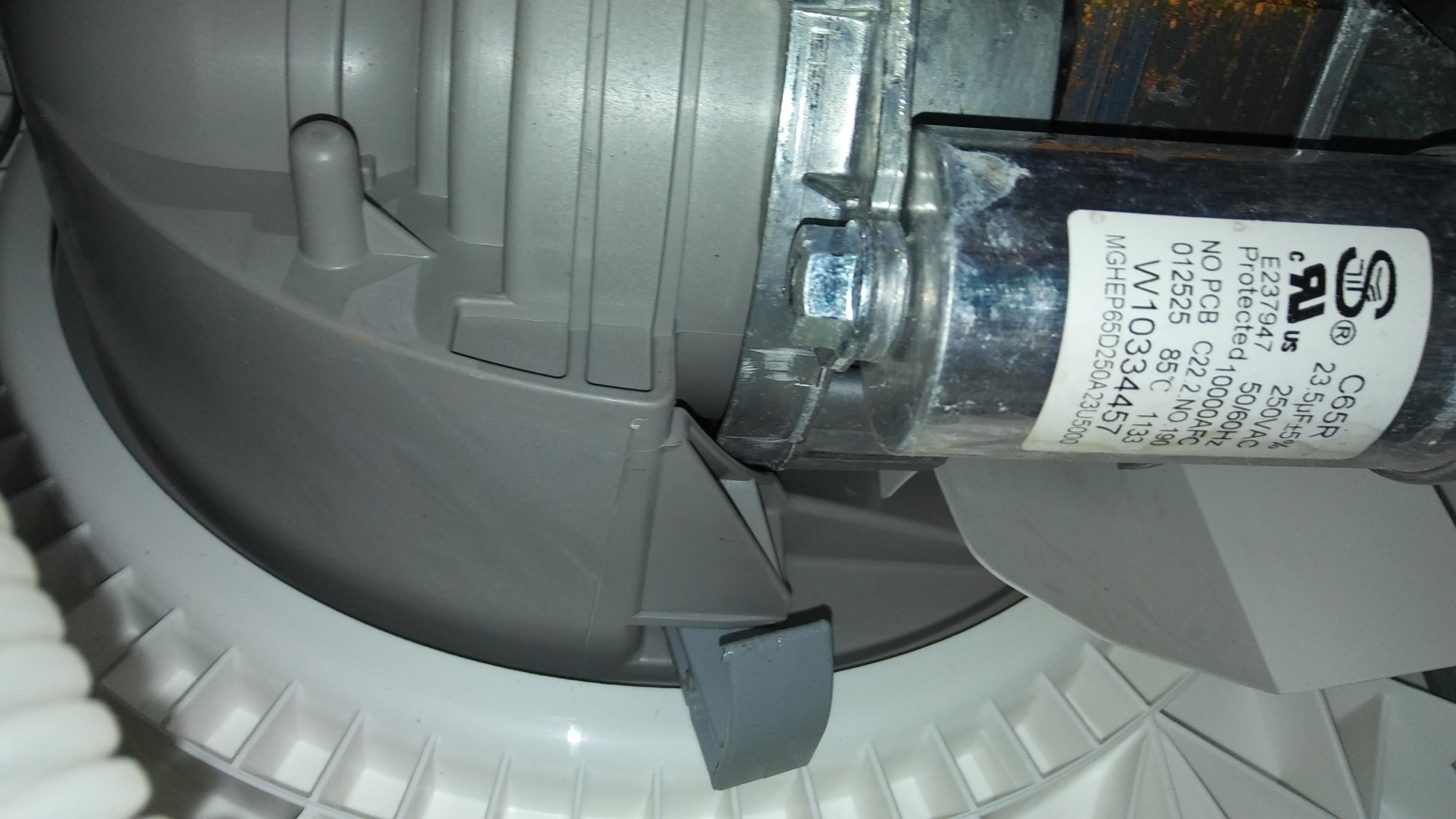

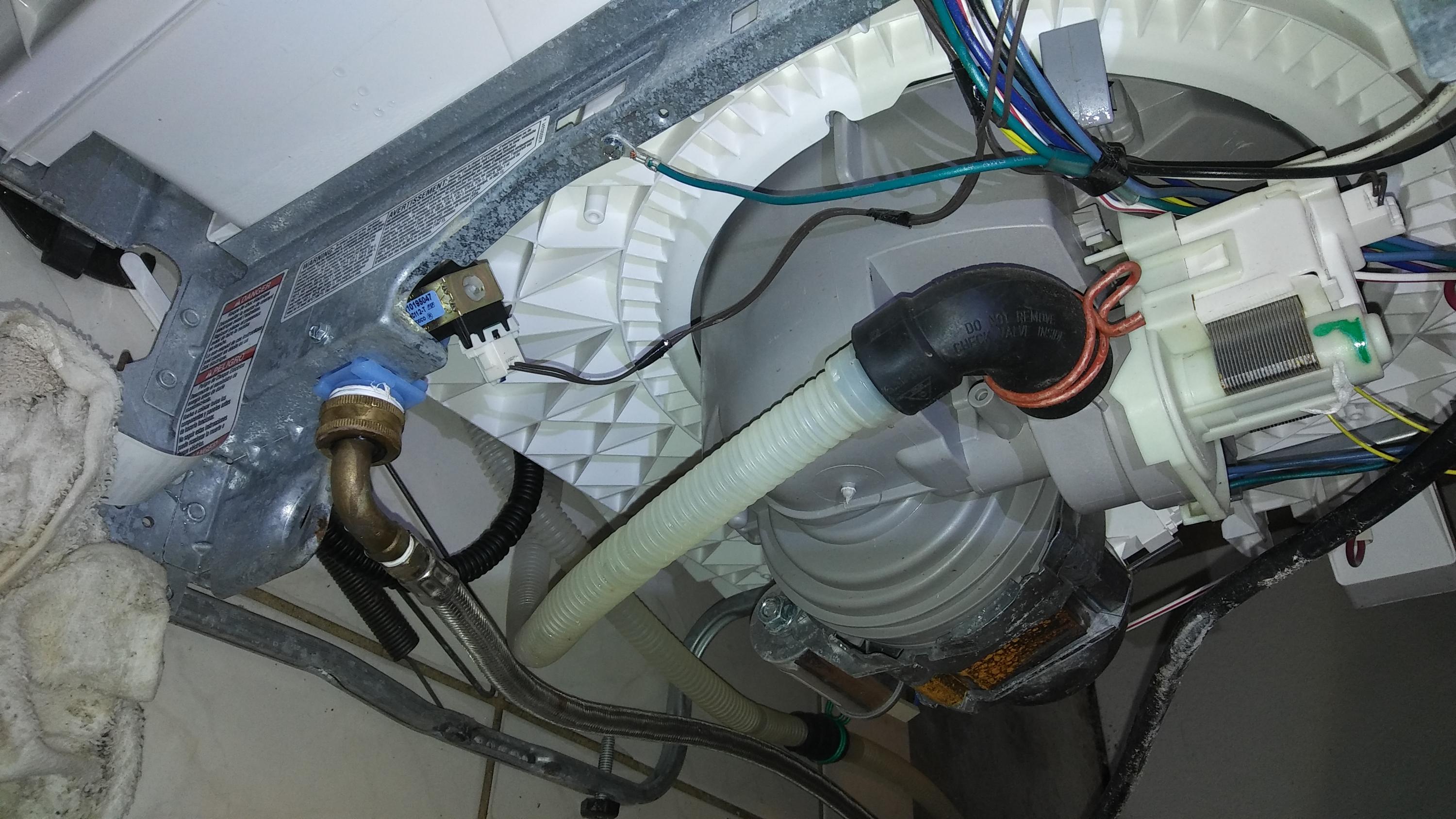

    Dishwasher has capsistor also, when I fix the leak of the input hose (pic 2) I found it has A motor start cap. at 23.5uf/250v (Parts No.W10334457)
    Maytag PORTABLE DISHWASHER MODELS: MDC4809PAW1
    Some single-phase AC electric motors require a "run capacitor" to energize the second-phase winding (auxiliary coil) to create a rotating magnetic field while the motor is running.
    A motor capacitor, such as a start capacitor or run capacitor (including a dual run capacitor) is an electrical capacitor that alters the current to one or more windings of a single phase AC induction motor to create a rotating magnetic field.

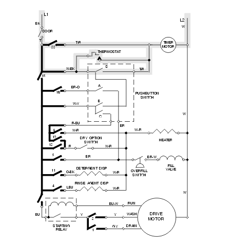

    Maytag dishwashers I've fixed use a "starting relay", cheaper than a start capacitor.
    Under high current motor load, the relay pulls in and connects the (wash or drain) start winding until motor current backs off.
    Anyhow, the relay gets sticky or contacts fail.
    A real bear to troubleshoot- if it's the motor or the starting relay or mechanical friction causing the motor to not startup.

        Yes I bought this, Maytag Dishwasher, 3 years ago. when I junk some appliance I saw that (starting relay) I misunderstand it as A current limiter.
