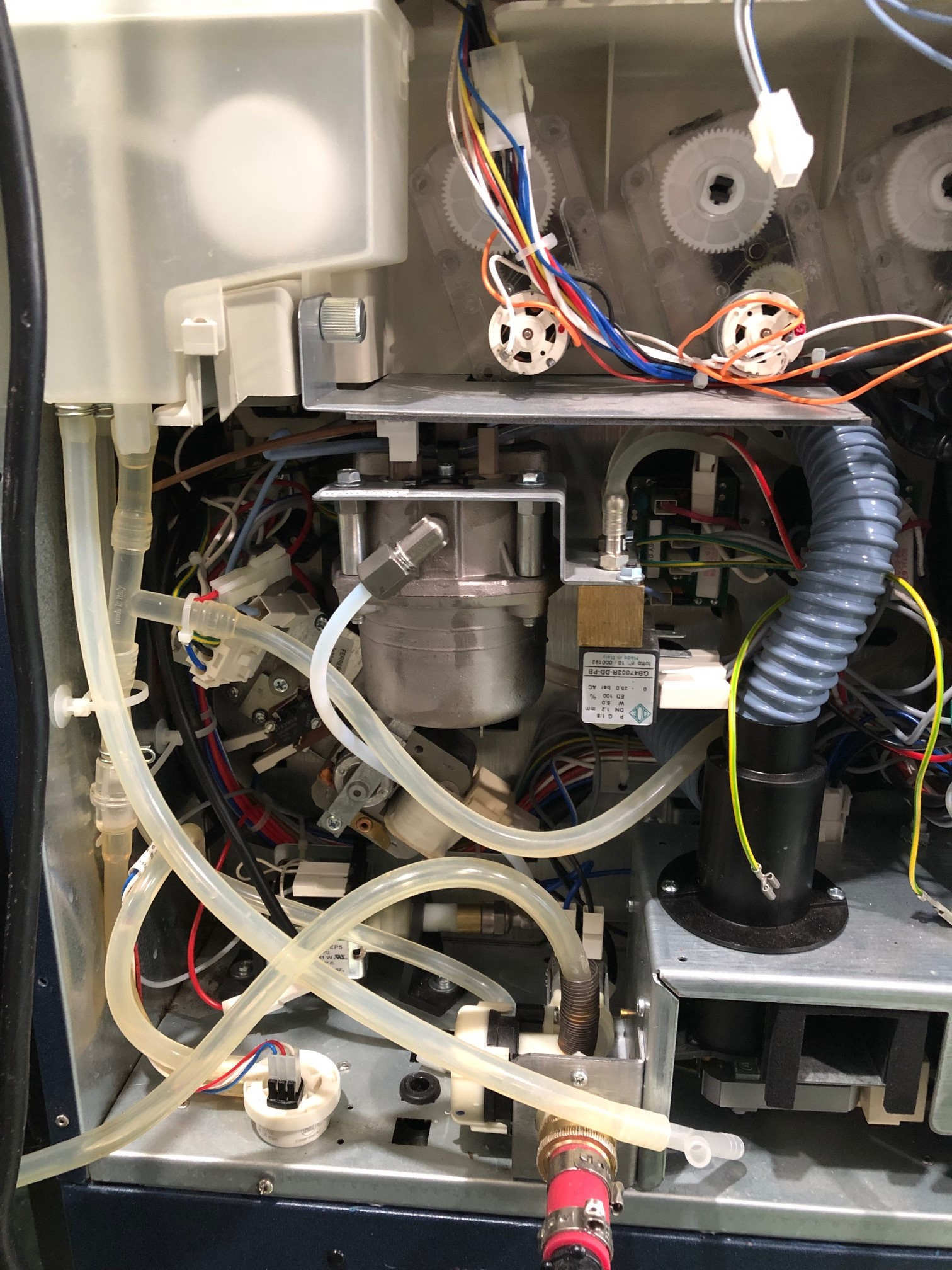

    Hello. Have a known good Saeco SG200E Coffee machine but the internal hose from the pump were disconnected. Would someone be kind enough to share a few clear pics of the inside of this machine so we can reconnect the hose plumbing again? Many thanks.

          Thanks but we have those very grainy manuals for the SG200E. The issue is that we are unable to make out how the white hoses interconnect inside of the machine using the same referenced manuals. A local tech has some contacts who may be able to assist and he has requested some pix of the inside of our machine. Will gather the pix on Monday. Was hoping that is a hose wiring diagram on the internet but unable to locate one so far.

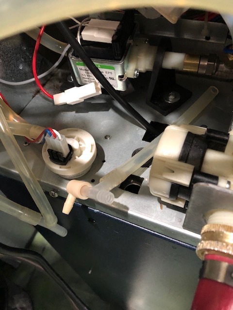

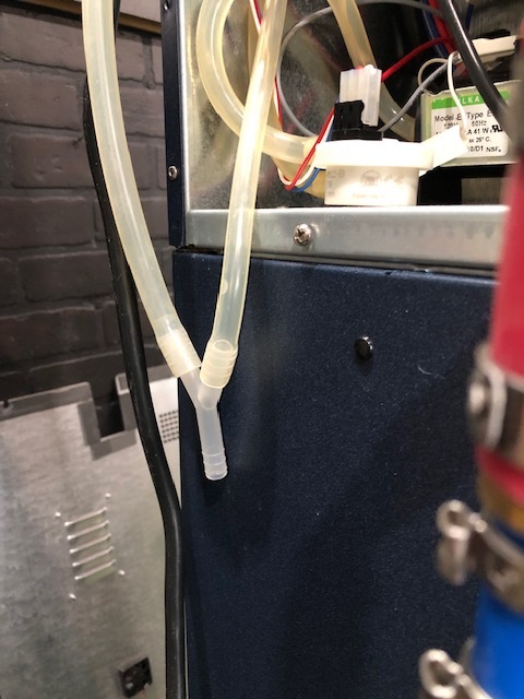

              Thank you. Please see attached.
              Trying to figure out the proper hose plumbing - note the disconnected hoses as well. The unit worked fine before the purchase but someone disconnected hoses that should not have and here we are..
                • 31283
                the hose with the long section not discoloured looks like a "waste" pipe for overpresure on the inlet maybe.
                the other one with the 3way joiner on it makes me think stuff is missing
                  • 31283
                  the long one could also go to the upper left but it doesnt look like it ever had a clamp on it
                  so who was the asshole who messed inside it?
                  you normally only decouple the water inlet to move a vending machine
                    • 31283

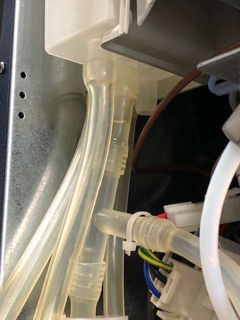

                    o.k. i got it atleast a bit.
                    the long hose goes to the tank inlet upper left,
                    the tank is a cistern style with a flat-valve/switch
                    the other pipe on that tank is coming off and the hose-clamp is missing - so whoever drained it is a complete cunt.

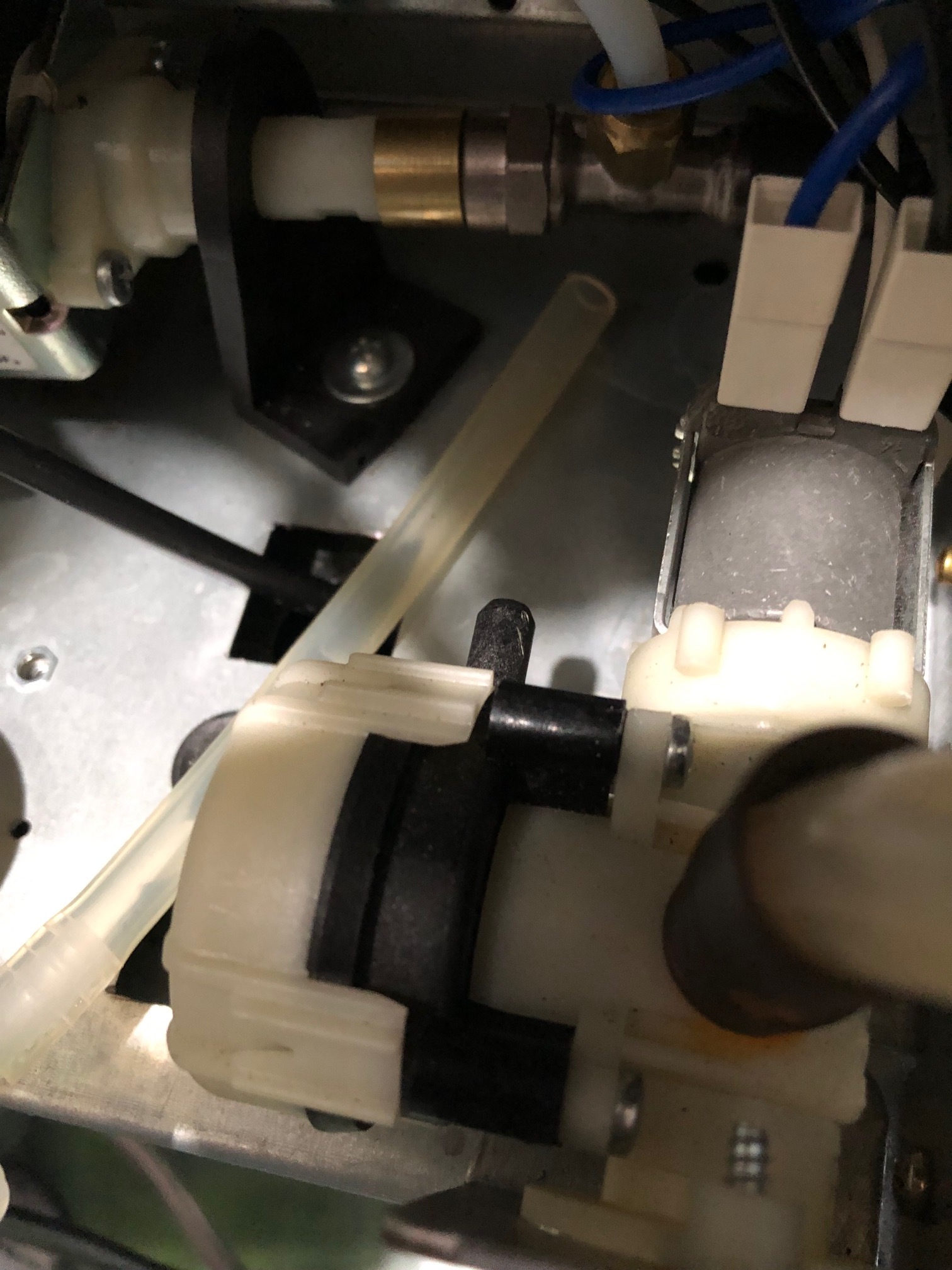

                      Somebody wants to make money and get called in to fix the "leak".
                      I can see the fill solenoid tube should connect up to the cistern tank. But it has the rod inside and looks instead like a tank overflow port, not a fill port?
                      The tank (drain?) port tube goes to a Tee and I'm not sure where it goes. Can't see where the drain is.
                      The one ground wire is loose, I hope it's for the rear panel. Pic is OP's but smaller file size:

                        Thanks guys. After more digging, finding assorted tidbits on the internet including:
                        Saeco Rubino Setup Guide Part 2 (youtube.com)
                        After watching this video, the red pipe mates with the outside water inlet and the topside clear hose attaches to the upstairs reservoir's bottom nipple.
                        Not sure where the 2 way splitter junction (bottom right of the pic) travels.
                        I think we may have just found a hose diagram but still staring it down and will post it here.
                        Click image for larger version  Name:	IMG_2371.jpg Views:	0 Size:	75.3 KB ID:	3270946 Click image for larger version  Name:	IMG_2372.jpg Views:	0 Size:	82.8 KB ID:	3270947 Click image for larger version  Name:	IMG_2373.jpg Views:	0 Size:	78.8 KB ID:	3270948
                        Rubino-200.pdf
                          • 31283
                          the reason for the fill hose going into the tank with a long internal bit is to fill the tank from the top so if there is a water pressure loss it wont backfeed from the tank to the mains.
                          • redwire
                            • Dec 2010
                            • 3912
                            The think the cistern tank has 3 ports at the bottom. Fill, overflow, drain. I guess it fills from the top via the long post inside.
                            But that means the outside port to the bottom of the tank is not an overflow, would not connect to the Y" if it's the drain/overflow Y.
                            Also weird the water solenoid has a big outlet and a smaller tube on the side.
                            The machine bottom has a grommet hole, it must be where the drain (pan?) is and the fitting pops into.

                              The bottom half of the machine features a drain water pail and a water tank to allow this unit to be stand alone without the need of a water connection. This unit will have a water feed so no need for the stand alone option. The YT video notes the water pump and the backside being referenced as a 'regulator'. Not sure how that works since there is a connection on the topside and also a backside? Personally know of a traditional water solenoid for my kitchen touch faucet.
                                • 31283
                                the tank is gravity pressure so it will feed the boiler, the smaller direct tap from the inlet may be a purge line to clean coffee out of the lines from the filter to the cup nozzle.
                                you have to remember these machines need to self-clean because they can sit unused for hours or days.
