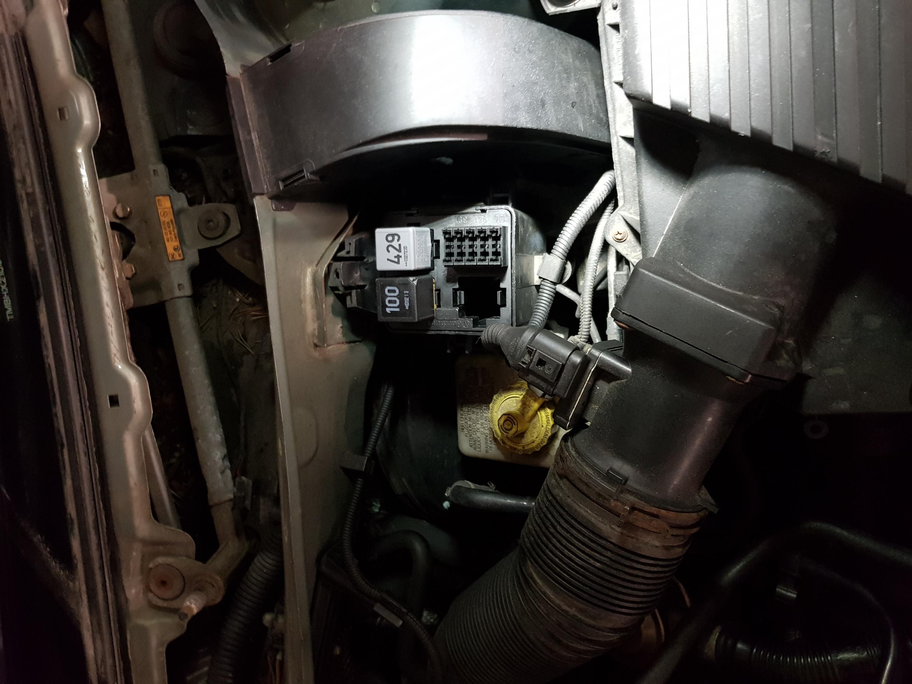

              Re: 12v 1uo941243c Relay repairable?
              cant remember if i posted pics of the fuse boxes . .. just starting up the laptop

                  #108
                  yes post 41 there is no 50 amp on it

                    #109
                    engine bay 1 .there are 8 fuses together .its one of those .
                    left side behind the headlight just to right of battery as yo look at it and behind battery

                      #110
                      Originally posted by sam_sam_sam
                      Post a picture of the relay that you want to know about
                      here it is

                          #112
                          ok if you cant find the fuse pull k20 and see if its getting power on one of the large terminals in the socket .

                                    #117
                                    just measure the voltage on the large terminals where k20 relay plugs in . one should be 12v . the other is going to be shorted to chassis if the fuses have been replaced that blew first .

                                      #118
                                      you need to find and fix the short before blowing more fuses .

                                        #119
                                        i did it allredy ut there i gott power from 2 pins and the fuses are replaced here somes pics. the car have an cautomatic gearbox
